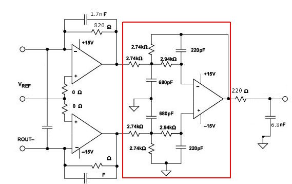

Continuing along with thinking about a through-hole output stage with adequate filtering, I am kind of thinking along lines of the schematic attached below.
It is an adaptation of a design shown in an Analog Devices op amp book, and may have been something originally designed by Scott Wurcer. The first part of the circuit on the left is just the usual I/V converters with the added possibility of trying a 'Rasmussen' style input capacitor, if anyone wants to experiment with one. (Maybe something around 100pf or 200pf could be tried if desired. Caps could also be connected from each input to ground rather than differentially, if one approach seems to sound better than the other. If experimenting with any circuit values, including trying any input caps, I would suggest measuring the effects on frequency response and phase response in the audio band, as well as distortion, in order to make sure various possible effects are well understood.)
The right side of the schematic shows the differential summing stage with filtering, which has been outlined in red. The filtering is a type that could be described as a balanced Low-Pass Multiple-Feedback (MFB) Architecture. If interested in understanding more about that type of filter, perhaps worth looking at the TI SLOA049B Application Report starting on page 7.
The reason for wanting to try this version of an output stage is that it is a pretty gradual transitioning nominally 75kHz corner frequency multi-pole filter with effective attenuation over a very wide range of frequencies, and which has a low likelihood of producing any audibly objectionable artifacts.
EDIT: Thought I might also mention the I/V stage RC corner frequency as shown should be around 120kHz. I notice that in some of ESS recommended schematics they are using a considerably higher corner frequency there, and maybe there is some reason for it such as to keep the offset virtual ground effect at the input node working effectively at some of the higher frequencies coming out of the dac. If so, it might make more sense to try reducing the cap labeled 1.7nF to something quite a bit smaller, maybe 1/3 to 1/5 of the value shown on this version of the schematic.

Okay then, getting back to prospective output stages, I did some looking around at Mouser and it looks like decent leaded resistors are available at similar prices to SMD. Maybe in some cases leaded might cost more. Also, tighter tolerances may be available in SMD types.
For the schematic I posted a couple of posts back, all of the resistors should be .1% tolerance thin film or metal film. Using even tighter .01% resistors might do a better job for canceling common mode distortion though and could be used for all I/V and differential summing and filtering. The one output 220 ohm resistor should not matter so much in terms of the tightest tolerance.
For SMD, I guess I kind of like Vishay PLT resistors. For leaded resistors, Vishay is still a good brand perhaps to consider, but I have no real preference.
All the capacitors shown in the schematic should be C0G or NPO dielectric types. Not shown are power supply decoupling caps for each opamp which should be .1uf X7R and 10uf tantalum in parallel from each opamp power pin directly to the ground plane. There are a total of three dual opamps needed, which could be put in sockets. LME49720 are recommended, but can be sensitive to nearby DECT phone base station emissions unless the dac is put in a steel case for shielding. If such a problem is suspected, unplugging the phone base station power could confirm the problem.
The schematic only shows the parts for one channel, left or right. The two I/V opamps for one channel can be in one dual opamp, such as the 49720. The two differential summing opamps, one for left and one for right, can be in a third dual opamp. So, three opamps in total, and thus 6 sets of decoupling caps needed. In addition to decoupling, you may find some extra local energy storage capacitors on the output stage board help improve sound quality. Maybe 1,000uf or more for each +-15 rail, and perhaps some film caps for higher frequencies if desired.
If any questions about anything so far, please lets's discuss as needed.

Don't you think film polypropylene caps might sound better than COGs or NPOs?
Polystyrene might even be better, but are hard to find.
What regulated supply are you planning to use for that output? Perhaps 1000uF local bypass might not recommended depending on the regulator.
Thank you for your comments. We appreciate your interest in the project and willingness to help.
However, no to the other caps in this case. C0G and NPO are as good as caps get. Only problem with them is they are only available in small values. For larger values then we would consider other dielectrics as you recommend. Also, remember we are trying to filter out some very high frequency content possibly as much as 100MHz. We want caps that sound good and work well for pretty high frequency RF too.
Regarding 1,000uf caps and regulator stability, it should not be a problem if there is a little distance between the caps and regulator. If too close to a very high gain feedback regulator then we might not want to use that much capacitance, but I rarely see a problem with it. Also, my preference is usually more for successive stages of lower gain regulation more than one stage of super high gain regulation. Not always though.

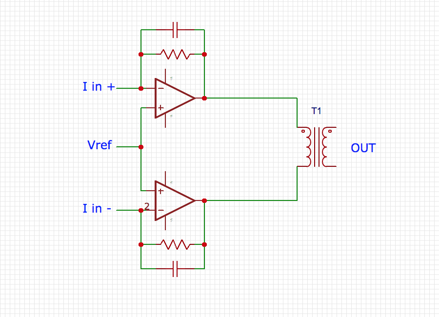

How about a transformer output stage? The transformer can be part of the filter design due to its bandwidth characteristics and also provides isolation. The output can be balanced or single ended. Jensen makes good (but pricey) line level transformers which would work. And for really good performance, I would look at Sparkos discrete op amps.
How about a transformer output stage? ... And for really good performance, I would look at Sparkos discrete op amps.
Hi wtnh, Thank you for the comments and interest.
Transformer output is a possibility. There is more than one way to do that of course, but right after IV stages should be an easy one to try. Thing is good transformers are very expensive, and they tend to add at least a little bit of distortion due to core hysteresis and sometimes saturation. Of course some people like that sound a lot, and one could say that everything has a sound, so take your pick. Opamps probably show the least measured distortion if implemented well, but we should probably use both measurements and listening to make design choices.
Anyway, I have some transformers here I could probably try as you suggest, if I ever get around to it.

Yes, transformers will introduce distortion, but some of the Jensens, like the JT-11-BMCF are spec'd at .002% THD at +4dB. They get this by using mostly nickel in the cores. The downside of that particular transformer is that its bandwidth goes out to 15MHz!!! (so not too useful as part of the filter). The Jensens have almost perfect linear phase response (as in zero shift) in the audible spectrum. Lindahl also makes good line level units but they are even pricier.
Anyway, looking forward to your impressions of the improved Katana.

http://www.ti.com/lit/ug/tidu672c/tidu672c.pdf
TIPD177 A High-Fidelity Headphone Amplifier for Current Output Audio DACs Reference Design | TI.com
Don't know if eval boards are available for the headphone circuit. If so, it could be an easy way to do it.
If not an enterprising soul can then use this and combine it with possibly the DAC layout recommended by ESS and come up with a nice DAC. Thing is the LAYOUT by TI has been done for you. THAT part and they know that layout is a hit and miss thing, they's done the hard work of layout. The design and traces on the PCB is a big issue if you want the optimum.
An essential read for anyone pursuing the design of the IV section. Best design lessons I have seen in print.
