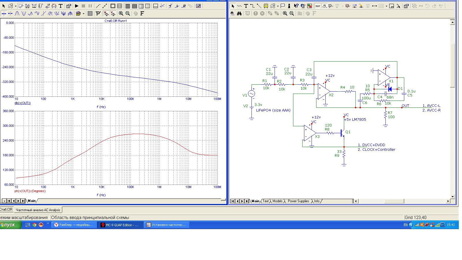

Full schema from post #1146 & 1425
Hi KoAP, Sure, agree it would be possible to use a battery for an approximately 3.2v reference. Not sure that approach would be my first choice though because batteries require maintenance, and do not supply a constant voltage over time as they discharge. Of course, the good thing is they are not affected by power supply noise. However, something like LTC6655 can work really well and is probably even better than a battery to my way of thinking about all the trade offs.
There is something curious about the schematic in your post though, which is that I am wondering what the opamp with the diode connected to it is doing for the circuit.
longimanus, Yes, I am also well aware of OPA1612. I think the main reason they are being used instead of LME49720 or LME49860 is because they can supply a little bit higher output current which is necessary for use with ES9038PRO. Other than output current, however, I don't think they are superior to LME49720. Also, LME49720 can supply enough current for use with ES9038Q2M. That being said, you could use either type of opamp if you want.
Regarding the other couple of issues you mention, please let me respond to each one. (1) The only reason they say THD is better with higher output swing is because less of the output signal time is spent down near ground where opamp distortion is higher because of their internal opamp cross over distortion. But that distortion is produced at every zero crossing which happens all the time, so it's always there. That is one of the drawbacks with using opamps. But, low average THD per cycle, or per zero crossing, in one stage is not necessarily the best choice in a multistage circuit. For example, the gain structure that results in less noise may be better in some ways than the gain structure than results in the least average THD per cycle of audio output in one single stage. In fact, ESS does test their recommended circuits for lowest overall distortion and noise measured where the signal comes out of the last opamp. To get the best performance there, I believe the I/V stage part of the circuit is better run at a little lower voltage swing.
And, (2) 1.65v is used as an offset because it is about 1/2 of AVCC, which would be the quiescent operating point of the two differential output signals for each dac channel. When there is zero output from the dac, each output from the dac should be offset to about 1.65v (exactly 1/2 AVCC, actually).
In addition, each of the two balanced dac output signals per channel have a lot of common mode noise and distortion on them. We need to remove the common mode signal and only keep the differential signal. For that reason we use two 1.65v offset virtual ground I/V converters to first convert the offset differential current signals to voltages, then take the difference between the two.
At the same time as we are doing the above processing with the dac output currents, we need to finish reconstruction filtering and remove RF leakage that also comes out of the dac outputs. Using opamps that are tolerant of RF is a good start, and LME49720 have a higher open loop bandwidth than OPA1612, likely allowing better behavior at high frequencies above audio which are present along with the audio signals.
In addition, the simplified dac output filtering shown in application note simulations fails to take into account the need to filter out RF above the frequencies where the opamps actually have enough gain to work like we usually expect from opamps. For best sound quality results including as the power amp and speakers may be affected, we should have some passive filtering sections in the output stage in addition to the active filtering given by the opamp sections. In short, empirically we tend to find that more thorough filtering often results in better sound quality coming out of the speakers. For the above reasons, the output stage schematic I will recommend using will include more than the theoretical minimum filtering that would be needed if reconstruction filtering were the only concern.

Markw4, if you compare the amplitude- freqency response of the circuits in the post #1146 and #2468, it will be clear for what opamp with the diode.

I guess that this is what might happen at the end - two identical circuits with both types of op amps.. if I have enough timeThat being said, you could use either type of opamp if you want.
Now there's the thing. The Vout range of the DAC = k.AVCC, where k is a little < 1 (value stated in the datasheet, don't know if I'm allowed to cite it publicly, although it is widely available), or somewhere around 3V. Let's assume that the zero out is AVCC/2 (this value has to be generated inside the DAC, before the output, right?) then the maximum + swing should be VoutP-P - AVCC/2 = k.AVCC - AVCC/2 ~ 1,35V. That would make the usable P-P output ~ 2,7V and leave a dead space of ~ 300mV. That makes the next question more important. (Please, tell me where I've got my calculations wrong)When there is zero output from the dac, each output from the dac should be offset to about 1.65v (exactly 1/2 AVCC, actually)
If the usable signal therefore reaches at best an amplitude of 2,7V then we could probably use a little more amplification than planned for 3,3V? I can see that in the ESS 'every budget' paper the feedback network is with comparable resistance to what is suggested in the OPA16xx evaluation schematic (2k+), even with higher Zout of the ES9008.

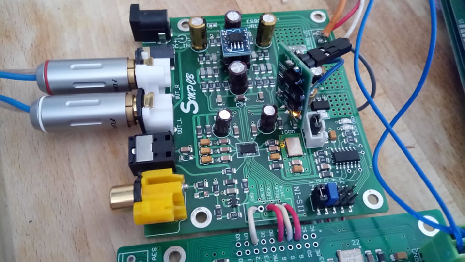

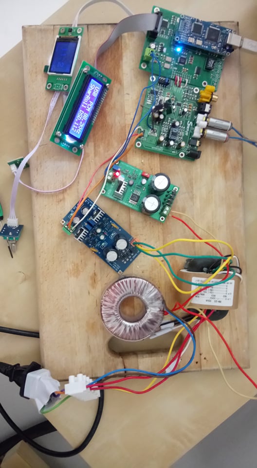

some pics from mine that i promised some time ago![]()
Thanks for the pics! Good to see how the project is coming along. Always curious, I hope it will be okay if I can ask a few questions:
