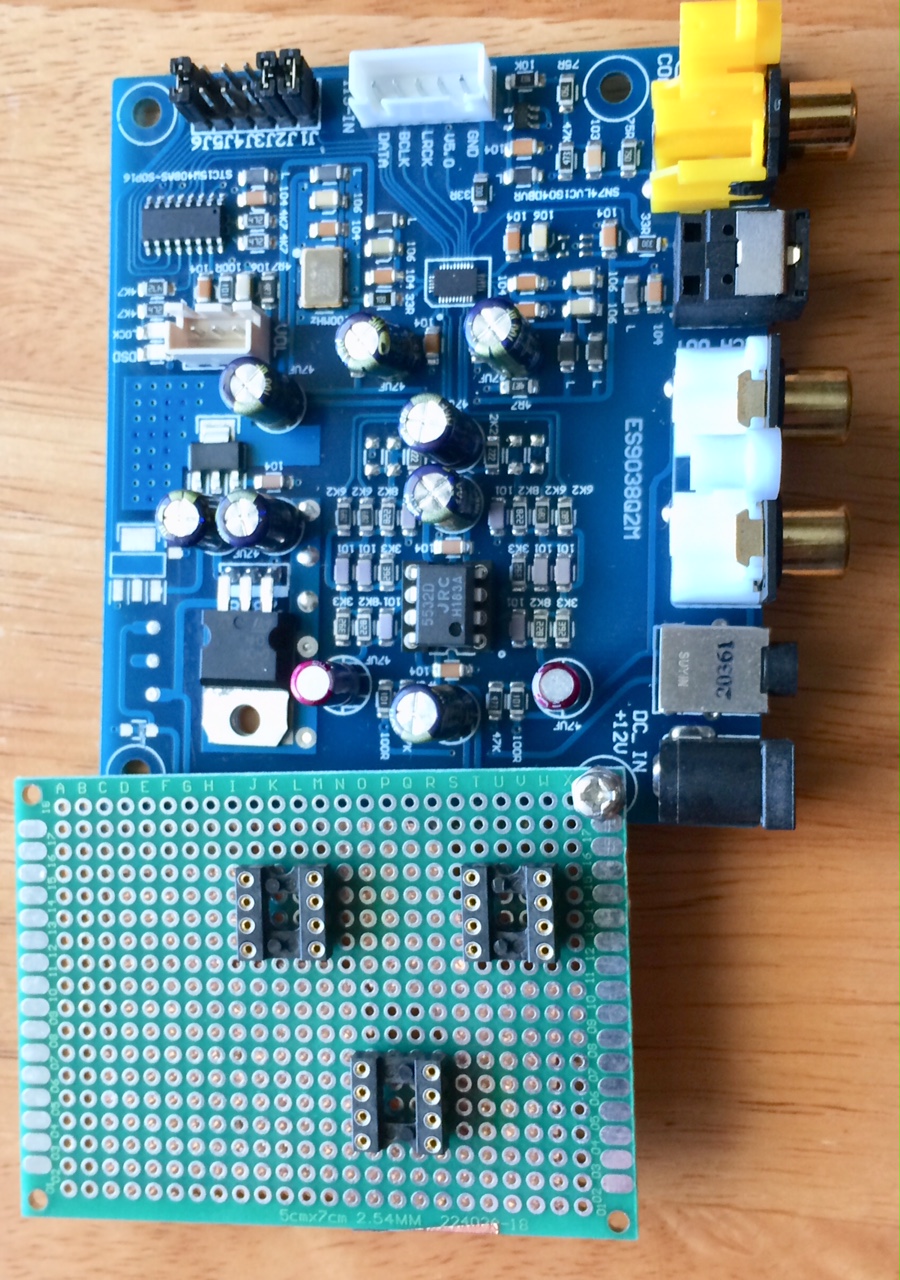

Tomorrow I will see if I can take some initial steps to get working on a though-hole output stage layout. Before I go too far with it though I may want to post some pictures and get a feel for what people think about the level of difficulty for some different options. For example, when it comes to AVCC it would be nice to have the option of using an LT6655. Unfortunately, it is SMD and rather small SMD at that. However, it should work okay on one of those little SMD adapter boards various people make. Another example might be that the existing dac board output stage opamp socket and SMD component solder pads could be reused for differential summing and filtering after through-hole I/V stages. Would that be something people would be okay with, or do they need through-hole differential summing to go with the through-hole I/V?

Okay then, my preference would be to reuse the existing output stage real estate for the new differential out as I did on my own modded dac, but with better filtering.
As far as the I/V part goes, that would take two dual opamps, one for each channel. If a through-hole differential stage was wanted it could go next to the I/V opamps.
Two pictures below show a quick and dirty mock up of an external output stage with enough space on it both I/V opamps and for the differential output, which would be the third dual opamp.
On the bottom of the board is a conceptual mock up of a ground plane connected as an extension to the existing dac ground plane (note: there are some missing gaps in the ground plane which should actually be more continuous) . Where the mock up ground plane crosses a power trace on the dac board, that could either be insulted with Kapton tape, or the trace removed.
Anybody have any comments on the general concept?

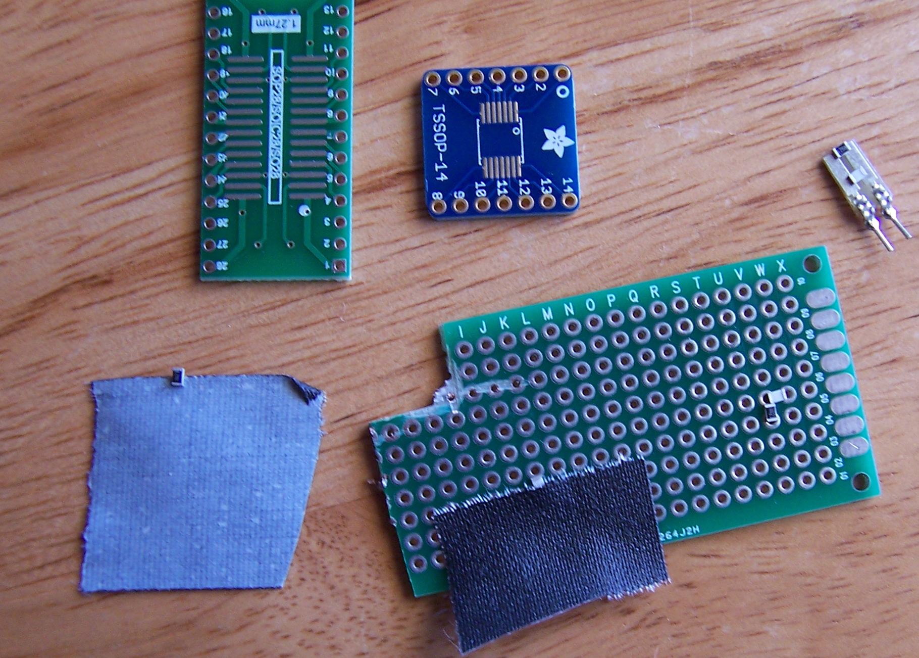

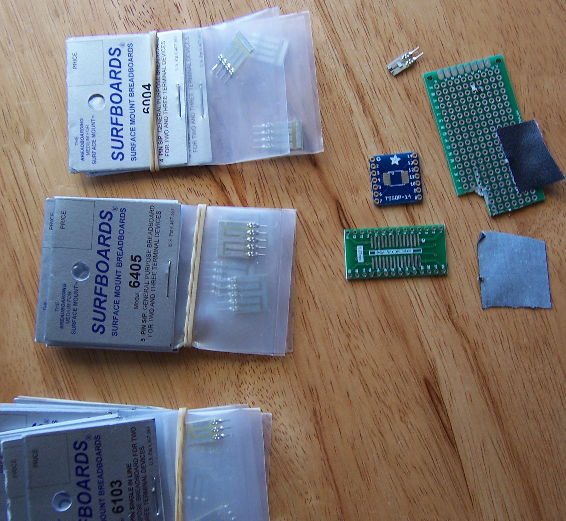

Thought I might see if I could post some pictures of some SMD resistors and give some idea of how to solder them to regular perfboard or adapter boards for SMD. I am trying to show that it is nothing to be afraid of. Just try it with a practice kit or some junk parts to get a feel for what it is like to do it.
Also, wanted to show 0.3mm and 0.4mm diameter solder I use. It is important to use the correct diameter solder. Small joints need small solder and small solder iron tips. Large joints need larger items. In addition, it can help a whole lot to make sure your solder is clean and not oxidized. Just wipe it gently with a paper towel until all or most of the gray color stuff comes off. Then it is ready to give to a good easy joint. It is much harder to get oxidized solder to flow and solder well.
Besides clean, small diameter solder and a clean, small tip (use a clean brillo pad type tip cleaner such as Hakko, get some refills too), the only other issue is how to hold parts in place while soldering. You can tape as I show here, you can put some solder on a pad then use tweezers to bring the SMD part down to the pad and stick it into the molten solder, you can make a gizmo thing like I did to hold down parts. If you have an assistant you can call on as a third hand to feed solder or hold a part with tweezers that can work too. Just figure out what works for you.
Okay, with that do we any comments or questions about SMD like in the pictures below? Does it still look scary? (Please respond otherwise I have no idea what you think.)

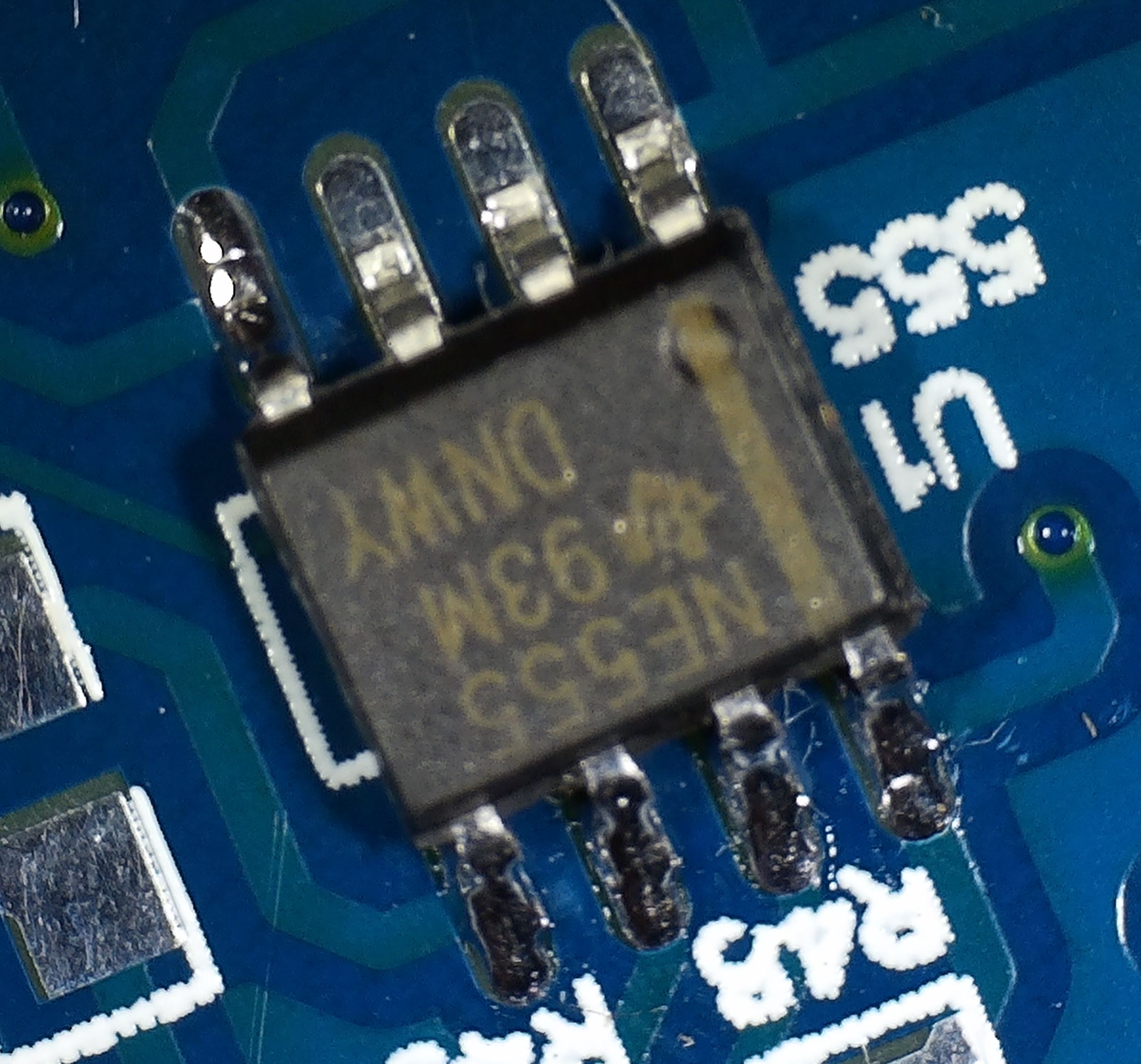

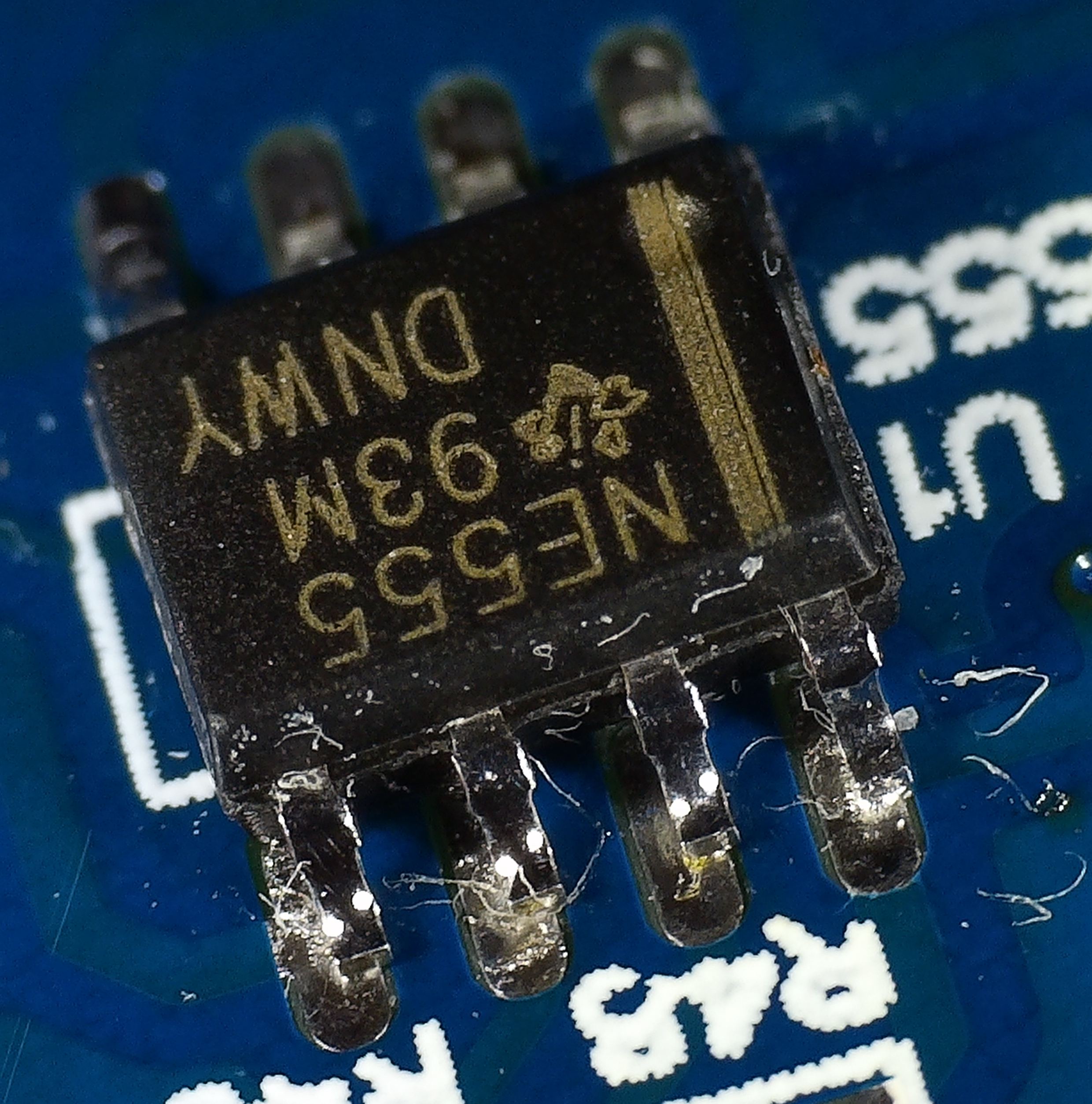

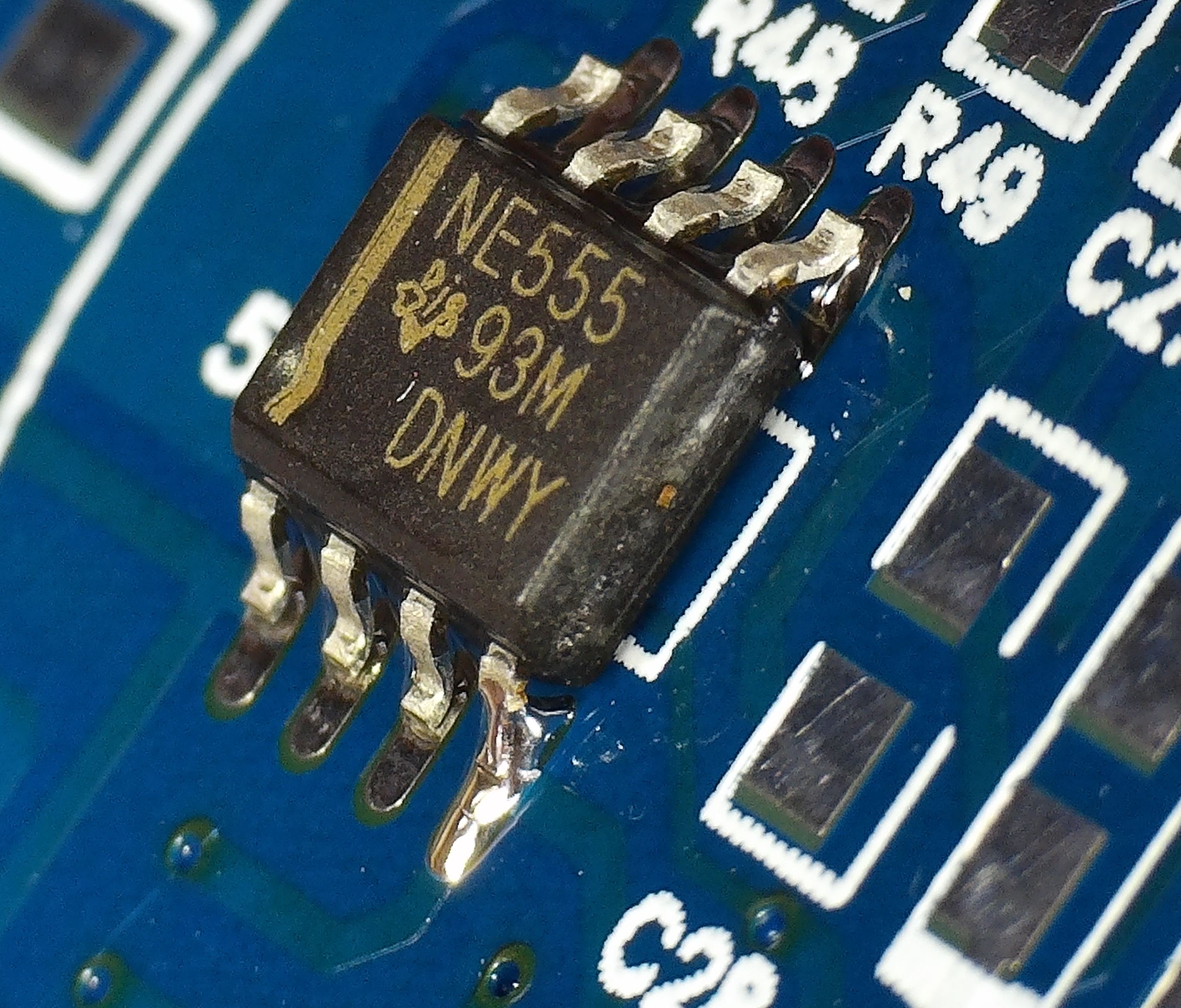

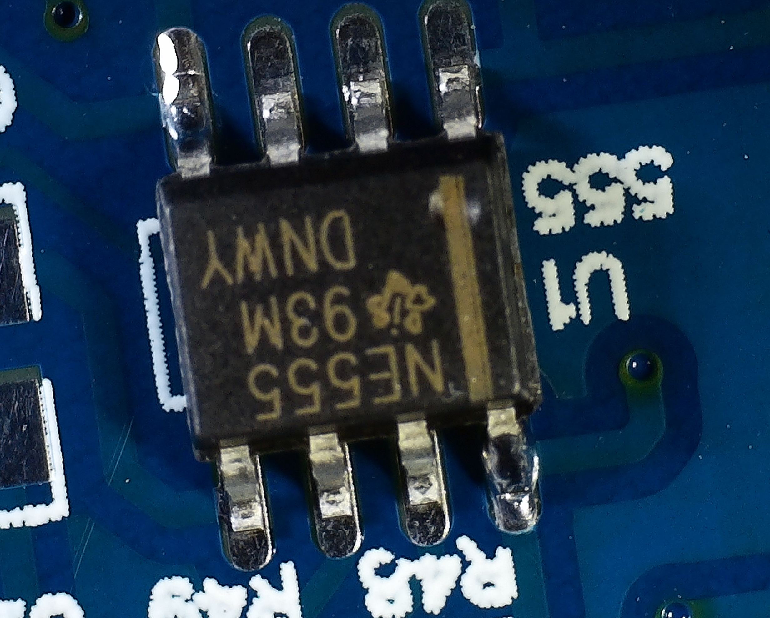

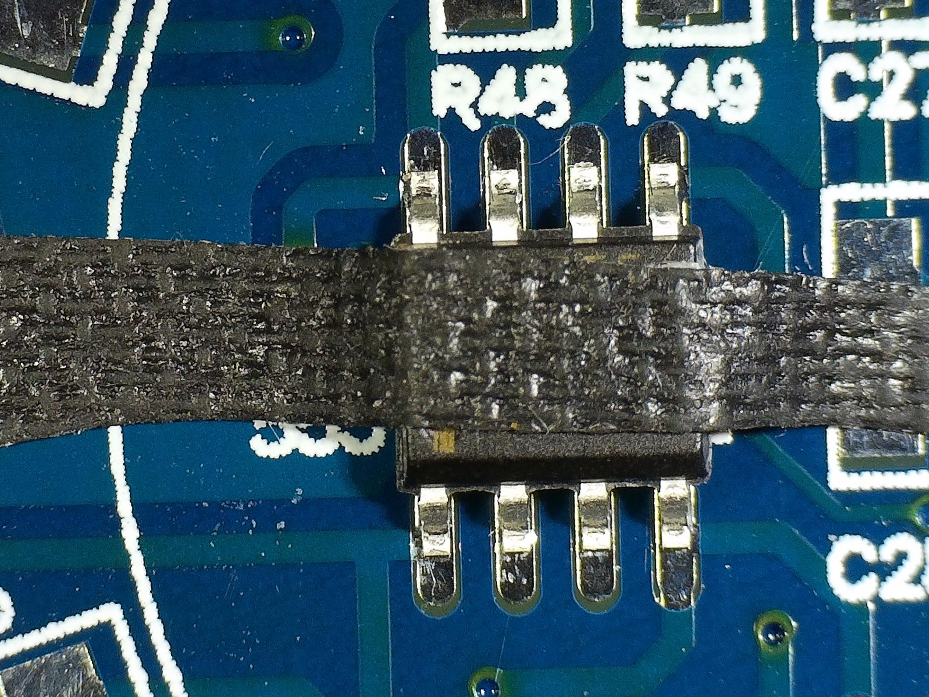

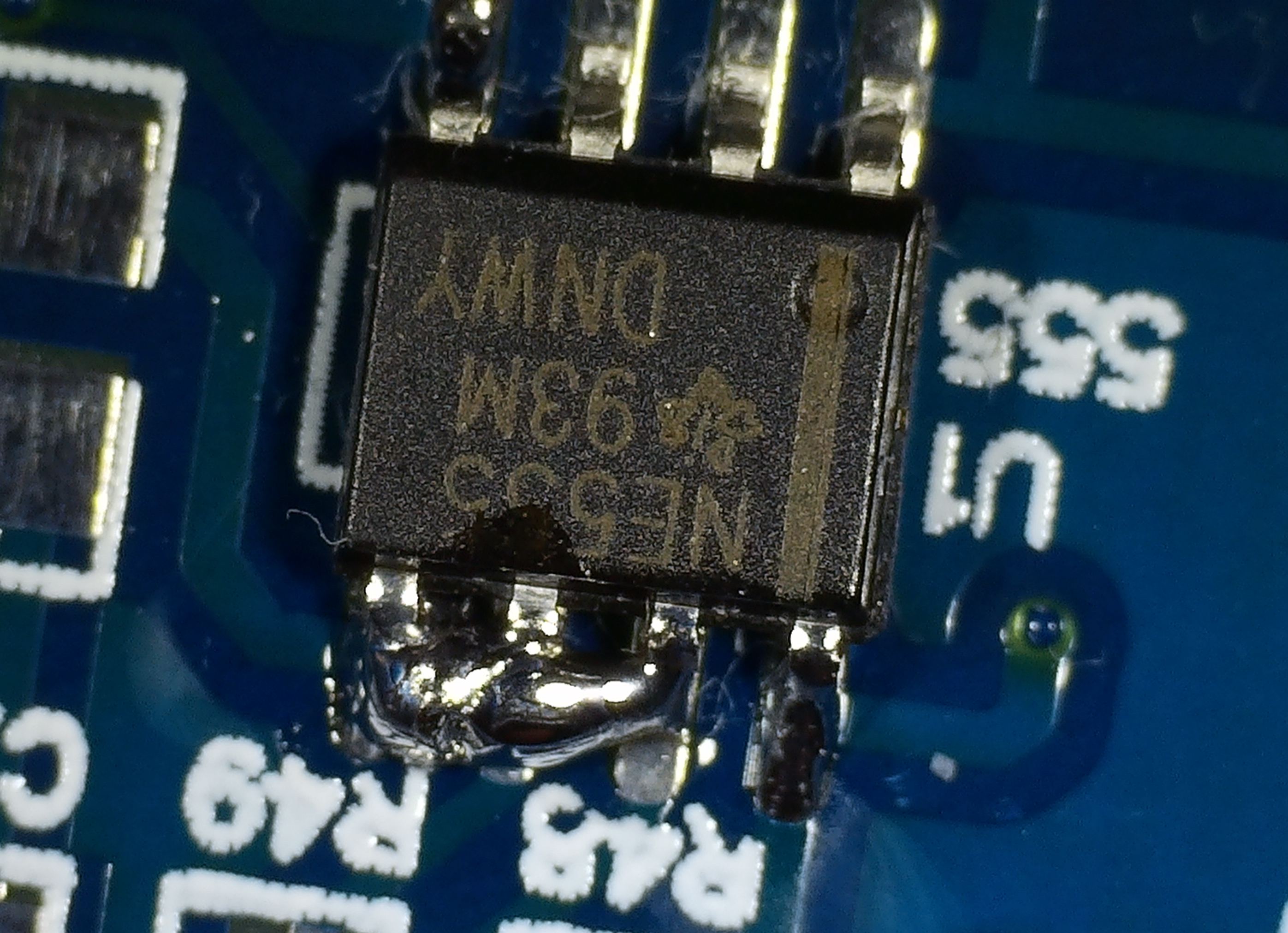

I wanted to show how to solder an IC with multiple pins. The usual way is to solder one corner first, make sure it looks okay and fix it if not okay. Once it is okay with one pin then solder the opposite corner. After that the rest of the pins can be soldered.
To illustrate what might happen and how to fix it, I also intentionally messed up some of the pins, then used solder wick and then alcohol to clean them up. The way I use the wick is to lay it across all affected pins, then use the flat side of the iron tip to heat the strip of wick and all the pins at once. After cleaning them up they were resoldered properly.
