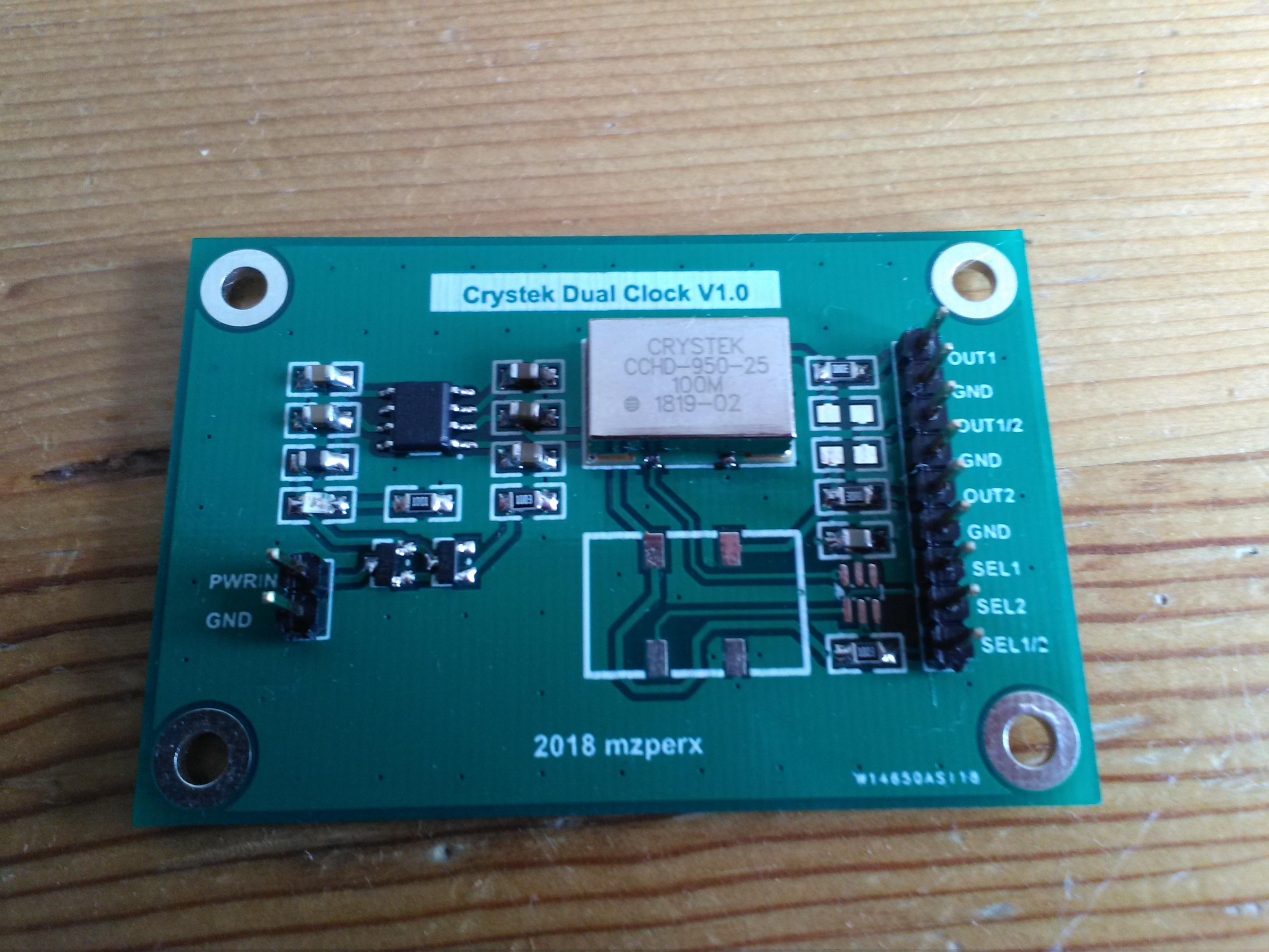

Crysteck clock panel
This is a clock panel planned and soldered by Mzperx. He is a great member of Hungarian diyers community. The 3.3V of the clock is provided by an ADM7150ARDZ ultra low noise LDO. The panel works with external 5-15 V DC. The Crystek CCHD-950-25 is from Mouser. I am going to install the clock panel soon. There is a 33R at the otput.

This is a clock panel... I am going to install the clock panel soon. There is a 33R at the otput.
Thank you for the update on the clock. Looks like a nice little board.
Hope you won't mind if I say that with 100MHz RF, I always feel more comfortable if it is soldered to the dac board right next to the dac chip. But, if enough of the right care is taken, it is probably possible to get very nearly the same results with a clock a short distance away.
Also, with the growing popularity of ufl connectors, I sometimes wonder that we still pipe around 100MHz RF on pin header connectors like it was only 10MHz.
The other thing that I have been wondering about recently and I would like to find out more about has to do with they DIY community love affair with LDO RF regulators and their noise density graphs. I have to suspect that it is the marketing department of LDO manufactureres that wants those graphs included in data sheets and scope traces of actual peak to peak noise omitted. While the noise density at every frequency shows a lot of 1/f noise perhaps from the RF transistor manufacturing processes they now run, noise density still looks very low even at pretty low frequencies like 10Hz. However, we don't really care about noise density at individual frequencies, we care about integrated noise over the band that can affect operation of our circuits. If we integrate the area under the noise density curves we get something much more suggestive of what peak to peak noise actually looks like. Also, IIRC, the Chinese LT3045 module makers used to show a photo of a couple of unlabeled graphs in their ads. One showed a noise curve that rose to about -70dB at LF and other trace was flat all the way down to LF. Well, once I found a bigger, higher resolution copy of that picture, and it turned out -70dB was noise out of the LT3045 down at 10Hz, and the flat graph was showing the accuracy of fit of an equation modeling the measured noise performance (in other words, meaningless). Okay then, -70dB noise out of a power supply might be okay for a circuit that has another 60dB - 80dB PSRR at 10Hz, but not for something with less or no PSRR. The 'no PSRR' category would include AVCC.
But, what about phase noise at 10Hz from a Crystek oscillator? I don't know how RF LDO noise affects that or what the Crystek PSRR down at 10Hz is. Sure would like to see some comparative measurements though.
