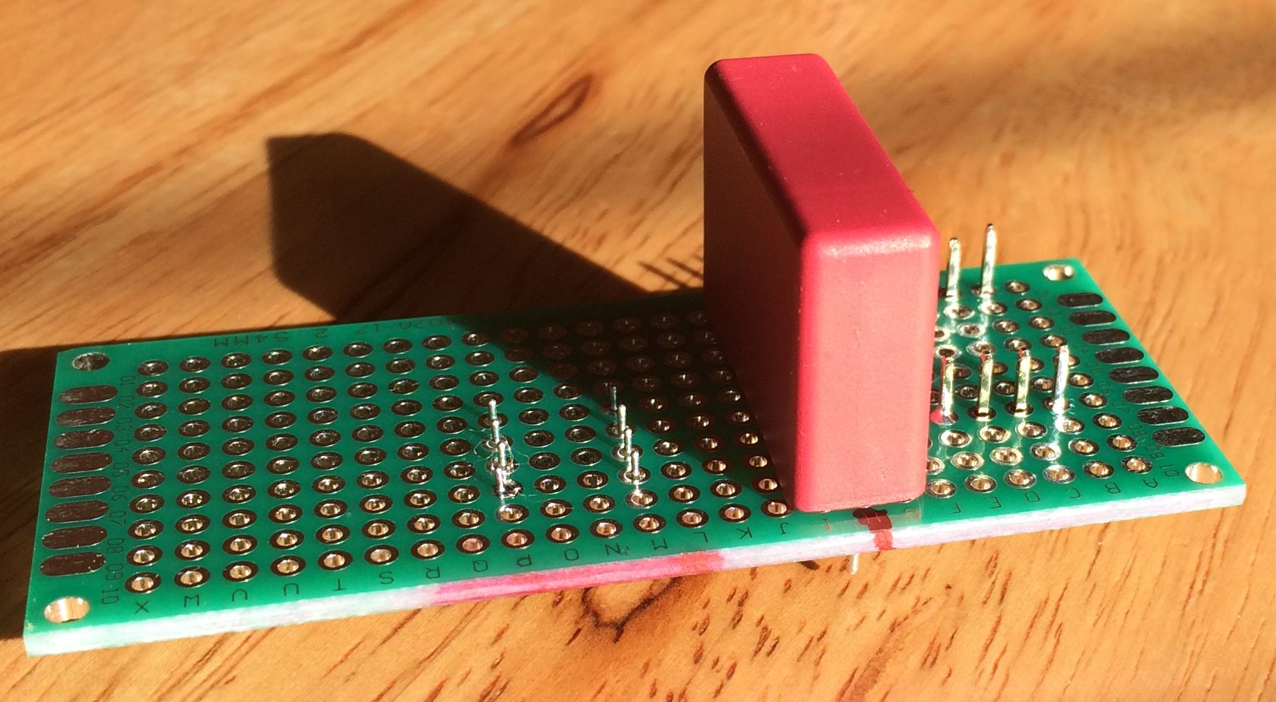

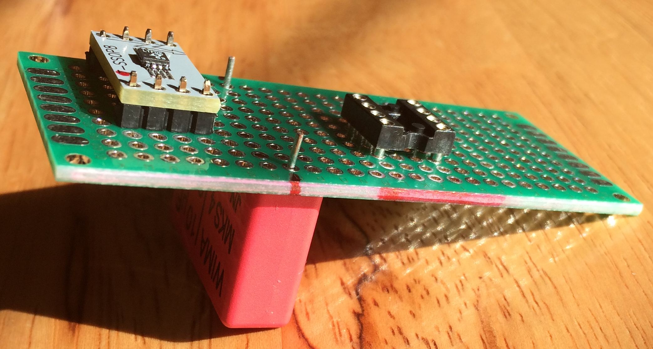

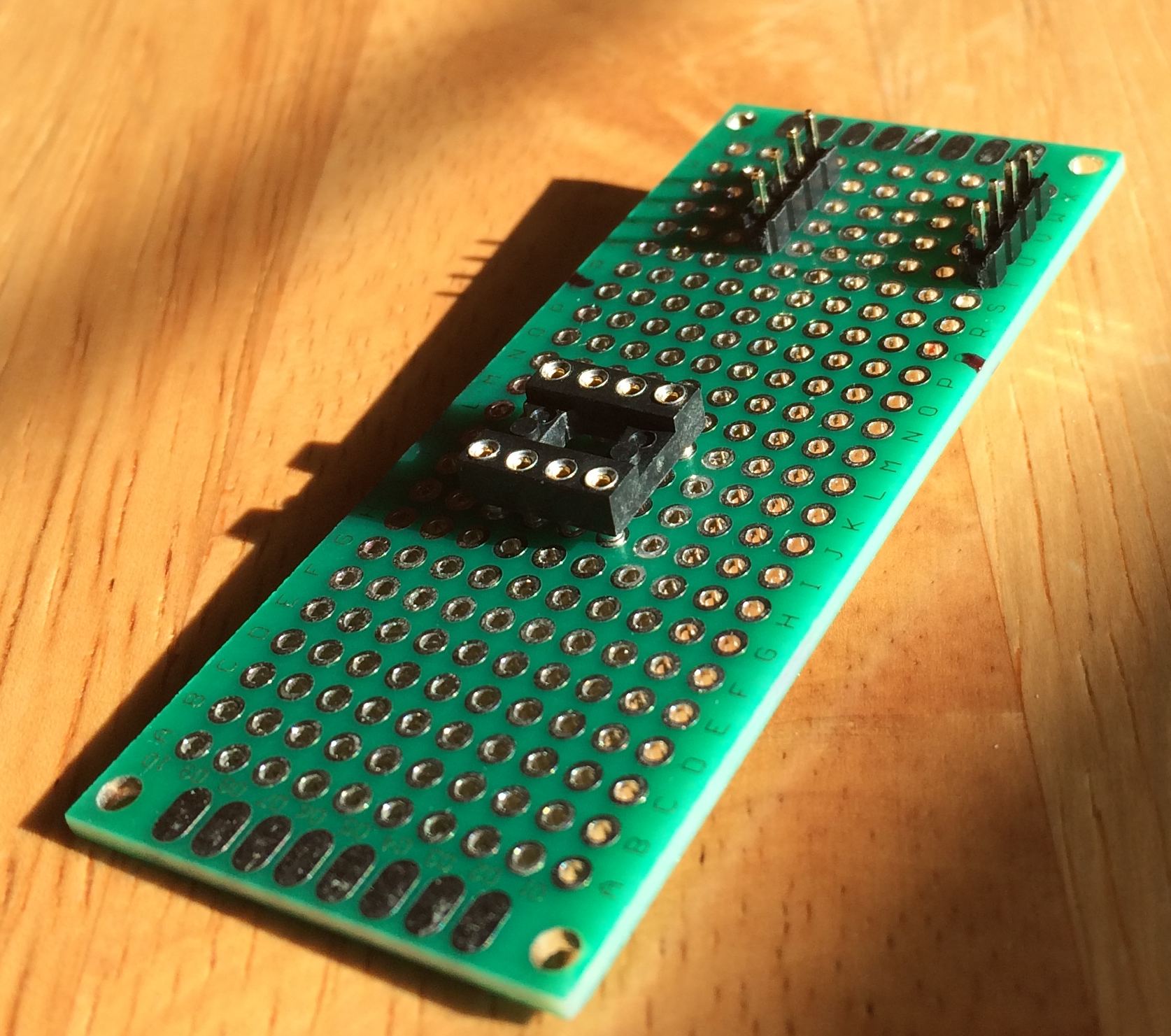

Starting to work on AVCC board layout. This time instead of paper, I needed to play around with the physical board and the major components. What I came up with is shown in the pictures below.
A red line across the edge of the board indicates the approximate area where the ground plane will be connected to the dac board ground plane. There are also a couple of smaller red marks showing where the 10uf film cap leads will go.
Ground plane will run on the solder side of the board again like we did with the output stage board. The ground plane will run underneath the film cap body, so ground plane needs to go in first with notches at the edge where the film cap leads go. There will also be some ground plane run around the edge of the board to fully surround the LTC6655 adapter board.
This time opamp electrolytic filter caps will be located at the sides of the opamp socket rather than off the ends. Thinking about some holes in the the ground plane for where the opamp 10uf input filter cap and 10k resistor get joined together. Also need to figure out what to do with creating the two Vref signals needed by the output stage. I sure would like to use SMD resistors for that, although metal film could be used too. Have to see what I have in stock because I don't want to place an order for just four resistors.
The AVCC board will be oriented with respect to the dac board such that the AVCC opamp pins point towards the 47uf AVCC filter caps in the dac board and also point at the output stage board. It will be located right next to the 47uf filter cap pins.

Hi Deenoo,
The 47uf AVCC caps in my existing modded dac board are Panasonic Aluminum Organic Polymer, part number EEH-ZK1E470R. They are actually intended to be SMD, but I removed the plastic spacer on the bottom and straightened out the short leads in order to solder them into the cap mounting holes.
Thing is about those caps is I decided to try them because they are 47uf like ESS specified, but low ESR. I don't know if they are better or worse than other capacitor choices for AVCC. I figured if there were any problems I could try some other ones, but I never got around to trying any others. Although my AVCC on that board seems fine and produces bass with the same balance to other frequencies as DAC-3 and Allo Katana, I don't know if other caps might have made the job easier or performed better in some way. For that reason, I am still open to trying some different caps to see if any difference in SQ, or anything else.
Speaking of Katana, I think I mostly know how they designed the AVCC supply for it, and it is very different from the opamp circuit ESS recommends. Sometime later when I write a review of Katana I would like to describe how I think it works in more detail. Maybe describe some other things of interest to the group as well, since we are a pretty technical bunch and may have more than average interest in such things.
In the meantime and since we are using the opamp circuit for our dacs now, I think it would be fine if people want to experiment with different caps. It's just if they do they should follow through to swap them out and make sure they actually go through with some testing. If they don't want to get into that, then using the ones I used before worked okay then and will probably work okay again.
That being said, I was thinking of trying some slightly different ones this time, but no final decision yet. They are still polymer, pretty similar to the ones I used before, but intended to be through hole. They may be different in other ways too, I will have to look at the data sheets.
If I wanted to try a bigger change compared to last time around, it would probably be some good quality standard aluminum electrolytics. They might work okay too.
For more extreme testing, I also picked up some very low ESR super caps. Never used any of those before, so that would be a whole new experiment to play around with. Might not use the opamp circuit anymore in that case, have to think about it some more and or maybe just try it to see.

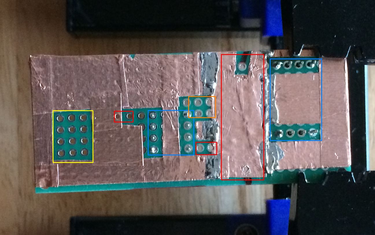

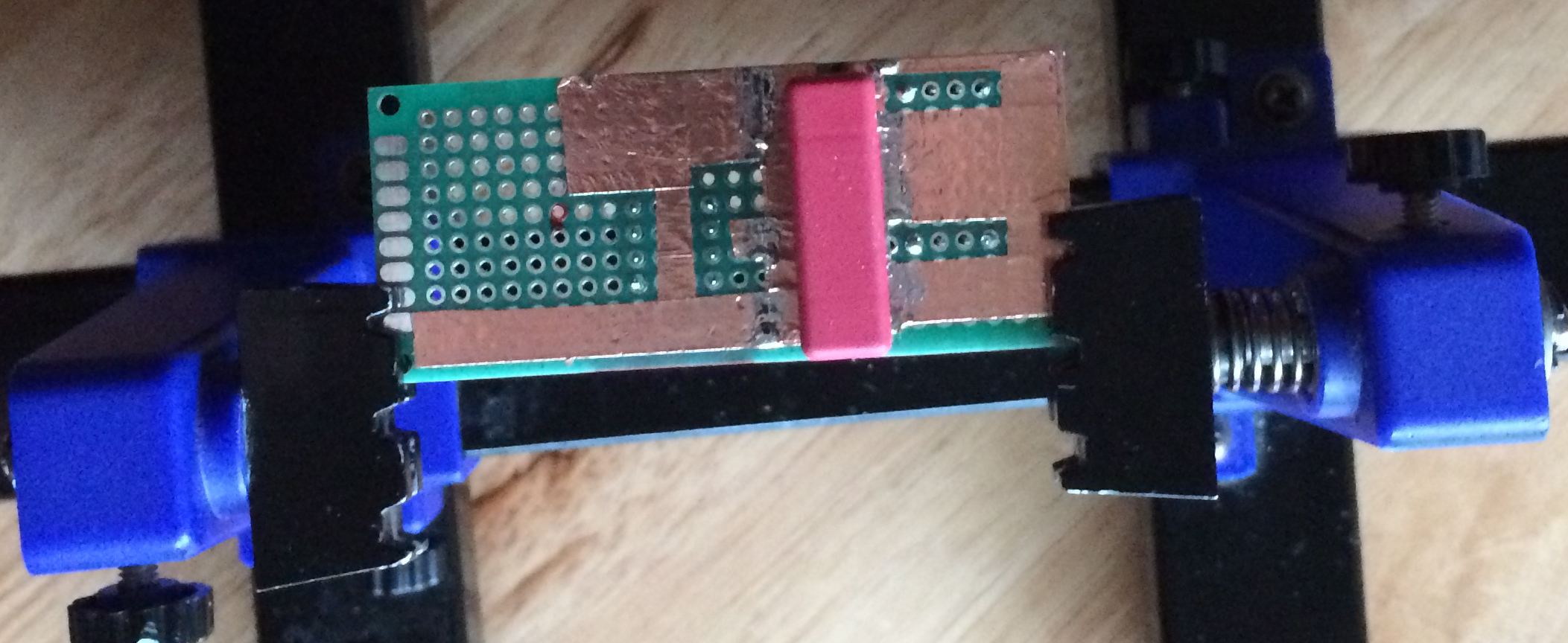

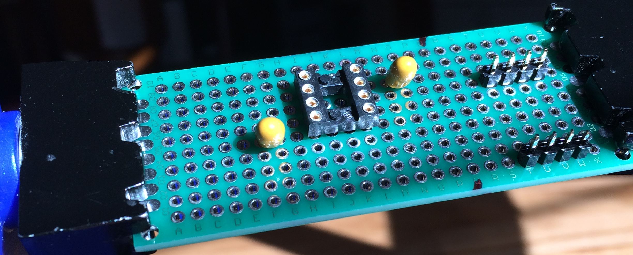

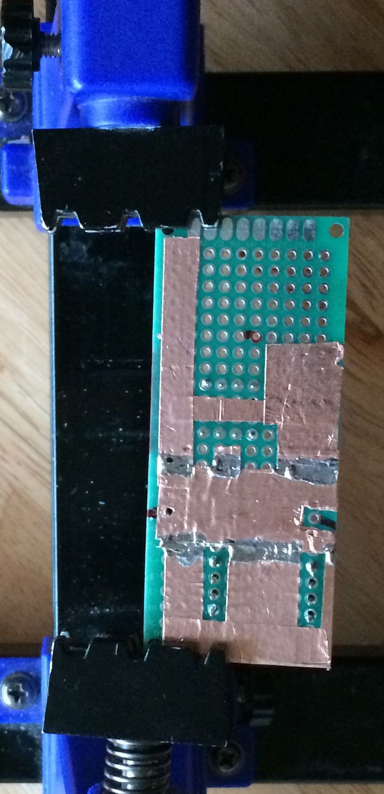

More AVCC board progress. See pictures below.
Pics show bottom side of the board which will point towards the output stage board. The big 10uf film cap will stick out on this side. Other components go on the other side.
Third picture shows color outlines for various parts of the circuity. Blue areas are for the opamp socket and LTC6655 adapter board mounting header pins. Red is for the big 10uf film cap and the electrolytic opamp decoupling caps. Orange shows a few holes I left open for soldering together the opamp input filter, and Yellow shows where the Vref dividers and filter caps go.
