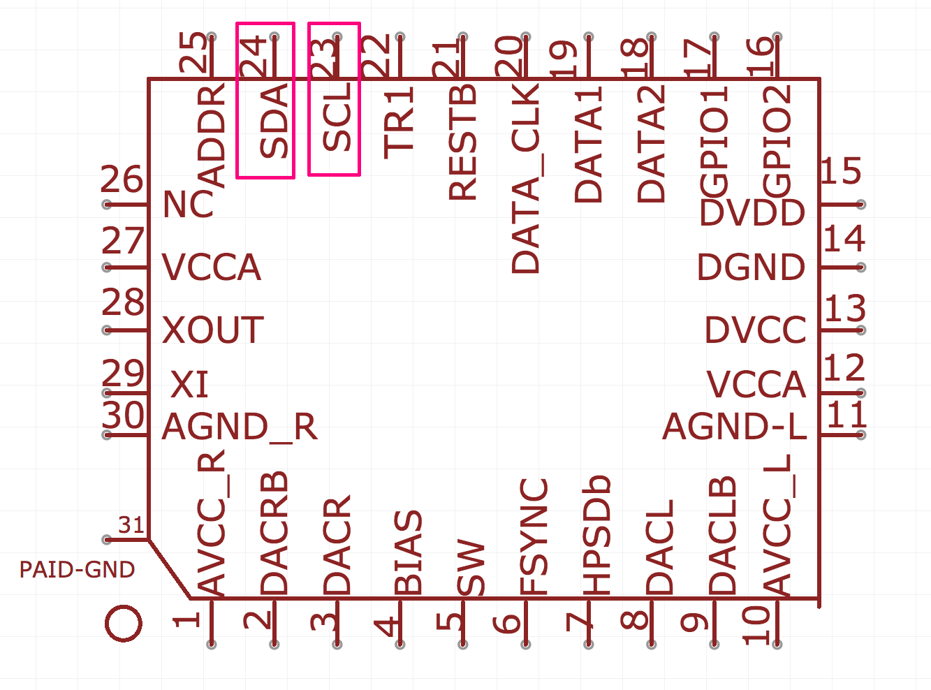

If you plan to test few registers values , you can act as multimaster i2c , no pin lifting is required , once booted , the microcontroller is polling the ess chip on a regular basis, you can send I2c commands between polling commands . since I2C is based on open collector IOs there is no electrical risk.
I've been using it to dump all the ess9038 registers 🙂
Hi occip,
Thanks for the tip. I know I2C is supposed to work that way, assuming the dac microcontroller is coded properly, an unknown when I started. The other implication is that without pin lifting one can't set the dac registers in a way contrary to the way the dac microcontroller sets them, otherwise it will just set them right back where it wants them. However, I found that the registers I usually want to change such as DPLL bandwidth and harmonic compensation are not accessed by the dac microcontroller code, so no conflict there.
Since you say sharing the I2C bus works fine, I think we should try it that way this time. It sill involves attaching wires to the I2C bus which is likely easiest to do at the dac board I2C pullup resistors.
When I do an I2C mod on the dac I am modding now with through hole component boards, I will try it your way and take some pictures for any others who would like to see.
Or, maybe if you have pictures of yours you could post some info to help terry22? Otherwise, no problem I can do it when I get to that.

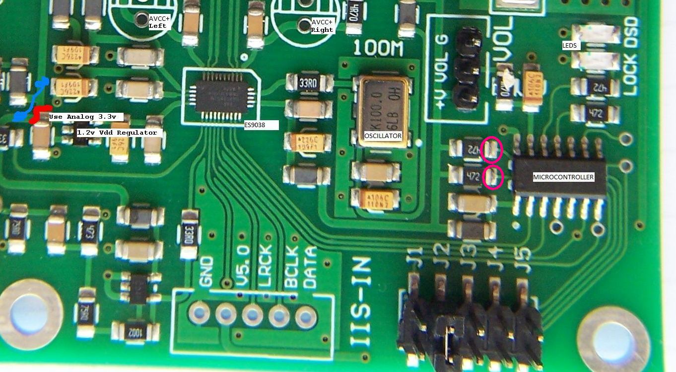

Regarding I2C connectivity as occip has described above, below are pics showing the I2C pullup resistors on the dac board where wires would be soldered on to connect to an Arduino (points outlined in red). Also, shown is a dac pinout diagram with associated pins outlined in red. The dac chip pinout diagram needs to be rotated 180 degrees to be seen from the same perspective as the dac board pic.

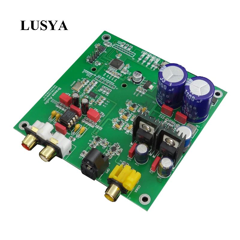

A new ES9038Q2M dac board arrived today. See pic below.
More junk, unfortunately. Looks like maybe they have plans for display and user controls for some later version. Right now there is only a button to change inputs, no other controls not even for volume.
There are 7815 and 7915 linear regulators for the opamp, but the other stuff is powered through a maybe 5v (or maybe 8v or so?) switcher, that then supplies input power for some individual linear regulators. There is a 3.3v linear reg for both AVCC channels and VCCA. Only small SMD bypass caps at AVCC inputs, no electrolytics. Another 3.3 regulator for the other dac chip digital and the clock, and one more reg for the SPDIF and TOSLINK digital signal amps. There is also a bigger 3.3v (or maybe 5v) regulator for the MCU, which looks way oversized for its current job.
There is not ground plane under the opamp and the only ground return from that area is a long trace that connects to the ground plane for all the rest of the board back at the +-15v regulators. Guess they think the opamp will remove any common mode noise between the opamp and back to the dac outputs. Not likely very well with 100MHz clock and a 5532, given what I have observed so far about these Q2M dacs. Not like ESS says to do it either.
Anyway, looks like it would need all the same mods as the other boards, plus the addition of a volume control, and ability to select the dac filters. Junk! is what it is.
