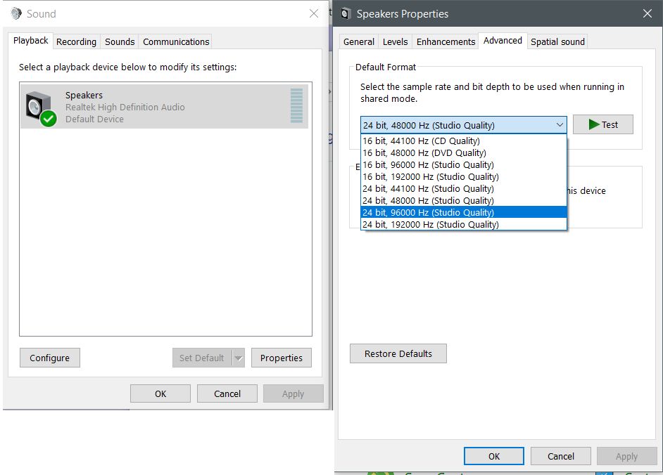

Something else I have been thinking about mentioning is not new, but it might be new to some people. It has to do with modern computer operating systems and intersample-overs.
It turns out Windows, MacOS, and possibly Linux by now, have multi-client audio systems so that multiple programs can access the default sound device at once. The complication arises because a sound device such as a sound card or XMOS board and only operate at one sample rate at a time. Therefore users may set the sample rate and bit depth they wish the OS to use for all audio output at all times that is to be routed to the default sound device. To make it work the OS has to perform real time sample rate conversion to any sound streams from applications that are not set the the default sample rate and bit depth.
In Windows for example, there are sound card settings in the Windows control panel for each sound device. Please see the screen shot below. If a device is set as default, the sample rate Windows will use can be set as seen in the picture. The problem is that the sound quality of SRC is not very good, and with a good dac one can easily hear that the sound is not up to the quality it should be.
in addition, on the Level tab, the maximum level for the device can also be set. For modern dacs that use ASRC, and or if upsampling to DSD is being used, it should help lower distortion by reducing the output level by 3.5dB per resampling event that is anticipated. That might be overkill, as it is a very conservative estimation of what might be needed. One could listen to a loud highly compressed CD playing, turn down the level 3.5 dB or more and see if more than 3.5dB seems to help very subtle low level distortion at all. If you can't tell if more than 3.5dB is needed, it would probably be good to leave it set there. I find setting the level in Windows at 92 or 93 out of 100 seems to be needed so I don't notice any level related distortion.
Regarding what to do when playing music to avoid unwanted resampling by the OS, if there is only one sound device then it would be necessary to set the default sample rate and bit depth for whatever music is to be played. In theory, there are some checkboxes to allow sound card device drivers to grant control of the sound card settings to one app, but generally speaking nobody seems to be writing device drivers that can use that feature. So, it means manual selection is required.
Since the above is a very undesirable state of affairs for playing music of arbitrary sample rates, the best solution seems to be to have more than one sound device installed in the computer and set the one that you don't intend to use as default. The other thing is to install an ASIO sound driver for the sound device that you do want to use. If there is no specific ASIO driver available then the ASIO4All universal driver can be tried. The last part of allowing apps to set sound device sample rate and bit depth requires that the app itself can be configured to use the desired sound device with the ASIO driver.

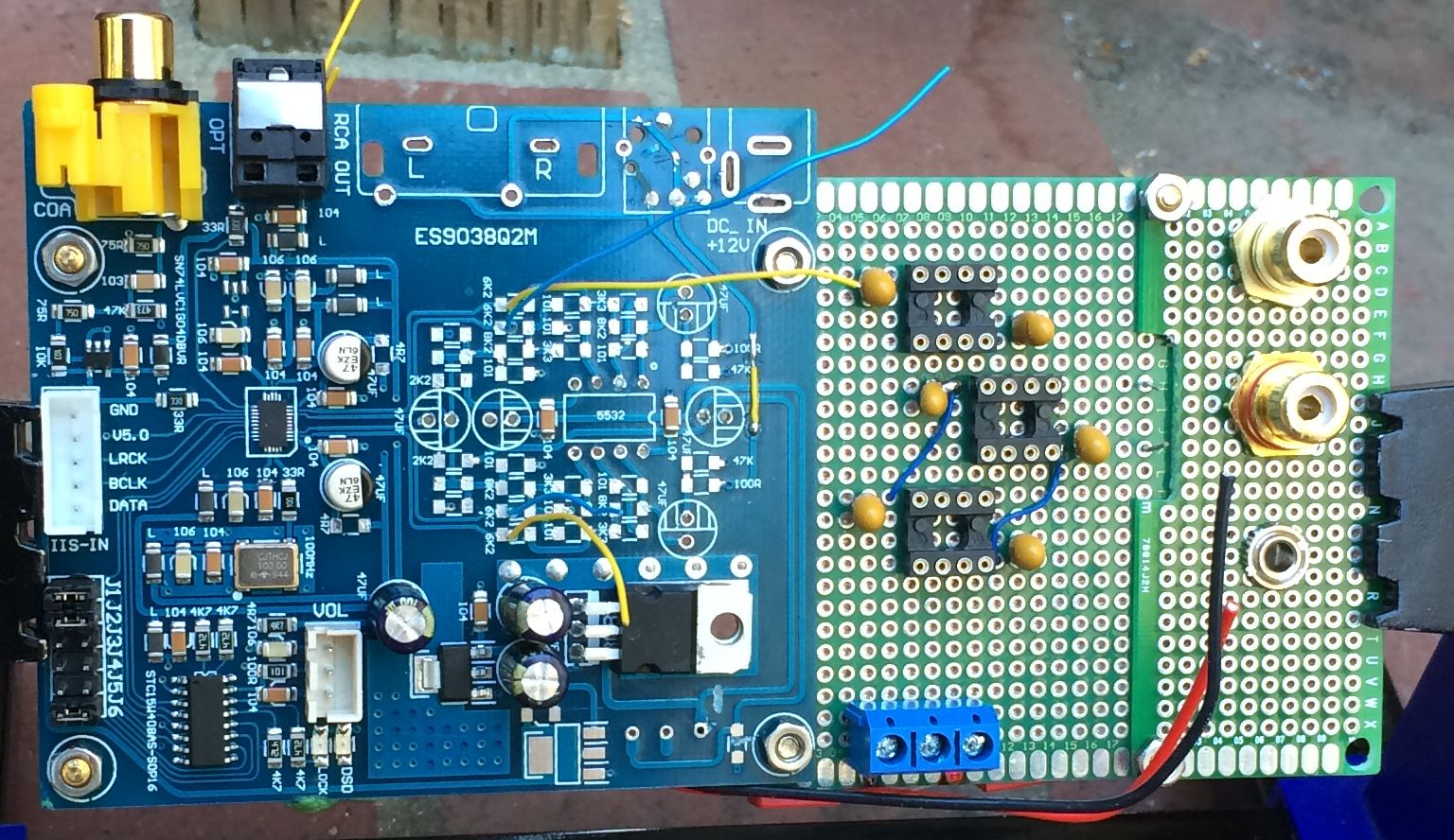

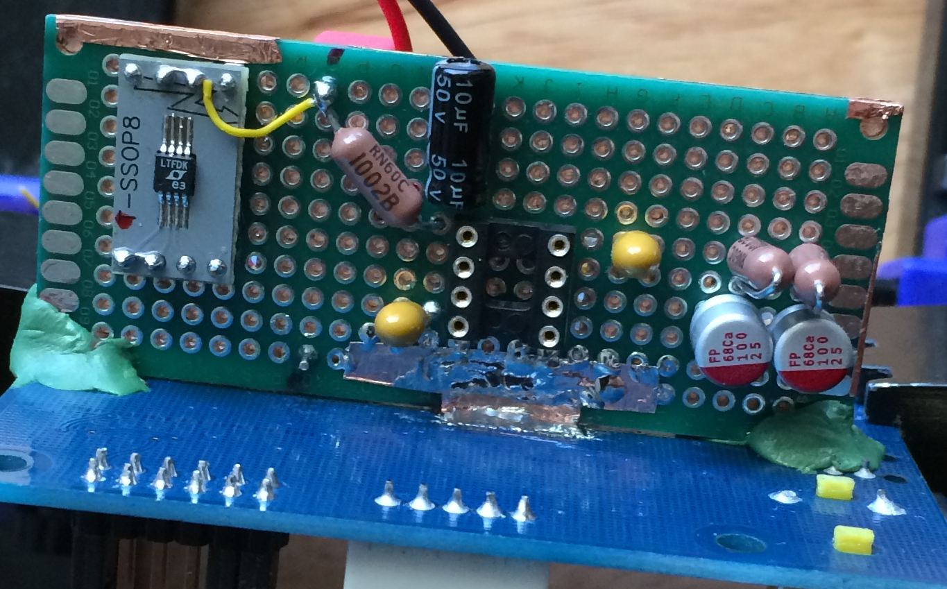

Not much activity going on around here today, so I thought I might post a couple of pictures showing how the through hole project is coming along.
Since I removed the original output connectors, I decided to put some new ones down at the end of the output stage board. Another 10-15 wires and this part should be done enough to test.
Also decided the holes for the +-15 power input connections on the dac board are too small, so I moved where power comes in to the output board.
After testing the through hole board mods, that will leave a clock mod, I2C mod (occip type), and maybe some local voltage regulators for the clock and or VCCA (maybe one for them to share, not decided).
Also, pretty soon I need to get back to writing AVCC board instructions, although it seems pretty obvious without instructions from the pictures and the schematic (after doing the output stage board first), doesn't it?
Hope things are going well for everyone else.

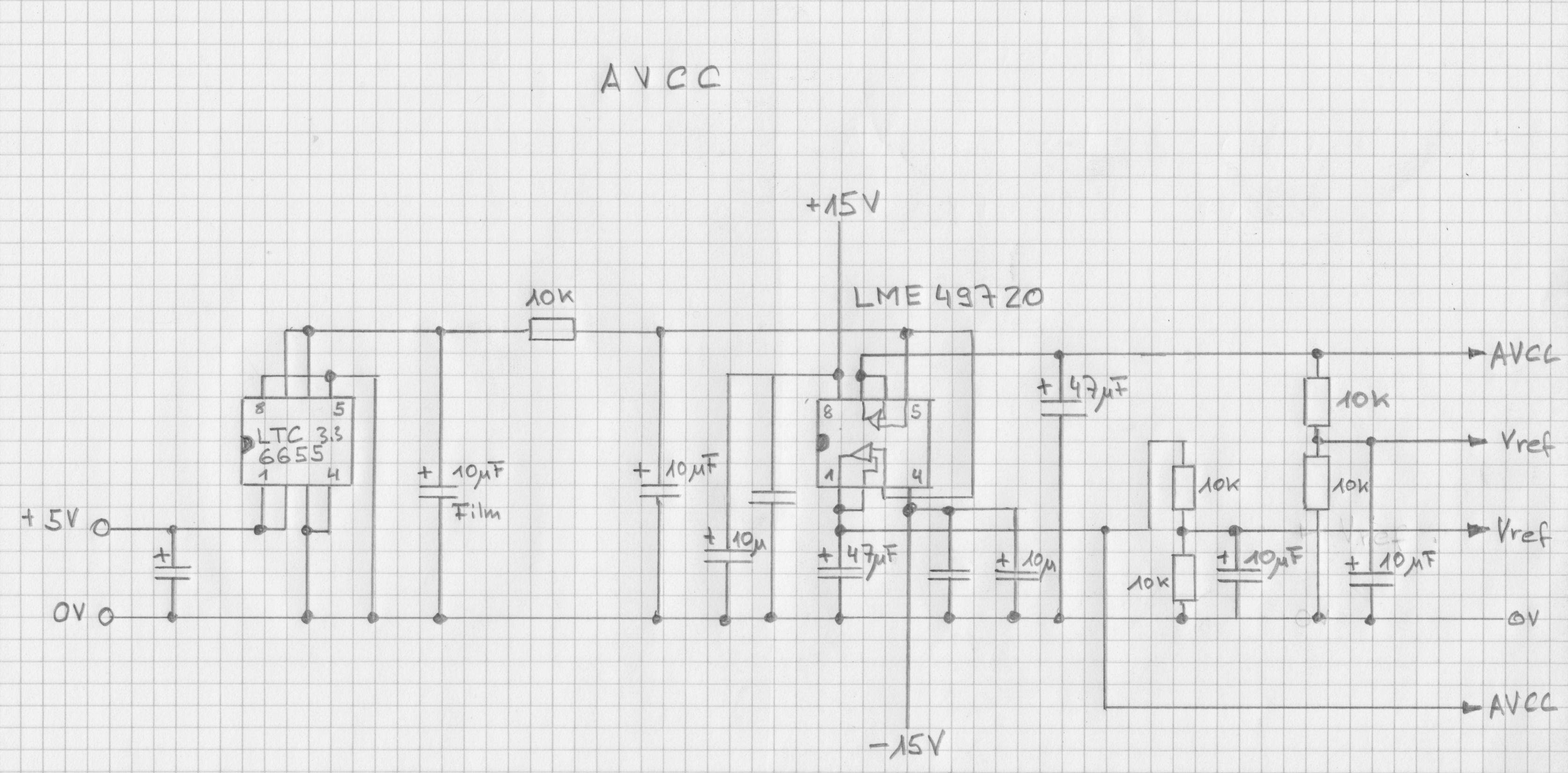

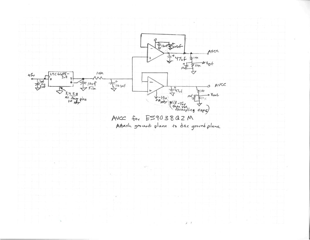

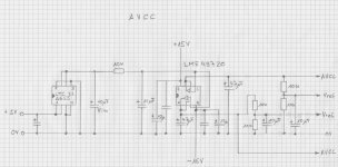

Hey Guys,
Question for you if I may. Those building through hole component board mods, after looking at the output stage board and seeing how it is constructed, do you think it is still necessary to have the same type of instructions to lay down the copper foil and solder parts in place, given the pictures and schematics attached below?
If building the AVCC board after the output stage board, it should be easy to do AVCC with less instructions, it seems to me, but maybe not to other folks. I don't know.
However, if one were contemplating building the AVCC board first, I guess without the experience of doing the output stage first, then more advice might be needed for AVCC? What do you think?
If it is needed for me to do it then I will do it, but being a bit lazy I wouldn't do it unless people still feel it is needed.

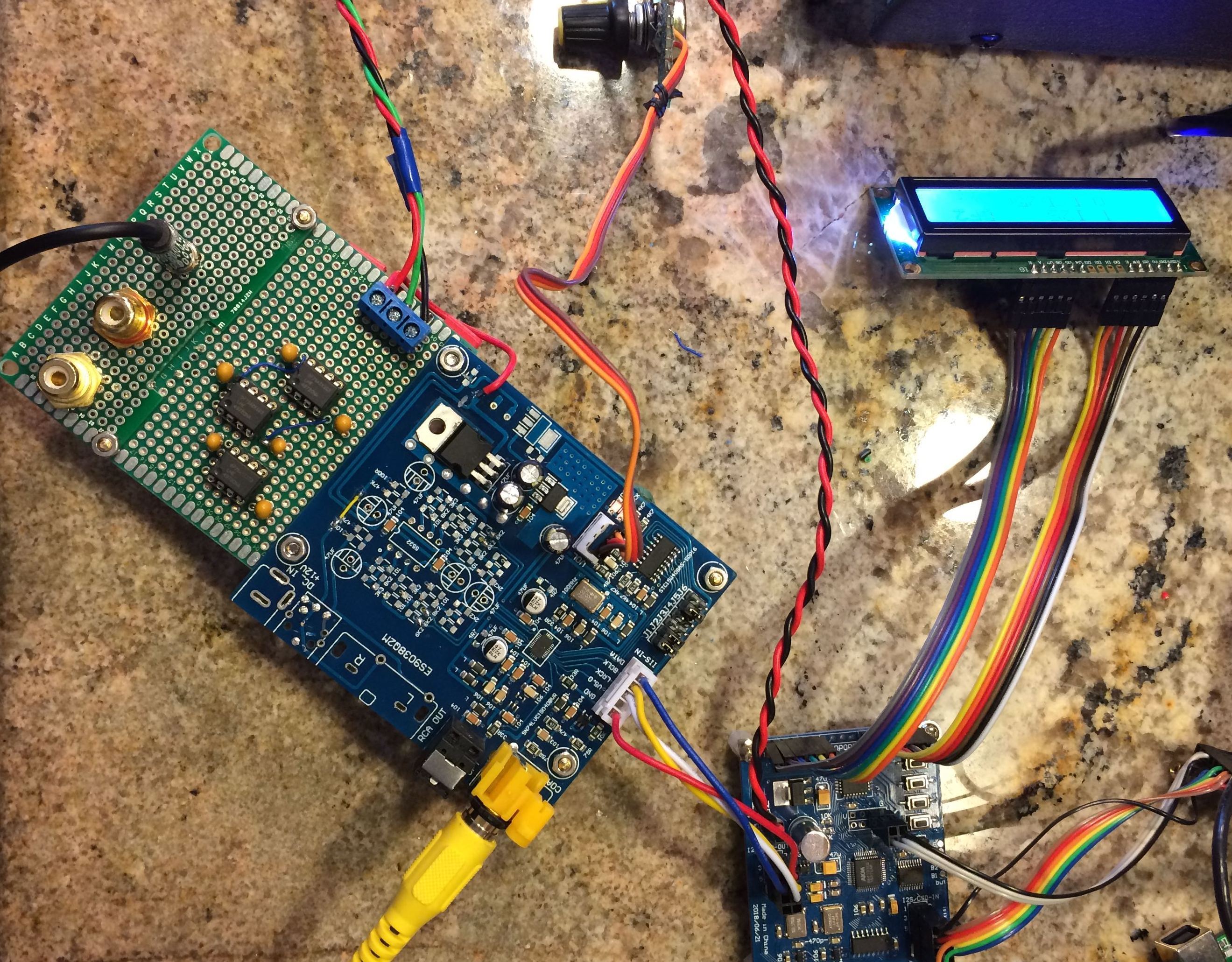

It works! Sounds pretty good too, even before the clock and occip I2C mod. It needed the upsampled DSD though, which makes a big difference. First I tried 16/44 SPDIF and too much distortion.
Also wanted to mention I noticed bih included an AD797 opamp in the BOM. Those might be good for the AVCC supply, but they are single opamps, not dual. So, if anyone wants to use them or try them, one should plan accordingly. There are little single to dual opamp adapter boards. One of those could hold two AD797 opamps and then plug the adapter assembly into a dual opamp socket like we use for LME49720. If the AD797 opamps don't mind being on the adapter (they don't exhibit any instability) then it would be fine to give them a try.
Or, if one knows in advance that AD797's will be used for AVCC, then the board could be laid out for two single opamp sockets.
Personally, I think I will try the adapter board option and give it a try. I'll let you know if I notice any difference.

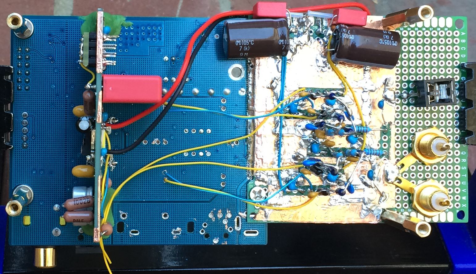

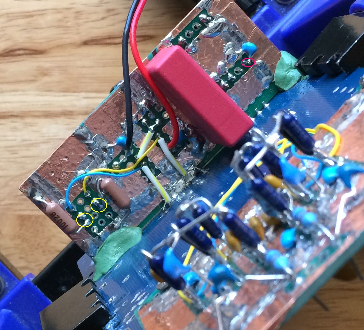

Clock is in. Now it's really getting to sound good. A few more little things and that's about all I know how to do for now.
Strange thing happened just after I soldered in the new clock. There was a short to ground on the 3.3v bus. Figured I must have bridged one of the clock solder joints to ground so I took it back out. Nope. Still a short. Starting cutting traces and removed the 3.3v regulator. Finally found some low resistance to ground right around the dac chip, DVCC maybe. Cut traces to see if in the Q2M itself or the power filters. At that point the short went away.
Soldered up all the cut traces, replaced the 3.3v regulator, and strangely, it works and I can't prove what happened. Could be as I was cutting traces and taking resistance readings I mushed around wherever the short was. Don't know. All I can do is see if it comes back at some point, and if so try to track it down then.
Anyway, with the clock in there not only does it not have that typical Sabre PCM sound, but between all the mods it is getting to sound really musical much more like listening to instruments rather than a recording of instruments. Very nice, can't see doing anything less in terms of mods with one of these dacs.

Haven't talked for awhile. I think bih's drawing is supposed to have two AVCC outputs, either one of which can be used for either channel. May I ask if you are you asking because you are thinking about jumping into the fray and doing some mods yourself? If so, that would be great. Nice to have a really good DIY dac, don't know why more don't try it. Maybe they are waiting to see what other people say after finishing one. Like maybe, "is it worth the effort?" "how good does your's sound sound?" "how long did it take to finish it?" "which mods help the most?" etc.

Regarding how to do it, I have posted photos of one way a few times. Don't remember what the posts were. Guess I can do it again. Click on the little white X in the lower left corner to blow up to full size or download and view in full size on a PC.
I also added a picture showing how to set the output sample rate for Windows from the sound settings in the control panel. Unfortunately, unless you have ASIO drivers for a sound card that is not the default sound device card, Windows will resample your audio to whatever that setting is and do a poor job of it. If you want to hear it unaltered you will need to reset it to match the sample rate of whatever file you are trying to play. When testing DAC operation, setting it correctly is mandatory or the exercise is probably a waste of time and even worse misleading. Macs do this type of thing too, maybe Linux.
