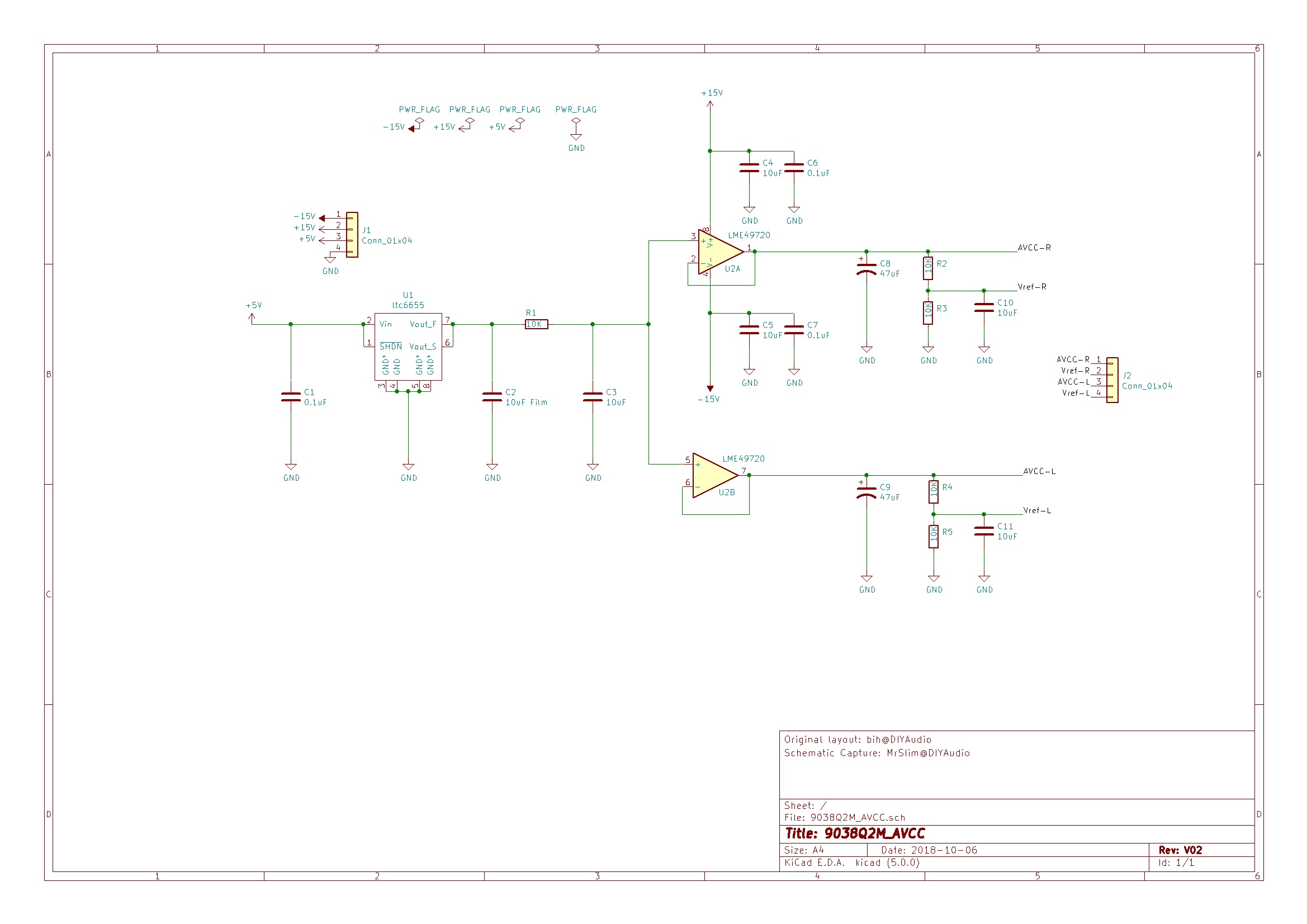

Hi Mark,
Here is a revised copy of the AVCC circuit, using standard schematic symbols. Let me know if there are any issues with it.
It is based on the schematic and BOM from bih.
I've also attached the original BOM from bih with only the AVCC sheet revised to reflect the capacitor types that you recommended. I used 47uf Panasonic low ESR Electrolytics at 1/10th the cost rather than the Organic Polymers you mentioned.
I'll probably do the I/V stage schematic next and then post a revised copy of the BOM from bih before going onto the PCB layout step of either circuit.
Also, where do the 22uF Wima's fit into the circuit, I didn't quite figure that one out?

Hi MrSlim,
Thank you for the nice work!
Actually, the 22uf Wima caps replace the 47uf output caps, C8 and C9.
Also, I have to say some of the mix of film caps and electrolytics doesn't seem entirely rational. If electrolytic leakage currents cause noise that is audible, which presumably they may at some very picky level, that is. I honestly don't know how much the 22uf film caps help because I haven't tried every variation of parts systematically. However, the AVCC load may also have current draw variations for which the film caps somehow work better. On the other hand, Vref supplies a fixed load, so some difference in that respect. It is entirely possible that most of the benefit of the recent changes comes from the new output stage, and LT6655 more than from film caps. Just don't know, but they aren't too expensive and it works. Maybe someone else can come along and do some more testing with different components. After I finished the first modded dac, with all the work I did on that one since it was the first, I said, "never again." Then I went ahead and did the second one to document how through hole components could be used. I feel like I have done my share of work in that regard. There are other things I may pursue that interest me, but I feel like I need a vacation from dac part swapping and listening tests for awhile. Not too worried though. It sounds good, if ever so slightly bright still but not objectionably so to me (some of that should diminish with HD compensation, I would expect). It sounds plausible enough although still not as good as DAC-3. It's good, enjoyable, non-fatiguing, non-clinical listening. Just not quite world class perfect.
