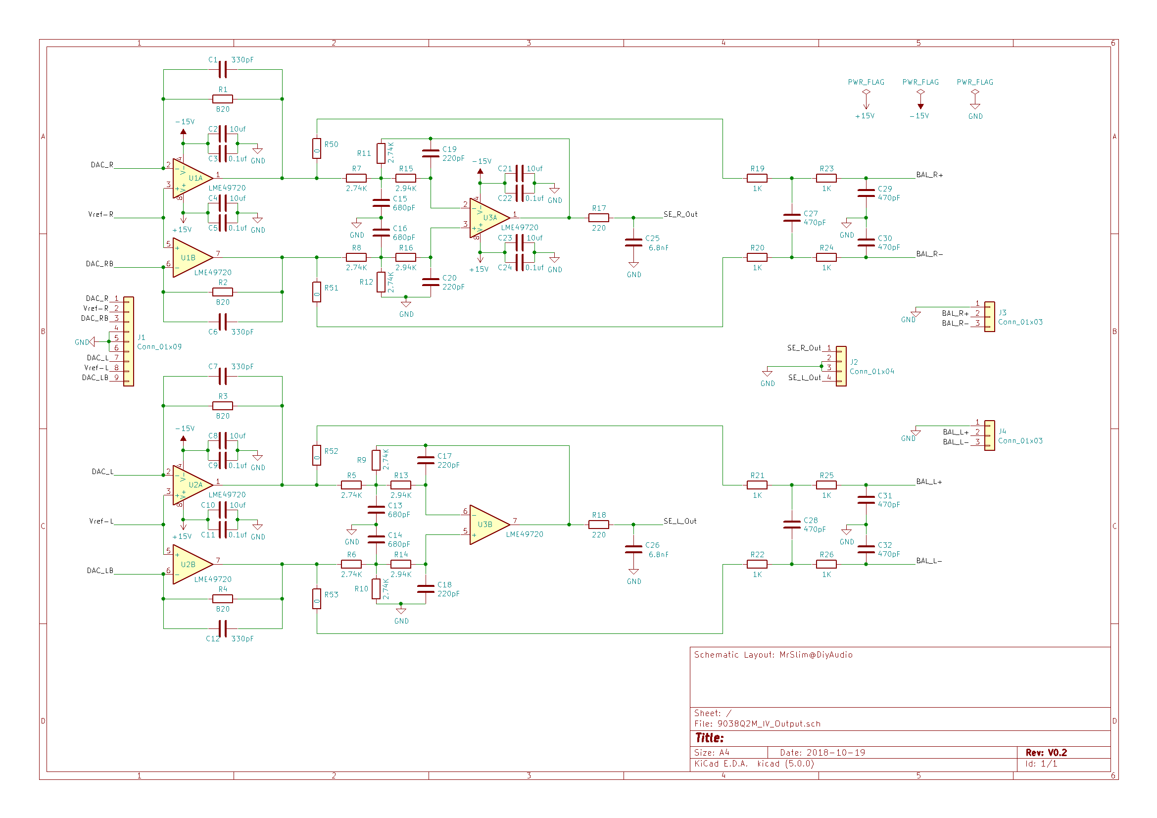

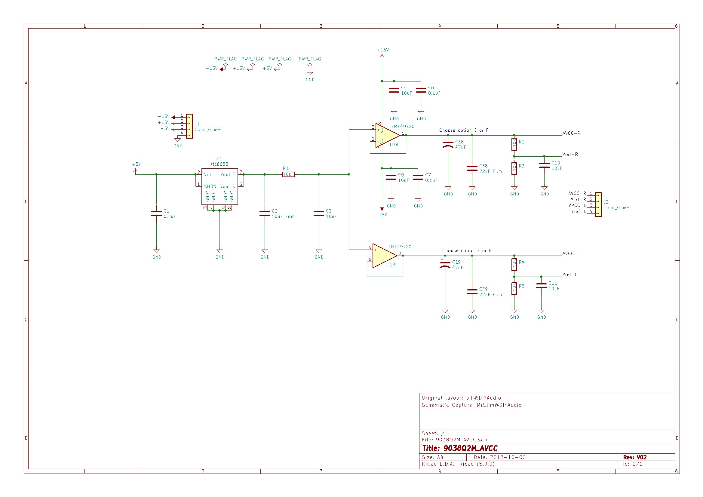

Through Hole AVCC and IV-Output Schematics
I've revised the AVCC schematic to show C8-9 as either Electrolytic or Film, and the board layout will include footprint's for both.
I've also added optional balanced outputs to the IV stage. R50-53 are jumpers that can be left out if the balanced outputs are not required. These jumpers reduce the amount of non-powered wiring on the board that could become antennae for external noise pickup.
Both Sheets of the BOM have been updated, as well as the Combined sheet.

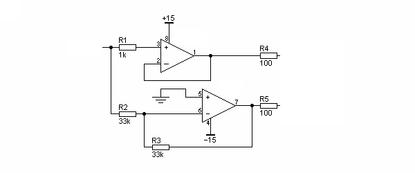

MrSlim,
Thank you so much, sir. However, may I request to please revise the balanced outputs to add the circuitry shown below following each unbalanced output, if a balanced option is desired?
Also, not quite clear on why connectors are shown for the inputs, since it is strongly preferred to tie the ground planes together through a continuous bond.
This would be the case for both AVCC and the output stage. Perhaps more critically so for AVCC which needs to be as close to the dac pins as possible with as low a source impedance as reasonably possible.
EDITx: This has already been edited quite a bit, but I would like to add that I include 1,000uf electrolytics in parallel with 1uf film caps at the +-15v power entry point on the output stage board. I tie the AVCC board to the output board with short length 18 gauge wires for +-15v to the output board power entry filter caps.

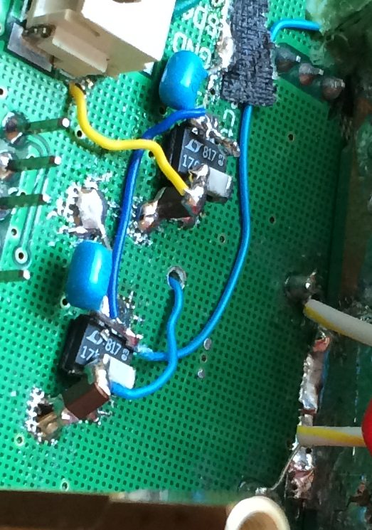

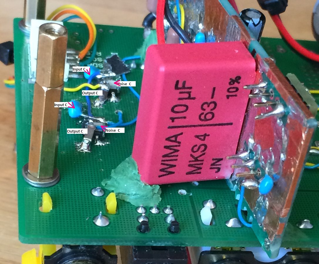

Somewhere or other I would also like to include that I use local 3.3v regulators, LT1763, for clock and VCCA. In part that is to help isolate them from digital noise from the MCU as recommended by ESS.
In addition, since I use an external +5v supply to power all three 3.3v regulators on the dac board, the ground return to the 5v supply is taken from the digital end of the dac board. The idea is to help keep digital ground currents from flowing in the analog sections of the dac as much as possible. +-15 and +5v power supply grounds are only tied together at the dac board.

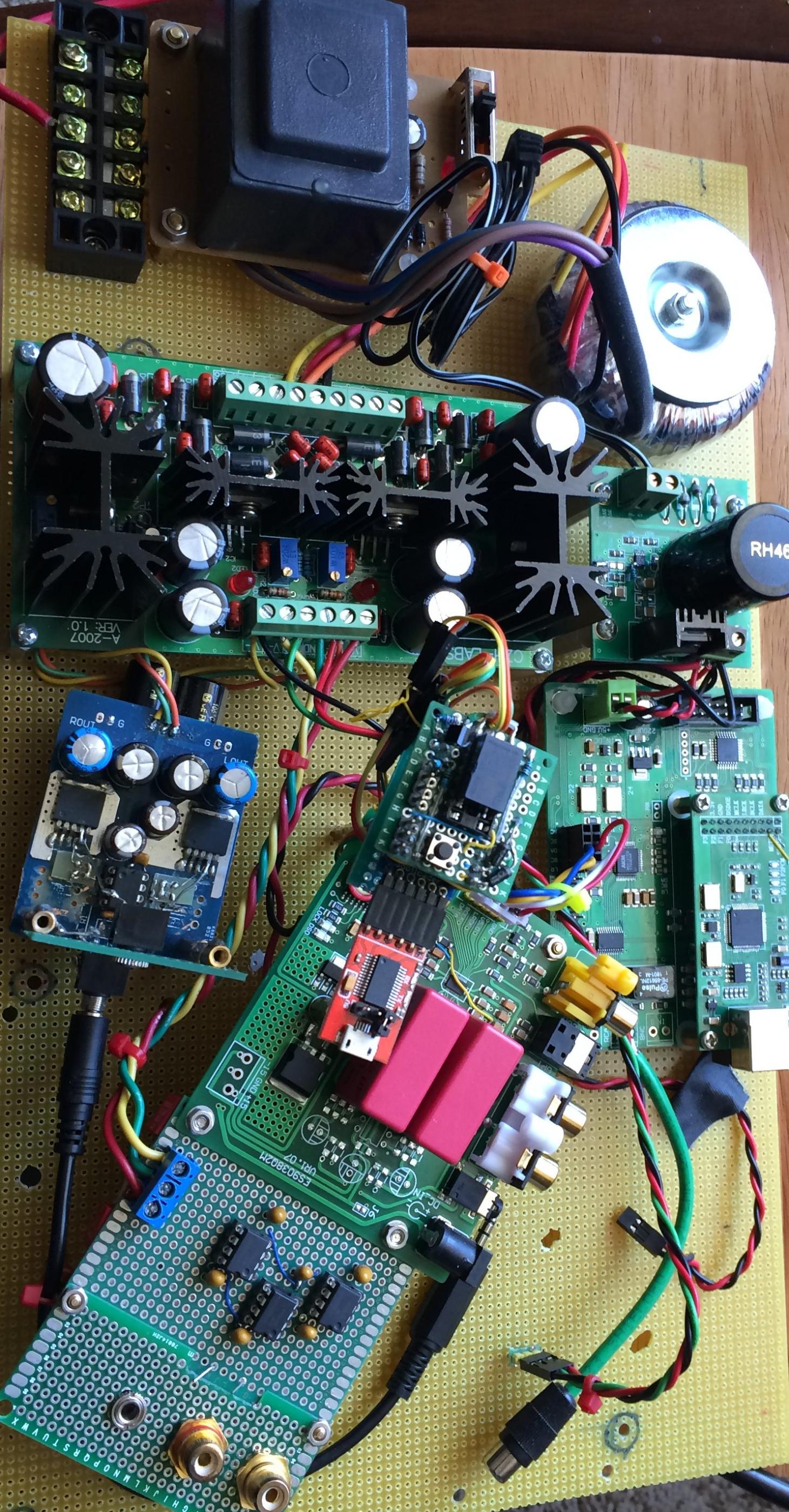

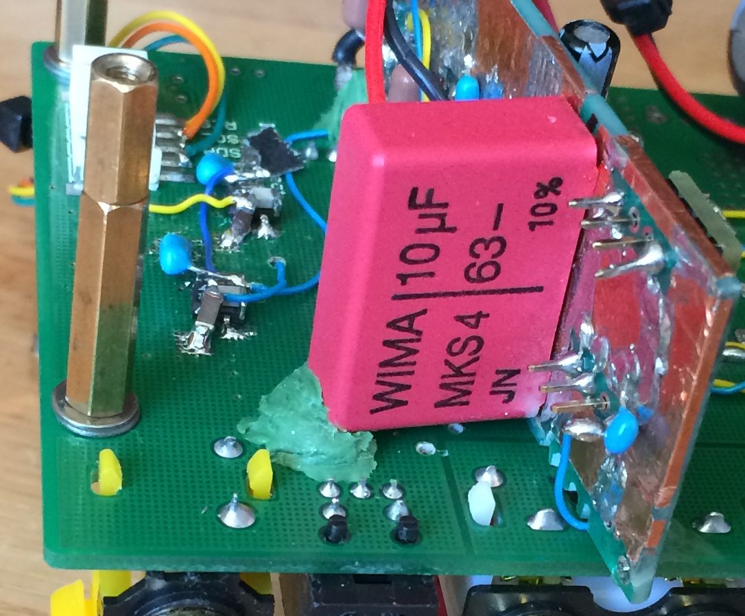

Pulled the dac out of the test box to work on the quality of connections between AK4137 and ES9038Q2M. Trying to get DPLL bandwidth lower requires low connector noise. Will try soldering ribbon cable at AK4137 end, and more connector ground pins at dac I2S input.
Anyway, took the opportunity to take some pics showing the test board and the current state of the dac board including the LT1763 3.3v regulators for clock and VCCA.
Just noticed BOM item 6 shows both 220pf and 220nf. The nf abbreviation should be corrected to pf. Thanks!
EDIT: Also noticed in BOM for AVCC, there are no 10uf aluminum electrolytic. Instead there are five 10uf tantalum caps. The 10uf tantalum caps should be quantity 2, for opamp power decoupling only. 10uf filter caps for 3.3v AVCC and for Vref should be aluminum electrolytic, because tantalum caps are too noisy for that use. So, that would be quantity 3, 10uf aluminum electrolytic (low esr wouldn't hurt but probably not necessary here).
Hi Terry,
Agreed. That schematic was copied from somewhere else. Makes sense to reduce those resistors to something more reasonable. In case the balanced load impedance is very low, it might make sense for the resistors not be be too small though. Something like 4.7k would probably be okay. Signal to noise by that point should be pretty high anyway. If someone knows they won't be driving a very low impedance load they could make the resistors smaller too.

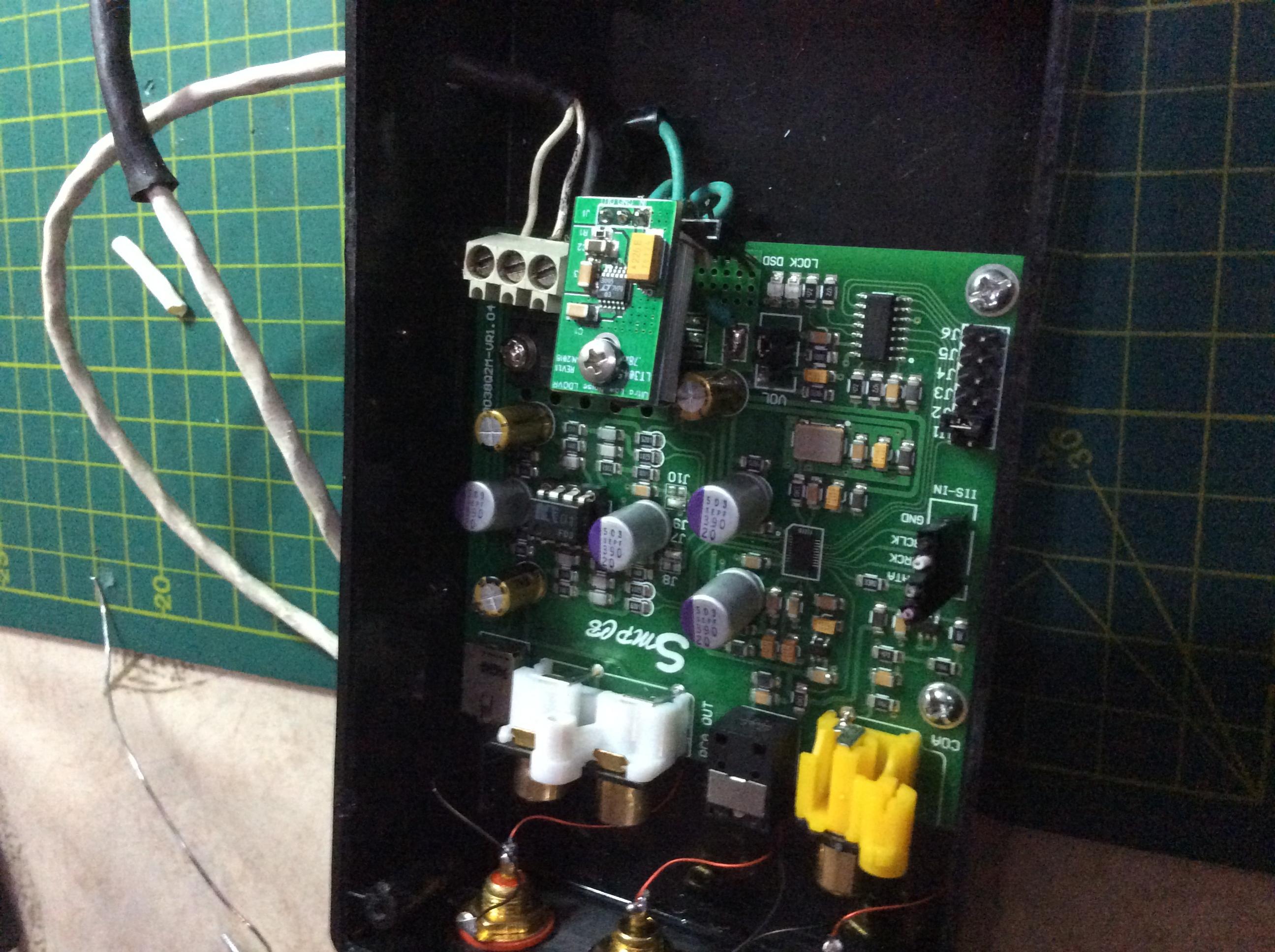

Mark,
Photos of the DAC. Embarrassing you will see how bad my soldering skill is.. ha ha.
The RCA jacks on the board are bit flimsy so I have a separate set on the plastic chassis.
Noise from dac is quite small. Despite 2 stage filtering there is another filter at output. Output load 220R/6,8n is not good for lme49720... of course for my experiences.
Try to filter as much as possible noise before enter the opamp but not load dac too much. This gives me best result at last designs.
Mark,
Photos of the DAC.
The dac board looks like it has the right stuff on it to sound good modded.

Output load 220R/6,8n is not good...
While I understand the possible concern, I thought about it a lot too. Thing is about a lot of the earlier filtering is that it depends on opamp gain which is falling off as frequency rises, thus the filtering becomes less effective at very high frequencies. In addition, at this point I am not seeing or hearing a problem. Sound quality is better than ever, for one thing. The RF noise is small enough at that point the current flowing into that last filter cap is so small the opamp is hardly loaded. However, a final real pole just before leaving the dac board seems to be best for power amps, at least for mine.
