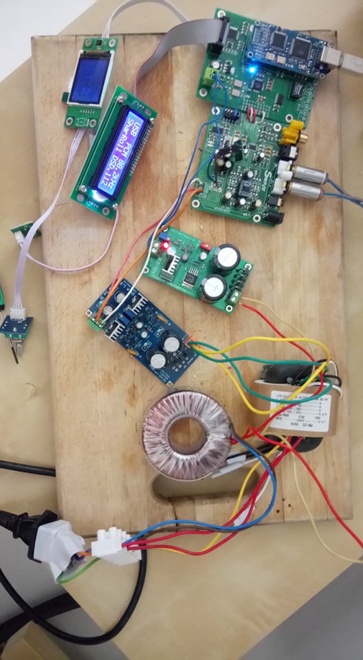

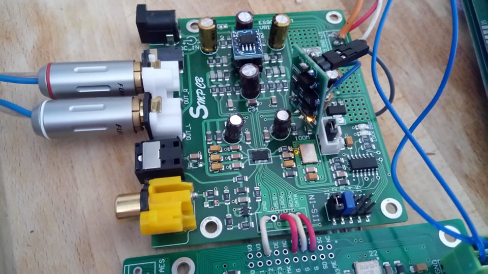

Paul,some pics from mine that i promised some time ago
still waiting for the crystek clock, but replaced the power for the oscillator with a separate regulator. Also changed the 7805 to lm1086.hopefully will finish up the avcc board this week.
What are those 2 separate regulator PSU boards you are using in your first pic? Are those home-grown, or available on eBay? link? Maybe buried in the thread somewhere!

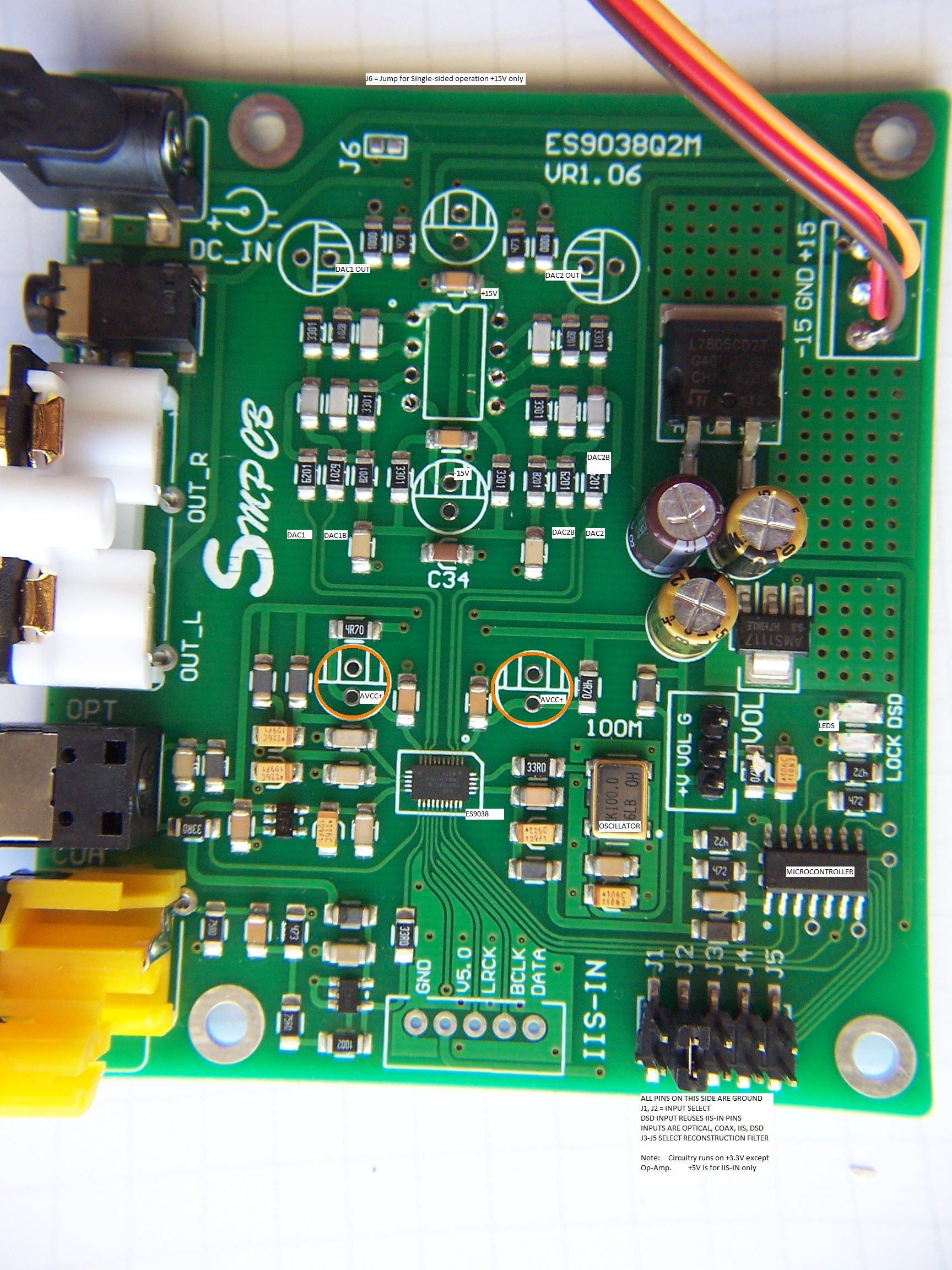

Also, if you want to keep mods minimal at least at first, you might try one very simple one which is to solder some more electrolytic caps on the bottom of the board under the 47uf AVCC caps which are in the board now. A very good designer named Victor used three each 1800uf caps for each of the two AVCC supplies. He soldered the extra caps onto the bottoms of the pins of the existing 47uf caps. It should help quite a bit, although it is far from a really good and proper AVCC supply.
The caps in question are located in the positions outlined in orange in the pic attached below.
EDIT 2: Another trick you could do would be to reduce harmonic distortion quite a bit using an RPi. An RPi can be used to control I2C bus with some simple commands. If you have the optional display unit for your dac board, it is easy to stop the MCU and use I2C bus to go in and turn on harmonic distortion compensation and set it to reduce some of the distortion that comes from using the original, built-in, single opamp output stage. I could give you some more info if you want to give it a try at some point.

Hi Redjr
below are the links from ebay for the boards
https://www.ebay.com/itm/LT3042-Low...ro-XMOS-DAC-/173021810599?hash=item2848e74fa7
https://www.ebay.com/itm/Dual-DC-12...one-Pre-AMP-/182139118107?hash=item2a6856621b
I used the above, but they are fairy cheap solutions. If you will use something more expensive the results might be better.
Regarding the dac, I have added some regulators based on lt3045 to the avcc supply.Along with the changing of the clock for me those were the upgrades with the most audible results. I have finished the dac for now, and im putting it in a nice case now.When ill finish ill post some pics.Maybe ill add an output stage in the future. For now i want to start an amp project for the winter.
For last few months i was listening only to this dac, but now that im putting it in a case i plugged in my old dac and the sound is so much better that even my wife noticed immediately.
For me all the upgrades were worth it, the cost was probably around 300-350eu, but the sound is much better then my current dac TEAC 501, which had a cost of around 1k.
