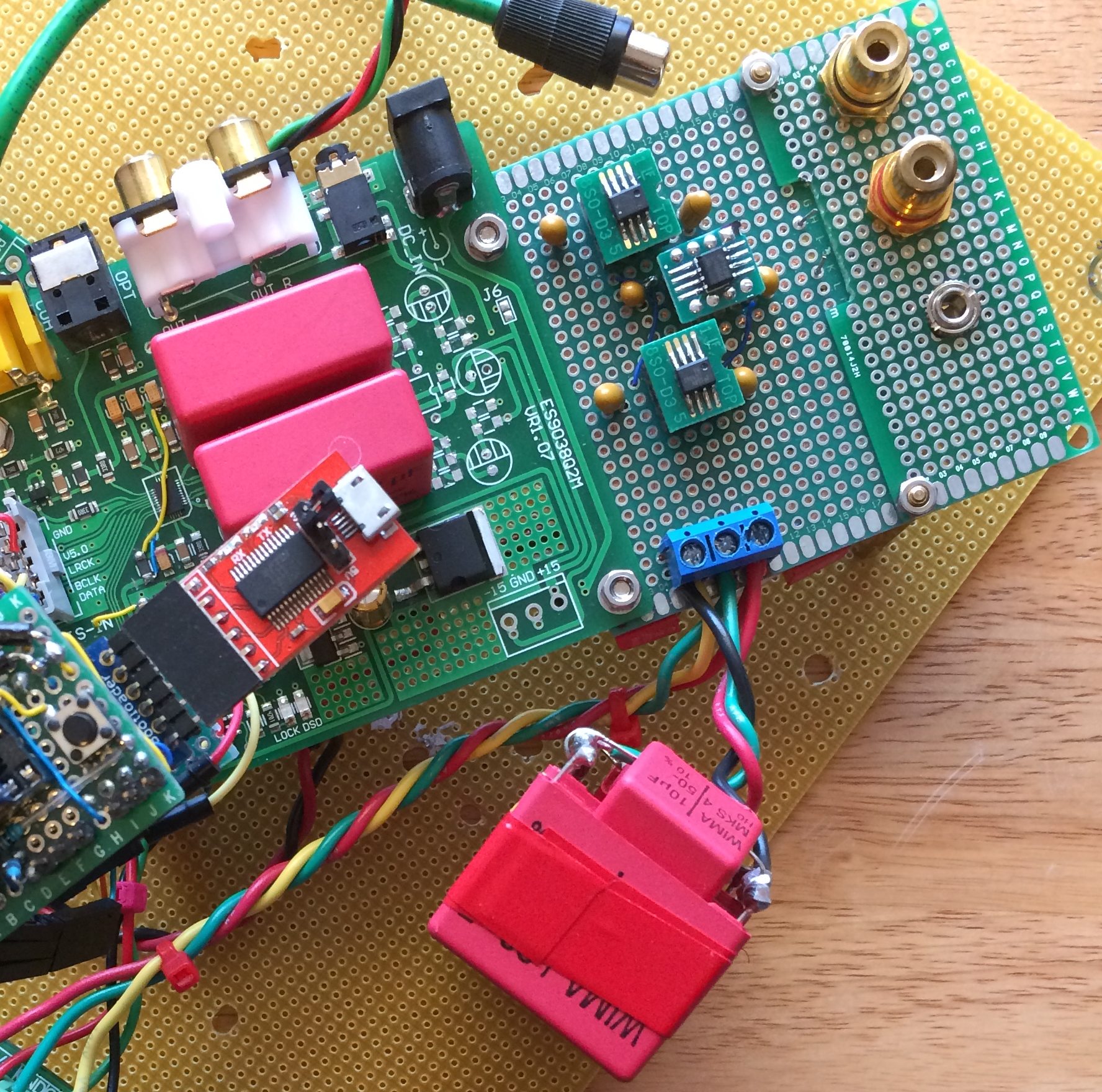

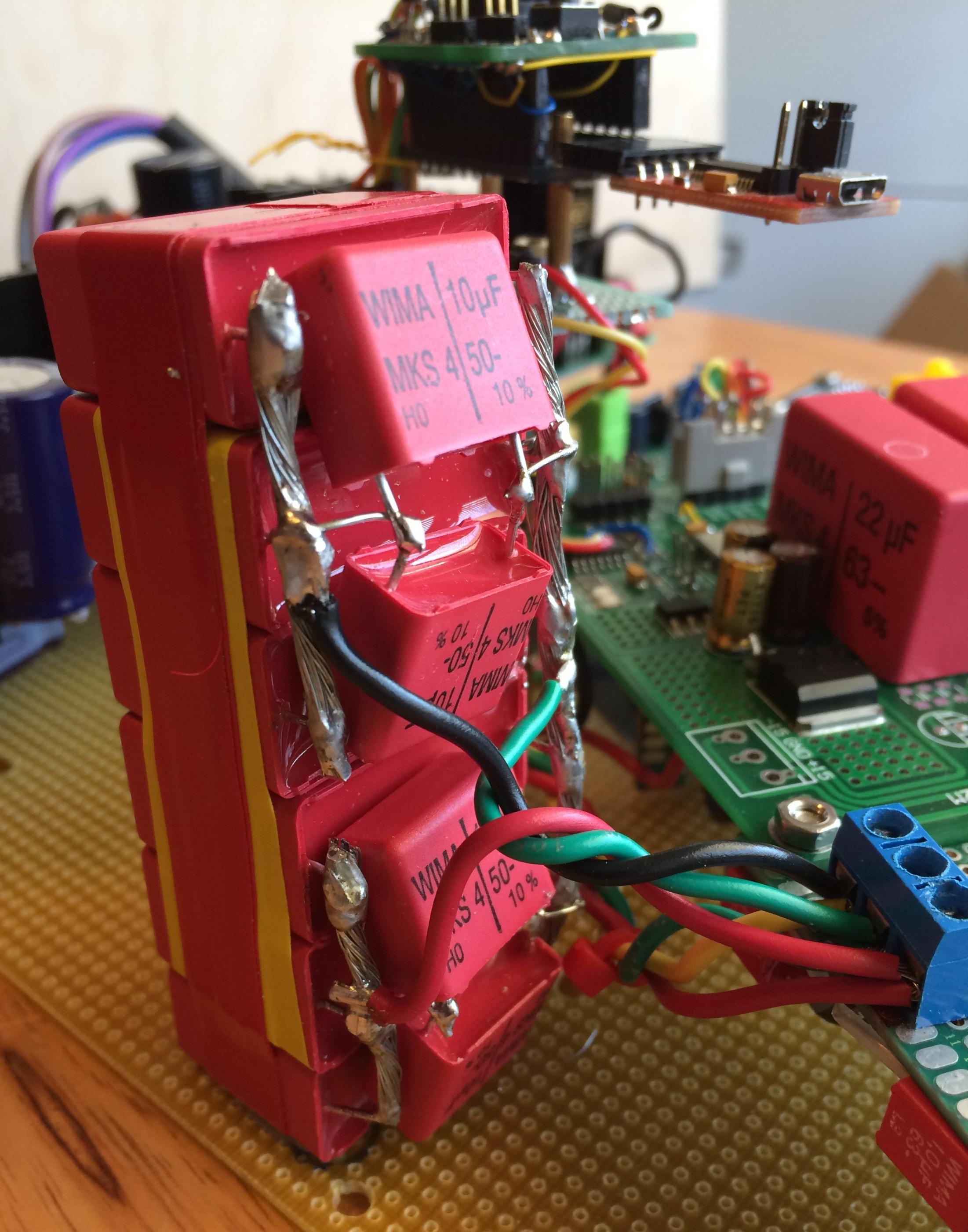

Did an interesting experiment recently. Don't have measurements yet though, its on my list to do pretty soon. One issue I have been trying to look into is why the 2nd modded dac has much more H3 than the 1st modded dac. On the face of it, there didn't seem an obvious reason. Used the same AK4137, same external power supplies, etc. All looked to be the same.
Since the 2nd modded dac has sockets for the AVCC opamp and the output stage opamps, I looked around and found an OPA1612 on an SMD to DIP adapter. So I tried swapping it in for one of the output stage opamps. Tried for I/V and for differential summing. In both cases, it didn't sound bright at all like LME49720, but it didn't sound right either. It sounded like the dynamics were compressed quite a bit. So, why did the two different types of opamps sound so different from one another, and neither sounded quite right?
Decided to try an experiment with the +-15 power rails. Thought the might be the most salient commonality that potentially could affect the opamps differently. I gathered up all the big film caps I have, and soldered them together in two groups. There is nominally about 110uf of total capacitance in each group of film caps. Connected one group between +15 and ground, and the other group similarly connected to the negative rail. This is in addition to several thousands of uf of electrolytic filter caps per rail, and pairs of tantaum and ceramic caps at each opamp power pin. Pictures attached below.
As I said above, I haven't measured anything yet, and haven't even finished subjective experiments, but there is a change for the better in sound quality with the LME49720 opamps. Haven't tested with OPA1612 yet. The excessive brightness is less now, maybe by about half, and it sounds smoother (less distorted, I think). I expect when I do measure I will likely find I don't need -150 counts of H3 compensation to null H3 to a minimum, meaning odd harmonic distortion is probably reduced.
Obviously, I have some more work to do on this, but thought it might be of interest to thread participants without having to wait longer for the final conclusions.
EDIT: Forgot to mention, for this experiment I replaced the LME49720 opamps with LME49860 opamps. That is because the latter opamps are on SMD adapters which are easier to swap in and out without bending pins. However, the types of opamps in this case are exactly the same except for maximum voltage ratings. They sound the same.
