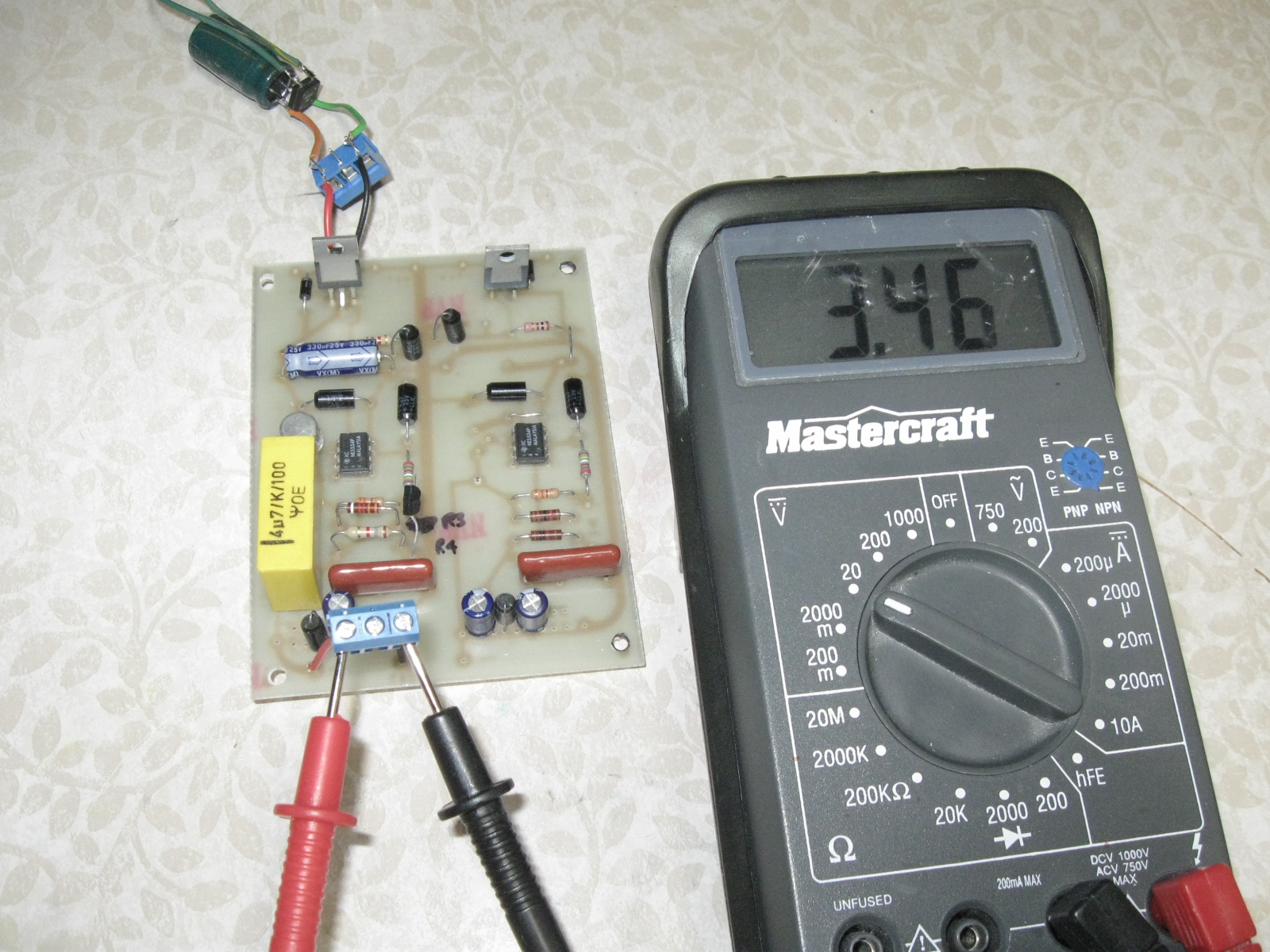

Well for this weekend I took out an old partially stuffed Sulzer Jung regulator, grabbed some parts I had since I discovered I had an LM385Z - 1.2V reference and made myself an op amp AVCC using an already soldered in NE5534. It is preregulated with an LT317. With the resistors I had on hand the closest combination I could come up with was 3.46V - still safe for the 9028PRO AVCC.
While this is burning in to ensure reliability before I put it on the ESS9028 DAC, I am using the test mule rig, a PCM1794.

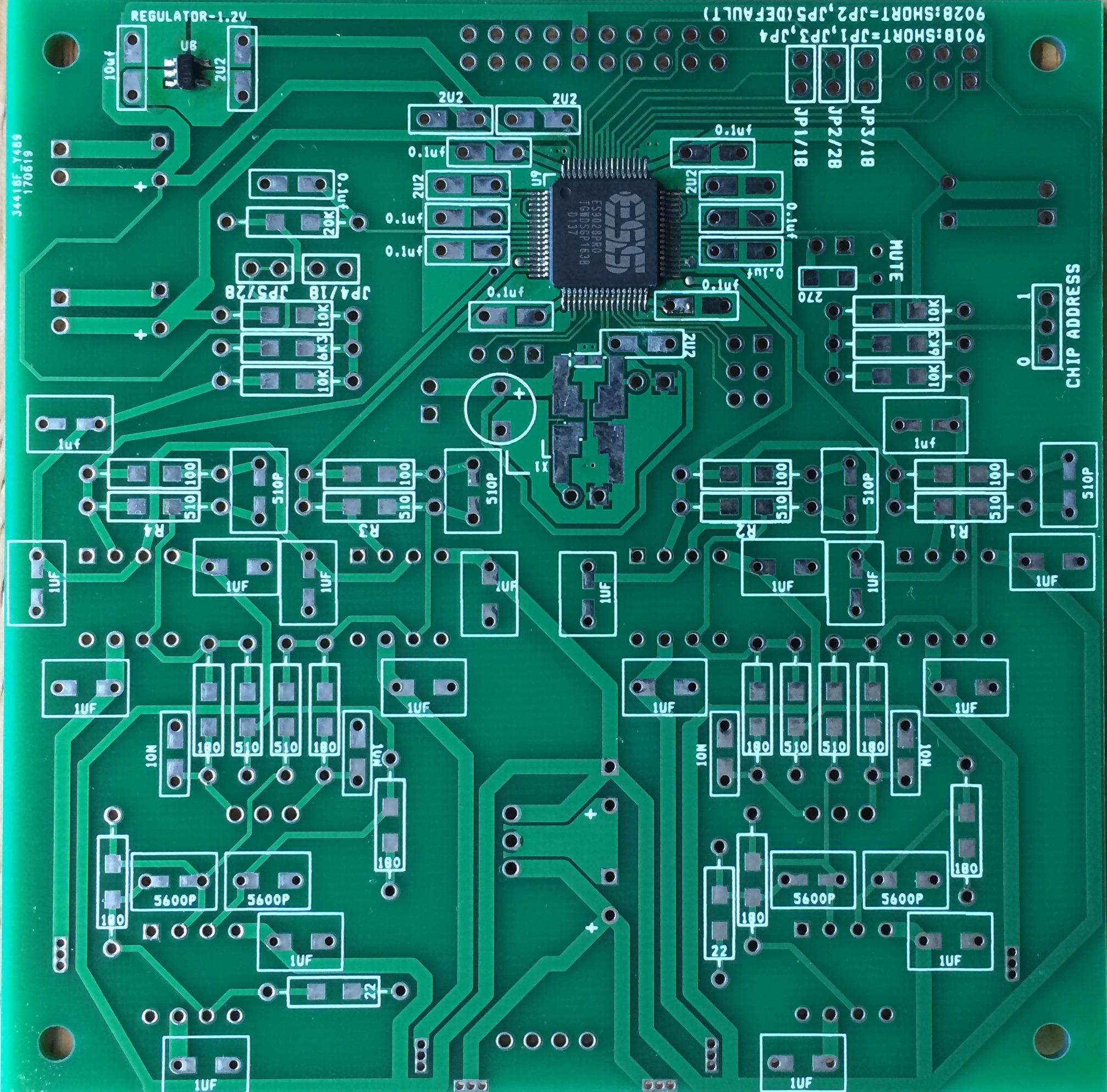

Looks like I may be joining you soon in playing around with an ES9028PRO, which I am primarily interested in doing to see how it differs from ES9038Q2M in terms of best possible sound quality. The only reason I can think of is the 256-tap interpolation filter option (if I can come up with some coefficients), and maybe more dynamic range associated with lower noise which in turn is is possible because of the higher output currents.
Anyway, my diyinhk board came today. It is only populated with the dac chip and an SMD voltage regulator for the 1.2v supply. I think I will have to replace the regulator with a 1.3v version though. That makes 1 mod lined up already.
Since the board is undocumented (they say the schematic is printed on the board - NOT), I spent the afternoon sketching out the schematic, and already thinking about the 2nd and 3rd mods. The second will be to redesign the output stage, and the third mod would be to try to bring out wiring to access the dac output channels they didn't use. They have two outputs in parallel going to each I/V converter, which uses up 4 out of the 8 total channels. They tied the other 4 channel outputs together in twos like they did with the first four channels, but they didn't bring out any traces from the dac chip big enough to solder to (by most reckoning). Maybe I will see if I can test out my microsoldering skills on those very tiny pins. Two sets of pins will be easy, and the last to sets of parallel pins will be hard as it gets, I think. Biggest problem will probably be getting the solder to go where I want it. The low temperature leaded solder I use tends to want to form bigger drops than I want, maybe due to surface tension when it is molten. We'll see.

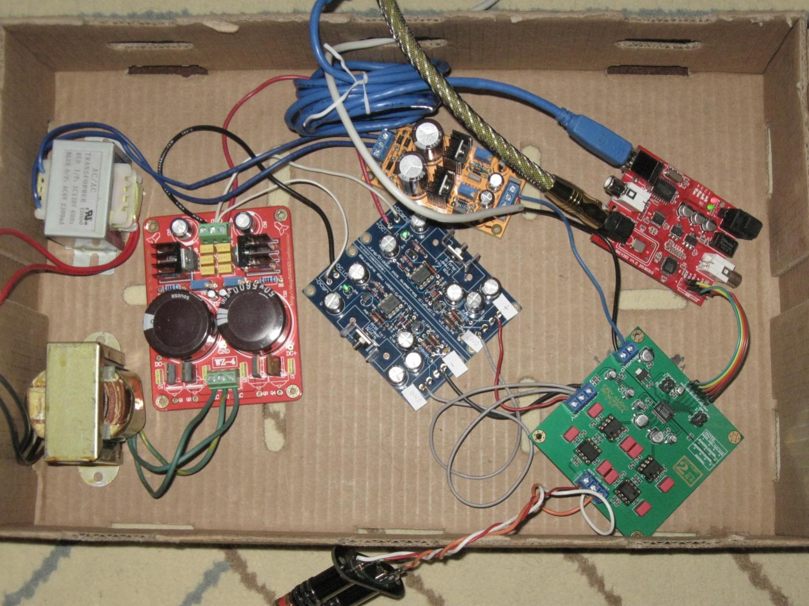

Well Mark, you were correct in using an op for AVCC. My op amp based Sulzer blew the LT3042 out of the water immensely. Not even close.
A tip for followers. Don't waste your time on LT3042/ 3045s. Honestly, they might be low noise but they are SLOW in response and cannot deliver the goods at all.
The LT3042 are slightly better than the LT1963 and likely the LT1763 but they are not one what would consider good for AVCC. Definitely better than the AMS1117-3.3 LDO and don't even think about LT317s.
So based on my testing of the 5534 on the Sulzer then the Super Reg and then the LME49710 on the Super Reg on the test rig, there is a lot more to come. since this 5534 on the Sulzer is like really at the bottom of the heap. Parts bin selection of old caps, cheap resistors etc. I will begin building a Super Reg for AVCC using the LTC6655 1.25V.
I have yet to install the Super Reg on the IV stage, that will come in the next week as I dismantle the test rig to retrieve the Super Reg.
