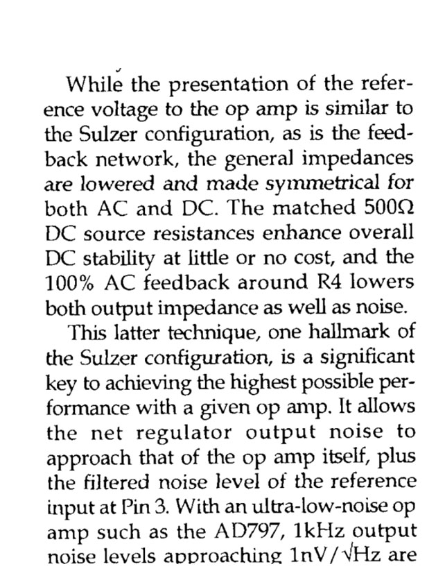

The reason I was gung ho this morning is that last nite for bedtime reading, I reviewed the work that Walt Jung did in 1995 for high performance regulators and now I understand it much better but not all of it. It is quite some work that I can't imagine anyone should overlook. Based on what I see people doing now, it sure looks that that work has been overlooked.
Now regarding the noise aspect, remember these regs use LOTS of feedback and their topology is a lot more sophisticated than a unity gain op amp configuration.
Months ago, I could have linked the articles. Walt Jung has removed his web site now so I will extract a snippet of what was pointed out in his work. Hope he does not mind too much.
If you have access to the Audio Amateur series in Feb 1995, then you can read the complete article and others following up to 2000.
Walt Jung did some very impressive work indeed.

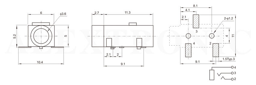

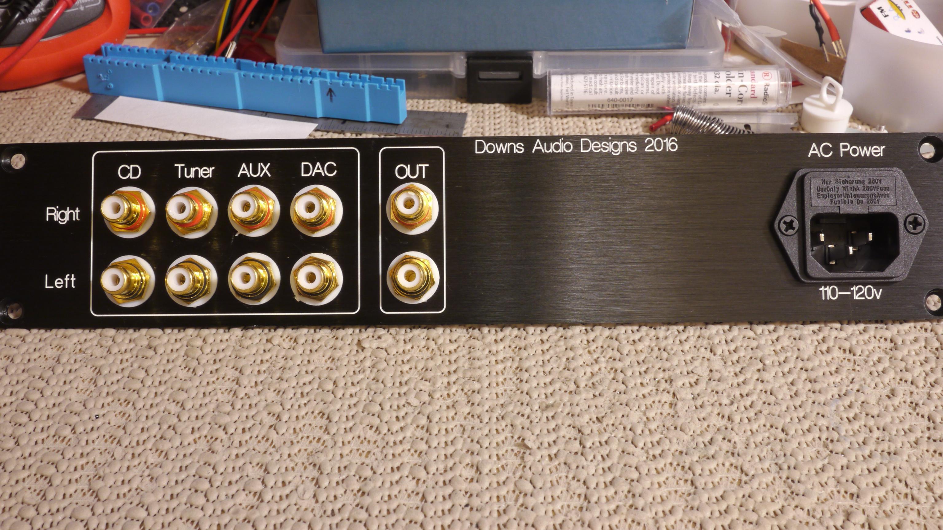

Searching doesn't really give me anything, so here goes: Has anyone made a mechanical drawing on the connector layout so I can make a Schaffer/FrontPanel Express panel for the original DAC board?
Not that I know of yet. That can be one of the most time-consuming tasks of DIYing - at least to my standards anyway. I usually, grab my calipers and the board and start measuring. After I get close, I print the FP diagram panel out on paper. I then cut out the holes, see how the board fits and finesse the size and location in mm movements, and adjust the FP layout accordingly. Usually it takes several iterations before the final is locked down. It's a slow process, but I've gotten pretty good at it over the past several years. It can be an expense many don't bother with.
Thanks. That's basically my approach as well, so if noone else has done it already then I looks like I have to get the calipers out and turn on the printer :D

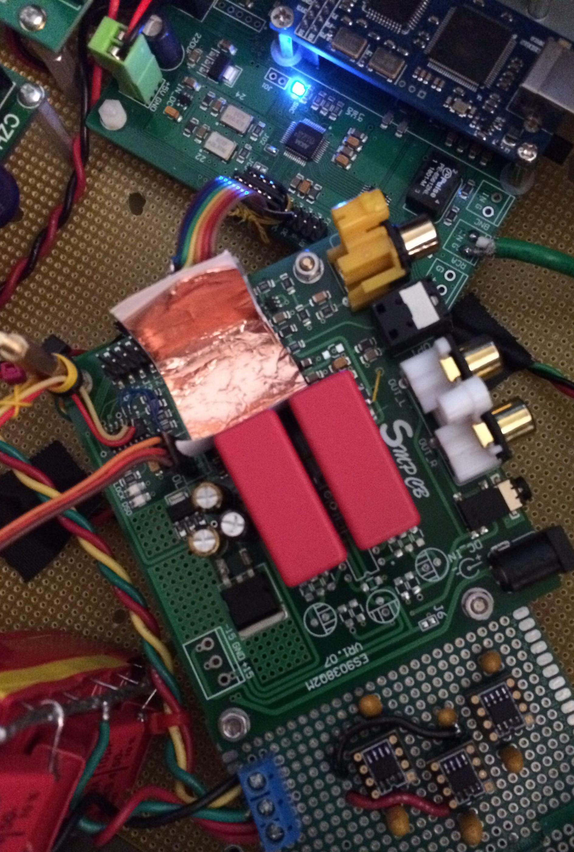

Maybe time for a little update on the dac project. Currently, I am finding that OPA1612 opamps in the output stage seem to be giving a more honest sound than LME49720 types. Perhaps that is due to some small amount of RF I have not been able to fully shield them from. A lot to artificial brightness is gone with the new opamps. Still have LME49720 on the AVCC board. Maybe will try a substitution there later, although I don't hear any indication of anything wrong.
Where I am seeing the last bit of improvement I can get that brings the dac really close to not having a sound of its only, it just plays whatever is on the recording, comes from adjustment of DPLL bandwidth. It starts with a default value of, let's call it 10, and if I can get it down to 8 out of 10 that sounds a bit better, but I like definitely like it better if I can get it stable at 7. That turns out to be much tougher as stability seems to tend to drift with time and temperature. Some experiments show where the sensitive area on the board is as can be seen in the picture below. It is where the I2S signals come into the dac and and bit the right side of the big AVCC film caps. I found dropping a piece of copper foil in there with the backing still attached so as not to cause any shorts helped some. I was actually able to get DPLL down to 5 although I couldn't get it to stay stable for long. Where the copper foil is also happens to be where I can probe around with my finger to affect stability.
Last night I tried a new experiment which looks like it might offer more reliable stability of the EM fields in that area. I laid a small plastic bag of ferrite cores into the sensitive area. I would hoping they might be lossy at the sensitive frequencies or at least help keep the fields more well defined and contained to a very local area. Don't know exactly what is going on, but it seems to be helping. I will try to play around with it some more today to see if I can learn a bit more.
I have some attachments that might help. That's about it though.

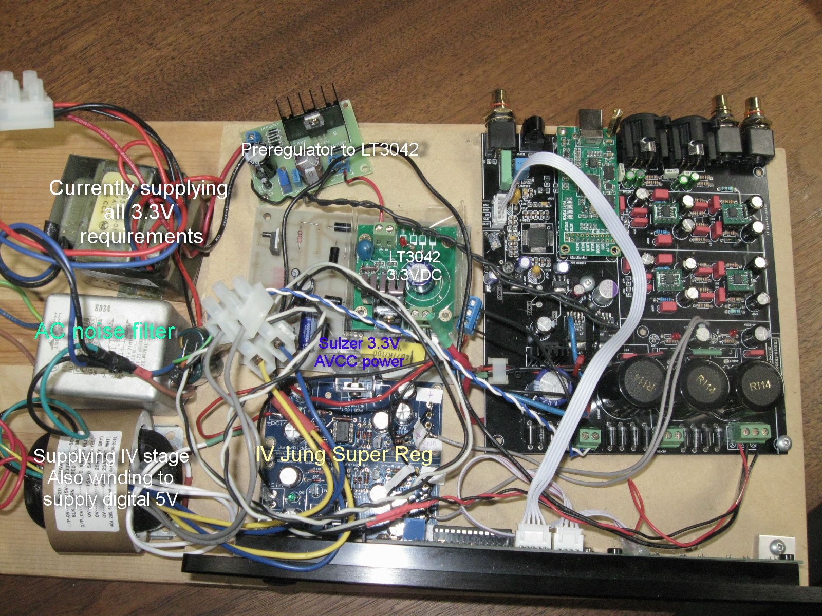

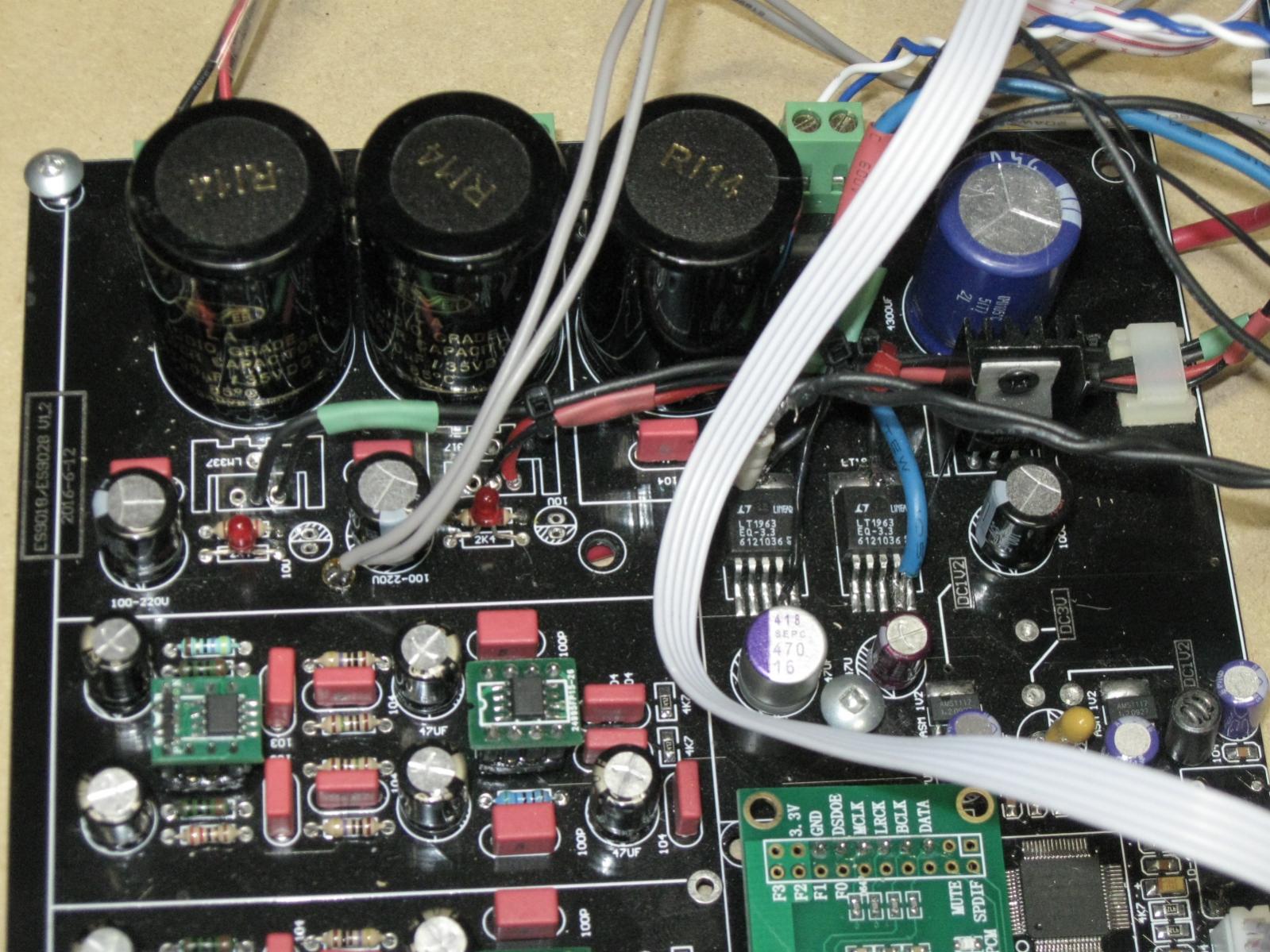

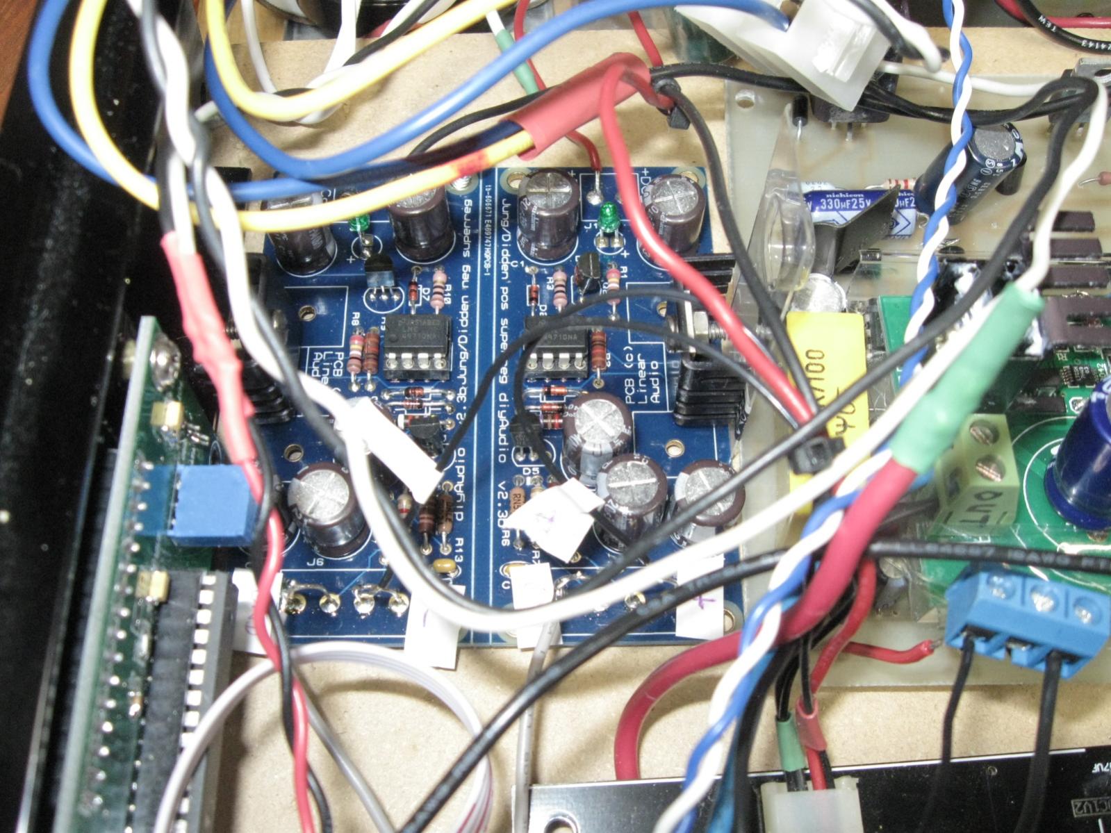

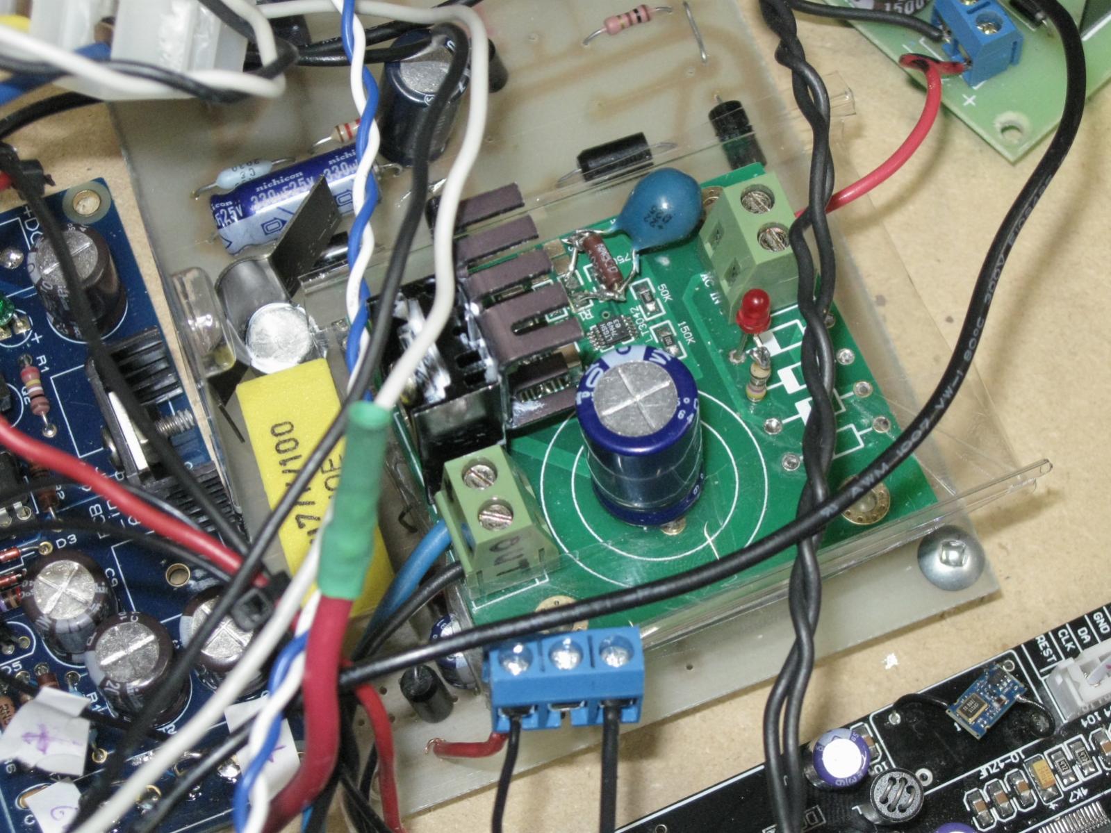

Here is my web of confusion.
Here is the rejigged Crystek on the bottom right hand corner WITHOUT the cover!
Just above it is the LT3042 that will eventually power it exclusively. I feel the constant power required is something the LT3042 was really meant for. We shall see.
Right now it is also powering other 3.3V requirements besides the clock. When the sampling frequency increases the power drawn increases and thus I had the need to increase the heatsink. When it goes back to powering the clock exclusively, the additional heatsinking will be removed.
Yep. That looks to be pretty heavy gauge wire supporting it. I'm sure a lot of people would be interested to take a look at the insides of one. Good that you got it working. After that I would say you are probably getting increasingly qualified to work on small parts. If you can solder small enough little strands of wire, surprising some of the things you can fix.

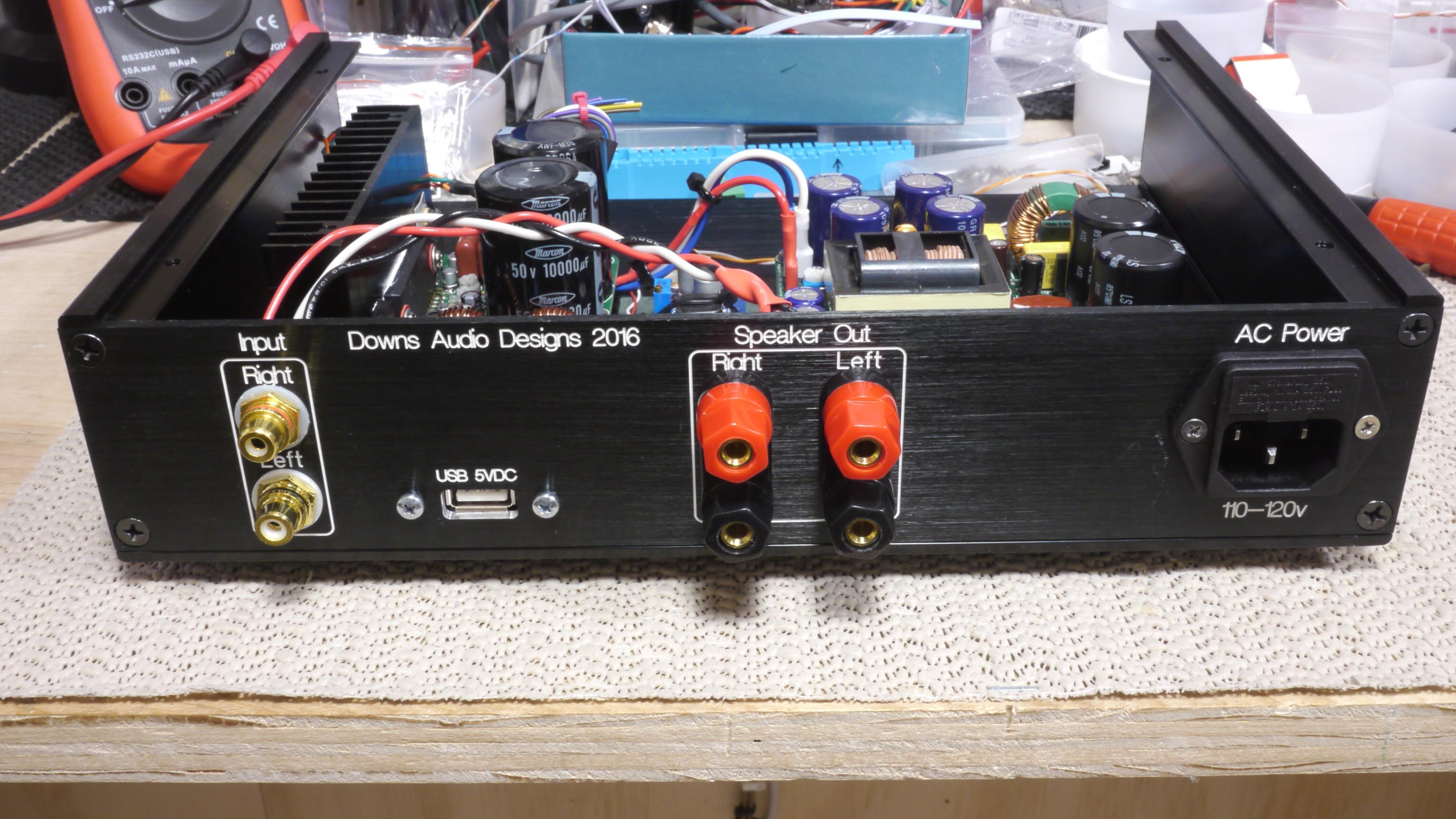

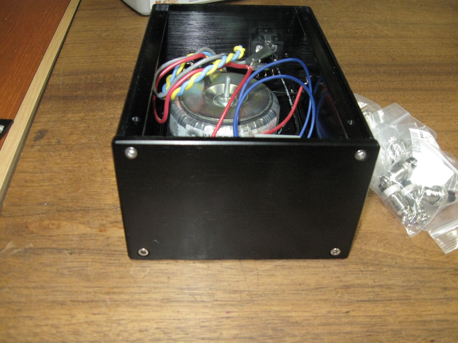

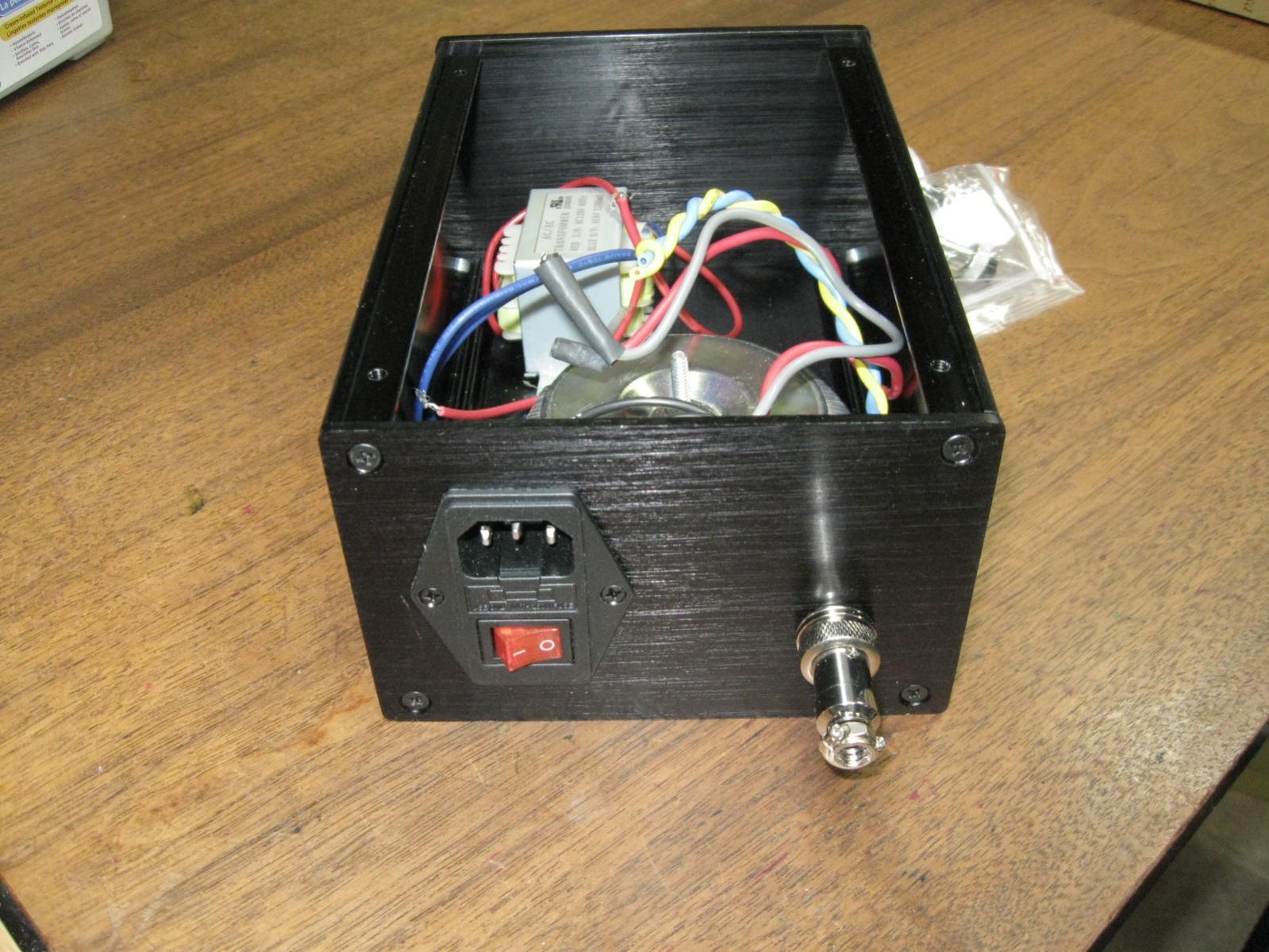

Here is the system as it is now.
The external power transformer cases will be finished first. Inside is an 80VA toroid for the IV stage , there will be a separate transformer to power 5V & Digital 3.3V, the AVCC and clock will likely share the same transforner. Depends on space left inside the enclosure.
Inside the DAC some tight packaging will be involved.
