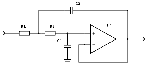

Probably using LT304x as a buffer for the LTC6655 3.3v reference on the AVCC...
A simple tweak could improve the performance - if it works, reconfigure the LT304x op amp as a sallen key low pass filter, I need to buy one to try.
...Vref apparently is TL431...
TL431 are noisy, I use them in my shunt version of the Super Reg with dedicated 12dB sallen key, ~ 1.5Hz (47K & 2u2F).

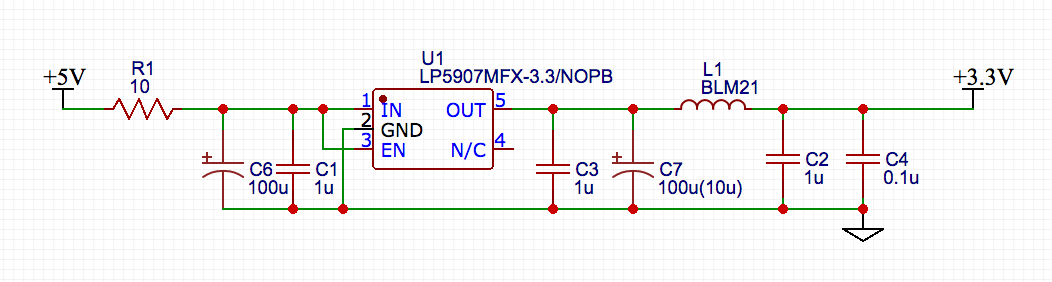

for DAC and clock powering by LP5907 LDO I wonder how to handle the info about max output cap size for this reg. It is written in datasheet as maximum output cap size 0,7 to 10 uF. For both VCCA I have 2 tantalium filter caps (probably 10uF each)+ 2 ceramics already on the board. Is it necessary to place a resistor (e.g.47Ohm) or the ferrite bread between the LDO output (with 1uF cap to ground before the bread) and the VCCA / Clock filter caps to not exceed max cap size though?
Would it make sense to place a ferrite bread at AMS1117 (which feeds MCU and DVCC) input to not pollute the 5V rail which also powers the other LDOs for VCCAs and Clock?
