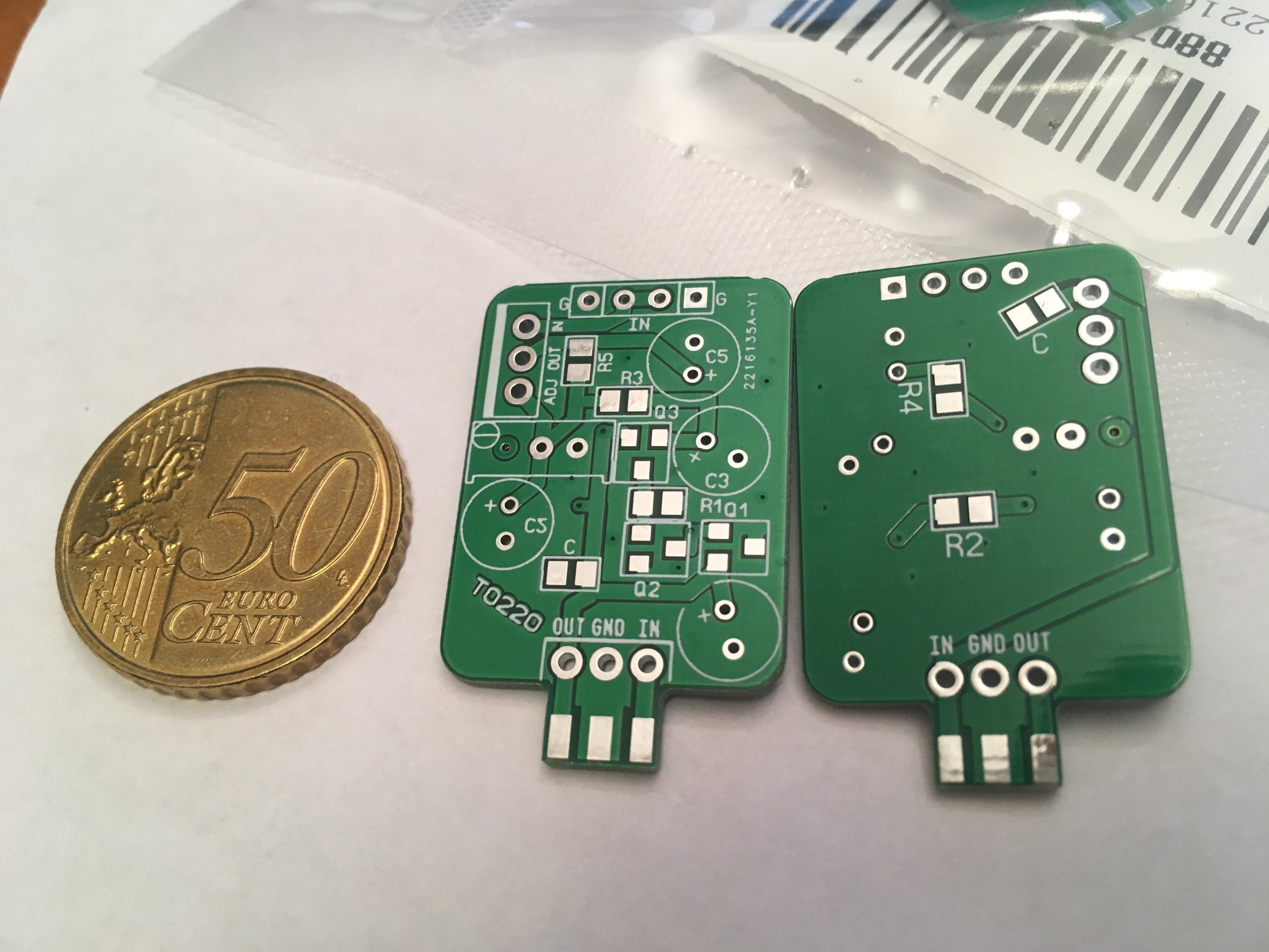

What actually makes difference with series-shunt topology is:
"Nazar`s regulator", variants - diyAudio
Here is one of its practical implementation:

I've been trying to find the time to finish development of a super shunt regulator, similar to the store Jung/Didden series reg; which is intended to power (an idea at the moment) a high current (1A per channel) I/V, the idea grew from a cross between the D1 and CEN but using current mirrors. The shunt can be easily adapted to replace any of the various PSU's.
It'll probably look like a dogs dinner by the time I'm finished

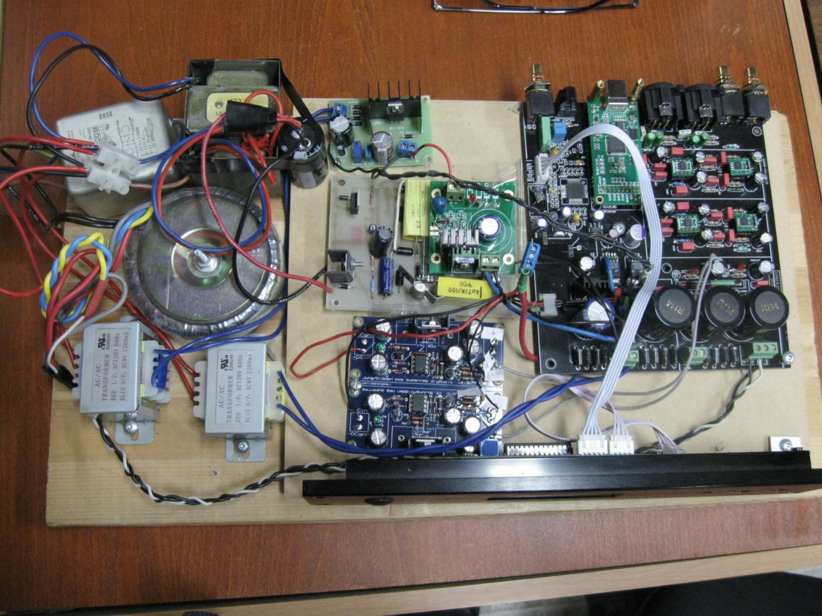

I played Katana for a bit as I had it last time to remind myself of the sound with isolator, 'thd' output stage, and modest linear supplies for +-15v and 5v rails.
Also, checked where I left the modded dac. It was still as I left it a few days ago running stable with DPLL at 6 out of 10.
In initial listening I preferred the sound of the modded dac, as it was less grainy than the sound of Katana. However, with the modded dac DPLL set to 6 out of 10, Katana had better audibility of low level reverb tails.
I then connected up some 10,000uf, .053 ohm ESR electrolytics to the Katana +-15v external linear supply. There was not as much change as I was kind of expecting, still grainy compared to the modded dac. I suspect that if I removed the bank of film caps from the modded dac and transferred them to Katana that might help more. The film caps are on the modded dac +-15v rails and are about 110uf per rail. Those may provide lower impedance and less DA ladder network sound than with electrolytics alone. Don't know til I try it if it will sound better. If it does sound better, exactly what the technical differences between the electrolytics and film caps are would have to later determined. I can speculate about possible reasons, but couldn't say for sure without more work. In any case, that experiment might have to wait, as I am not ready to remove the film caps from the modded dac yet.
Then added same type of 10,000uf cap to Katana 5v rail. Did not expect much if any difference since there is already a super cap and electrolytics on that rail internal to Katana. Just tried it to make sure, and, as expected, no audible difference to me.
Summary at this point is that neither dac, Katana or modded dac can equal or beat the other in every respect with any reliability. My preference for the two dacs in a stable configuration goes to the modded dac at this time as I prefer the lack of grain to the extra low level detail. However, I am not personally satisfied with the modded dac sound in that state. It is very good, but hopefully we can get it a little better. Just have to see how it turns out.
Also, as cdsgames suggested a few posts up, he would be happy for me to try modding Katana to see if I can make it any better. I wonder about that too, but I have to focus my efforts mostly on one thing at a time, and my commitment to the diy dac modders to see what I might be able to do about DPLL bandwidth setting stability will have to come first, at least for awhile. If I find myself stuck on that, I might switch to something else while I let the DPLL thing simmer on the back burner. Again, just have to see.

OK, this weekend I did some more changes and some interesting changes to me at least.
First off. How large and stiff a transformer do you need for feeding 4 op amps. 30VA should be more than enough even when you are using a Super Regulator . Right? Well I found for mylsef this weekend that it is not so. It is distinctly different when I changed to a 80VA Plitron toroid that is conservatively rated. What is the difference? The foundation of the music is fuller but leaner and more distinct. Bass lines are much clearer. Previously when I had used larger transformers, in my preamp I used a 160VA toroid but I never compared the sound of transformers like I did here. So now my IV section is fed by 80VA toroid that goes through a Jung Didden Super Regulator.
Next thing I did was I studied the AVCC Jung Sulzer AVCC power supply using an AD817 right now. Then it occurred to me that I was using a 4.7uF tantalum that was part of the RC filter for the reference voltage as was speced many many years ago. So I changed it out to a stack of metallized polypropylene caps of equivalent value and listened. I was not expecting this. The change was for the good. Now the detail of all arrangements in the music is clearly heard. The more interesting part is that the imaging solidified in depth now. While the sound is more distinct it is not accompanied with higher tonality and harshness that many many mistake for detail. Increased detail with harshness will mask the inner sounds of what is being played, in this case, the inner sounds are released and the masking or veiling is removed. So for those using an op amp somewhere for the AVCC power supply, you might want to try some films and see if you can gain something there.
I also took the time for feed the DVCC and clock power supplies from a separate transformer. It now looks like the separate enclosure I purchased for the transformers is getting too small now.
Well its time for the holidays so modding days are definitely for the New Year now.
