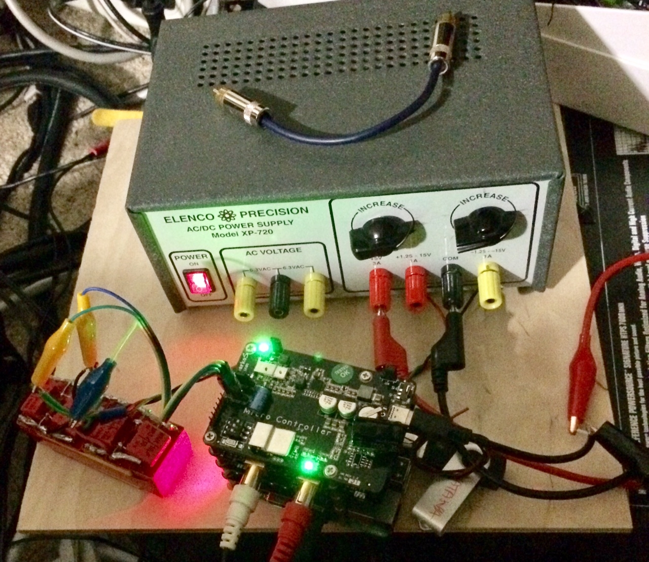

While working on the modded dac today, I decided to remove the bank of film caps and try them with Katana and the modest linear power supply setup to see if any of the graininess I reported previously could be smoothed out. My initial impression is that it seems to be helping. I will listen again tomorrow with and without the film caps to see if my impression still holds then. (As a reminder, a previous test using 10,000uf, .053 ohm electrolytics on the +-15v rails didn't really seem to help at all. They might help some though if used in parallel with the film caps, a combination which I haven't tried so far with Katana.)
The film cap bank is made out of whatever large value film caps I could find in stock. There are some Wima 33uf, 22uf, and 10uf caps of same types I used for LTC6655 output filtering and AVCC opamp output filtering. There is about 110uf for each of the 15v power rails (220uf in total).
Using that many film caps in those sizes would probably add a fair amount to the cost of the dac, but the linear power supply I am using is very modest indeed. It is one of these with a few simple mods: Amazon.com: Elenco AC/DC Triple Output Power Supply Kit: Electronics
The mods are that all the rectifier diodes where replaced with Hexfred ultra soft recovery rectifiers, and the + 15v LM317 regulator was replaced with an LT1086. That's it.
Total cost of the film caps might be a little more than the cost of the linear supply. 🙂
The other thing, of course, is that the linear supply is powered from a very good AC line power conditioner. Don't know how much difference that is making at the moment, but it can help a lot in some cases.
The RPi and that half of the Katana isolator are powered by an IFI 5v wall wart supply, just for the record.
Katana Update - Good News
Okay, I listened to Katana again with the film caps. The graininess is gone. It's the best I have ever heard Katana sound. The only thing I notice is maybe some slight thickening in the midrange, a tiny bit of muddiness that kind of sounds like it may be some low level 2nd harmonic distortion characteristic of the discrete output stage. Don't know for sure. But, aside from that minor little effect the sound is extremely detailed, smooth, and very pleasant to listen to. It is good news for people wanting a great RPi dac at very reasonable cost. I think this is it.

I took a picture of the Katana power supply setup. Its still early in the morning here and kind of dark in that area. Didn't want to use a flash, so this is what I have.
EDIT: Unfortunately, I only have one block of film caps, so can't compare Katana and the modded dac directly right now. If I order more caps, maybe I could next week.
