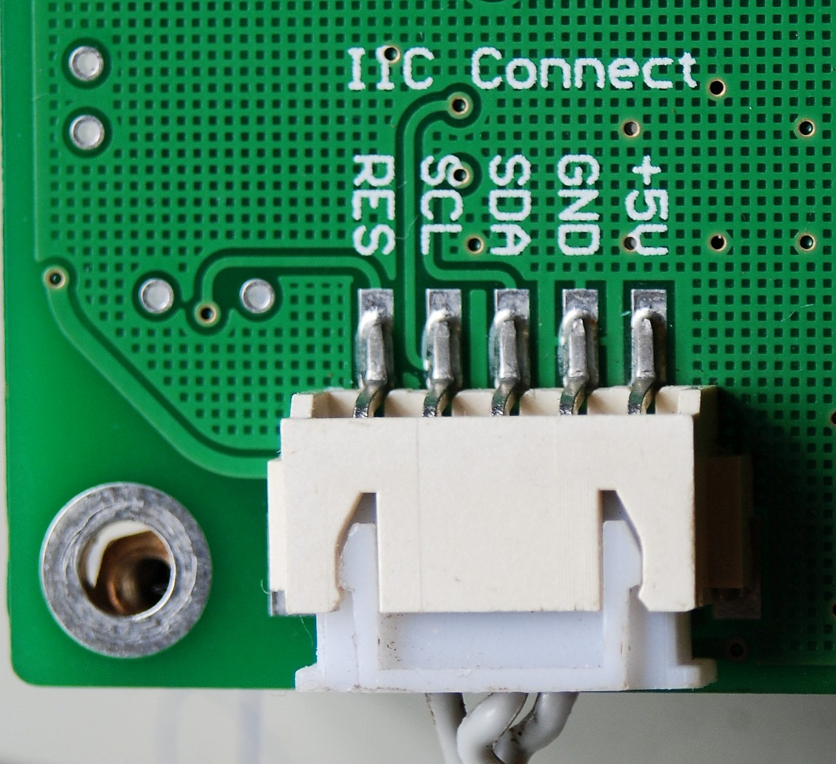

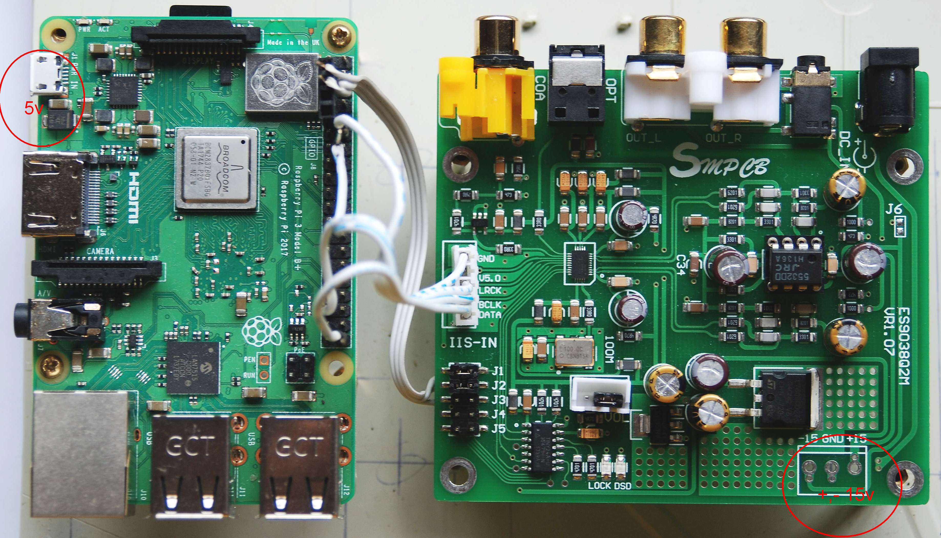

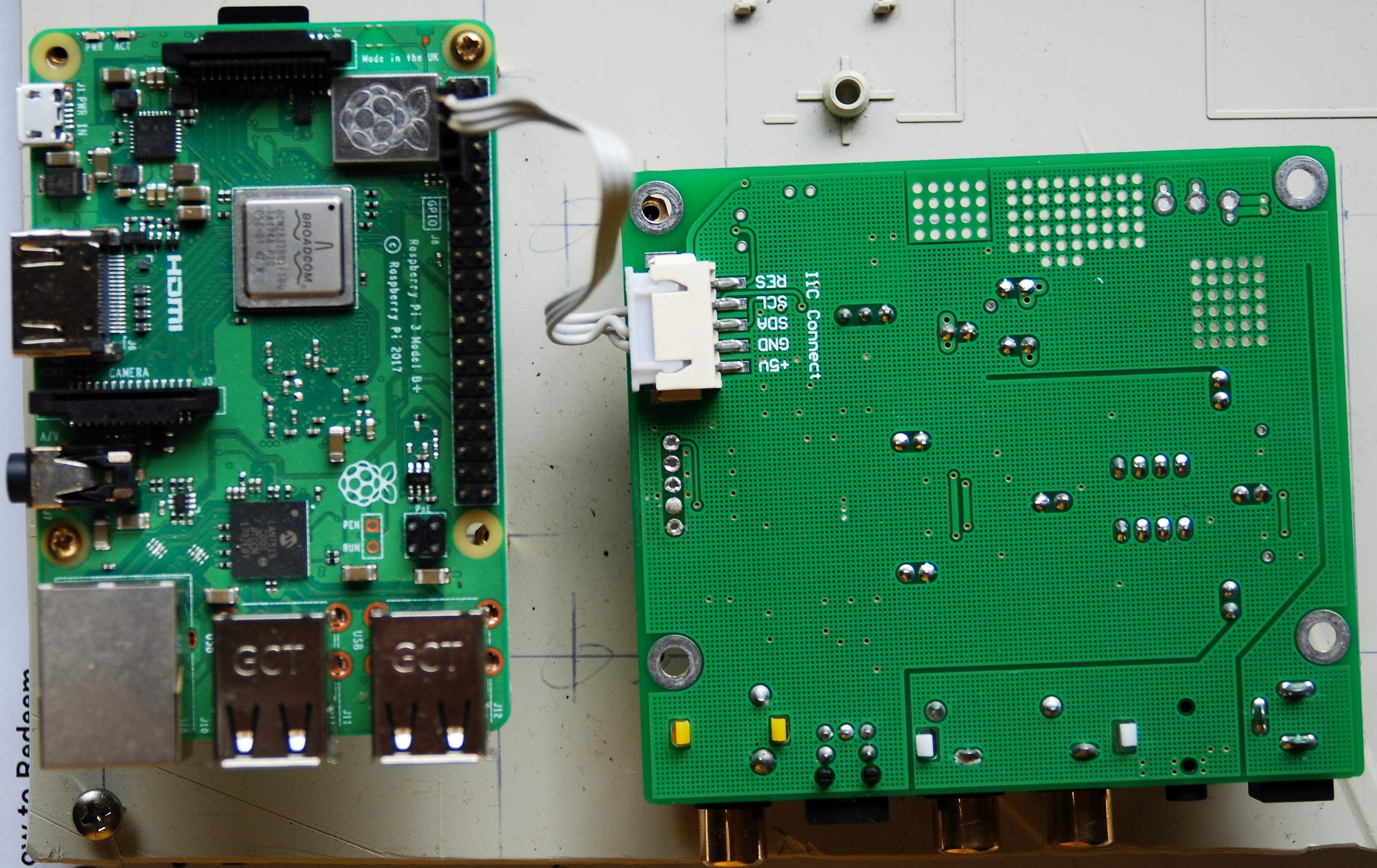

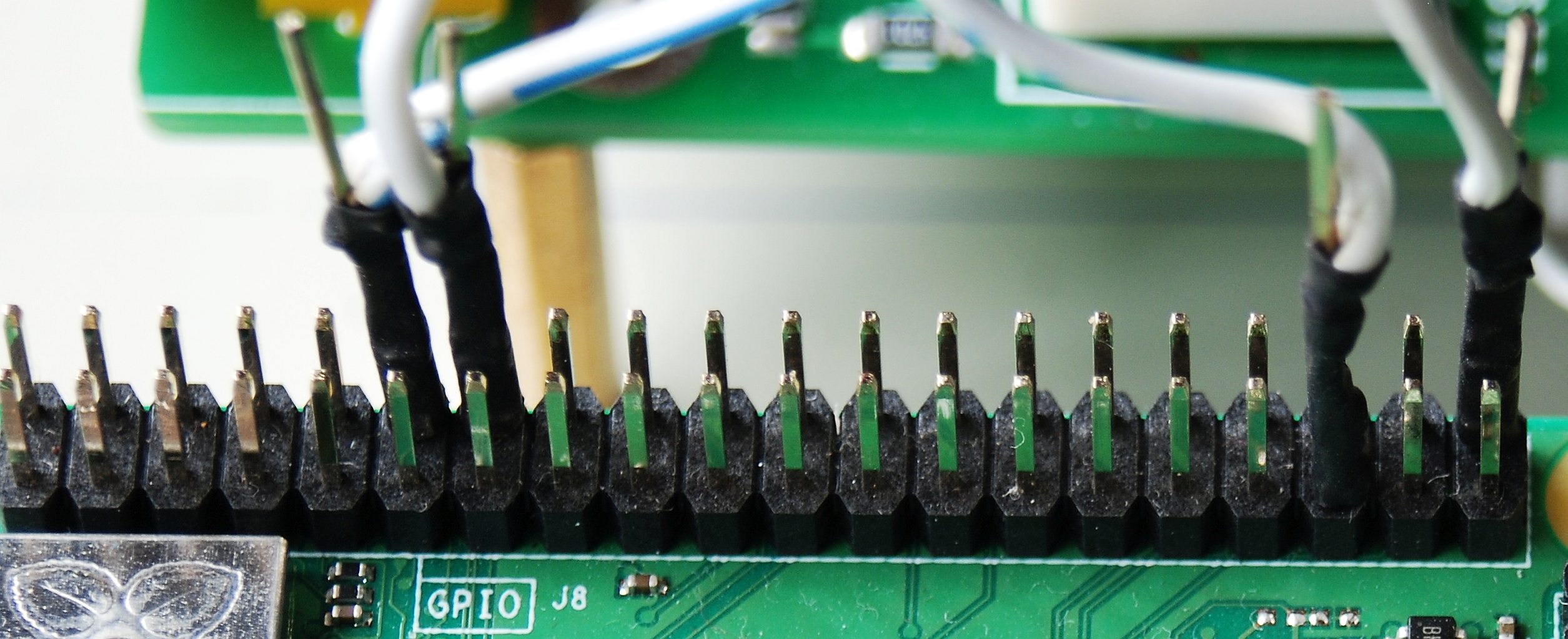

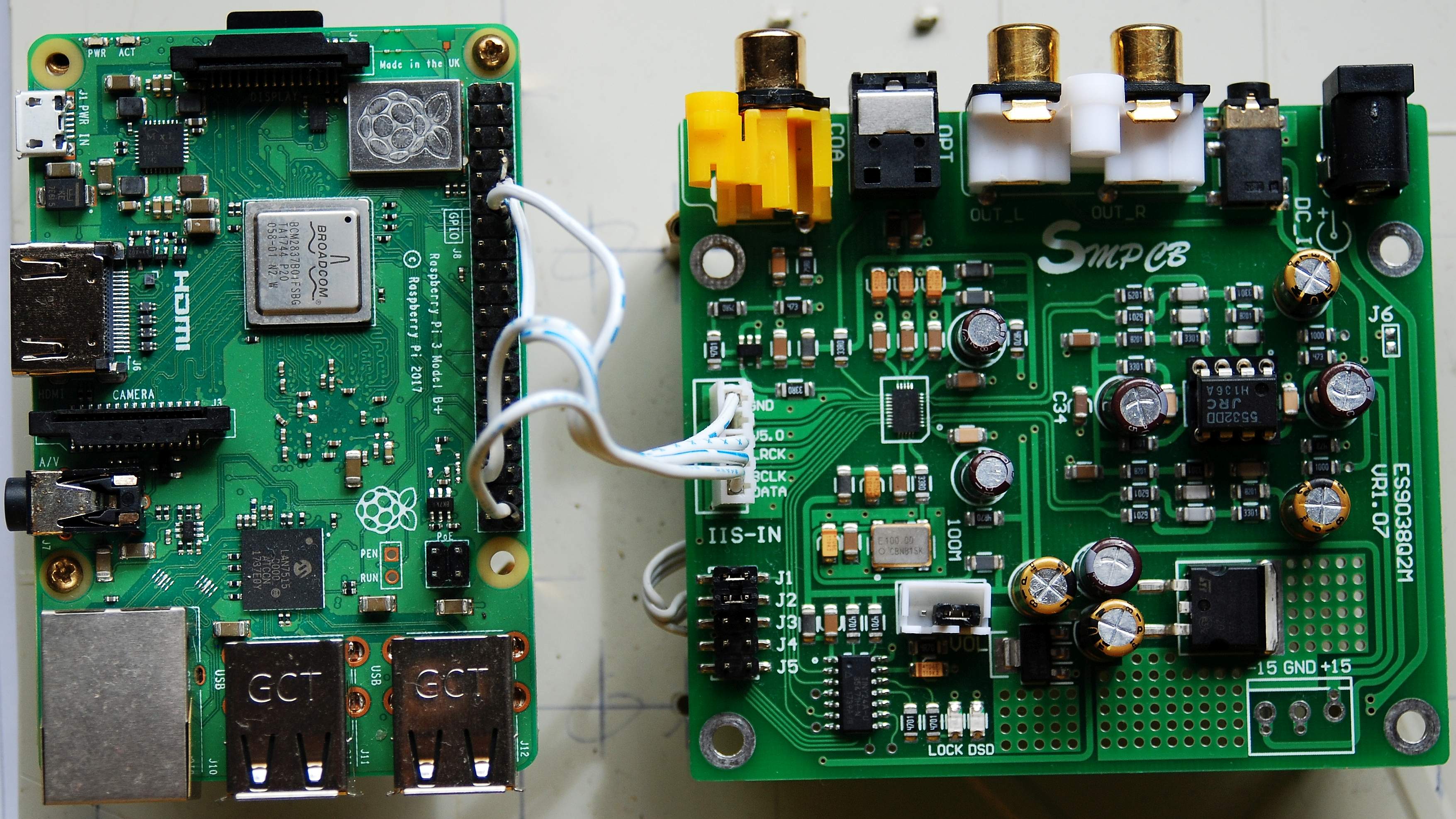

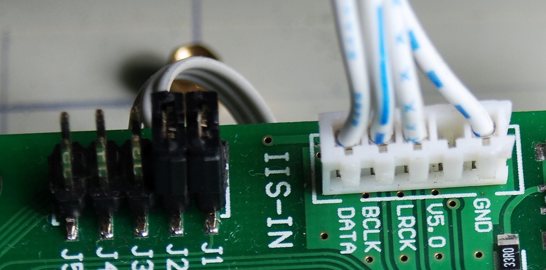

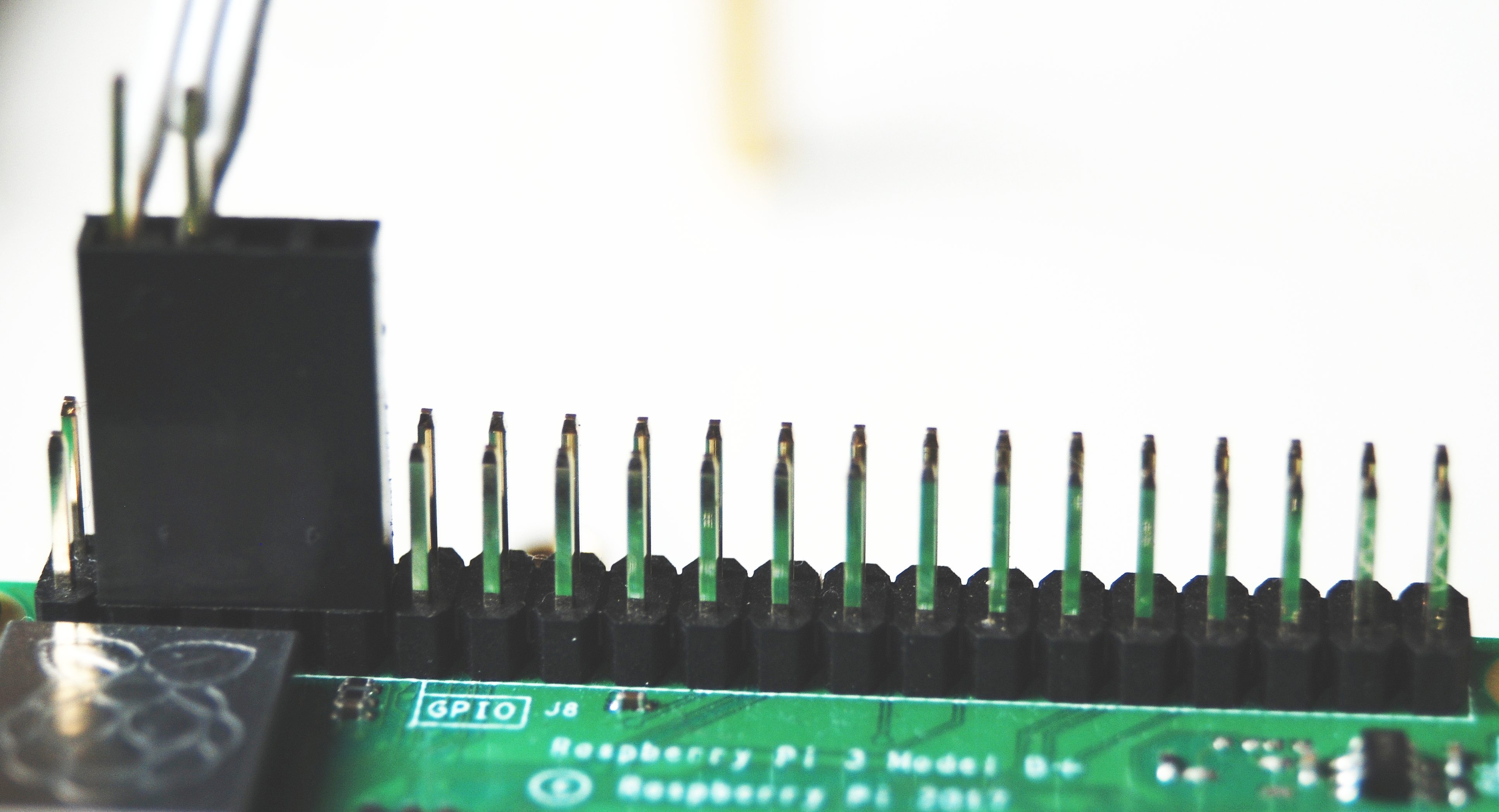

Okay, if you say so. I have one of the 1.07 boards and got a display to go with it just to try out. Display never worked with it, and installing J1, J2 did not stop the MCU. Maybe they loaded it with the wrong firmware, don't know. Anyway, it got its pins lifted.
i think you are right, the firmware is wrong, i worked on more than 20 pcs smc cb q2m boards, they are all good, may be just coincidence . here are some photos of my test module, hope they are helpful in starting on q2m modification.
