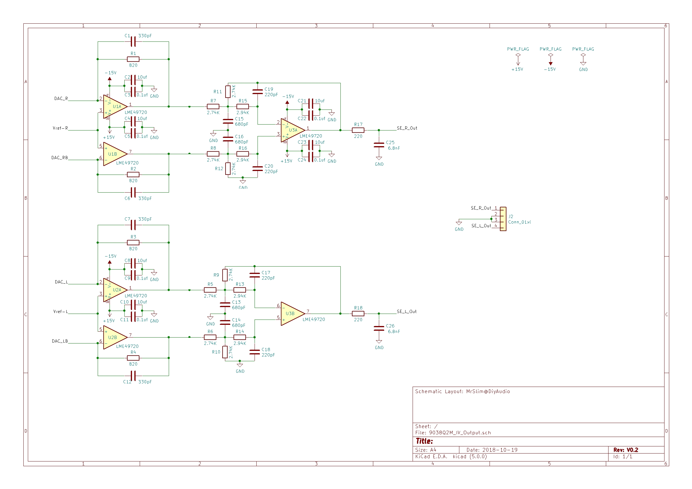

I plan to use Mr.Slim schematic on page 301, is that what you mean Mark? When using the Rasberry board and Volumio, I assume we have to hardwire a switch for those 2 buffers(pins) to swap between Volumio and the other inputs on the board? I assume the display and remote dosn't work while using the Volumio since the onboard control chip is deactivated?

If you look at the next post after MrSlim's with the schematics, regarding unbalanced outputs, you see my reaction to seeing those for the first time. Actually, what I said at first was a little different, but I edited it to make it more nice sounding. I have to disagree with taking unbalanced outputs from the I/V stages, as we haven't finished with the proper filtering. Let's do it right, then make it balanced after that, if needed.

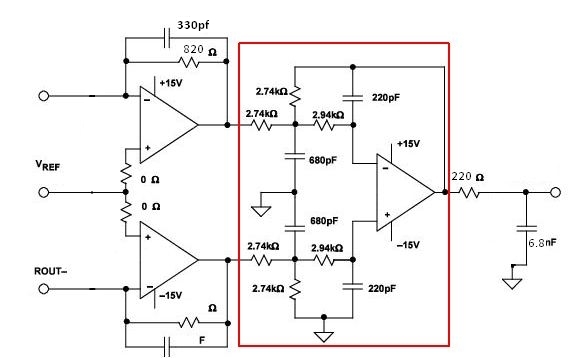

Yes. MrSlim's schematic is correct from my perspective aside from the addition of the unbalanced outputs. So, I would just say print it out and put some White-Out on the unbalanced outputs. With that in mind, it is the schematic I recommend to use when building an output stage from the instructions I wrote up.
If it helps, I can post a copy of the output stage schematic I used. It was the source that bih and later MrSlim originally started with.

Hi Paul,
Guess I should have edited the schematic before now. It does look like it might be a little easier for builders to read.

Please let us know if any problems or questions. Don't forget the output stage sound quality may be improved with film caps added to the +-15v rails. I haven't tried to figure out the minimum amount that works best (which may vary with type of +-15v supply used), but tested with about 100uf per +-15v rail.
