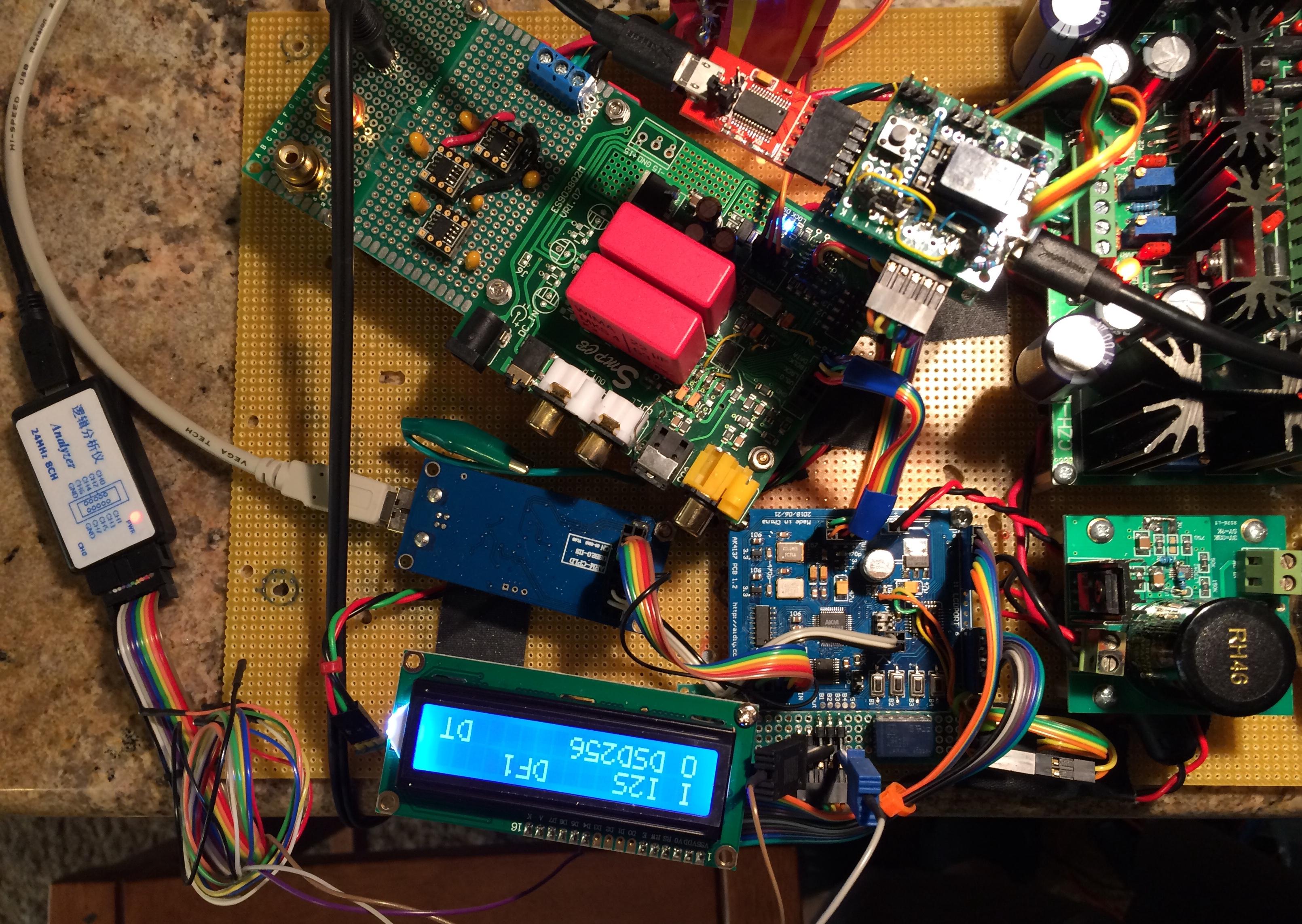

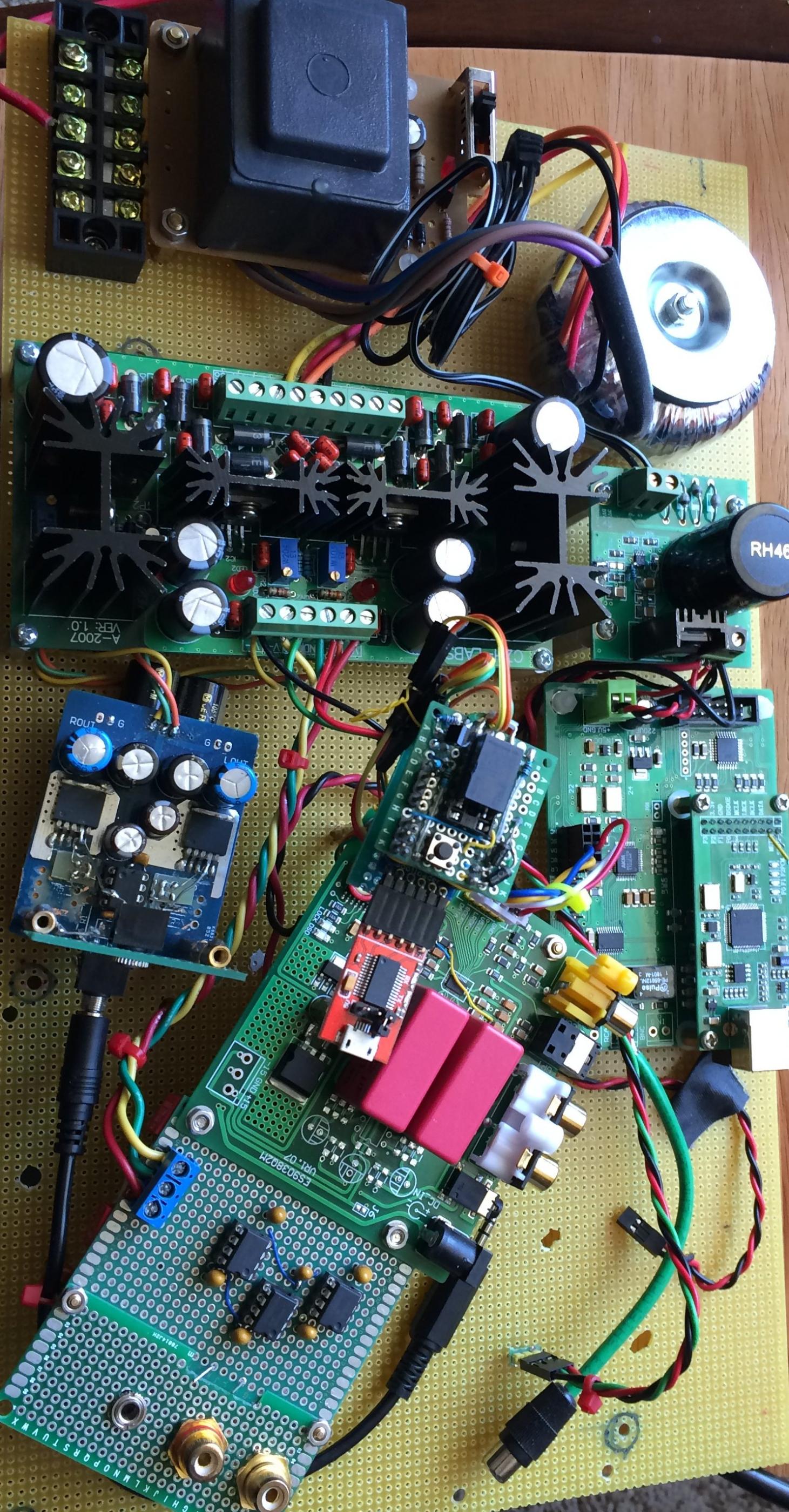

We hook up devices in this order: USB-to-I2S-board -> AK4137 board -> ES9038Q2M board. The AK4137 can be configured as desired using the buttons on the board or the button attached to the display (depending on which type of AK4137 board).
I have recommended using gold flashed or gold plated pin header connectors for I2S between AK4137 board and the dac board to help minimize jitter (it definitely helps). For the low cost AK4137 board, that means the existing output pin header needs to be removed and replaced which can be tricky. I can describe how I did it if anyone is getting close to that point. I also add some extra ground pins for the I2S connections at AK4137 and dac boards. That allows use of ribbon cable for I2S configured as G-S-G-S-G-S-G where ground and signal wires are alternated. u.fl connectors and cables might be another option.
I will attach a couple of pics below showing test setups with both types of AK4137 boards. In the first picture, the thing on the upper left corner of the dac board with the little red board attached to it is the Arduino, it's shield, and an FTDI communication board. The blue board to the left of the dac board is a modded LME49860 headphone amp board, something I also recommend doing since distortion is very low and dac board sound quality can be properly heard. Many power amps aren't really good enough to hear what the dac can do at its best. The headphone amp boards are about $32 on ebay, and the mods aren't too hard. Mostly adding a ground plane, better decoupling, and other power filtering.

I assume that outputs DSD in i2s format. It says standard, low freq and 768k crystal confifs are available. Which one should I get? Which is best? I assume standard...
DSD is output in native DSD format, using the I2S pins. Both boards understand the format and no cabling differences are required.
Regarding the AK4137 board options, most people opt for the 768k version. It doesn't matter for DSD, since the 768k option replaces the 24MHz clock with with one twice the frequency, but DSD uses the other clock which stays at 22.5MHz. A little table in the AK4137 ad should show what frequencies are affected by which clock option. If your dac chip is clocked at 100MHz as the boards we use are by default, then you can play the 768k PCM.

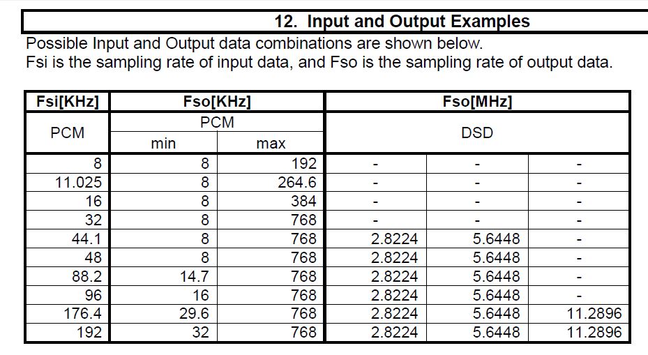

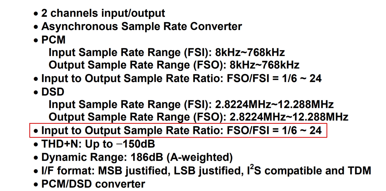

Everything is correct except that AK4137 can not convert 44.1 PCM to DSD 11.2. This can be done for PCM 176.4 and higher. PCM44.1 can be converted by AK4137 to max DSD 5.64, right?
Interesting point you raise. That table is in the example section of the AK4137 data sheet. However, I have input 16/44 PCM and measured the DSD output clock at 11.2MHz in that case. I will have to look into it some more later. Right now the dac test setup is down for some modding work.
Also, sorry for all the edits I have been doing to this post. Its very early in the morning here. :confused:
The way the DSD output sample rate is programmed in AK4137 is via one of the I2C bus registers. It can be set to 64, 128, or 256 output sample rates. DSD256 can be 11.2MHz or 12.28MHz depending on the MCLK frequency. The Chinese dac boards both use 22.5MHz clocks for DSD conversion (except the the low clock frequency version of the low cost board), which would make DSD256 come out at 11.2MHz.
Also, for 16/44, BCLK should be around 1.4MHz = 2-channels * 16-bits * 44.1kHz.
According to the blurb below in the AK4137 data sheet, for DSD output mode FSO/FSI can't exceed about 24. Well, 24 * 1.4MHz is easily more than 11.2MHz, so 16/44 would presumably be in the range that can be upsampled to DSD256.
That is the only interpretation of the data sheet I can think of at the moment that would explain why 11.2MHz DSD comes out when 16/44 goes into AK4137.

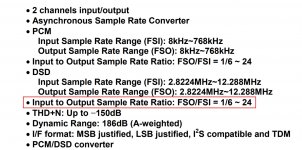

Ok, please check this out. I was sure of this (I'm not now), because the Chinese sellers on ebay and aliexpress mention this in a somewhat strange way:
"Note: When the input PCM signal is lower than 44.1K, it cannot be converted to DSD, nor can it be converted to a higher sampling rate of PCM. When the input PCM signal is lower than 176.4K, it can output DSD64. DSD128 can't output DSD256. " I think that the author had in mind: When the input PCM signal is lower than 176.4K, it can output DSD64 or DSD128 but can't output DSD256.
And "similar" information is here: 6moons audioreviews: Lindemann musicbook:15 dsd
"For a quick graphic representation of the various up/resampling options, we see, in CD mode though it's the same for USB file/streaming, native playback as 44.1-->44.1PCM; we see PCM44.1 rendered as DSD128, then maximally upsampled to DXD aka PCM352.8. In USB mode, we see an original PCM96 file rendered as DSD256; and finally the same 96 file first upsampled to 384 in PureMusic (replace with Audirvana, JRiver Media Center or similar), then rendered as DSD256 by the musicbook. By implication, any 128/256/320kbps MP3 streamed via Spotify & Co. can be upsampled to DXD or resampled to DSD128.
When the Lindemann is set to native, feeding it an already upsampled signal achieves otherwise missed target rates like 88.2/176.4kHz or 96/192kHz. When set to DSD, it renders Redbook files as DSD128. Upsampling those CD files to just 88.2kHz in player software then ups them to DSD256. If PCM upsampling is desired, the user decides whether to do it in 64-bit math with one of the many software players for Windows/Mac; on chip in the AK4137 SRC; or both. Physical discs obviously can't be pre-upsampled. They will always only render as DSD128, never as DSD256"

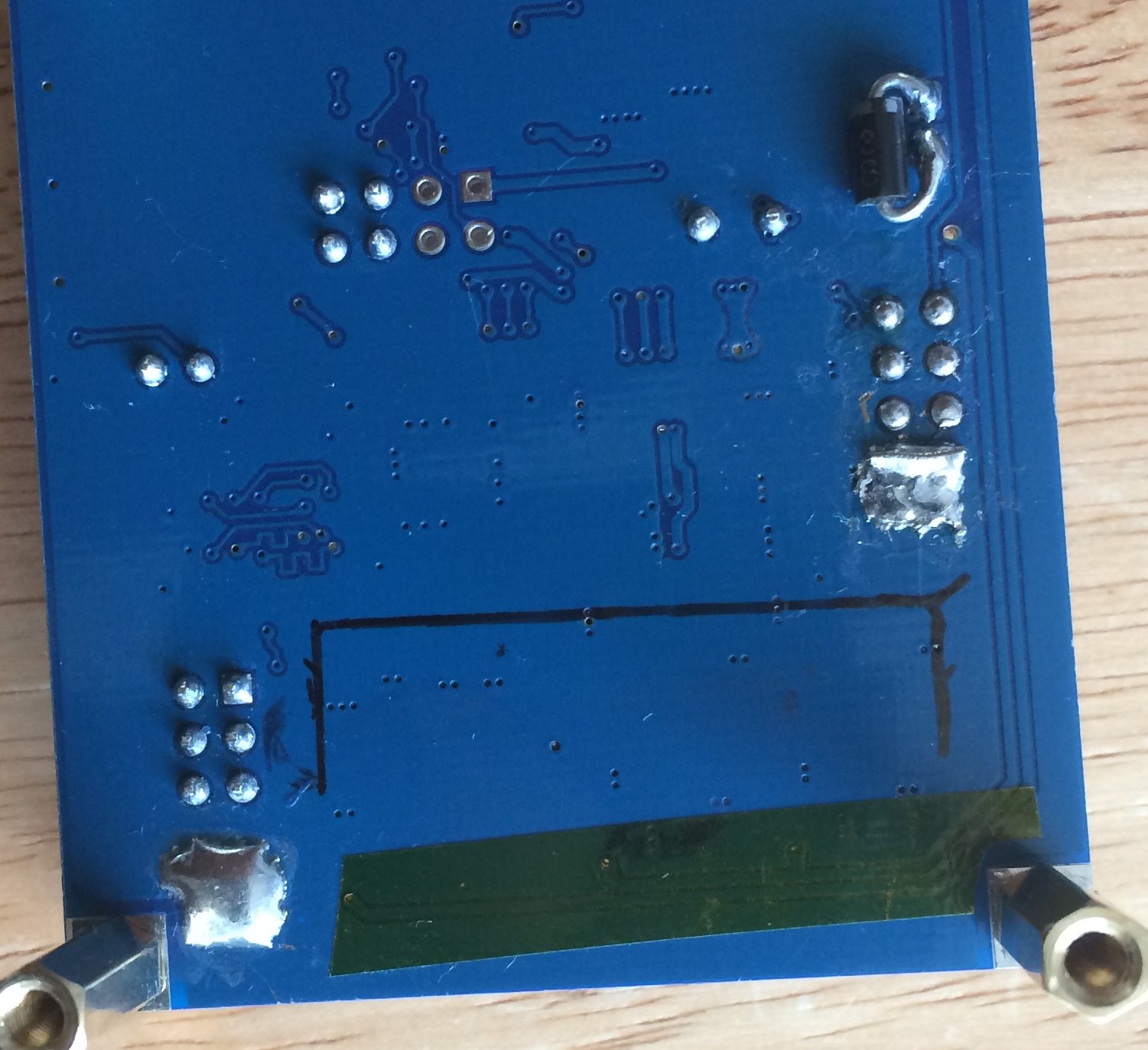

I definitely will take a bit more detailed look next time I have a chance. Won't be for at least a few days probably.

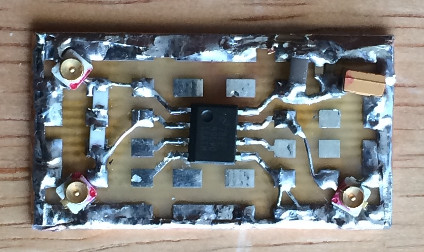

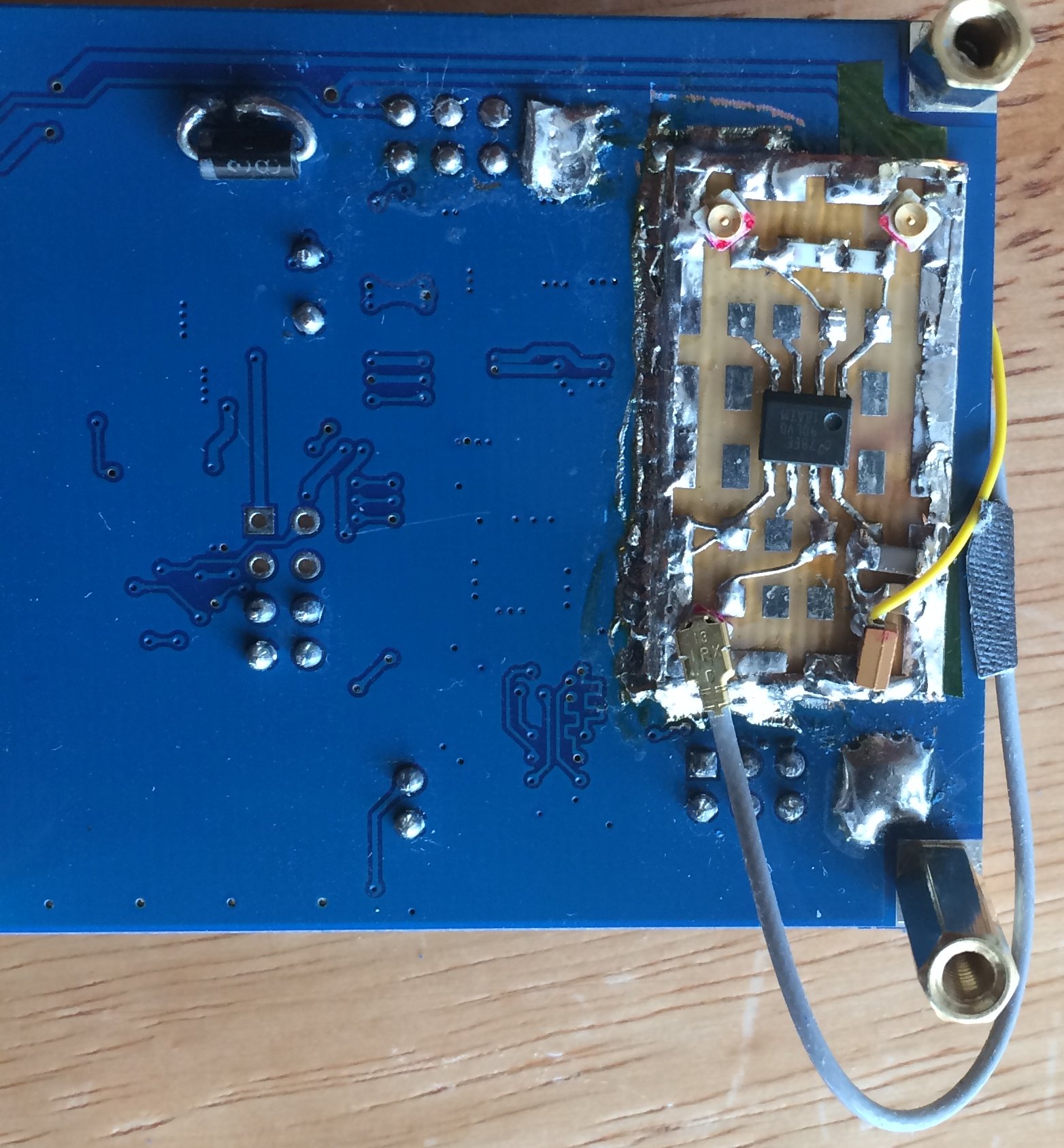

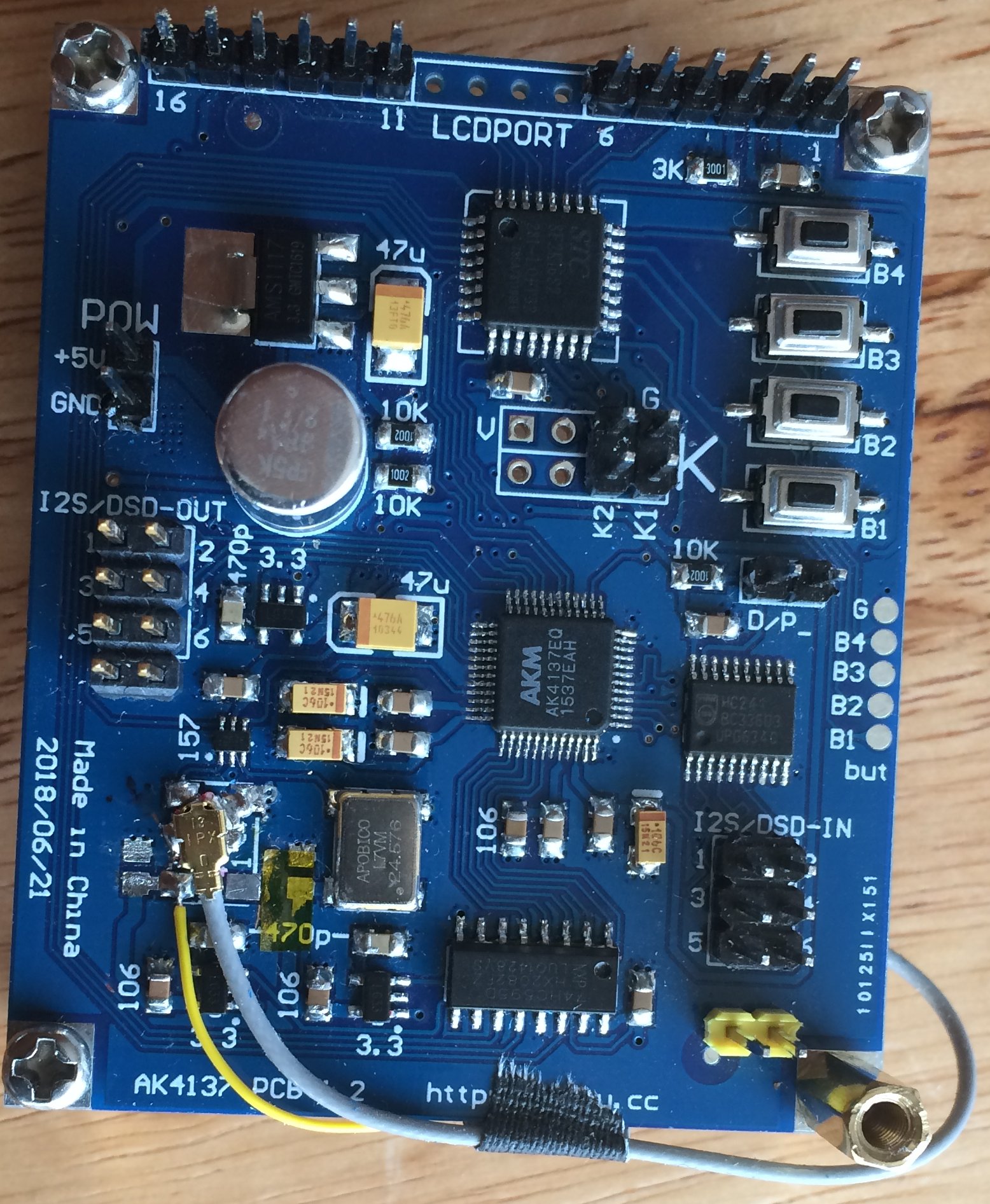

I did, however, do an experiment recently. I replaced the 22.5MHz clock with a 25MHz clock on one of the AK4137 boards to see if DSD conversion would still work at a slightly high and nonstandard sample rate. It did work, ES9038Q2M played the DSD output, and the DSD clock was measured at 12.5MHz. Nothing amiss, no muted or blanked output. As usual input source was a CD rip.

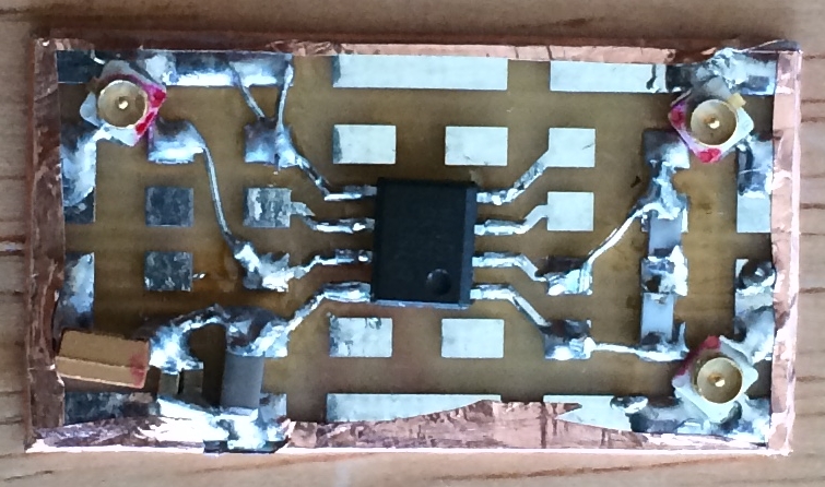

In the meantime, and before I can get back to subject of input and output sample rate limits, I have some other work to get finished up.
Returning for the time being to the jitter tests with a clock divider that I want to run, I have a few more pics showing how one of the AK4137 boards is being modded to allow external clocking. A LDVS to LVCMOS adapter board was constructed and attached to the back of one of the AK4137 boards. The output of the adapter replaces the output from a removed clock module. Power for the adapter board comes from the dedicated clock power regulator.
