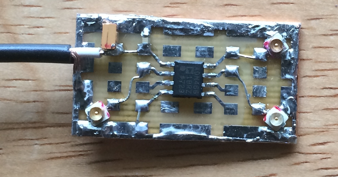

Just finished constructing a little LVCMOS to LVDS transmitter for driving the clock divider chip. It uses an ADN4661 High Speed Differential Driver. Also, considered using what looks like a possibly better choice, MAX9112 LVDS Line Driver, but it comes in a SOT-23 case which is smaller than part I used. Would have been a lot more trouble to use the smaller part instead, although could probably do it if necessary. One of the things to think about in trying to test out the clock divider is that every extra bit of added circuitry is likely to introduce some of its own jitter. From that perspective I would like to keep it as simple as possible.
Anyway, will try the new little adapter board located near the dac chip MCLK output and see what happens.
A pic is attached below. It can be seen that construction is very similar to the LVDS to LVCMOS receiver now attached to the AK4137 board. A coax power cable can be seen exiting to the left. There is also one u.fl input on the lower left, and differential outputs on the right.

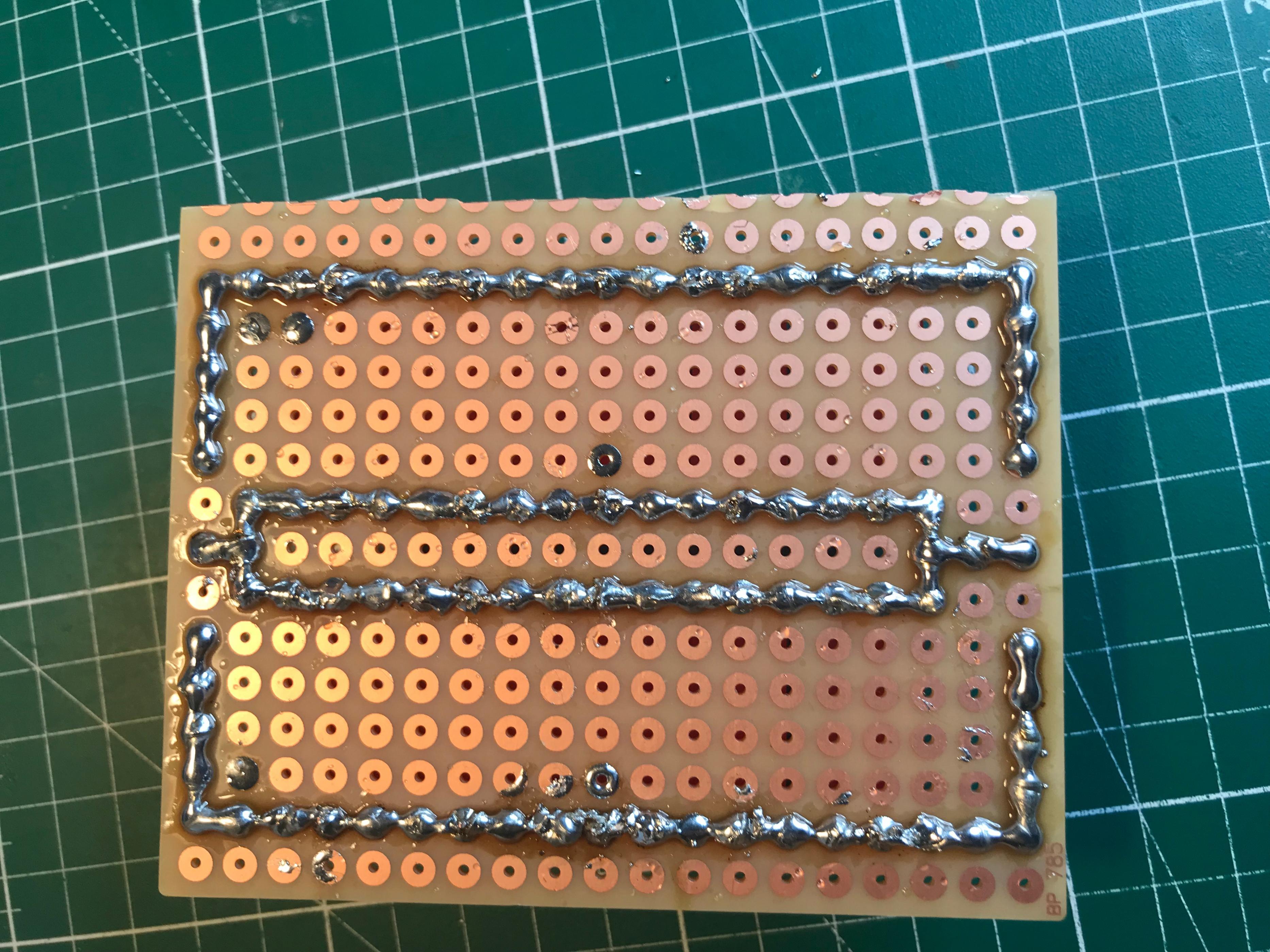

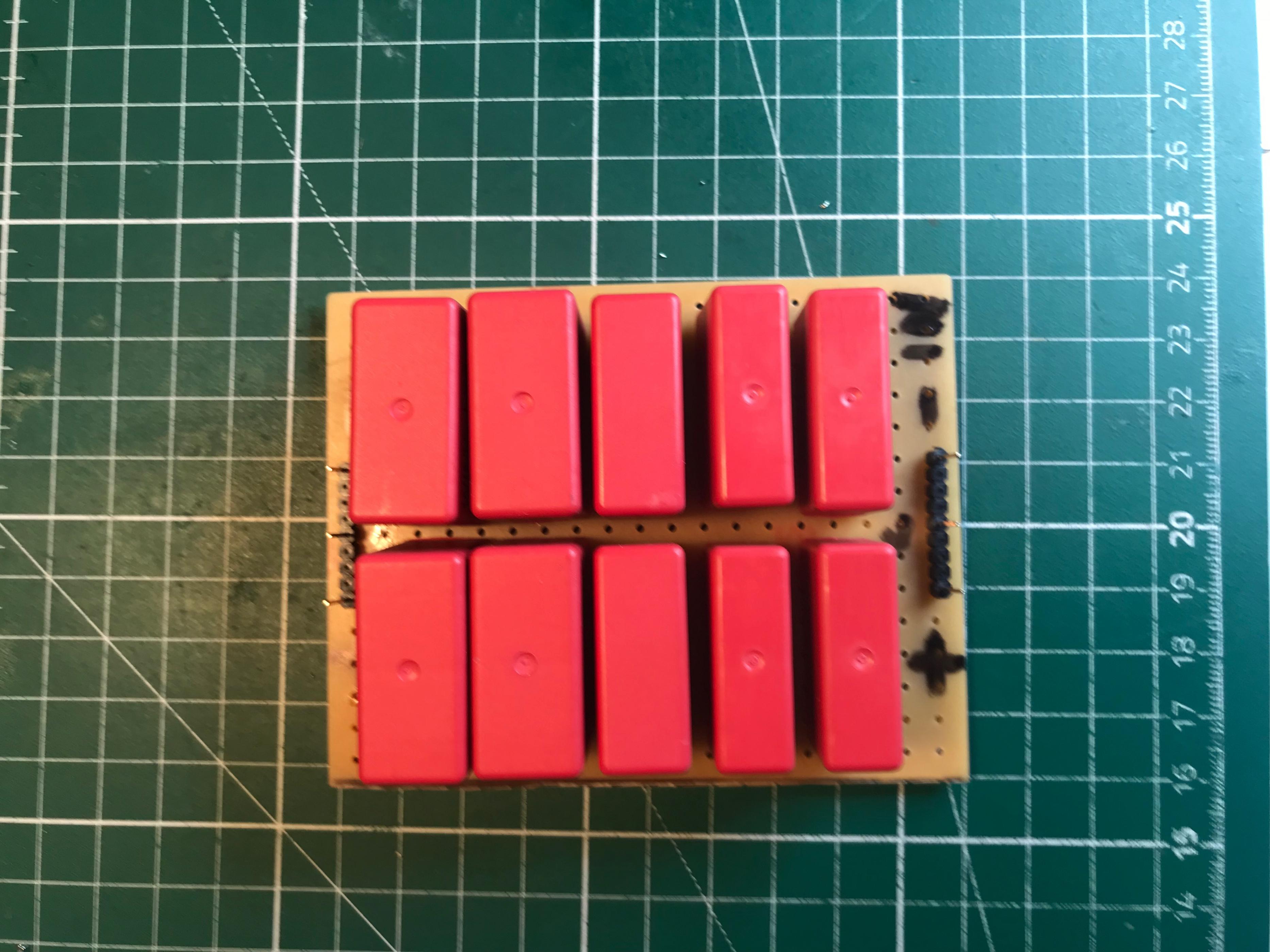

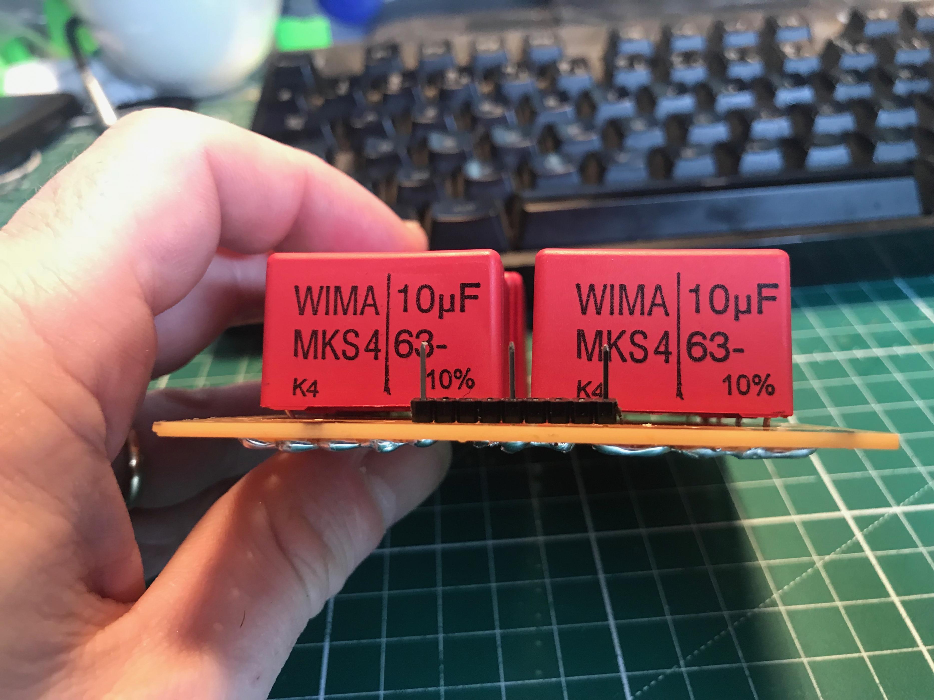

I received yesterday the wima film caps.
My solder lines on the perfboard are really dirty(It is my first use of perfboard).
Please tell me if it is the right way to go or if I am wrong.

Hi Terry,
Katana won't sound its best IME until powered as I last described with linear supplies and the film caps you have there. Makes a big difference from 2 or 3 SMPS. Katana with SMPS only is inferior and easy to beat. Same goes for any other dac that uses SMPS with only one exception I know of and that is Benchmark DAC-3. For the $2,200 price, they can afford to put a lot of engineering into a combination of preventing and cleaning up SMPS noise. I have never seen it done successfully at lower cost.
Looks like you have soldered the film caps correctly. You should probably practice cleaning up where you got some solder in places where it should not be. I would use Chem-Wik solder wick to clean up and remove excess solder. The most useful size is probably like this: Chemtronics Desoldering Braid, Chem-Wik, Rosin, 10-50L 0.10", 50ft. - Solder Braid - Amazon.com It is a good brand, but in some cases a little extra electronics paste flux can come in handy, especially for difficult solder removal jobs. Amazon.com: MG Chemicals 8341 No Clean Flux Paste, 10 ml Syringe by MG Chemicals: Home Improvement Doesn't take much, use sparingly, or you can clean up with alcohol if necessary. 824-100ML 99.9% Isopropyl Alcohol, 4.2 fl. oz. Bottle: Amazon.com: Home Improvement
The other thing to be aware of is that pre-tinned perfboard is far superior for soldering than the bare copper stuff. I probably should have mentioned that before. Sorry, it didn't even occur to me. I never use the bare copper stuff which is junk in comparison to the tinned/plated type. The better perfboards are usually green color and the holes are plated through the inside for best solder penetration. AUSTOR 100 Pcs PCB Board Kit Including 30 Pcs Double Sided Prototype Boards and 30 Pcs 40 Pin 2.54mm Male and Female Header Connector(Bonus: 10 Pcs 2P&3P Screw Terminal Blocks and 30 Pcs Jumper Caps): Amazon.com: Home Improvement
Hi Terry,
One other thing, from looking again at the picture of your soldering, it is not clear if you used a piece of wire tie adjacent pins together or tried to do it with solder bridges? The correct way would be to lay a long piece of wire along all the holes you want to solder together. Then solder one end, pull it tight and solder the other end or the next corner. Then you can just go down to row soldering all the cap pins in the middle one by one. If you run out of flux trying to heat a joint, or don't use a big enough tip or enough heat then you may get some of the ugly looking Joints like you have in the middle.
You could wick off the bad solder, with or without some added flux, or slowly add a bit more solder which will add some flux and try to get the rough solder to flow into a smoother shape. If it is too hard to heat quickly before the flux burns off, you need a bigger tip and or higher temperature to get the solder flowing and done more quickly.
It is something that takes some practice and experimentation if you are learning alone. If you have someone more experienced to demonstrate learning can go much faster. Youtube videos can help too.
Remember, connections and solder need to be clean for soldering to work properly!!! Oxidized copper or dirty oxidized solder are bad. Clean off the copper with a scouring pad and thoroughly remove any residue of using bare copper perfboard. Gently wipe off solder wire with a folded paper towel or equivalent until all the dark colored junk stops coming off on the paper.
Then try to solder fast, using a big enough tip and enough heat to get in heat, flow solder and get out. They always say to heat the joint then touch the solder to the joint not the iron. Doesn't always work unless the iron tip is freshly cleaned and tinned with solder. Once the flux wears off the tip will be dirty again. It happens in seconds. Soldering is about constantly wiping the tip clean, touching it to a joint, maybe touching a tiny bit of solder to the tip to wet it them quickly move the solder back to the joint.
If you look at the video I posted a long time ago of soldering an SMD IC, you could see it happened very fast. I got the solder flowing, fed it in where I wanted it to go and go out fast. That's the kind of thing to experiment with and practice. Its not perfect work, but if you want to look the link is here: Dropbox - SMD Solder.MOV
You may notice that any solder applied to the tip to wet it tends to flow away from area you are trying to heat to the other side of the tip. That's because solder flows to where there is more heat and that side of the tip isn't being cooled by trying to heat the joint. I compensated for that by rotating the iron in my fingers a little to bring the side of the iron with the solder around in to contact with the joint. Once it wetted the joint, heat transfer improved and solder went where it was supposed go.
