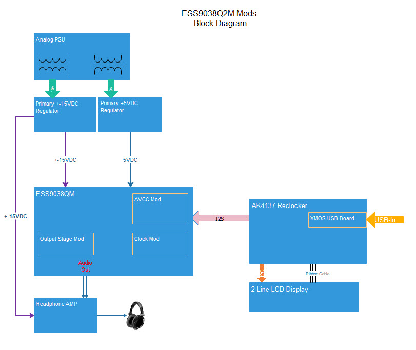

@ Markw4
hi, there,

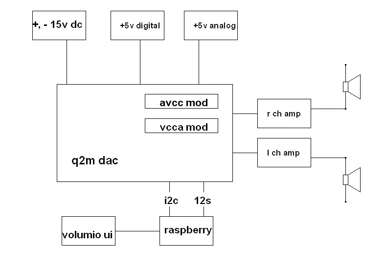

can you post a functional block diagram of your system, i wonder how the ak4137 works on your system.
cheers
I've been following along in this thread, but have yet to start this project. In response to your query eslei and my own planning, I drafted the following diagram. This only shows the 'primary' mods that I'm aware of, realizing Mark continues with other 'minor' mods as well. I hope it's accurate enough and I will defer to Mark to point out any mis-representations, or other significant mod I missed. (I hope I got the voltages correct.)
My particular version planned is to add a RaspPi and use I2S to the reclocker in lieu of the XMOS USB board and have the audio output switchable with PRE-out. How each of these is implemented is obviously up to the individual user following Mark's more detailed instructions throughout this thread.
redjr,
Your diagram looks pretty good. The only things I would probably add would be +5v power also going to the AK4137 board, and then three LT1763 3.3v regulators soldered onto the dac board ground plane down at the digital end for the clock, for dac chip VCCA, and for DVCC.
Maybe good to label the AK4137 as a Sample Rate Converter rather than a reclocker, too. It is a SRC and PCM<->DSD converter.

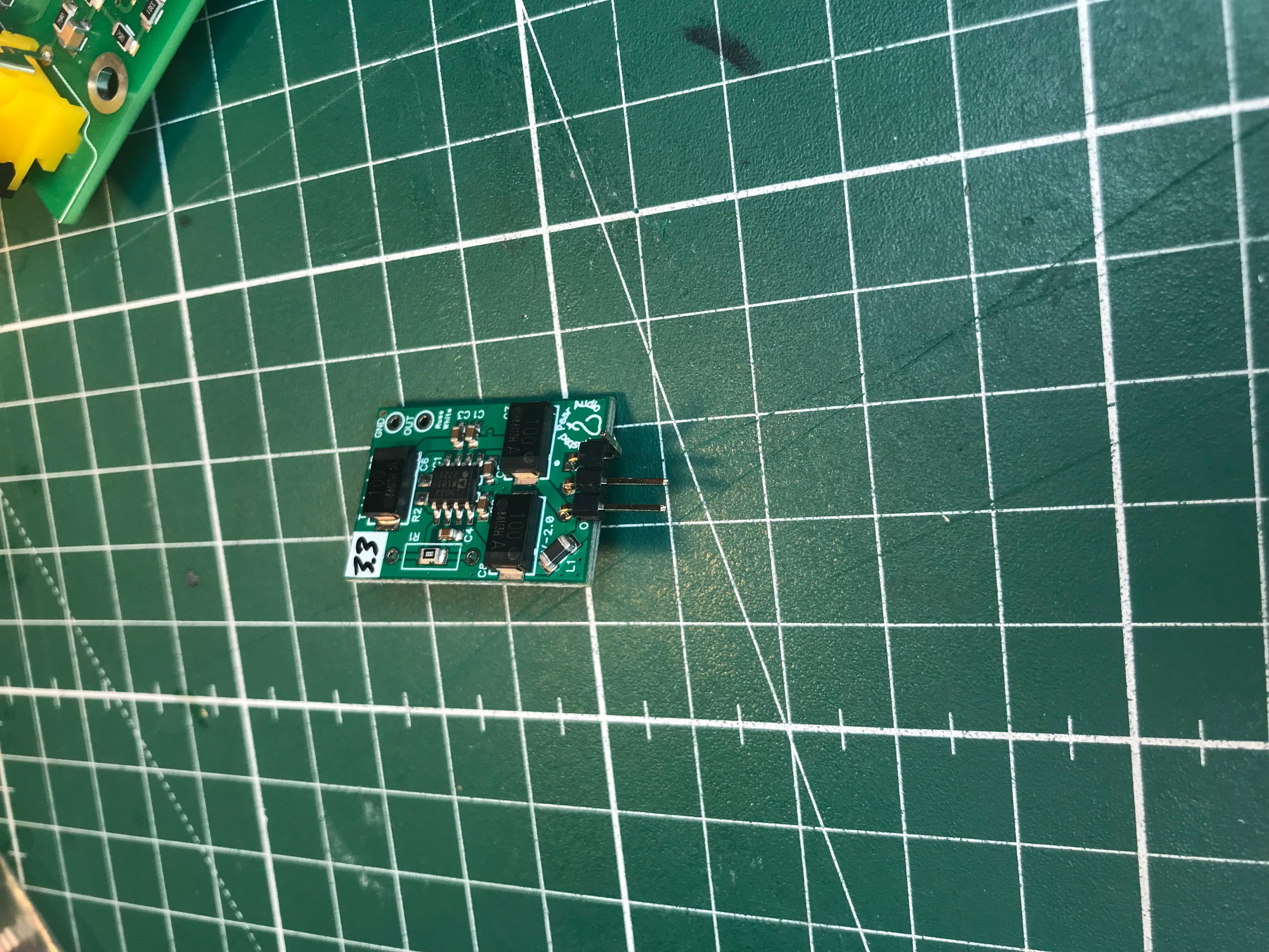

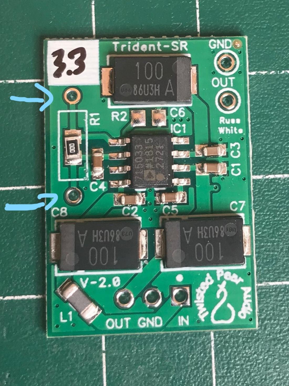

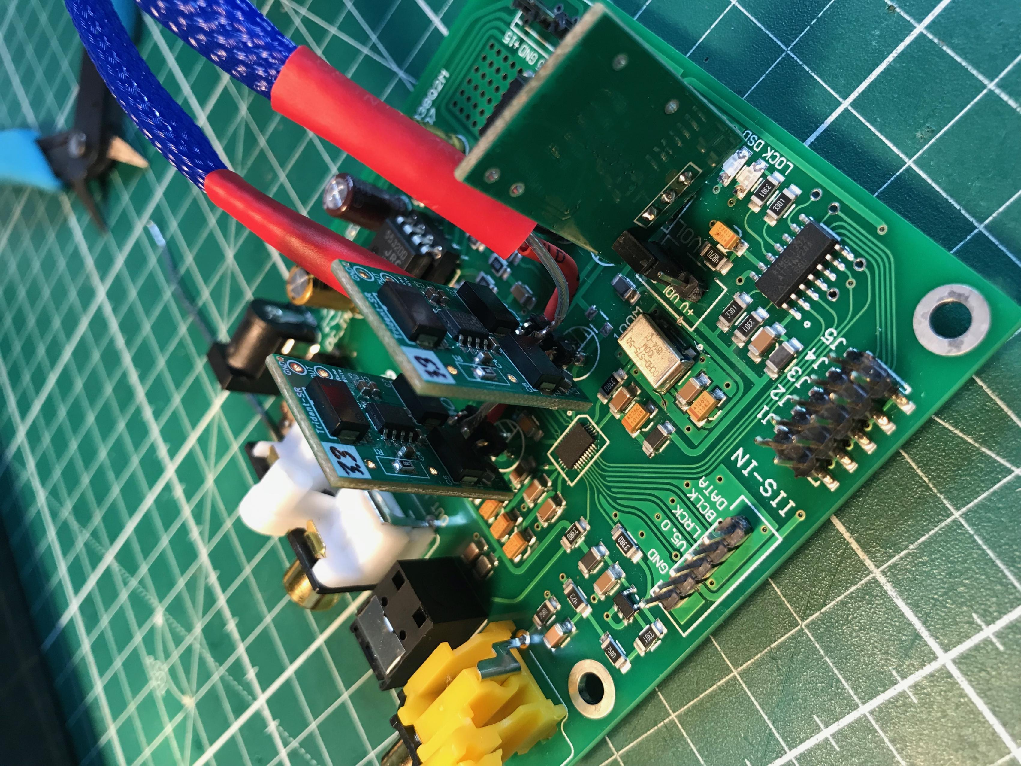

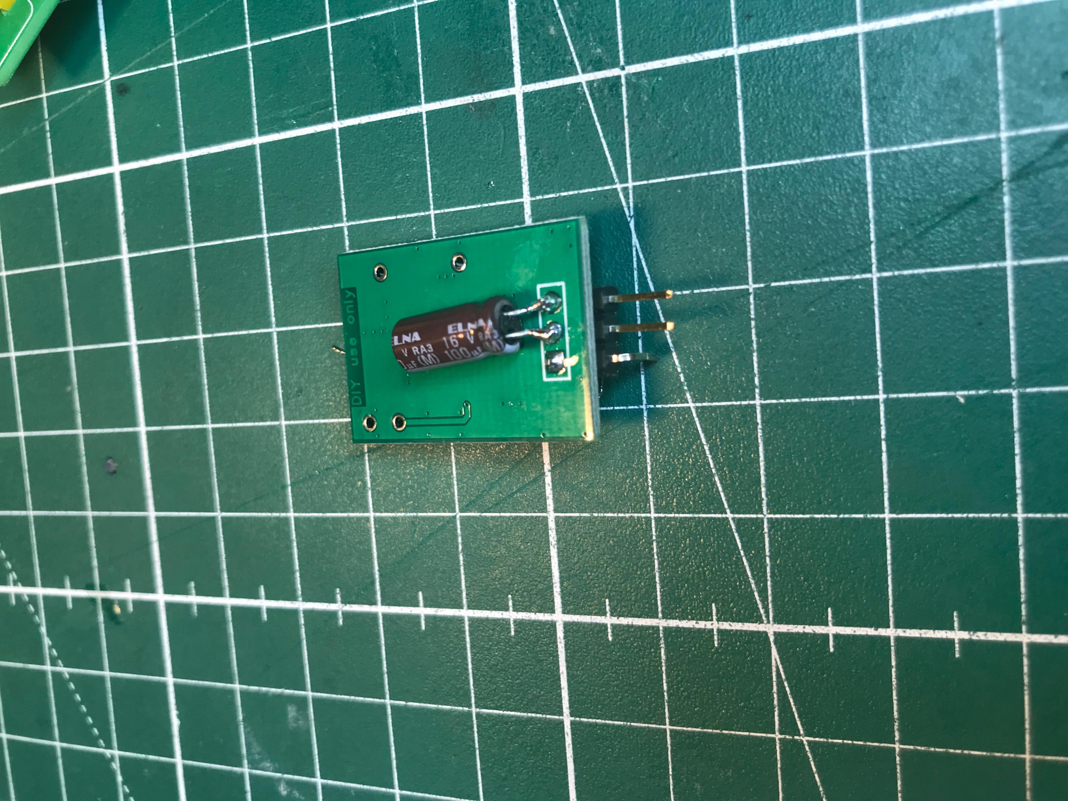

Hiu Guys,
I just received my TP 3.3v regulators, and as I can't find no documentation, I have some questions:
-Do you know what are the 2 connectors on the left?
-Does the out & gnd on the bottom and the ones at the upper right can be used indifferently?
thank you.
Hi terry22, Twisted Pear has their one forum here:
https://www.diyaudio.com/forums/twisted-pear/
You can ask question about TP regs probably at the Buffalo topic: Introducing the Buffalo III-SE-Pro 9028/9038
There are no connections on the left side, but you can use a through hole resistor instead the original smd-one or just install a jumper over there.

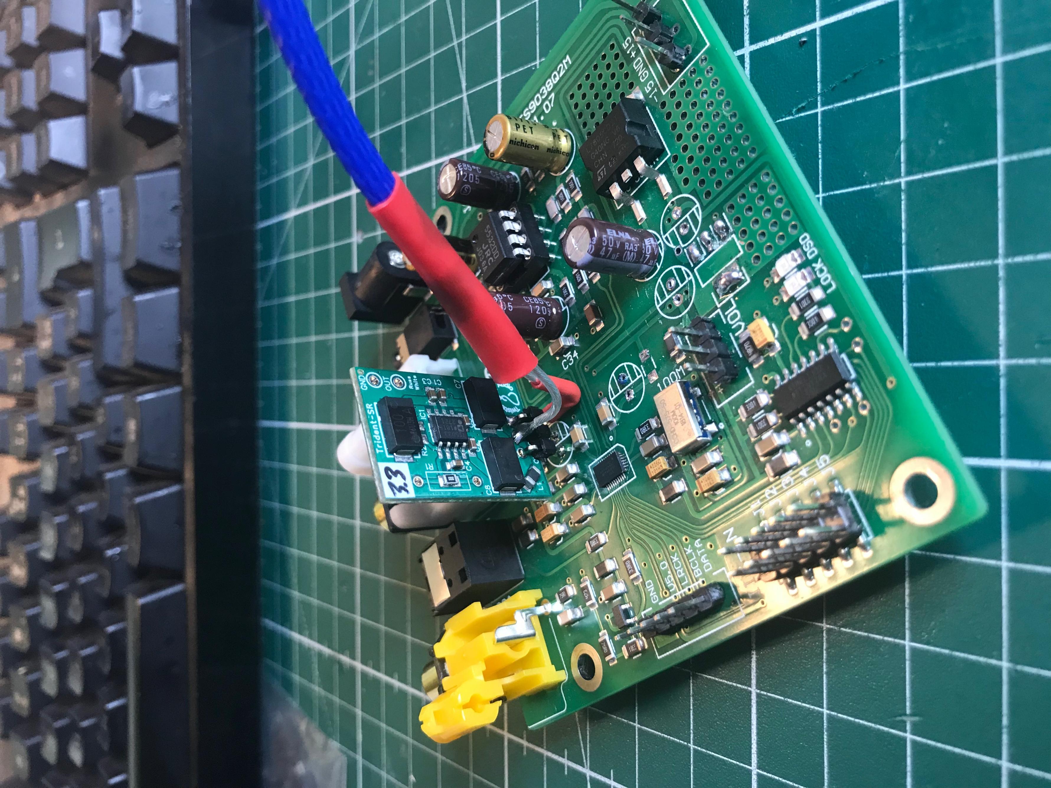

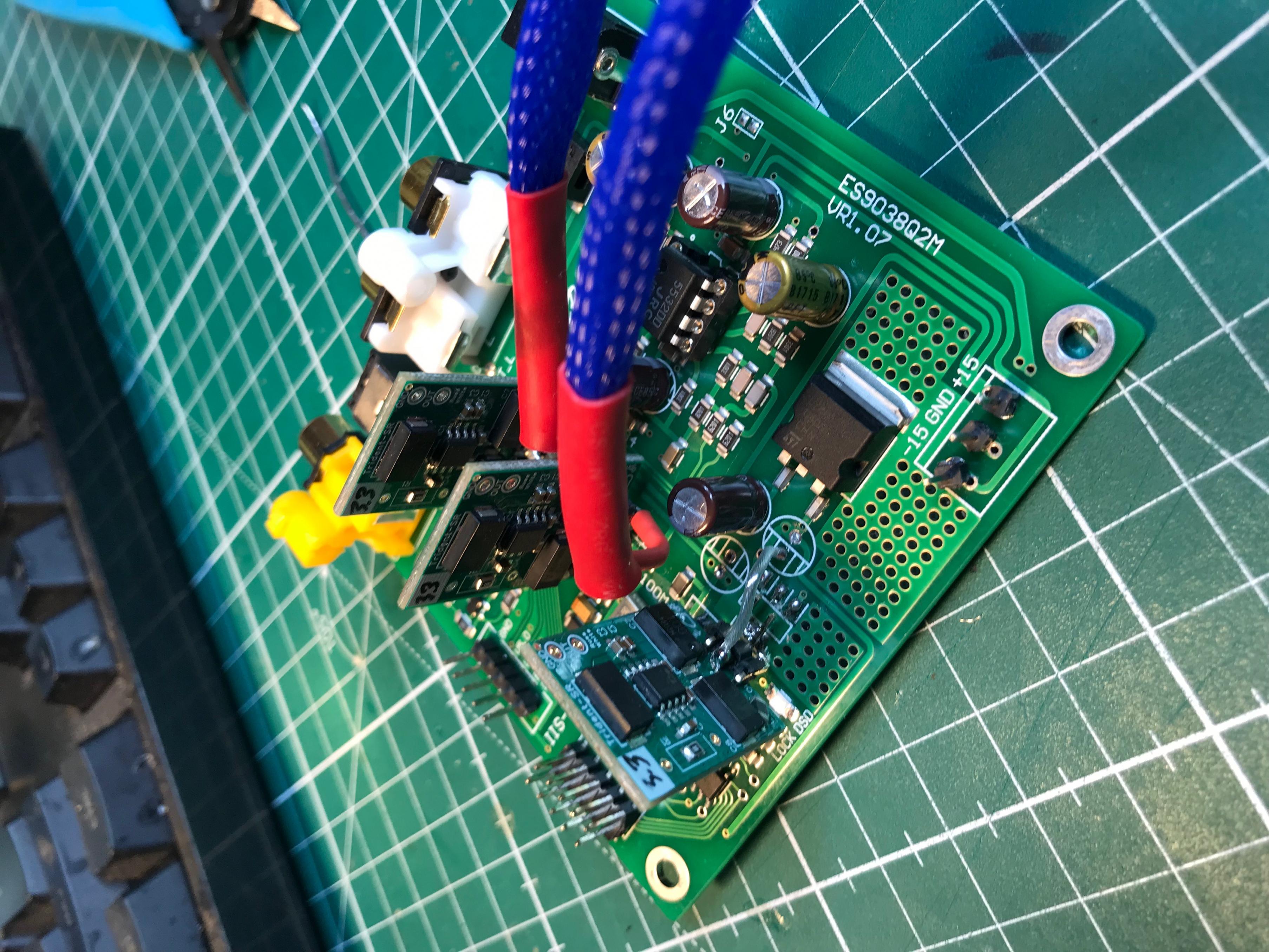

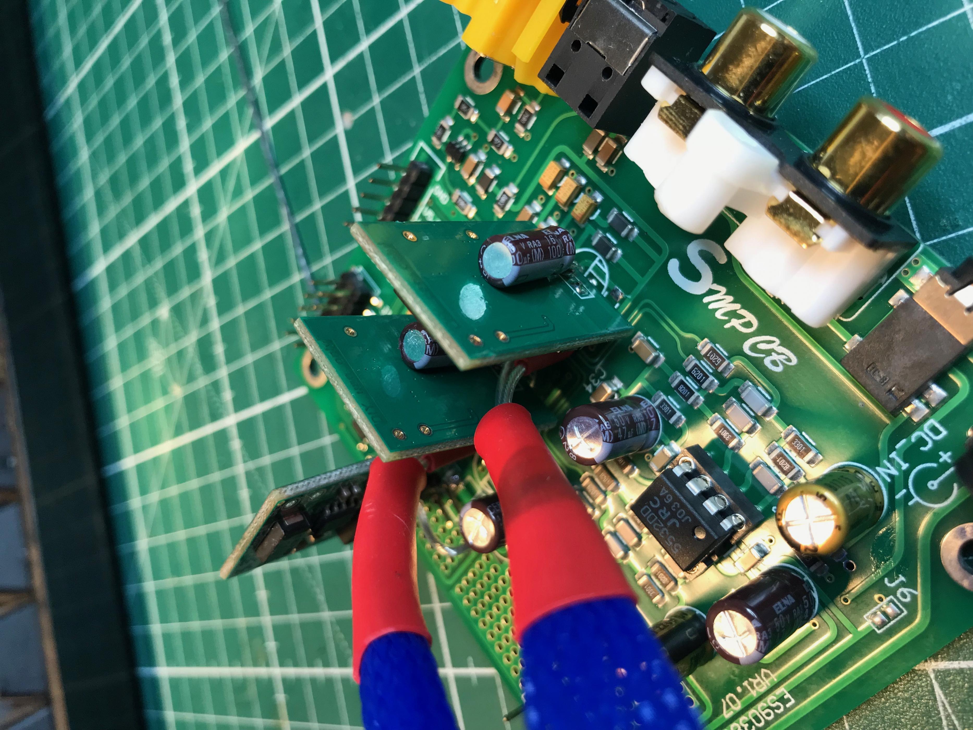

thank you about the resistor stuff info, Janos.
the more convenient for soldering the regulator were the 3 connections at the bottom. I added a 100uf cap as advised by Serge.

Terry22,
Looks like you didn't order the TP regulator they recommend for AVCC. The one with AVCC in the name and that has two regulators on it is the one they recommend. It is also programmed for 3.6v rather than 3.3v. The higher voltage is probably okay, it is not the exact voltage recommended by ESS, but it is within the maximum limits.

Hi Mark,
Yes I know, but on TP website it is said that their avcc module is basically 2x3.3v regulators joined and boosted to 3.6v.
So, as ess recommends 3.3v, I ordered 2 regs for avvc and 1 reg for dvcc.
Do you think that it is someting better in their avcc module that makes a difference?
Looks like you have soldered the film caps correctly. You should probably practice cleaning up where you got some solder in places where it should not be. I would use Chem-Wik solder wick to clean up and remove excess solder.
I tried to clean the board with chem-wik, but with this board the solder really sticks strongly to the board copper and I was not able to remove it...
I will try again with a larger irin stick, but it was really difficult.
You won't be able to remove solder to leave only copper, but that's okay. The idea to remove any excess. Using some extra flux may help, as may using a larger tip and laying it down more flat on its side to make really good contact with the solder wick. If you can get most of the excess solder off, that is about as good as could be expected.
You could probably also remove some excess solder on some of the joints that look rough (cold joints, as they are called) and then add some fresh solder to replace it. Heating solder too slowly so that the flux burns out before you are done heating will also produce joints that don't look good. So-called 'cold joints' can be produced by not enough heat, or from heating too long and burning out all the flux. Either way, it can usually be fixed, by reheating if still some flux left, or by removing most with solder wick and resoldering with fresh solder. Extra flux, usually electronics paste flux can be helpful for difficult solder removal jobs.
Don't know. I think they use ADM7150 regulators on the AVCC board, maybe with some extra filtering. If the same regulators on the other boards, then presumably any difference would just be the small voltage difference and maybe some extra filtering.
They are not talking of extra filtering. If it was the case, I ordered the AVCC-SR of course. If someone has the info, tell us please.
Ok, thank you Mark about the "cold joints"
I had set the iron tip colder, cause I had read that the wima caps don't like too much heat.
And I forgot to heatup the soldering iron to make the lines after soldering the caps.
