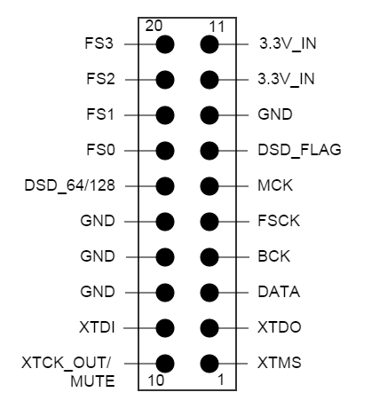

It occurred to me later that the more expensive AK4137 board has two modes of operation for XMOS or Amanero that are set by holding down the selector button during boot up. They tell you not the change the clock frequency settings there or it will stop working. Also, it reads the mute pin from the little USB to I2S plugin boards. That was something I noticed when tracing out the pins that are and aren't used on the USB to I2S header socket. IIRC, maybe three or four signals come out on one side can get routed to AK4137. The other pins that are monitored go to pins on the MCU. Mute is one of those, again IIRC. Pretty sure you should be able to get that working one way or another. Especially so, if you trace out all the pins that go somewhere on the AK4137 board. I did it once out of curiosity, but didn't make a map or any other documentation for reference. It's not hard to do though. A DVM with an ohm function can be used to help, especially if it can be set to beep for continuity checks. Between looking at traces coming out from under the header socket on the top and the bottom of the board, and using a DVM to help trace them, it should be possible to make a list of all the pins that might need signals for the board to work correctly.
The same thing can be done with the low cost AK4137 board, although it uses fewer pins from the USB to I2S boards, exactly how it uses the pins it does use can be little tricky to figure out. But the same method I described for tracing out connections on the more expensive AK4137 board also works for the low cost board.
The expectation I would have is that either of the boards should be possible to get working as you want to do. Unfortunately, I don't have all the details of how to do it written down on paper for you. I guess if you don't think tracing out pins is something that will lead to a solution for you, then you could always just use the cheapest XMOS or Amanero board with two rows of pins at the end to fit the two rows of pins on the AK4137 board and it should work. The only thing I found with one XMOS board I have is that it has it SPDIF output and they used what should have been the mute pin for the SPDIF pin. I swapped them back the way they should be and wrote and post with pictures about how to do it. https://www.diyaudio.com/forums/digital-line-level/314935-es9038q2m-board-145.html#post5458654
Pulling the MUTE pin to GND helped a bit 🙂 Now it showed me PCM 44.1kHz. Always 44.1kHz, regardless of the real SR (LRCK). But anyway it is the progress! Thank you Mark for your perseverance! :cheers:
Is it even MCLCK necessary?.. Will digging further...
BTW I know about XMOS\AMANERO and MCLK settings

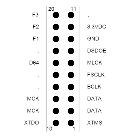

MCLK is not needed. The way the they get sample rate from the USB boards is with the F0-F3 pins. See diagrams below for Amanero pinouts. The AK4137 boards don't use all the pins, though. You would have to trace them out to see. Also, you may notice that sometimes different names are used for same signals on the same pins. The one called DSDOE is also sometimes called DSDON. Don't know why.

OK, I figured it out simulataneously with you. I mean, right F0-F2 is needed to indicate the right freq. Seems that Mute is needed to reset the requesting. Well... Will try to connect this XMOS' Freq pins with F0-F2 somehow... Bad thing is that those SR indicating pins on XMOS are not isolated. BTW, DSDON/OFF is not needed. F0-F2 and Mute pins only. Even I2S! is not needed 😀
I have spend hours trying make it work... It works now, but not as I expected. It is needed to re-pull MU-pin every time when freq is changed. If MU-pin is always on the GND, then I need to re-select USB-input to actualize freq. AUDMUTE (and DACRST too) which are on XMOS board are not help. There is "NOT LOCKED" promt until MU pin is not grounded at least for one time. I can actualizate freq manually by pulling MU to GND every time after freq of music changed. But to make it automatically "more or less" I can only by pulling MU-pin to DATA of I2S through 3kOhm. If more than 3k, then freq may not changed (depends on music). To avoid problems in SQ of music, I think that this resistor should be as much as can, because I don't want to solder any active splitter. If MU is connected to LRCK, then the freq is wrong (what "he" is doing there when showing me wrong freq ??? ), if connect to BCK\MCK - not works at all. Stupid method, but it works 😀
I have wrong version of old XMOS pins functionality, but thanks of you Mark, you made me believe in myself 😀 :cheers:

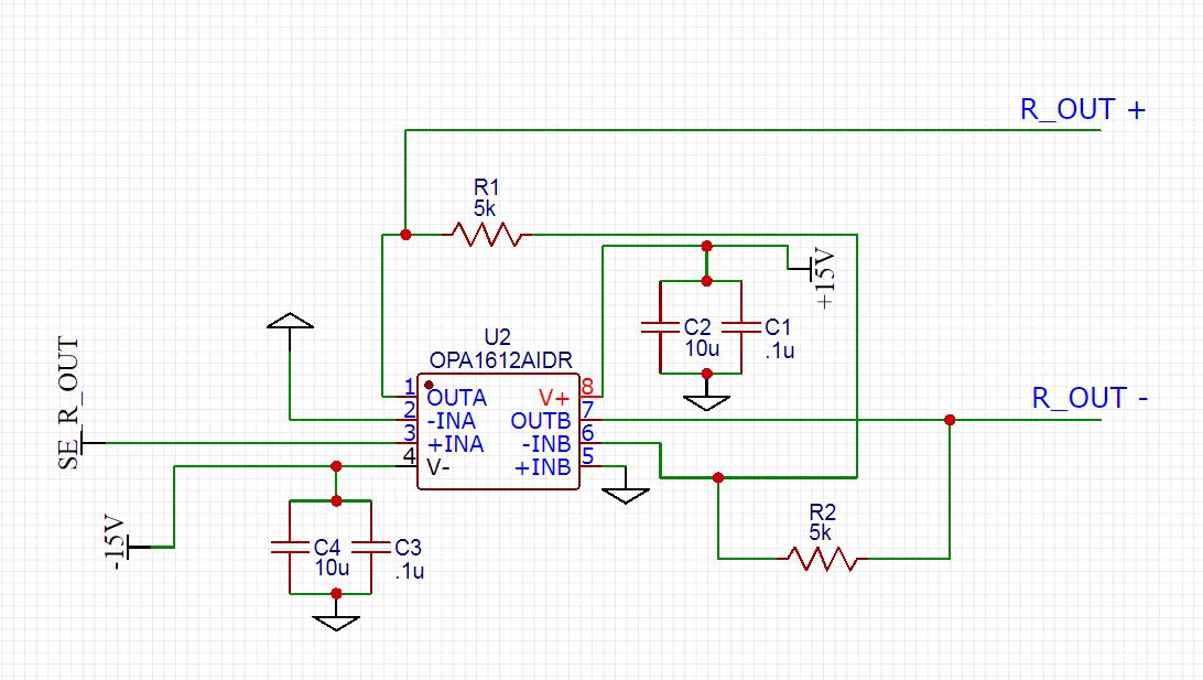

Hi Mark,
Regarding the balanced output schematic you advised, is it like the attached diagram?
Kay

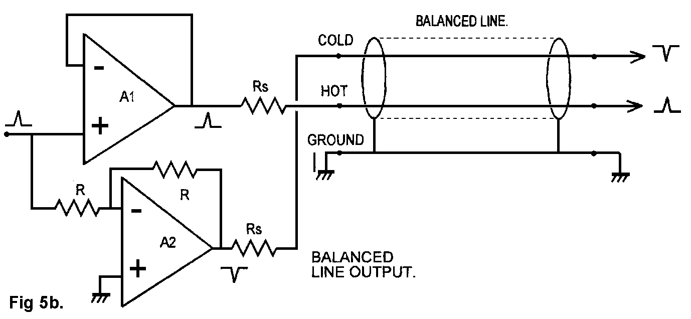

Hi Kay,
Yes, that is the way shown in one schematic I posted. The inverting opamp can take its input from the output of the non-inverting opamp, or the the inputs of both inverting and non-inverting opamps can be in parallel as shown in the schematic below. When it comes right down to picking one way or the other, I guess I would probably prefer the version with the inputs in parallel, as below. That is, I would prefer it if the source impedance of whatever drives the two opamp circuits is reasonably low, such as another opamp. If the circuit could be loaded down significantly by the resistors of the inverting circuit, then that could be a problem. In that case the resistors could be made sufficiently large, or the opamps could be connected as shown on the other schematic. Since with our dacs the output impedance is usually pretty low, the parallel input circuit would probably win out.
Mark
EDIT: If you are only driving balanced lines a short distance to your power amp inputs, most likely you would not notice any difference whichever schematic version you choose.

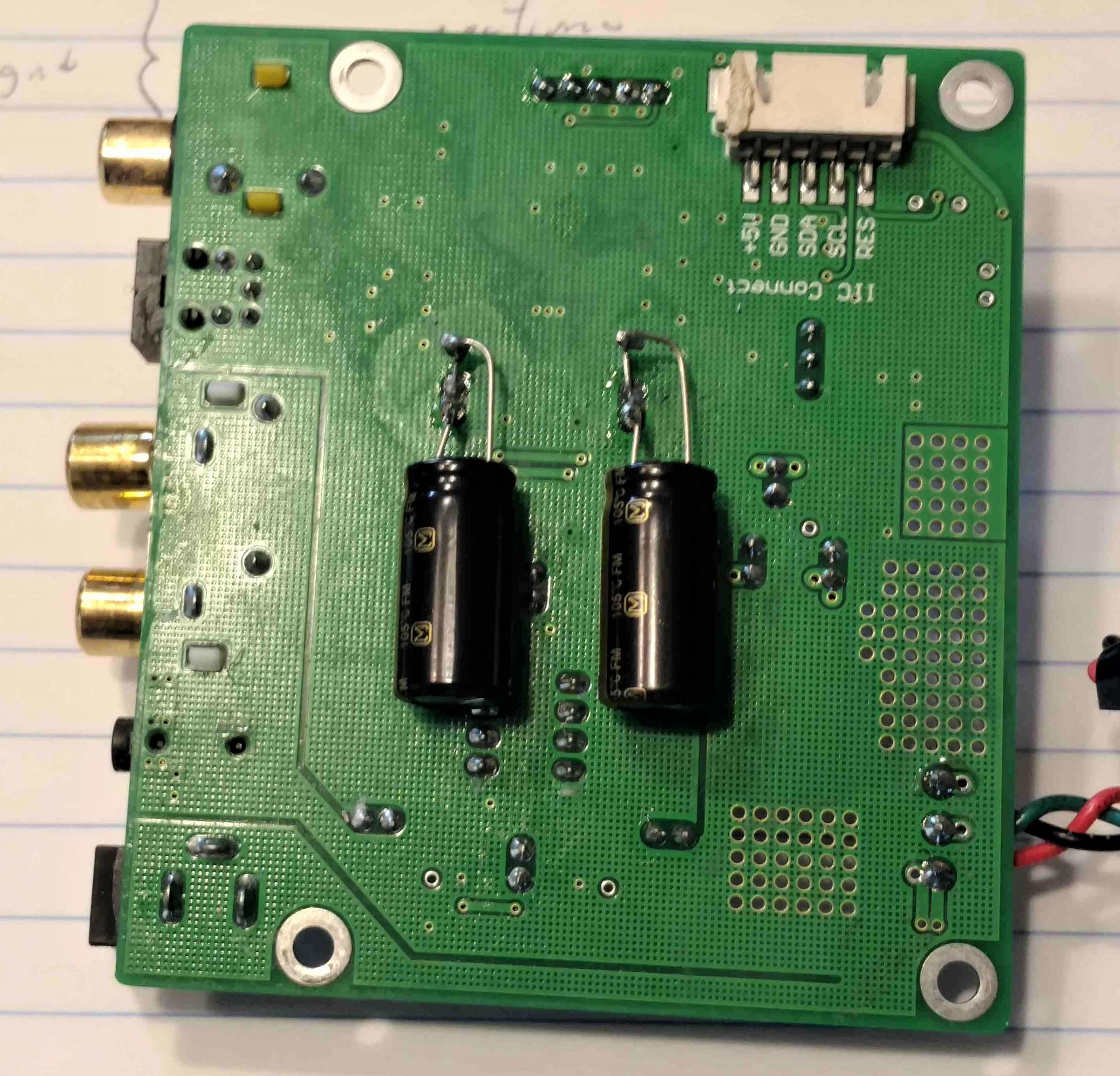

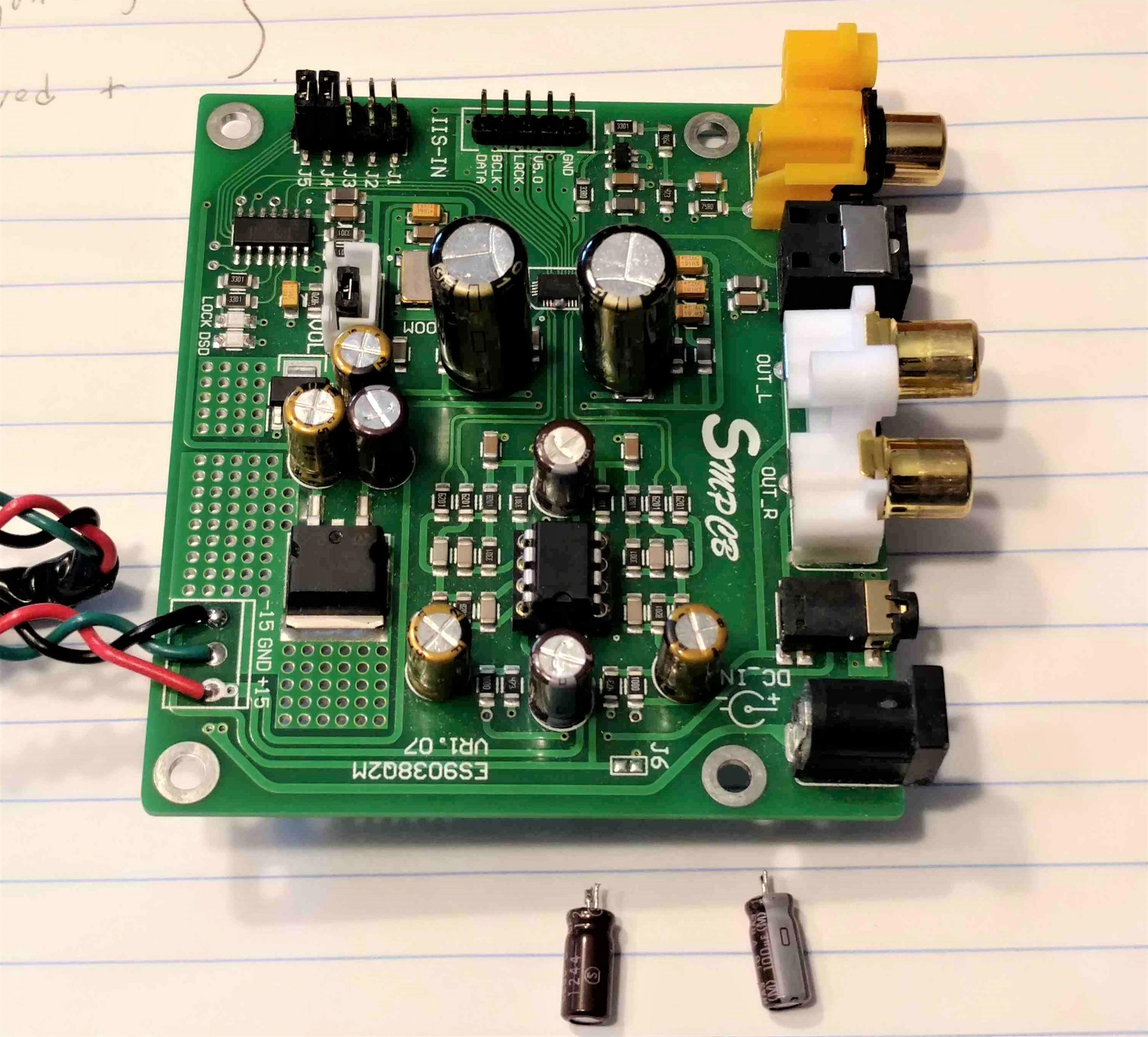

Hi Mark,
I took your advise using my DMM to check my output stage, found two mistakes that are easily fixed. In the meantime I added extra capacitance to the AVCC rails as suggested. I removed the existing 100 uF caps and put 2000uf on each rail. I had a good listen before the mod and after the mod. I have to agree that it is well worth doing, it is an easy, low risk mod that audibly increases sound quality. Sound is more liquid, the glare that can be present on high frequencies is greatly reduced, definitely sounds better. Next step straighten out the output stage and give it a whirl, need to modify my case to add some new rca outs first. Here are some pics of the cap mod, the wimpy original caps are shown in the one pic for comparison.
