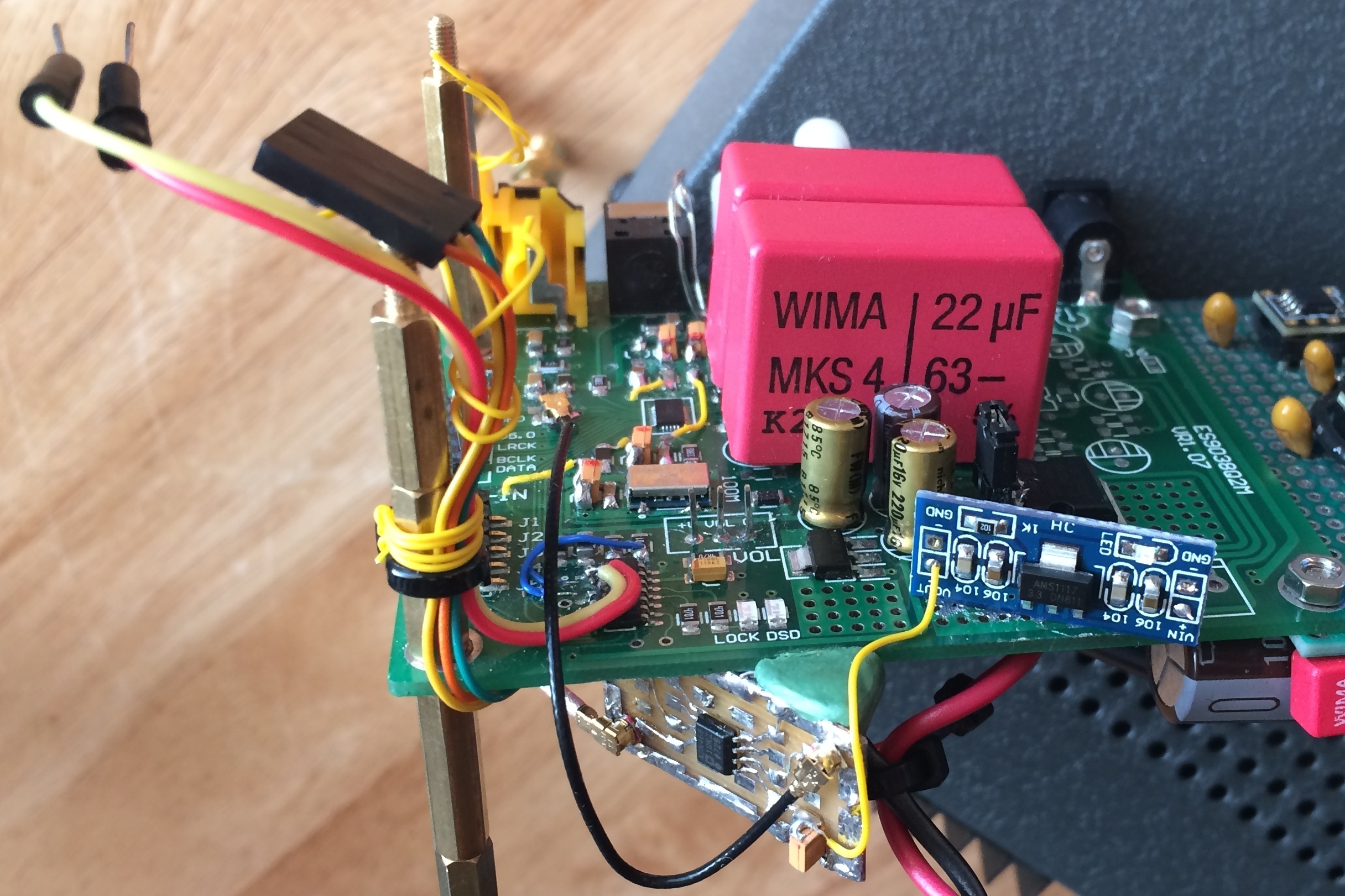

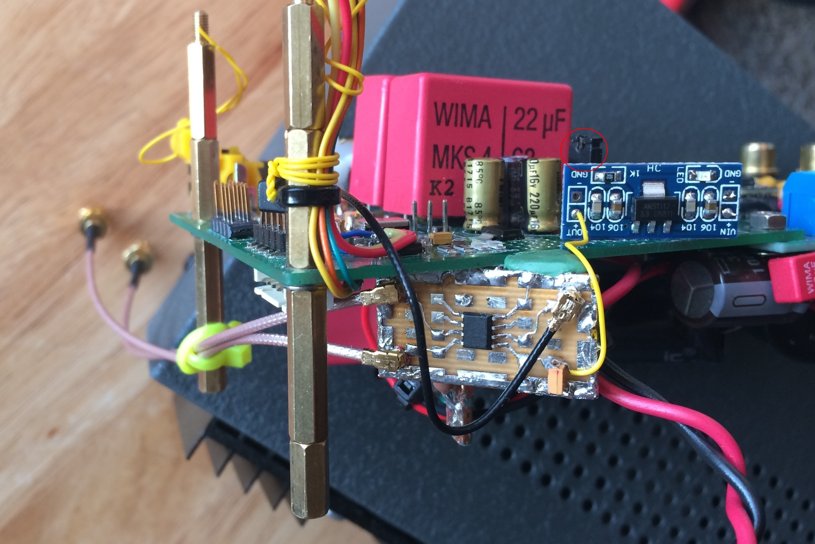

Update on clock divider mod: Turns out I didn't have another LT1763 in stock. Rather than wait to get one I decided to use a little AMS1117 board I had. Also, wanted to be able to switch on/off the LVCMOS to LVDS adapter board to test for any distortion such as I found occurring with the adapter in its previous location, so there is a jumper circled in red (in one pic) behind the regulator to disconnect power for test purposes. In addition, found some damage to a u.fl connector on the adapter board apparently caused during all the repeated assembly/disassembly that goes on when doing tests and performing troubleshooting activities. The connector was replaced and some new coax cables fitted to the board, this time with some strain relief for a couple of them. Pictures below.

Today's clock mod update: Clock divider setup is now working without added distortion from power supply issues. However, doesn't sound like jitter is quite as low as I have had it before back when I was bending circuit boards and playing around with ferrites in order to bring ES9038Q2M and AK4137 clocks into relative synchronization.

Despite the fact that the modded dac is now sounding much better as a result of adjusting the pre-dac digital signal level, I still think jitter is not the lowest I ever had it. So, I will keep working on it, although I may take a bit of a detour to set up an alternate test system first. We'll see.

Currently using the TI LMK1000 divider with some LVDS/LCMOS adapter parts. Next try will be with LTC6954 divider and no adapters. Probably reasonable to expect that could do a little better. Depending on the results, will take it from there.
No hurry though, it sounds very good right now. I can choose to make it sound either almost exactly like Allo Katana dac (a master mode dac with exceptionally low jitter), or a little smoother and less distorted than Katana, but with a little less audibility of low level reverb tails as compared to Katana. (Both Katana and the modded dac are using linear power supplies, supplemented with filter banks of film caps.) The best results I had before gave me both benefits at once, smoother and less distortion than Katana, and with audibility of low level reverb tails equally good as Katana. (Also of possible interest to some people, since Katana operates in master mode, it only works as an RPi hat, whereas the modded dac is being tested with USB, although it can work with RPi, too. Modded dac should be able to work with SPDIF, as well.) For the time being, all listening tests are being done with 16/44 CD rips.
It just seems like since I know I can probably do a little better than I am right now, may as well go ahead and see if I can figure out how to make it a little better. It could be helpful to other dac builders who may come along later to have some information on what has been found to work or not work, at this point in time.
