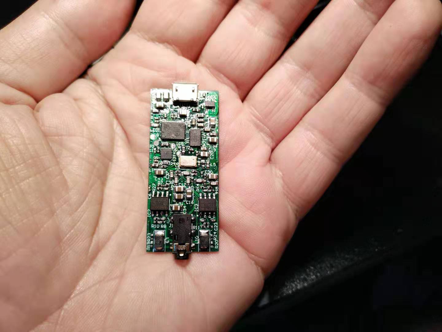

Just got my board to test. Its the blue 1. Took all the 47u caps off and exchanged them them with Rubycon 470uF ZLH caps. Then I took the 4.7 ohm resistors from the AVCC lines and made shortcuts there. The 12V input is now doing a + and - 9v for the output opamp(replaced it with a LME49720) by adding a Recom 78R9 regulator in negative output mode. Amp is now DC coupled...no caps in the output(or anywhere in the signal path). I really like the sound of this board. Sounds better then my Twisted Pair DAC or other DACs used.
seems output impedance of DAC is quite high.
Output impedance of ES9038Q2M should be around 820 ohms, but offset by AVCC/2. Don't know how you are using the opamp, but it normally takes more than one to remove the offset voltage from the output.
Are you running gain in the opamp that is amplifying the AVCC/2 DC offset voltage?

Nice to hear you are happy with the board. It seems very strange you would find it better than a TP dac, unless perhaps it is a very old one. These dacs can be improved a lot more than what you have done thus far, but that you like it is the most important thing.
Yes, Mark, it was DC coupled, now is AC coupled, and I was able to make some measurements. THD is bad(.005%@ hifiman he400i planars load, mid of the volume slider, my goal is 10x better), and I guess I see the reason. S/N I believe the best of possible to get with AD8397 and 1.2K FB resistor <-120db(A) but need to go somewhere to remeasure with AP.

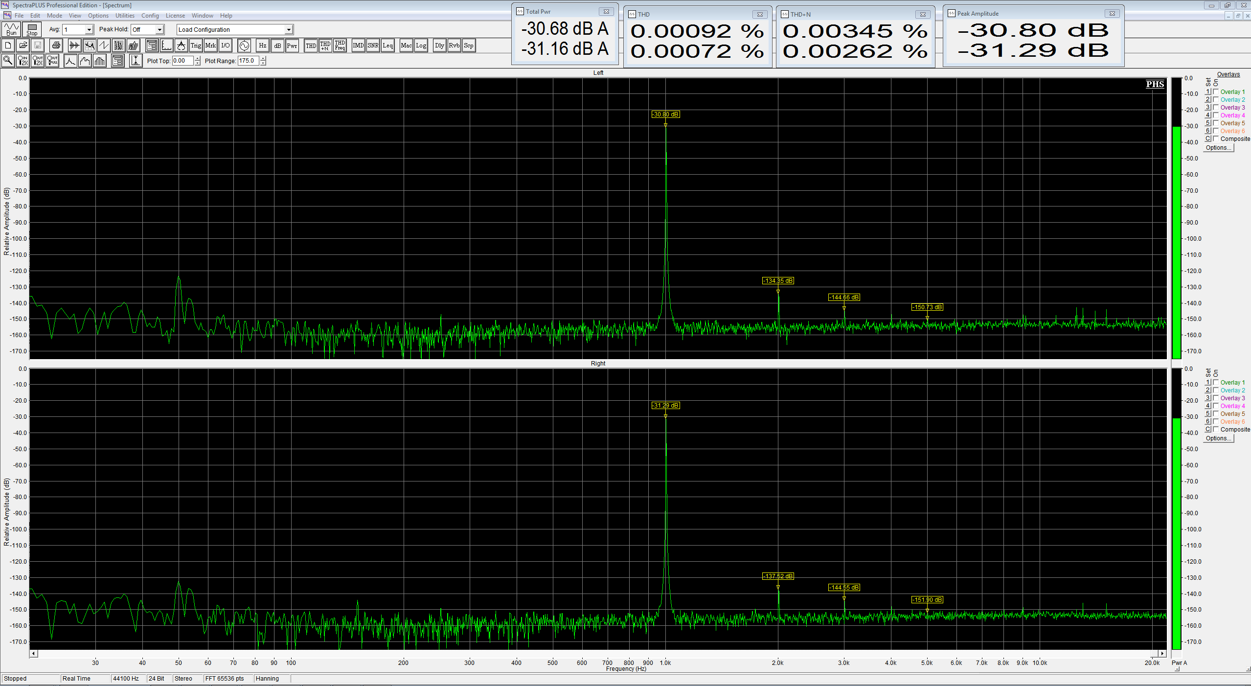

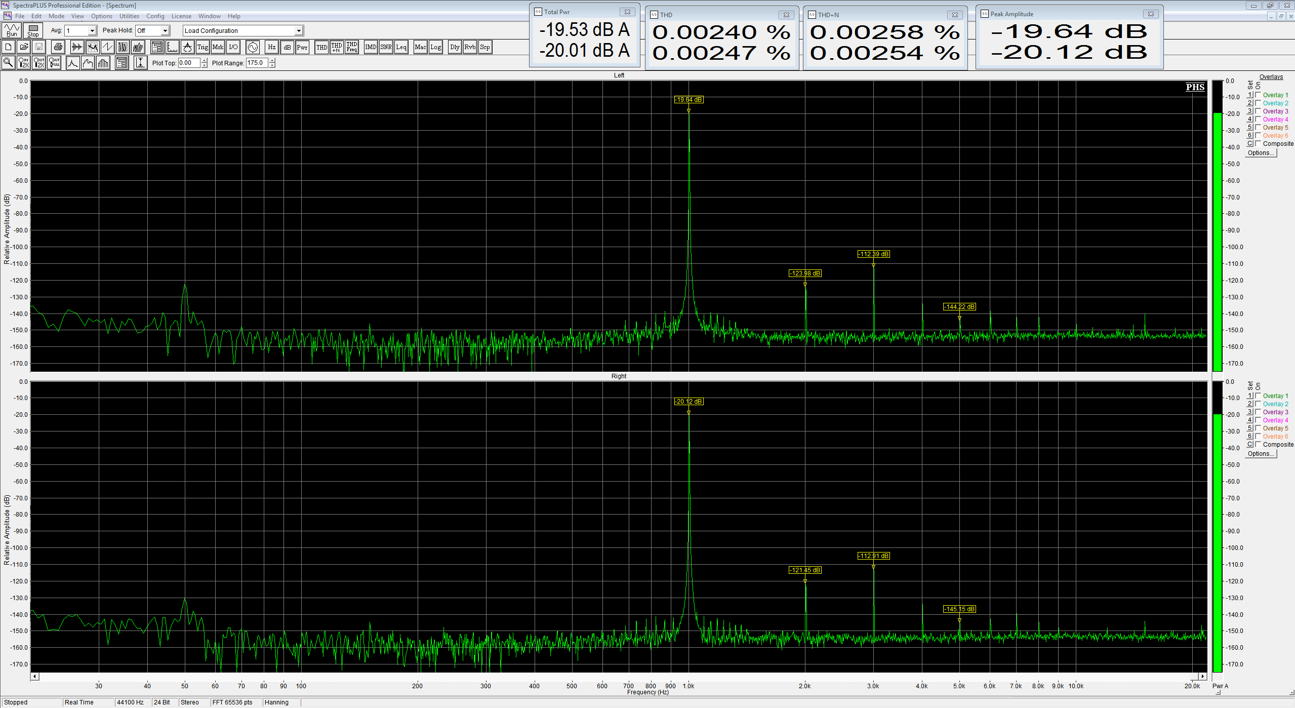

ok, I have a bit improved THD, and actually 3rd harmonic 'THD_comp' coefficient = +1200 working now good in the range -3db to -10db at least. See attached screenshots.
PS: coefficient format is Eight-bit ones' complement Signed number representations - Wikipedia

HD comp is 16-bit signed int format, which stretches across two 8-bit registers.
