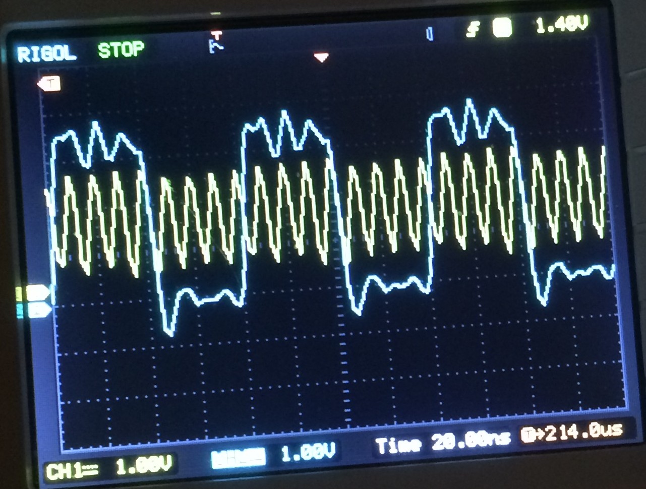

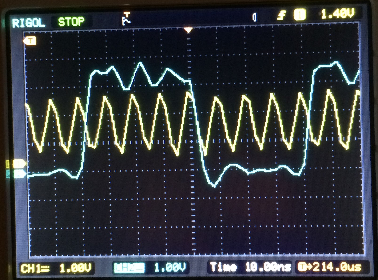

Thought I might post something of possible interest to others building DACs A couple of scope pics below show the best sounding phase relationship (that I found) between the DAC 100MHz clock (yellow trace), and the AK4137 nominally 22.5MHz clock used for all conversions to DSD. The actual frequency I am using for AK4137 in the phase-locked case is 25MHz (blue trace). Because the scope only has 100MHz bandwidth, the 100MHz clock signal should be attenuated in amplitude as it appears on the scope, since the scope frequency response is starting to fall off. Also, the ringing on the 25MHz is probably from having the scope probes grounded to the DAC board ground plane, but the 25MHz had to have been probed on the AK4137 board. So, I think the ground difference probably accounts for some or most of that ringing.
I'm assuming you've removed the earth wire and signal input clip from CRO
probe, connected the earth sleeve with as short a lead as possible to the GP
and use only the very short probe tip for signal input.
If you haven't done above, you will be looking at a whole lot of a/ signal bounce and b/ noise from earth lead and unshielded probe.

I know, but thank you for trying to inform those who may not. Actually, I have the little spring whisker ground tips for my probes. I also have one much better Tek probe that allows for more honest waveform display at around 100MHz. In this case I wanted to use matched probes to help minimize any timing skew. Unfortunately, the dac is down in a recessed area in a steel file server case, and quite hard enough for me to see where the probes are going, hold both tips in place using the more convenient clip-on grounds, and manipulate the scope controls too all at the same time. If I had an assistant to hold the probes or hold one of them it might help. I don't know if two people could look down in there without bumping heads, for one issue. In short, it was a hard measurement to make as it was. And, yes, I know how to do it the more accurate, and technically proper way. Once I noticed that I actually had saved a shot of the dac clock and the DSD clock, it turns out they are both on the same board, and and the probe grounds were clipped on a ground plane test point very nearby. In that case, I believe the ringing on the 12.5MHz DSD clock is mostly from the ribbon cable and pin header interconnects, and because it was measured at the arriving end on the dac board rather than the transmitting end at the AK4137 board. In the second, more expanded view pic, that is a stretched out view using the same capture points as in the first picture, the one that shows more waveform cycles. So, less density of sample points is visibly evident in the stretched out view and that makes it look a little more distorted than it would have appeared if taken in a separate capture at a higher sample rate.
