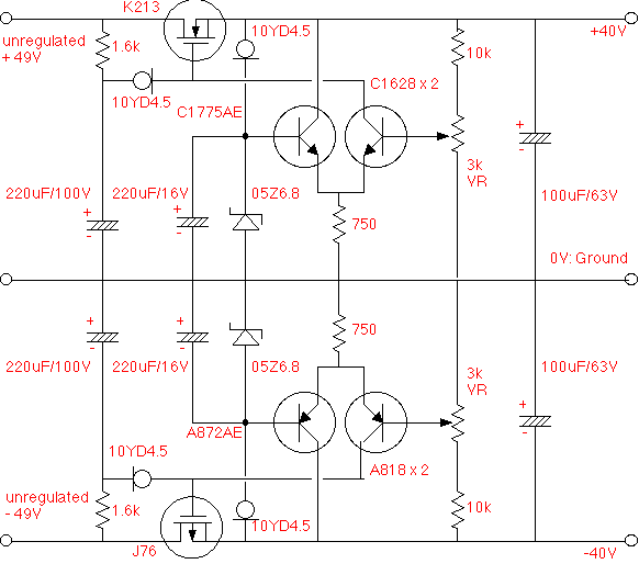

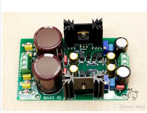

Hi Mark,
I've built many psu's before, but decided to try out a quick and cheaper alternative for this project. For about 20 bucks delivered I got a Chinese Kubota psu off of ebay, a lot cheaper that I could put one together for. I guess you get what you pay for. It is designed to deliver 500 ma, using a 10 va transformer should be enough for this dac. It worked fine for a while, no rail sag, no excessive heat. Now it runs very very hot even with no load, and with load the rails sag, the trafo is also getting warm. At this point I'm afraid to use it. From what I've been able to read on the web it is a constant current type of psu similar to a shunt. I'm guessing some of the transistors failed dumping a lot of current to ground. Attached is a schematic that I found and a pic of the psu. I can't guarantee the board I bought matched the schematic, there was none available at the sellers site. I have some known high quality psu boards from Salas that I'm going to use to upgrade my better dacs. If the LT1083 psu that I ordered to replace this piece of junk craps out I'll recycle an old psu from my upgraded dacs.

Paul,
The the pairs of two bipolar transistors with the emitters tied together are a differential pairs. One transistor base connects to a zener diode reference voltage (the zener is fed current by a constant current diode which are shown with the flat line and circle symbol. The zener voltage is also filtered of noise by a parallel elelctrolytic cap). The other transistor of each differential pair connects to pot wiper that samples the power supply output voltage. Depending on the pot setting, the differential pair should try to create an error signal (if their bases are at two slightly different voltages, that's a slight error in the desired output voltage). The error signal from the pair drives the gate of a MOSFET pass transistor. The other constant current diode at the gate of the MOSFET is connected to filtered power on one end, and the other end that connects to the MOSFET gate supplies collector current for one of the differential pair transistors. Using a current diode for that rather than a resistor for that helps to make the power supply regulation better by resulting in increased feedback loop gain of the differential error amplifier.
Hope the above helps to understand how the circuit is supposed to work. You can check with a voltmeter what happens if you connect a resistive load and turn the adjustment pots. The 6.8v zener reference voltages should remain steady, and the differential pair error amplifier should create a signal to turn on the MOSFET gate just enough to keep the output voltage in regulation.
EDIT: Also, the BJT differential pair transistors can probably checked in the circuit to make sure the PN junctions are intact and dropping around maybe .4v to .7v in the forward direction, and pretty much high impedance in the other direction. Many DVMs have a diode check function that can be used for that rough test. The transistor junction diode drops should be consistent for each pair of differential transistors. For the transistors with their bases tied to the zener references, the zeners will be forward biased when checking the reverse drop of that transistor emitter-base junction, so you may see some forward diode drop from the zener which should not create alarm as it is kind of expected. Some of what you would see would depend on the 750-ohm emitter resistor which would effectively be in series with the forward biased zener if measuring at the transistor base-emitter. The constant current diodes behave a little differently. Inside they are much like a FET with the gate tied to the source which makes them act like a sort-of imperfect constant current source (Idss).

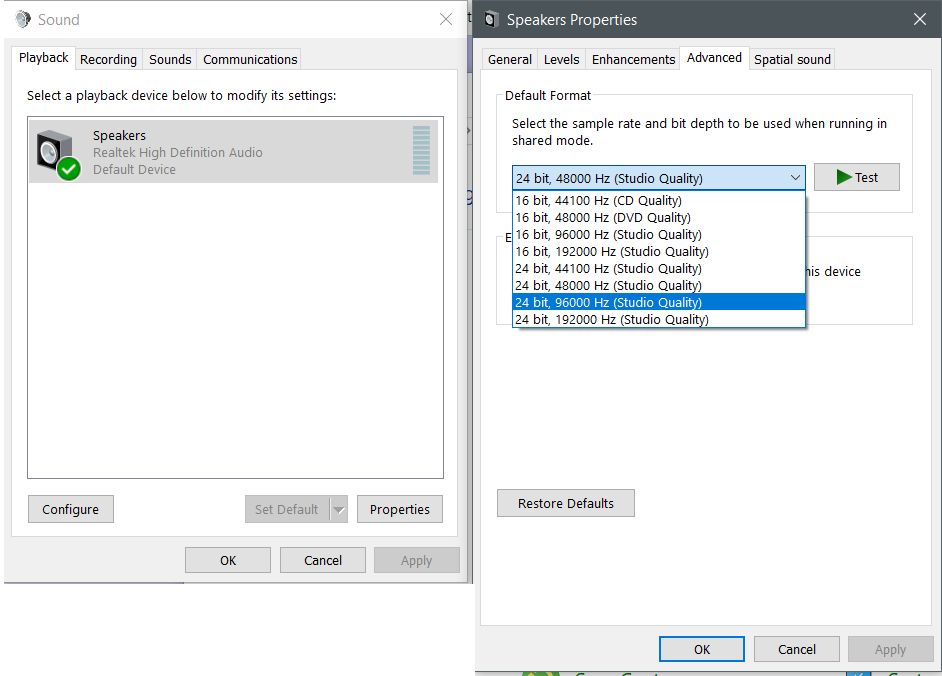

Windows or Other OS Sound Device Configuration
Can't believe I didn't post about this before. At least, I couldn't find it.
Okay, here goes: Windows and most modern computer OS audio systems will do real time poor sound quality SRC on your audio before playing the audio and they don't tell you they are doing it. Further, it is tricky to make them not do it. Please see the picture attached below.
It shows the windows sound device configuration in the windows control panel. I clicked on the one sound device in this computer then with it selected clicked the properties button in the lower right part of the left pane. At the top of the left pane you can see the sound device has a green check mark indicating it is the default device. There are actually two default devices at it is both, one for sound playback and one default for communication. In the right pane the properties box for the sound device is open. In the advance tab as shown there is a setting sample rate and bit-depth. There are also some check boxes to allow exclusive mode and configure it. They should be checked but it won't help. If a device is the default device then windows will always manage it via the windows sound engine and its poor sound quality SRC, Windows will do the same thing if the device is not the default device, but the sample rate and bit dept you have set are not exactly the same as the music file you are playing. Windows will also take control even if the sound device has ASIO drivers if is a default device.
Here is the only reliable fix I know of to make sound quality as it should be in windows. (macs do similar, and some linux might too): You must have at least two sound devices to choose from, set the one you don't want to use for music playback to the default for sound and for communications (it should be the only device with a green check mark). For the device you do want to use either set the default sample rate and bit depth to exactly match the music file you want to play next, or the best way is to make sure the device you will use has ASIO drivers or at least that it works with the free ASIOforALL driver. Then install foobar2000 as your music playback app (or use a paid app that support ASIO). Foobar can use ASIO but you have to download and install the optional ASIO component. Once it is installed, restart foobar and in the configuration options 'output settings' tab there is a drop down menu to select the sound device. Select the ASIO driver for the sound device you want to use (and that isn't the windows default). You may need to close and reopen foobar to make sure the setting sticks. There will be another ASIO page option below the output configuration page option. You don't need to configure that, it is for custom mapping of the ASIO output channels. Now when you play music, foobar can and will automatically use ASIO to configure the sound device to play using the exact same sample rate and bit depth as the file, so no crappy SRC will be required or used.
You will also need to turn down the master volume level in windows for the device you will use. You can do that in the control panel device properties 'levels' tab, or using the sound volume control slider in the lower right hand area of the desktop task bar. To prevent intersample overs in AK4137 you must turn down the master slider for the sound device to about -4dBFS (if a Sabre dac, the its hardware volume control also needs to be turned down to prevent intersample overs in the ASRC stage, or the Windows master slider must be turned down enough to avoid overs in both AK4137 and the dac ASRC, about -7dBFS to to -8dBFS should be the master level setting so as to minimize distortion). If you right click to the on the slider knob or the little speaker icon in the control panel device properties level tab, you can change the display from percent to dB which makes it easier to apply the correct level adjustment. From then on, only use the foobar volume slider or the dac hardware volume control to adjust playback volume, you can also use a volume pot in a preamp or power amp.

+1 Mark
Yep, W10 (and Macs) do that for the sound... and also for the pictures.
I had to fiddle around as you said with 2 devices to get close a sound from my PC reading my CDs than from my still cherisched CD Player (for serious listenings) and it took me a lot of time and effort to get it right for the pictures, splitting sound and image and then processing images as it should through special softwares (MadVR as platform & then dedicated stuff).
And despite all this, at each majour update, W10 tends to force its settings and ruin all what I did, activating again per defauts its... s*$$y systems and also affecting the output resolution (which leaves then the beamer doing upscaling job, not the best thing)
Anyway, digressing, point is indeed most people listen to MS and Mac sound and not to real music without knowing it
