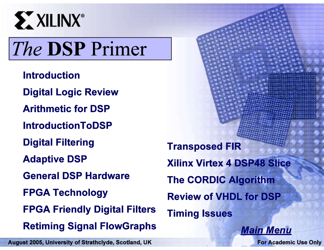

FPGA Info for New or Prospective Filter Designers
Found a book I would recommend to new Xilinx FPGA programmers/designers: "100 Power Tips for FPGA Designers." This is a book in which a majority of the content seems worth reading sooner rather than later, at for those who don't know it all already. Very practical resource.
Thought I would attach the list of chapter topics for the downloadable Xilinx 'DSP University' introductory self-study material on DSP. Besides general information, there is also some useful focus on DSP in the context of achieving good performance with Xilinx FPGAs.
Xilinx also has a number of other printed resources, some of which I may recommend from time to time.
In addition, there are a number of introductory Youtube videos on various topic such as getting started with Vivado.
I am posting the list of chapters with the thought in mind that is the material can be for anyone who thinks they might be interested DSP, FPGAs, and how to best use the Xilinx line of FPGAs.
There is something available for everyone who has an interest in such things, starting from the very basics of digital and continuing up to and including some rather sophisticated applications (although the level of sophistication in the introductory chapters tends to be at a basic level, the more sophisticated material from Xilinx and other resources can be found after the introductory material has been comfortably digested).
It's highly recommended stuff to learn about, IMHO. No doubt there will be more and more digital and DSP aspects to audio design as time goes on. Also, no time like the present to get started, even if its only a toe in the water rather than a deep dive. :)
