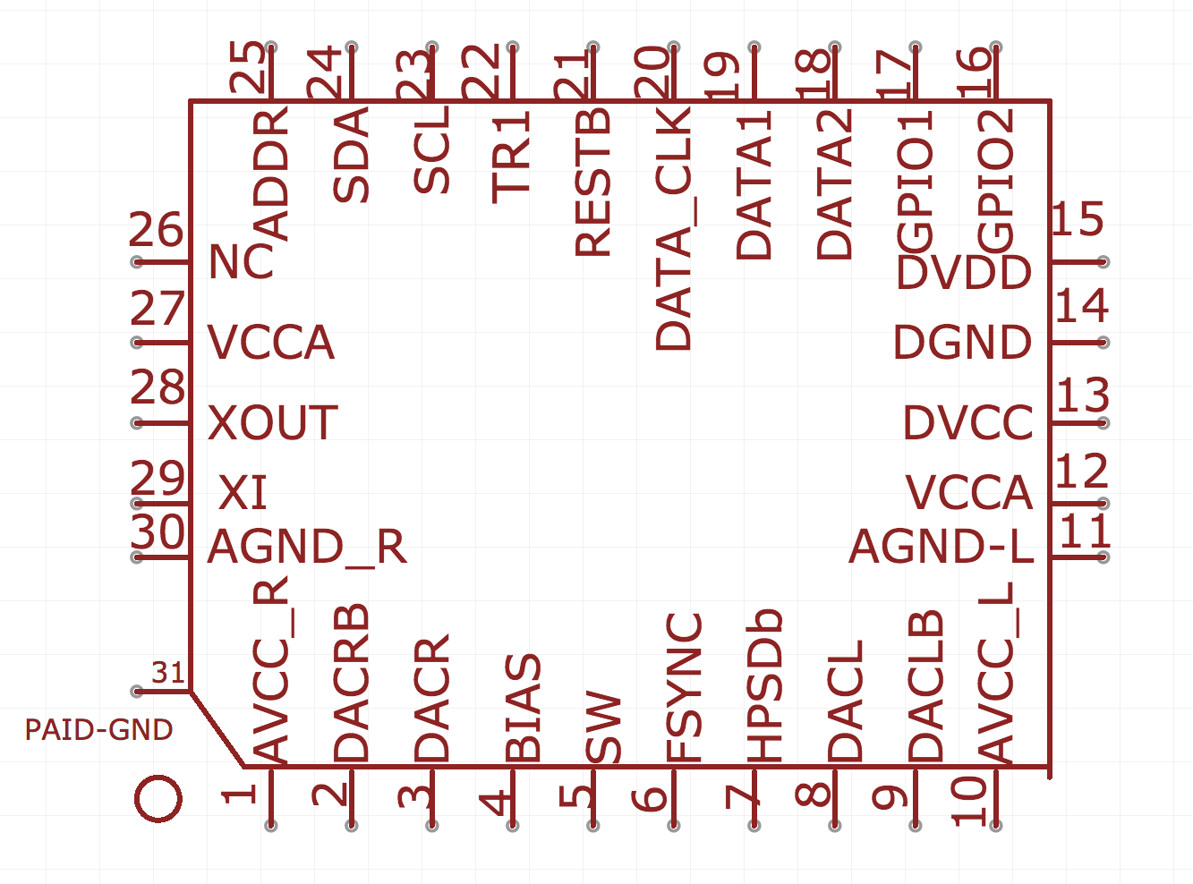

An ES9038Q2M needs three I2S signals. They are: DATA, BCLK, and LRCK. It also needs a ground for I2S, preferably three grounds, one for each of the I2S signals.
Depending on Amanero firmware, F!, F2, F3 indicate the incoming USB audio sample rate. The AK4137 board would like to see two of those, otherwise you might have to set the input sample rate manually.
Depending on Amanero firmware, the DSD pin is high when DSD is playing. The AK4137 board can use that signal too. However, a jumper needs to be removed on the low cost AK4137 board if using the Amanero DSD signal. Otherwise, you can set it manually.
Attached below is the dac chip pinout.

You could also replace the DVDD bypass cap at pin 15 of the dac chip. The recommended part is 4.7uf, 20%, X5R, 6.3v, 0402 size. The reason for so small a cap is to help minimize ESL (much of which is actually caused by the ground pad via).
