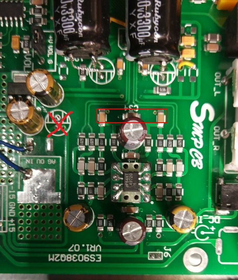

There is one more spot for soldering a smaller oscillator. What do you think, is it worth removing it, leaving only the necessary?
Should be okay to remove it or leave it. Shouldn't cause any problems to leave it.
I finished replacing the oscillator and turned on the DAC for the first time. I could not believe my ears. The sound really got much better. Particularly noticeable was the improvement at low frequencies. Apparently this is because I unloaded the old 3.3v line, leaving only AVCC and the microcontroller on it.

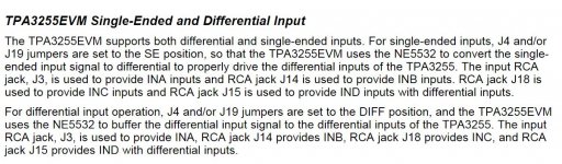

Am using TPA3255EVM amplifier, which uses ne5532 to make differential/balanced signal when input is single-ended (According to the guide - attached in the picture below). It also use the same op-amp as buffer when input is balanced.
I'd like to ask if there's any mistakes or improvements can be made to improve the sound. Any comments will be appreciated as always.

Hi Kay,
Not sure how you came to be using 4.99k resistors in series with the balanced outputs? 220 ohms should be plenty, and some people use even less. That might account for the loss of volume you report.
Regarding a change in sound from using balanced interconnects, mostly that would be used to help with ground issues between the dac and the power amp. Things like hum, buzz, and or noise pickup (and or more subtle SQ problems) caused when the two devices are connected should be improved. Especially so, if that was one of your biggest remaining problems with sound quality. At this point, I'm kind of guessing it may not have been. Ground problems can cause significant sound quality issues, so comparing balanced with unbalanced in your situation was still a wise thing to do, IMHO.
To make much more in the way of gains in sound quality, you may have to find some way to so you can program the dac registers. Improvements do come with that. Since you have AK4137 and hopefully have hooked up I2S carefully, you should be able to reduce DPLL bandwidth a least a bit for an immediate improvement. If you have RPi, you could try that. If you had a PC, Mac or Linux sound card with line input, we could also talk about how to reduce harmonic distortion in the dac. Those kinds of things are necessary to get the best out of synchronous AK4137 clocking anyway, so hard to avoid them at some point.
EDIT: Another thing that might matter in your particular setup might be to try another power amp or headphone amp. Don't know if it is a limiting factor now, but if not now and if you keep making the dac better, it won't be too much longer before the amp probably becomes the main sound quality limiter.

Now I have transferred the converter board a little. I replaced the transistors in the SOT23 package with the TO92. I also moved the 10uf output capacitors as close to the transistor as possible. I noticed a non-soldered leg of a capacitor, just on the line that did not work (I bit off her too much).
And it seems everything worked! I set the voltage to 15.00V and it stably fight, even after warming up the transistors. The no-load current is 70ma (Not very economical). The output current is 15 mA respectively.
Now, probably, I'll try to install this board in my DAC.
Unfortunately, I do not have an oscilloscope. After all, with the help of it you can do so much! Soon I will buy myself an oscilloscope at 200mhz 1gsa / s. I think this will be enough for a newbie like me.
PS I still have 47uf capacitors on the DAC board for each + -15V line. I removed the extra capacitor that was on the +15 line -> +5, since it is no longer needed. Now the capacity at + - 15 is the same. I did not understand a bit about the bias scheme. This is Vref, as I understand it? I wanted to redraw the circuit with face values, in order to transfer it to 3 operational amplifiers in the future. But still did not.
