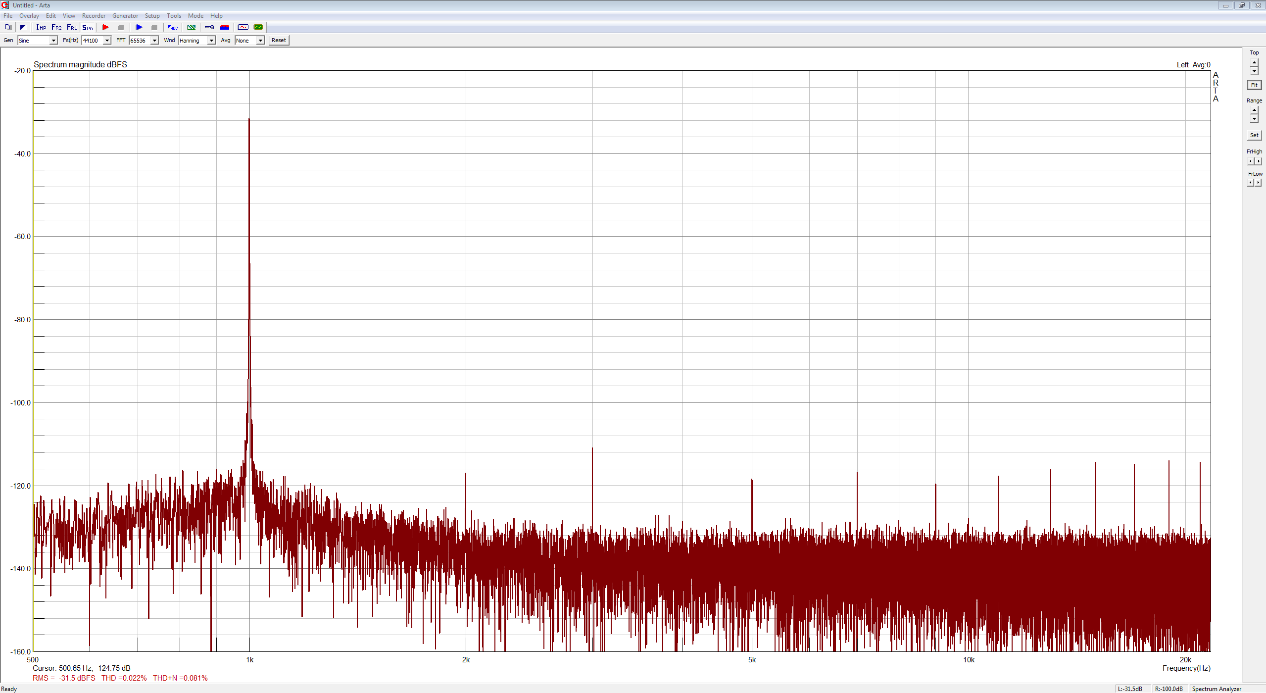

as I said in this post https://www.diyaudio.com/forums/digital-line-level/314935-es9038q2m-board-438.html#post5778058 shorted AP's inputs has about .5uVRMS A-weighted i.e. better than -135dbA.may be working at the very low end of its range
...AP's inputs has about .5uVRMS A-weighted i.e. better than -135dbA.
Displayed all in one range or in switched ranges (automatic relays, or otherwise)?

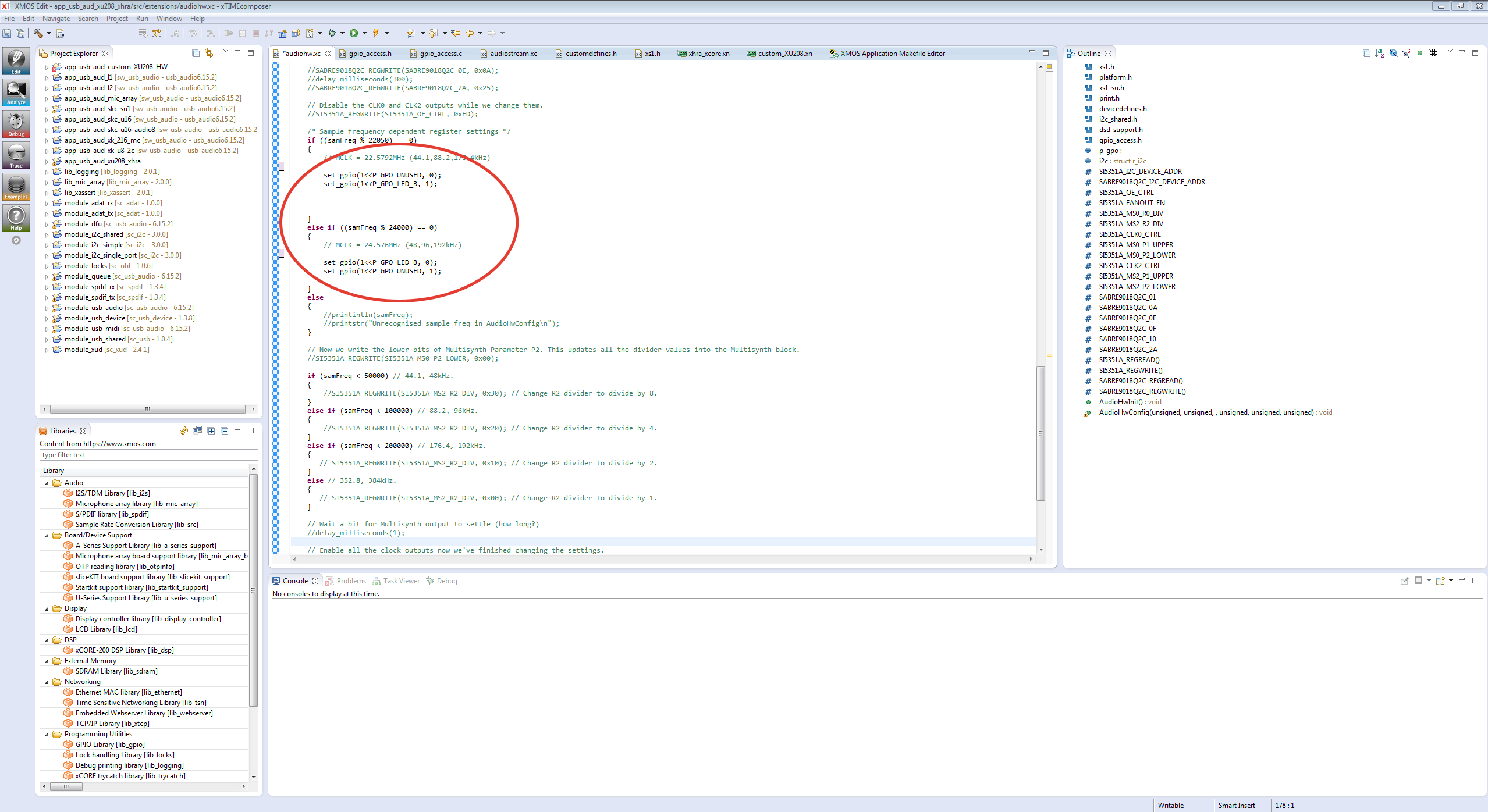

...performance-mode continuously scanning for the sample rate...
Optimal HD compensation settings my vary with sample rate.
Typically, whatever USB to I2S chip is used can be programmed to indicate incoming music file sample rate to the MCU and dac. There should be no need to scan for it, unless there is something I am missing here.
If I'll stop that polling how I should update registers?
XMOS USB to I2S chips have pins that can be programmed to tell which clock family (44kHz or 48kHz) the incoming audio is, whether it is DSD or PCM (DSD_ON), and the sample rate (F0/F1/F2/F3). A change in any of those signals from the XMOS chip could generate an interrupt in the MCU, which could then adjust the dac registers as needed. Or, DPLL_NUM could be polled, as could DSD vs PCM status, but polling is inefficient.
1) XMOS USB to I2S chips is actually normal ARM MCU, and any GPIO behavior only up to me, see attached how I manage OSC exchange according to Fs The same way I can manage registers updating without any extra pins and interrupts, and I do that.
2) My #9038S isn't XMOS based, and I have there host MCU 3x3mm QFN, any extra GPIOs and PCB tracks are highly unwilled due to PCB size 46x20mm.
3) The MCU isn't busy at all rather idle and may scan Fs inefficiently because nobody care if every 500mS MCU wakes up for few I2C transactions and eats 3mA
