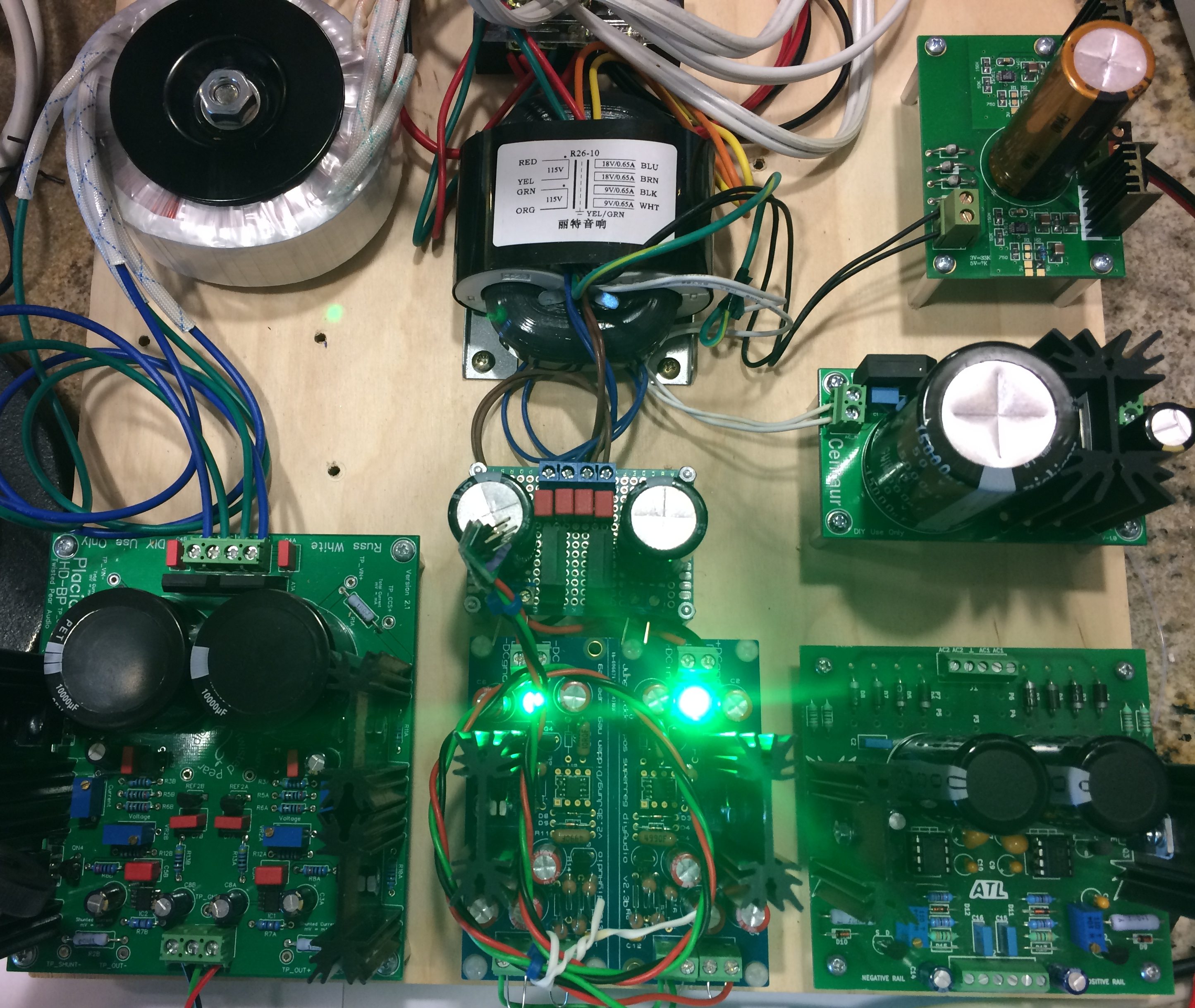

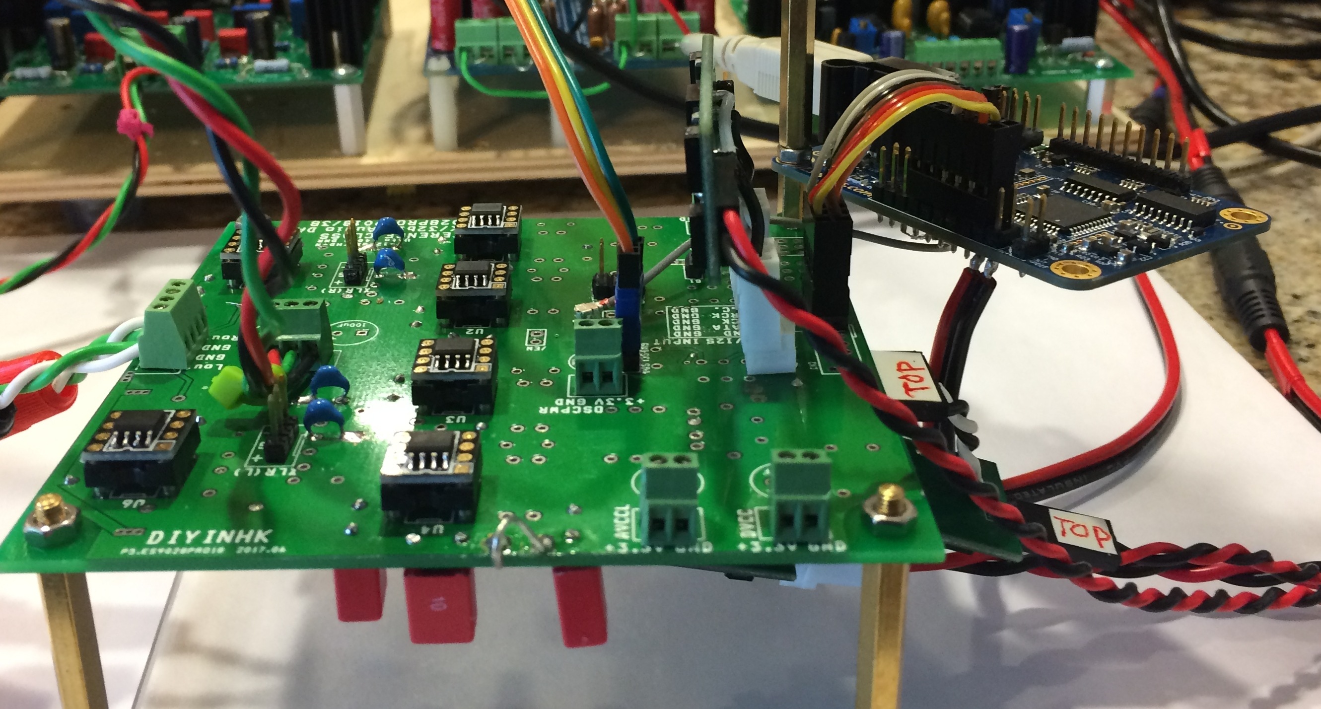

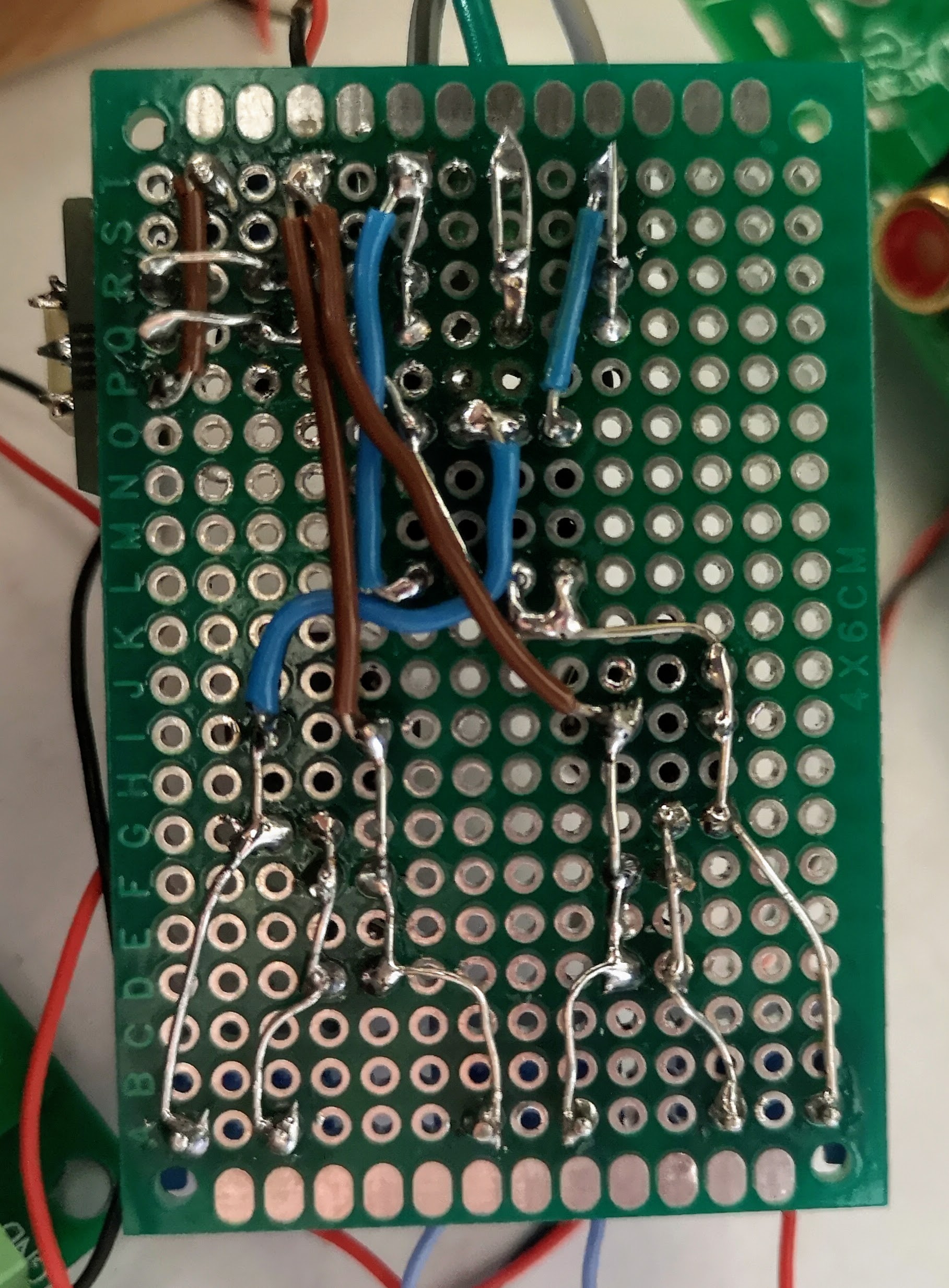

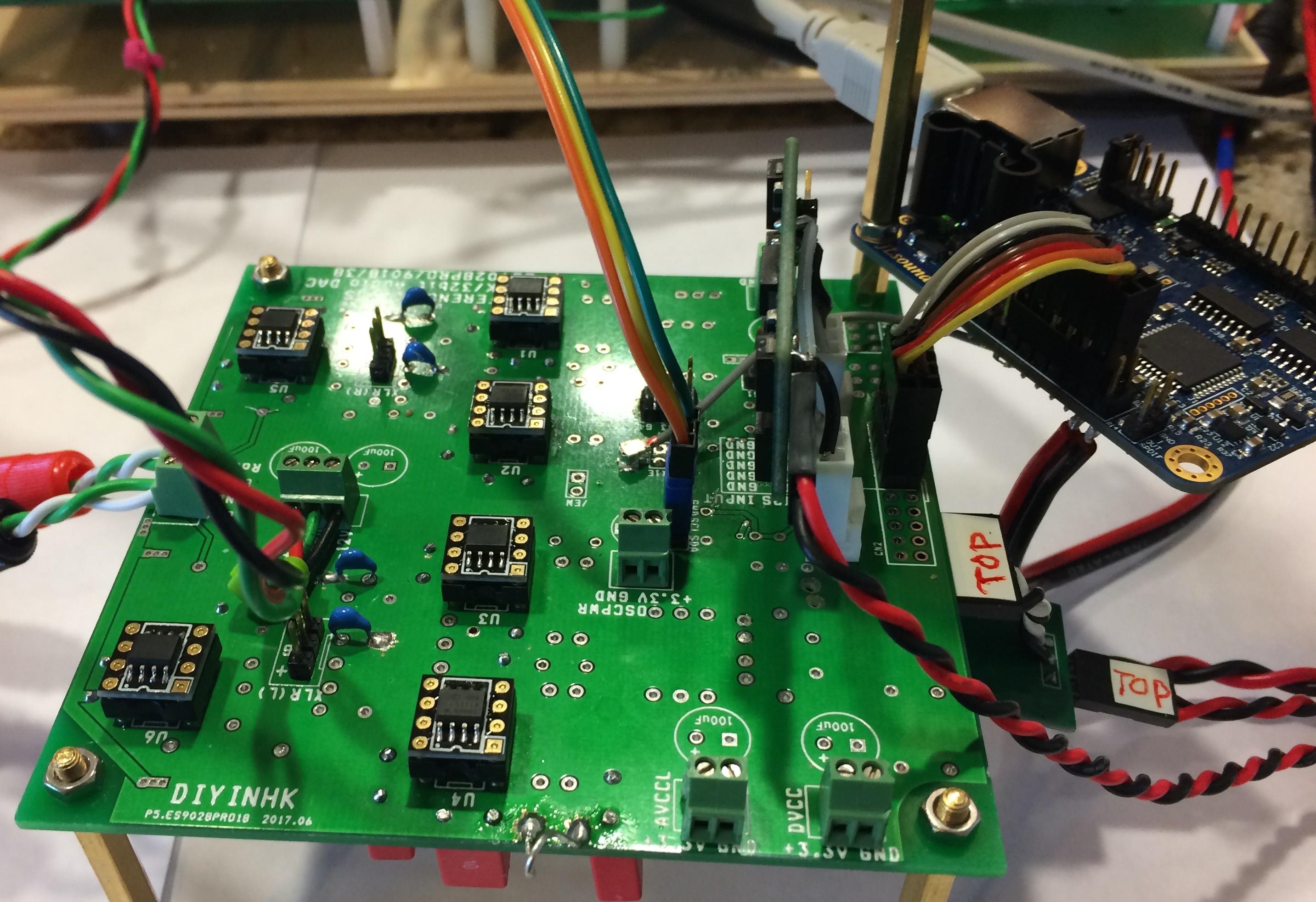

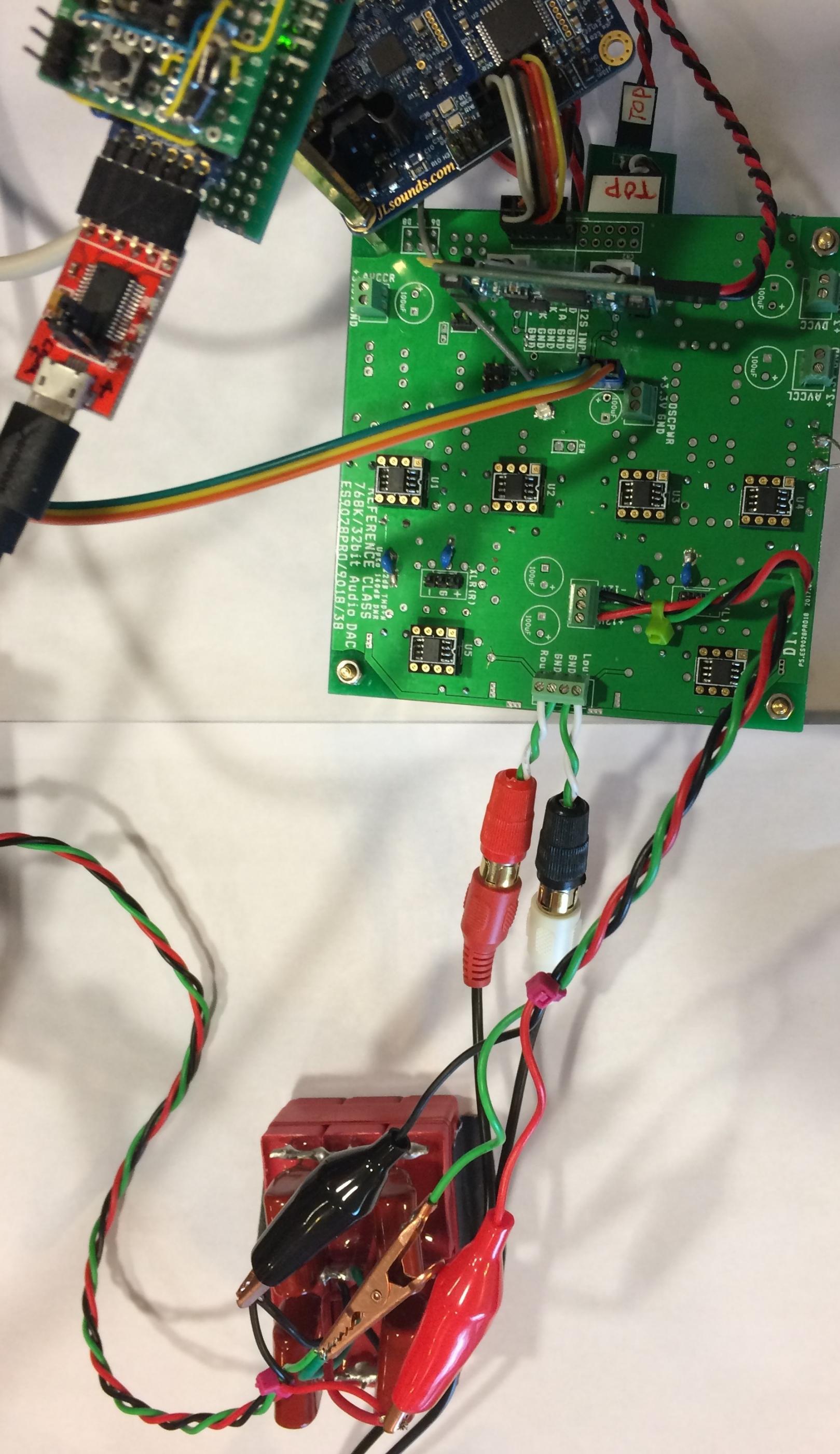

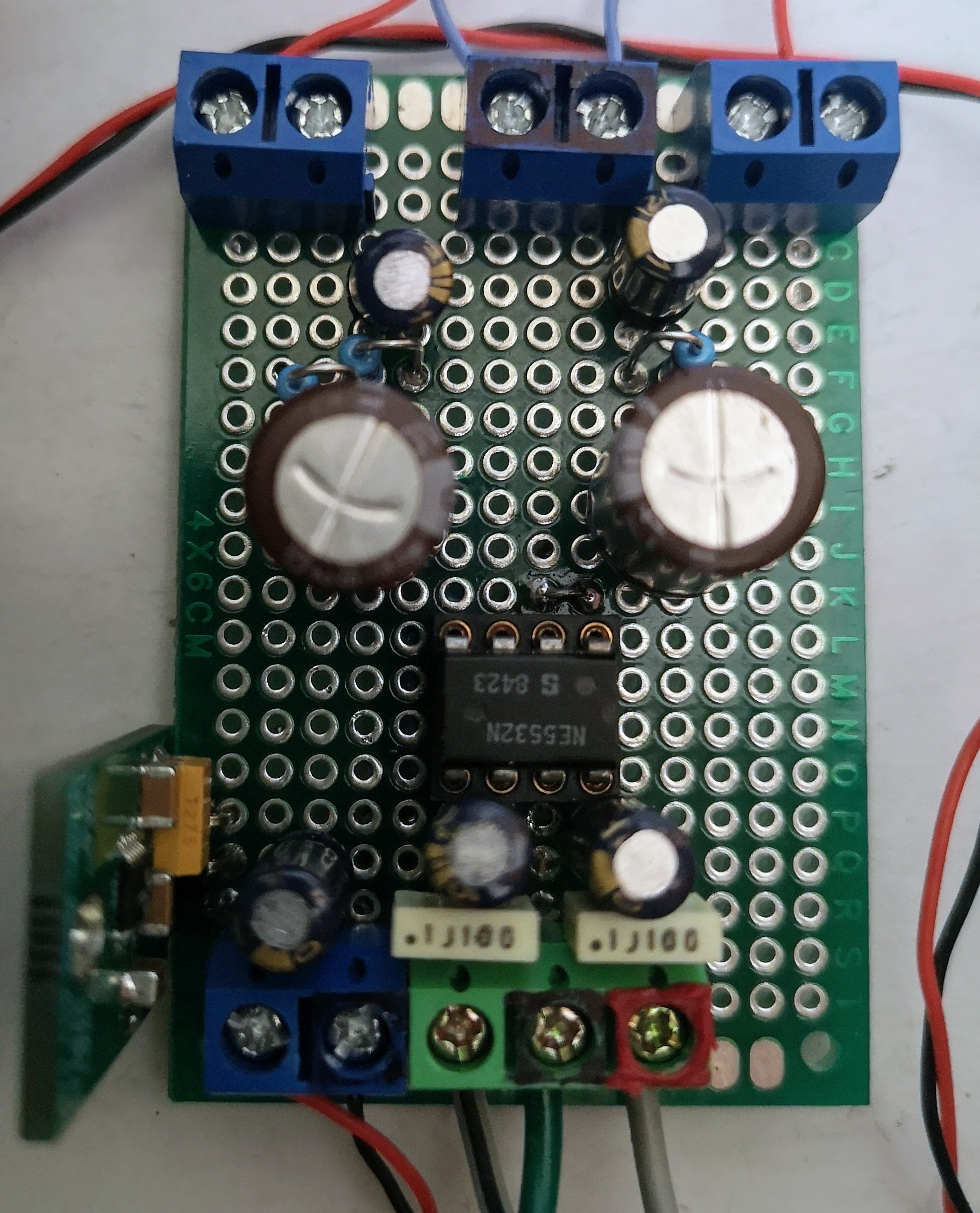

As promised, some pics of the test dac and test power supply board currently under development. The dac is working right now in with the dac chip operating in synchronous mode, clocked by the JLsounds I2CoverUSB board.
The dac board is an diyinhk ES9028PRO board that comes with the dac chip and one regulator chip installed on the otherwise bare board. The board is designed to work with through hole or SMD components. Opamps are all OPA1611.
Have tested the dac with 16/44 CD rips and using HQplayer (version 3 demo) to upsample to DSD. With a fast computer the best HQplayer algorithms sound very good (if the dac itself is good).
As is well known among people that have tried it, Sabre dacs typically sound better operating in synchronous mode and with upsampled DSD. Main problem with using HQplayer rather than AK4137 for that is cost. HQplayer costs much more than AK4137 and so does a fast computer. However, sound quality is better than AK4137 when HQplayer is running its best algorithms, IMHO. That being said, AK4137 can still sound excellent if properly implemented.
Dac registers are programmed by the existing Arduino setup borrowed from modded dac#2. Pretty soon the new dac will get its own Arduino.
There are still things to work on, AVCC sound quality being one. The TP Trident regulators shown in the pics for VCCA, DVCC, and AVCC are all being fed 6.7v from an external regulator on the power supply board. AVCC Trident does not have added load resistors at the moment, but trying that did help sound quality with another dac.
