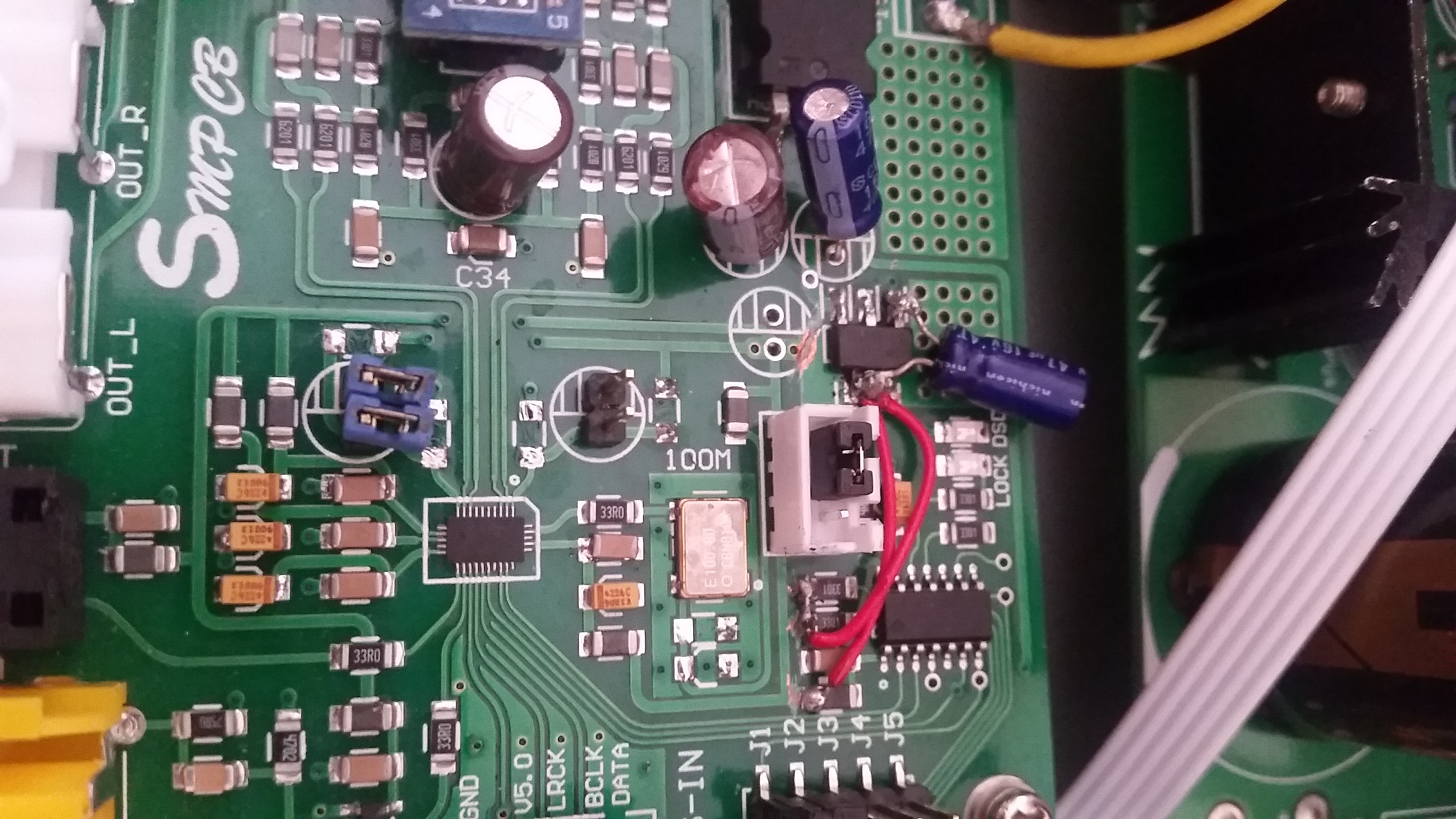

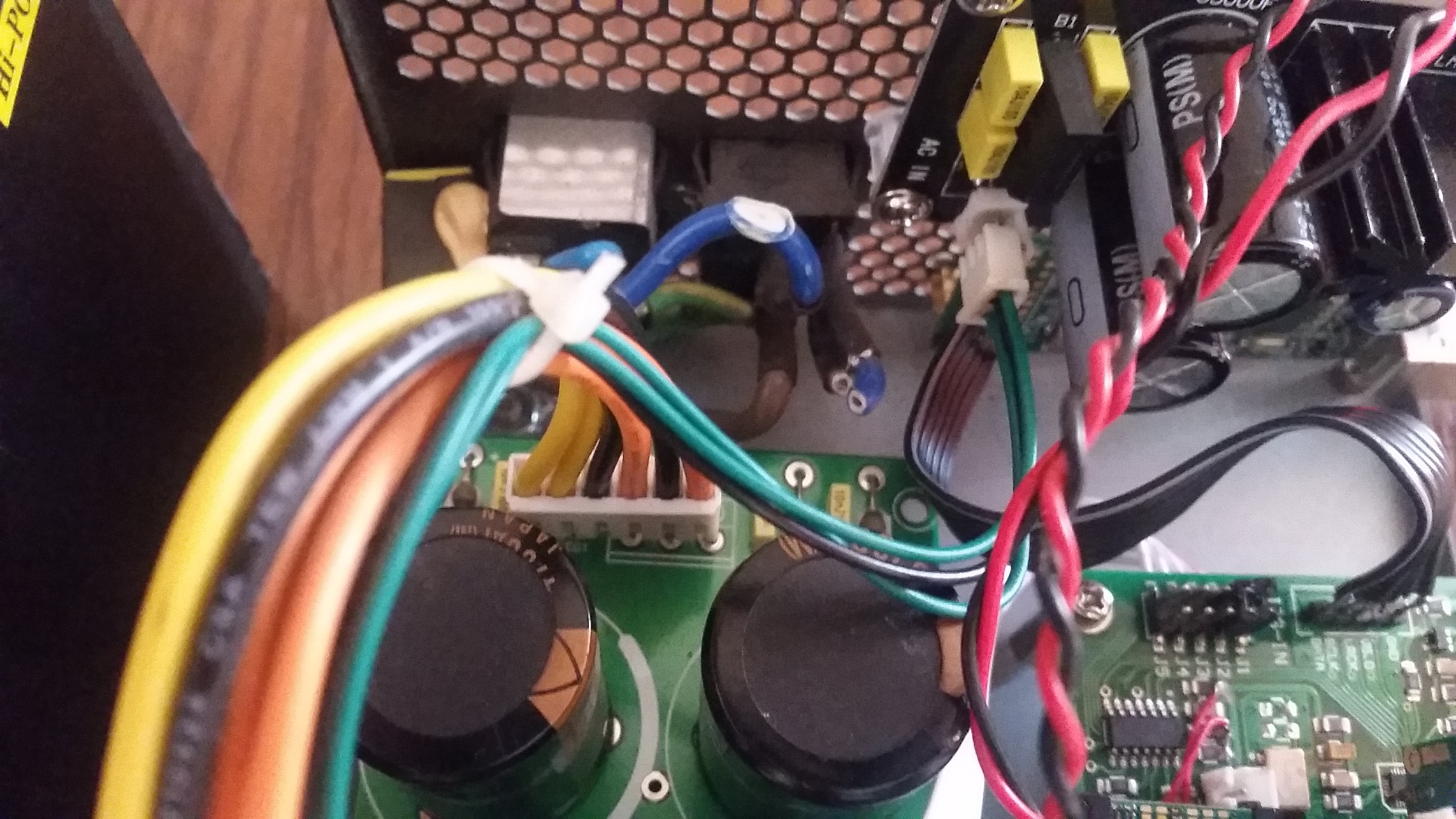

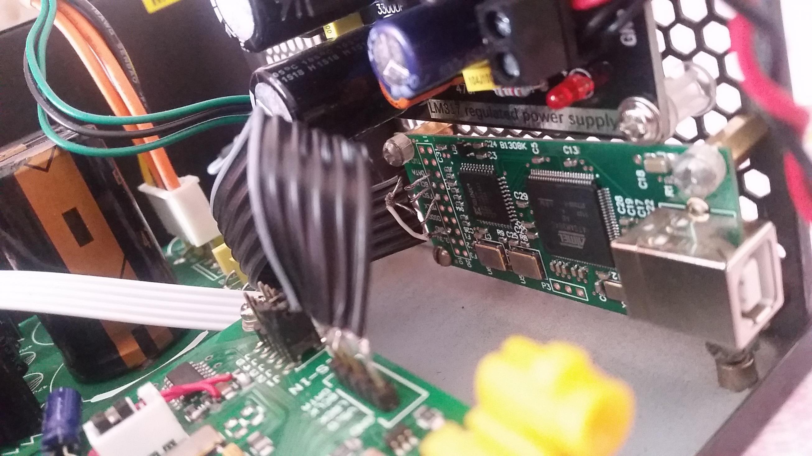

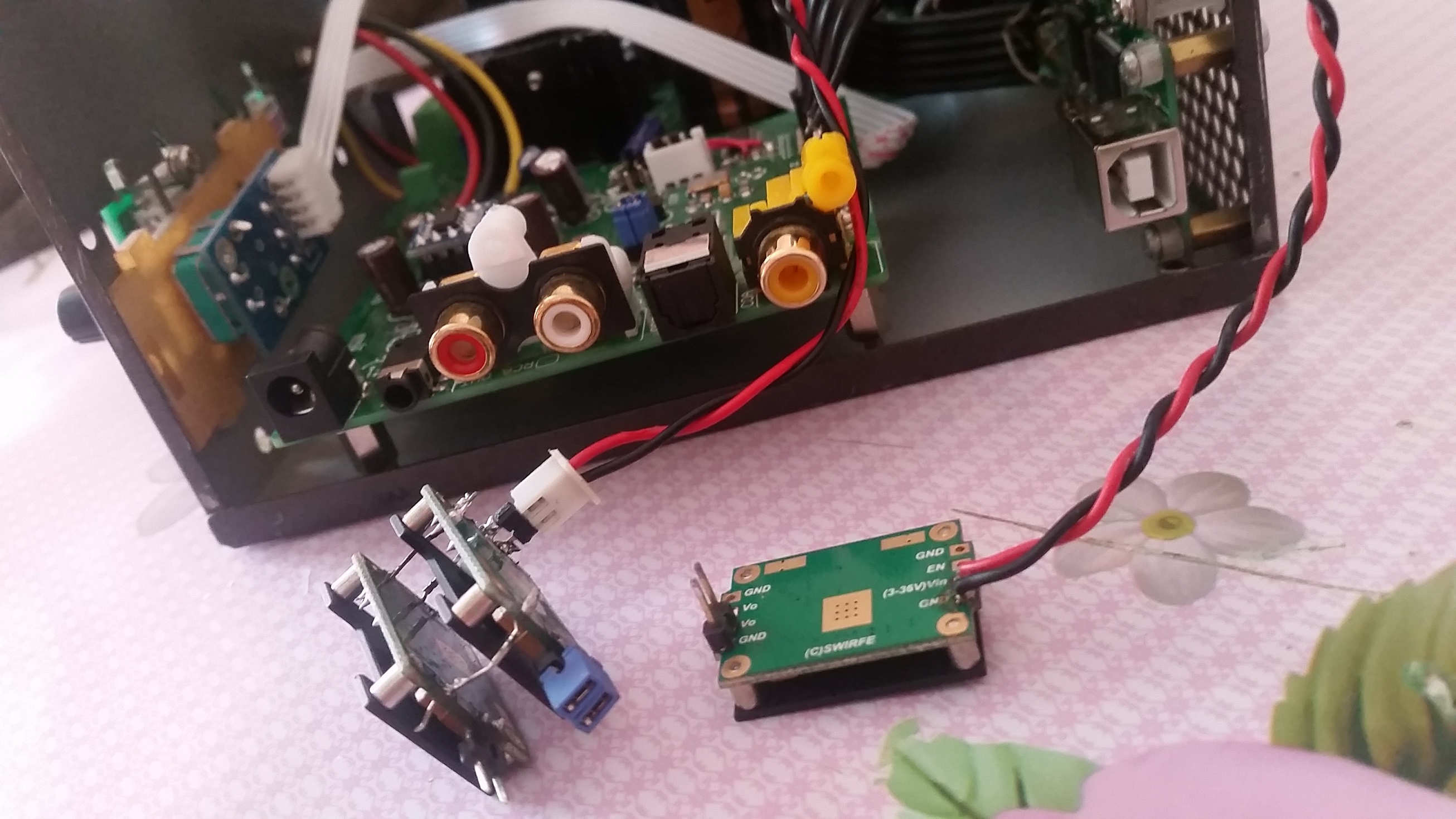

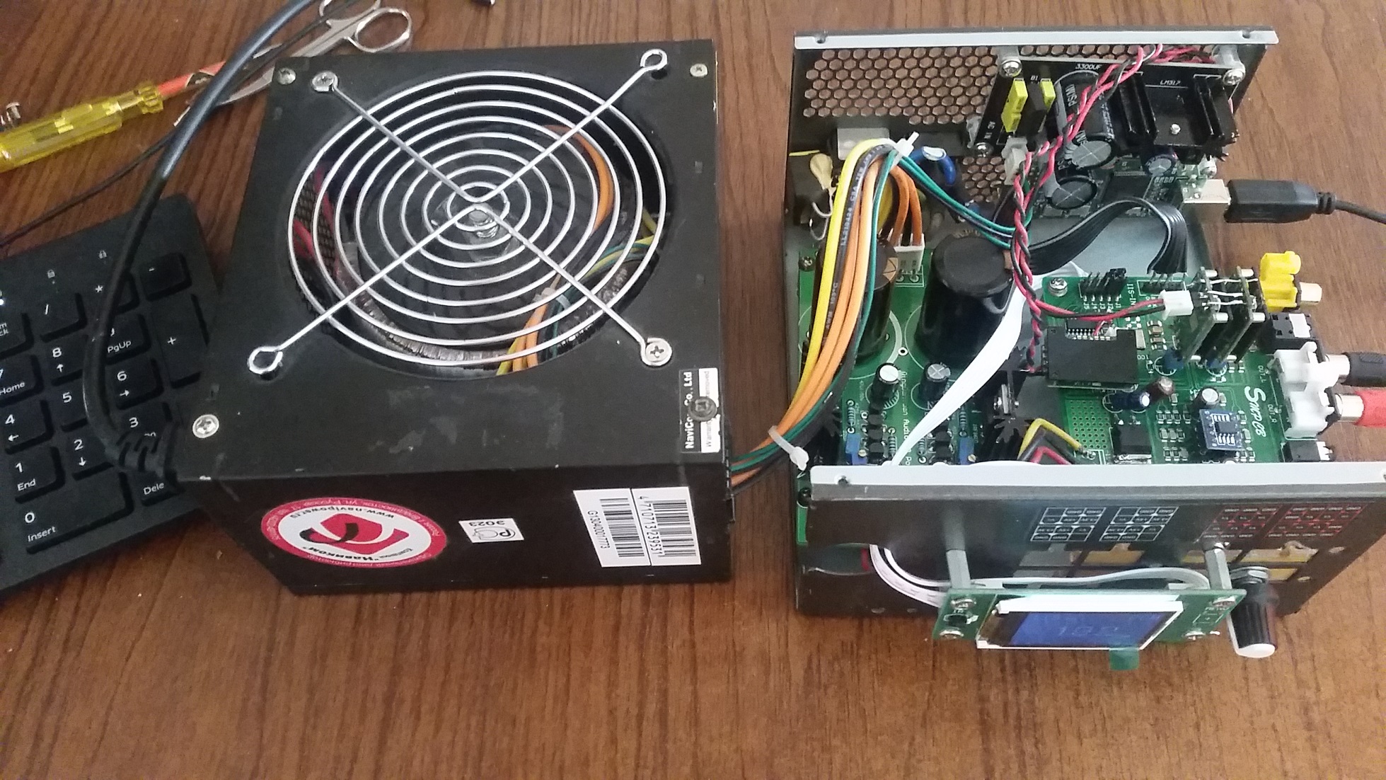

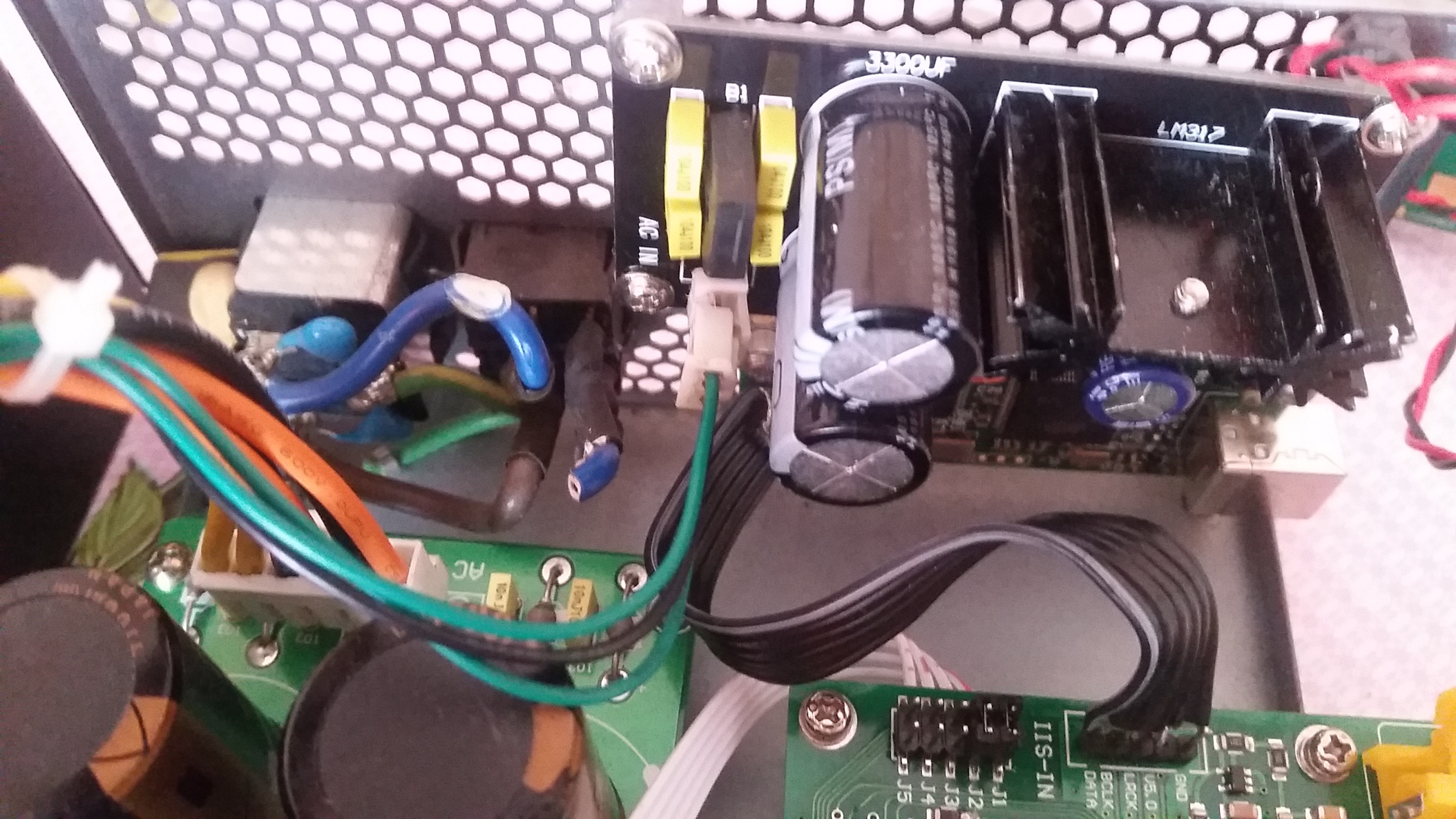

Hey. I already got the protection fee. Arduino's on the way somewhere. Ready according to your recommendations to change the settings es9038q2m. I removed the AVCC film caps like you said. And then removed the ceramic capacitors on the es9038q2m Board that filter the AVCC power line next to the chip. And the sound stopped being sharp. the problem went away. Through what service can I upload photos to the forum?May I ask if anyone has gotten started yet with Arduino or other means for accessing registers?

Regarding film caps, I'm not sure which ones you mean. Perhaps I don't remember what you were using for AVCC before?
I use TPS7A4700 for AVCC. And to remove the sharpness in the sound, I added the output ldo film 47 nF. After your criticism, I removed them. now there are, if I'm not mistaken, 57 nF ordinary ceramics. Here is a photo. This is a temporary structure. To looked good and was easy to change something at any moment.You can attach jpg files less than 1MB in size if you click on the advanced editing button and or scroll down to the 'manage attachments' button located below the reply/editing window. The images will be stored at diyaudio. I usually crop pictures, then reduce jpg quality until file size is under the 1MB limit (assuming the file was too big to attach without editing).
I started looking into using LDOs for AVCC, at least a little bit. So far only tried ADM7150 (a recent issue Twisted Pear Trident-SR). Didn't sound very good at first. Tried adding a 33-ohm, 1/2-watt resistor from the regulator output to ground. That seemed to improve sound quality some. I then increased the input voltage to the ADM7150 from 5v to 5.7v, and then to 6.7v (using an adjustable pre-regulator in this case). Sound quality seemed best using 6.7v for the input. I did not notice further improvement going to slightly higher input voltages, so I stopped at 6.7v to minimize unnecessary heating of the regulator.
I recently have been advised that it is not unusual for adding a resistor from the voltage regulator output to ground to improve sound quality in analog audio circuits. I kind of assume it works by reducing the source impedance seen by the load over a fairly wide range of frequencies. Similarly, I was advised that increasing regulator input voltage may also help improve sound quality.
