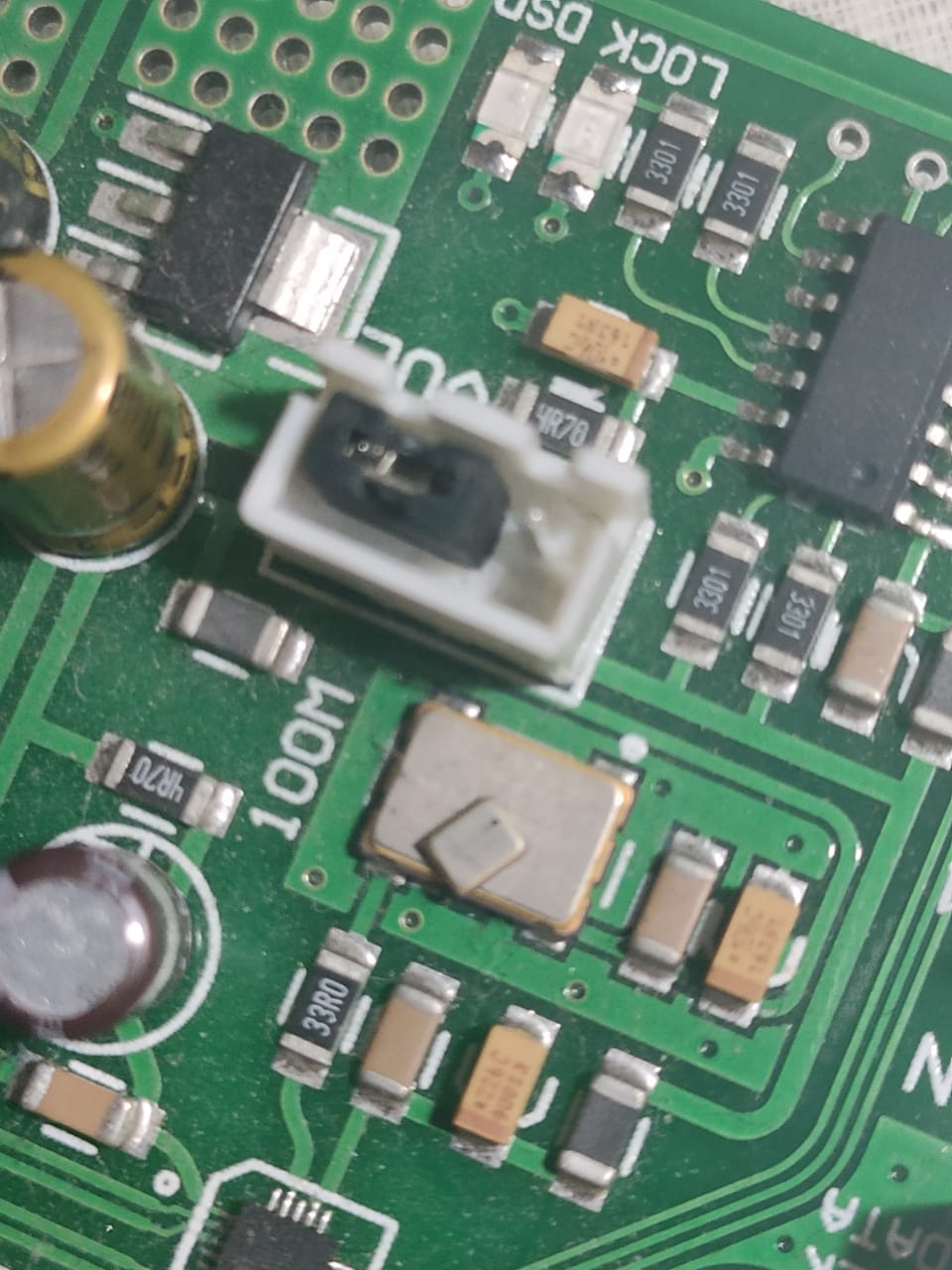

Regarding the NDK NZ2520SDA clocks, My friend got a 49.152mhz for $11 including shipping from diyinhk. It fits in the v1.07 green board where they made pads for a smaller size clock within the larger pad. We managed to replace it. Nearly made an error when we tried to solder it with iron and got the solder to short the connections through the top metal case. heat up occurs, fortunately realise it before damage. Finally made it to work with heating by hot air gun and letting it sink into the pads. It is really small.

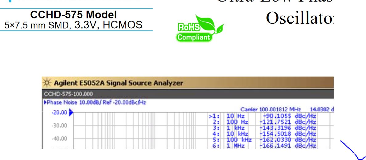

The datasheet seems to suggest a phase noise of around -122dbc at 10hz compared to -90dbc for the one we use i.e. the cchd-575 crystek, although the noise floor is higher at around -158dbc vs -168dbc.
The mod is a definite improvement soundwise from the stock clock, but since his board is still in the process of modding, yet to do avcc & output stage mod plus ak4137, I could not compare it.
Since it is not expensive, I want to try them to see if it improves sq, especially the lower frequencies. There is a choice of the following freqs : 49.152Mhz/45.1584Mhz/24.576Mhz/22.5792Mhz.
Will there a problem using one of those since our clock is 100Mhz? If not, which one would be the ideal choice among these?

It depends. If one wants to be able to play the highest sample rates ES9038Q2M can play in asynchronous mode, then 100MHz (or something closer to that) is better. Some people have tried an 80MHz NZ2520SD (no 'A' suffix), and been happy with the sound.
If one wants to do the clock divider mod the same way I did then 100MHz is better.
If doesn't want those things then various possibilities exist.
If one specifically wants to make a synchronous mode dac, then at set of two NZ25520SDA clocks would be one of the two most popular choices. However, some people like the sound of Crystek 957 clocks for that type of dac. There are various other audio clock manufacturers too, of course.
All the above having been said, aside from standard asynchronous mode operation with a single clock, all options would require some dac register programming, at a minimum. Some options might require more extensive mods we haven't talked about much in this thread.
A single 49MHz NZ2520SDA could be used with the dac board we mod here, with the main limitation that some of the highest sample rates couldn't be played (asynchronously).

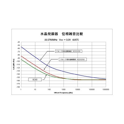

Thanks for the write-up. Indeed the NZ2520SDA datasheet do not include performance graph. The one I attached is from diyinhk; I don't know where they get it from.

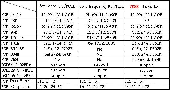

All things considered, it might not be a better idea to replace the crystek clock. If the supported sample rates follows the one detailed in the description of AK4137 board (attached below), there's various sample rates that cannot be played whichever clock frequency one choses, unless multiple clocks are used.
Those number are only for what frequencies the AK4137 board can output, not what input it can accept. Doesn't matter for us if using the clock divider since the 22MHz clock gets removed and AK4137 output sample rate is always set to 12.5MHz DSD256.
@Extreme_Boky
Thank you. The 1st document posted today appears to be an announcement or press release, not the data sheet NDK issues today. The document does confirm the lowest guaranteed offset frequency spec is at 1KHz.
something I posted earlier...
Don't know where the text in that originated. Doesn't sound like it was written by NDK.
