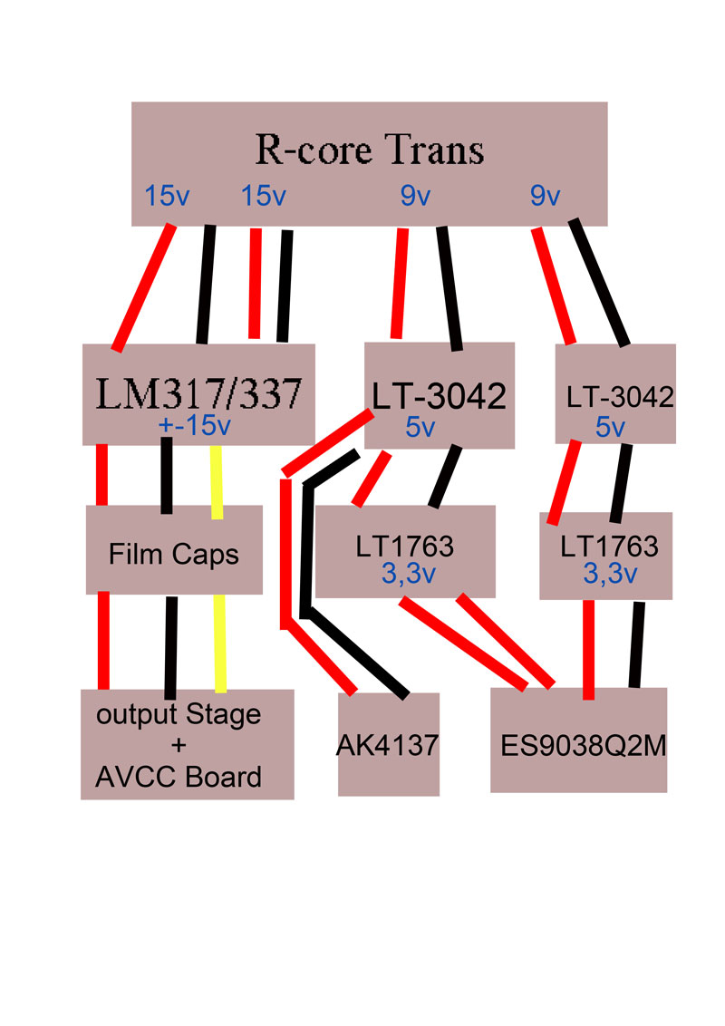

Hi Mark,
I do use a collection of jantzen & dayton film caps 45.84uf per line for +-15v. Details at ES9038Q2M Board. They improved the sound a lot.
Regarding the ground connections, I used ground connections for all lines. These includes lm317/337, two lt3042s, two lt1763s. Becomes confusing, Diagram attached below.
Kay.
Kay.
The ground diagram raises some concerns. It looks like you have two red lines going to the dac chip from the same upstream regulator that powers AK4137, but no black ground directly to the dac chip from there. That can't be right.
Also, where the AK4137 and dac chip share grounds from the shared regulator, you may find sound quality is improved by using one or two ferrite clamps on the AK4137 ground wire. That will help keep I2S ground currrents from partially returning through that ground path between AK4137 and the dac chip.

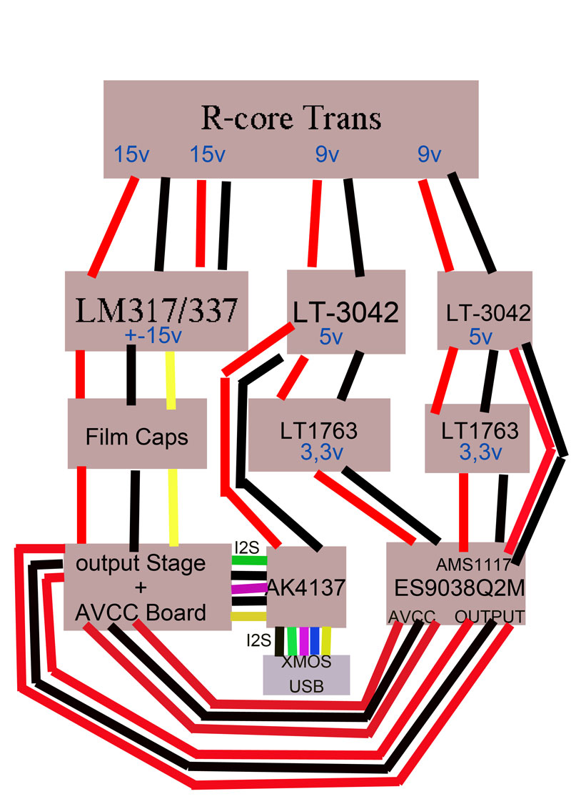

Hi Mark,
Sorry for the poor diagram. Corrected one attached below.
What kind of ferrite clamps? Like this is ok? https://www.amazon.in/Ferrite-10-Pack-Suppressor-Filter-Antenna/dp/B015E8DHC0.
Also included signal lines in the corrected diagram.
