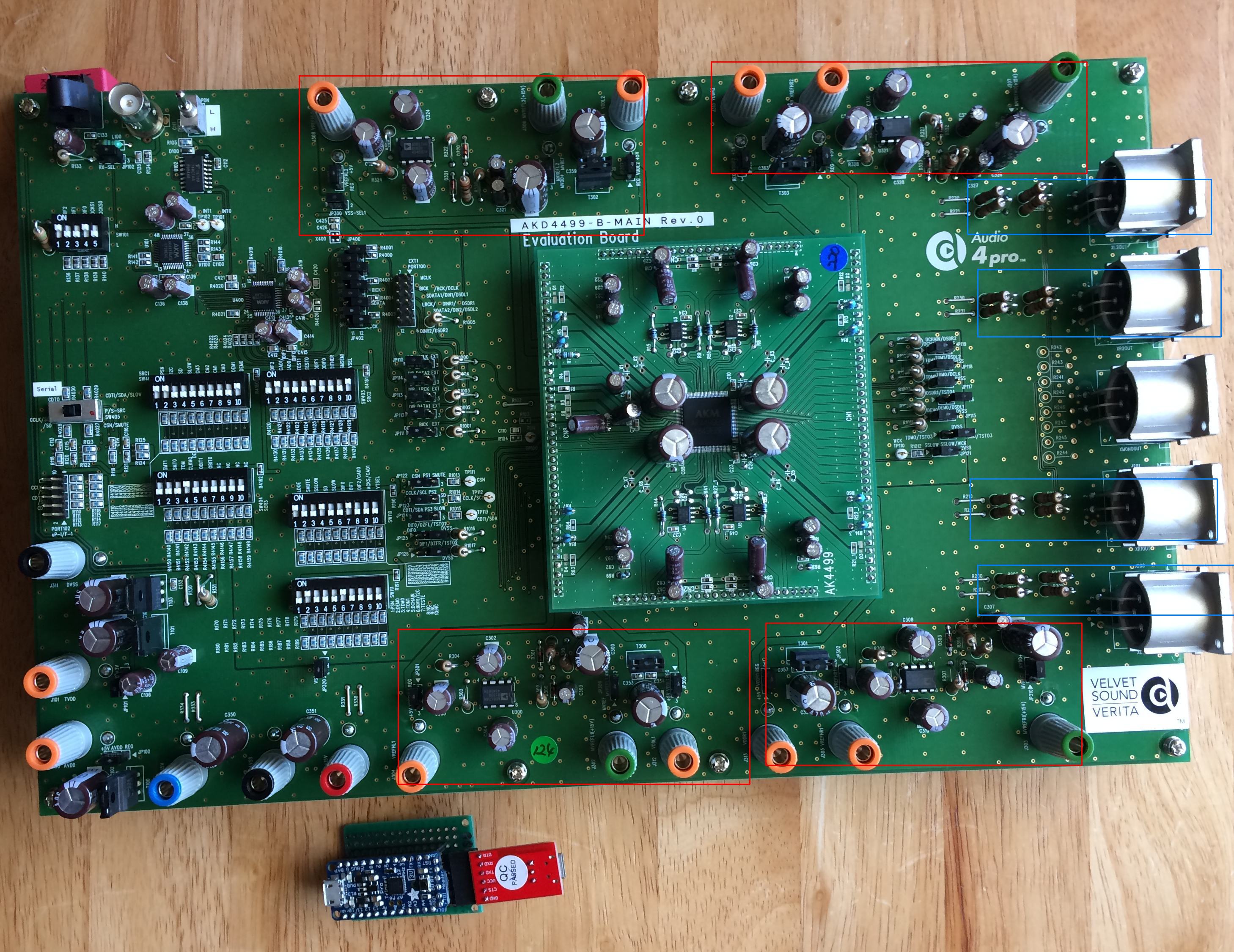

AK4499 is up and running using JLsounds USB board for input and MCLK, and Arduino for control. PCM only today, will try to get to DSD tomorrow. 16/44 sounds quite good, very promising, and much easier to get good sound out of than a Sabre dac, IME, so far. This is with the most basic power supply configuration and no differential summing stage. Passively filtered I/V outputs into my HPA balanced input.

- How much was the Eval Board
- Did they do a reasonable job of the layout
- What opamps are they using for I-V
Cheers
Terry
$0
Obviously, not the final price. Jam and I guess they would likely have to cost several hundred dollars each.
Yes, except the I2S inputs are near the middle of the board, but no local mounting points to put a USB board very close to that. The motherboard is 4-layer, but I found a spot where I could drill one hole to make a mounting point close to where I wanted one.
OPA1611. Sound is likely also very dependent on the 5v Reference Voltage (AVCC-ish) circuits, of which there are four, one for each channel.

Terry,
My bad. AK4499 daughterboard has four OPA1612, not eight OPA1611. Sorry about that.
The pic I posted shows it pretty clearly if you blow it up to full size. It as back at: https://www.diyaudio.com/forums/digital-line-level/314935-es9038q2m-board-457.html#post5830912
The board looks pretty good to me. Swapping the OPA's is no problem but you can only do it so many times before damage occurs.
The I2S also looks pretty nicely accessible but probably better to attach it on
the DAC board.
Note the four large electro caps on DAC board, I'm presuming they are for
analog supplies, interesting, they are large!
Are there any components such as bypass caps on underside of DAC board?
Where are DAC AVCC regs? They really should be on DAC board.
WRT current mode only, I'm sure it will happily swing OP voltage but the question is at what distortion / sonic cost?
Overall, it should sound pretty good, they have done a fairly decent job.
There are some components including ICs under the mainboard. Haven't looked under the dac daughterboard.
Please see areas outlined in red below. One AVCC reg for each channel.
Blue areas are passive differential analog output filters. Caps on underside of board.
