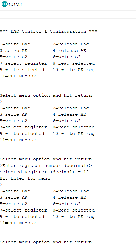

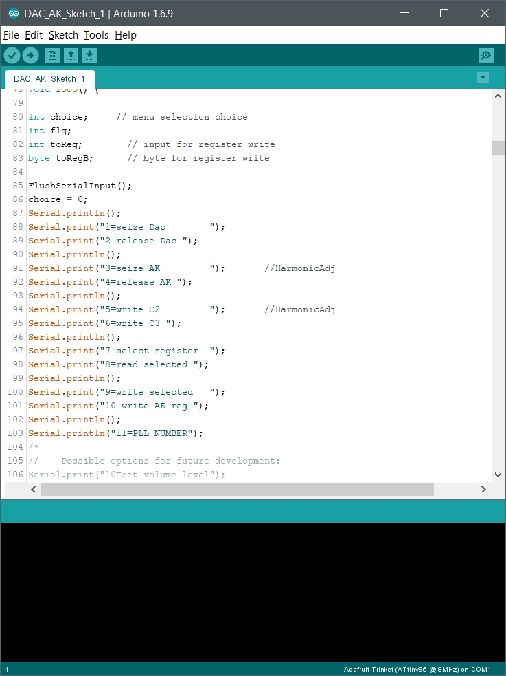

Hi Mark,
Finally got printout from Serial Monitor using the DAC Sketch you provided. The issue was two-fold. The adding of Softi2cMaster as a zip file as you said, and that the SM baud rate default was 9600. The sketch uses 1200. On setting this, I could access the menu, DAC Control & Configuration.
The first thing I tried was option 1, seize dac. That just gives me printout of the menu again. Is this correct? Should some msg of confirmation be there I wonder? Otherwise am guessing the MCU still blocks the connection.
Then I went to option 7, select register. >Enter register number (decimal)>. Entered 12, got Selected Register (decimal) = 12, Hit Enter for menu. Then tried option 8-read selected, and press enter. It just gives the menu again.
Any thoughts? When you have the time, you must be busy with AK4499 of which your comments are very exciting, further comments eagerly anticipated.
Cheers & Regards,
Kay

Hi Kay,
Yes, the Arduino Trinket boards I use require use of an FTDI board for serial communications, and its baud rate is 1200. 9600 is a more common baud rate for many serial ports (like in the old RS-232, in this case emulated over USB) communication.
If you have not already done it, I would suggest to go into the Arduino compiler preferences and check the box to show line numbers. That makes it easier to find sections of the program sometimes.
When you enter a menu option, such as the example you gave, there should be a cursor in the little one line box at the top of the serial monitor window. That is where you enter text such as menu numbers. The behavior you see is what you get if the program does not recognize that you typed in a valid menu number. In that case it just displays the menu again.
First thing to do would be to make sure an 8 appears in the serial monitor box before you press enter. If not there could be some issue with the keyboard.
If everything looks okay up to that point then we may have look in the program to find out why it isn't giving a proper response. The menu part of the program can be seen starting around line 85 as shown below. After that, the menu number you type in is read into the program at line 120. It then calls a function at the end of the program to convert the number code you typed in into an INTeger number for evaluation by the CASE statements. The conversion function starts at line 668, etc.
We can print out messages at any point to see what the program thinks its doing. However, my guess at this point is that either an 8 isn't appearing in the input box, or you are using something other than a US keyboard and the character codes are different. Otherwise, the program should get to case 8 at line 224 and print out something other than the menu to the serial monitor display.
Please let me know whatever you may find out and or if you are not sure what to do at any point. I can help you sort through whatever the problem is, most likely.
-Mark

Kay,
A bit more to add to my response above:
The options to seize and release the dac operate a DPDT relay via one of the Arduino output pins. I need that because my dac is not version 1.7 with the ability to stop the MCU using J1, J2. Therefore, I need to take control of the I2C bus away from the MCU and give it to Arduino. If you don't hook a relay like that to your Arduino then those first two menu options won't do anything.
The other thing I wanted to add is that I have been using the Arduino compiler Serial Monitor to talk to the Arduino, not a separate terminal emulator program. At one time I had the programming working either way, terminal emulator or serial monitor, but the menu interface didn't work properly with putty terminal emulator and I didn't get around to fixing it.
Last thing, once you get it talking to the dac, we can go into some other details about using the program. There still may be some issues making sure I2C is fully working, have to see. By the way, there are really cheap and low bandwidth scopes available on ebay for $15 or so. The scopes are good enough to see I2C signals working or not, and to see audio and higher frequencies up to 200kHz or so. Not necessarily enough bandwidth to see an opamp oscillating, or to look at clocks. But for $15, still likely better than nothing. Fully Welded Assembled DSO138 2.4" TFT Digital Oscilloscope (1Msps) + Probe B1 | eBay ...they do need a little power supply, and a 10x scope probe would also be a very good add-on accessory. DSO-Shell (DSO150) Oscilloscope Full Assembled with P6020 BNC Standard Probe 689286393428 | eBay
