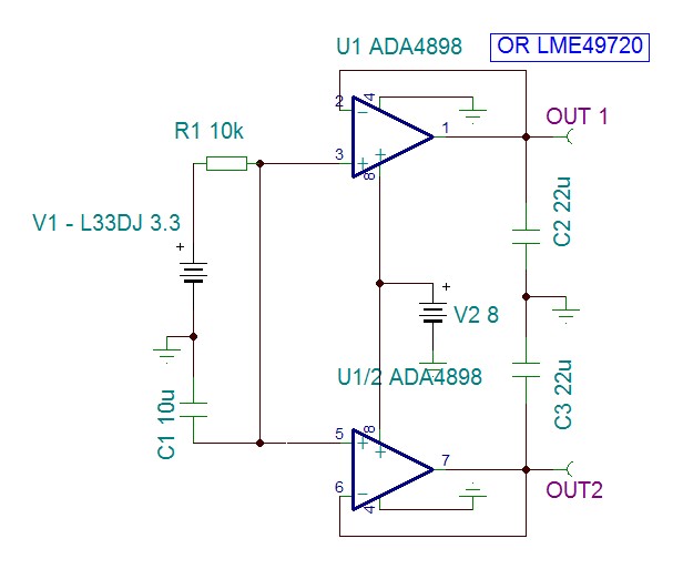

Also perhaps worth mentioning about some good opamps to use, IME. I have been using OPA1612 for everything as of recent (AVCC, I/V, differential summing). They and many other opamps tend to sound better with some several uf of film caps from each of the +-15v rails to ground. Some people have reported better sound quality with as little as 15uf of film caps per rail. Similarly good results may obtainable from using high gain audio-friendly voltage regulators such as Jung-Didden, or especially if cost and or size is an issue, perhaps Nazar regulators. We can probably provide some more info about the latter if you are interested.
Another opamp that is very good for AVCC is AD797. However, those particular opamps usually work better with no film caps on the +-15v rails. Too much low ESR capacitance on the power rails can cause stability issues in that case, IME.
However, film caps are probably worth a try if using other good audio opamps such as OPA1612 or LME49720/LME49860. The caps tend to help get rid of the last bit of graininess in the sound that may perhaps be most easily noticeable for things such as cymbals.
Also if interested, the AVCC schematic we use can be found attached to post #3003 in this thread.

Thanks for offer Mark, I dont understand the target of 1.65V for vref (which as we noticed does vary slightly higher and lower in some implemenations).
For one, you could get higher output levels from the I/V while remaining in Class A with a higher reference voltage.
1.65v = AVCC/2 and is the quiescent and average output voltage of the dac. Using it for Vref makes the dac output current = 0ma on average. Whether or not that is optimal in all ways is not something that ESS has said.
Some people may like to adjust the Vref voltage divider so as to make the average I/V output voltage = 0v. In that case, low level audio signals will be operating right in the area where opamp output crossover distortion sits. Maybe not so good for small signals coming out of the I/V stage, but maybe better for the differential summing stage. Distortion in the differential summing stage may be lower if the quiescent or average input common mode offset is = 0v. So, we could adjust Vref for lowest distortion coming out of the differential summing stage.
Another possible source of distortion with bipolar opamps we use for audio, such as OPA1612, is related to input bias currents. The bias currents are large enough that dc input resistance looking out through the opamp inputs combined with the bias current will create a voltage drop, which is an error source. If we can't keep dc resistance really low as seen by both opamp inputs, we should at least make the dc resistance of both of them look the same. That way the bias error is mostly due to the input bias offset current. However, none of the commonly seen Vref voltage dividers makes the noninverting input see the same dc resistance as the inverting input. The voltage divider might have to have a source resistance that looks more like 400-ohms for that. Then again, maybe the error is only a dc offset error, not a dynamic one affecting sound quality. Although there is a graph in the OPA1516 data sheet showing distortion as a function of input resistance, the test circuit they use is not the exact same circuit we are using. If unsure, probably best to run a suite of measurements with an AP to see what changes and to what makes distortion better or worse. Doing a measurement only at 1kHz and one input level is probably not adequate, IMHO.
What it means, I think, is that there are many possible sources of distortion in modern, ultra-low distortion SD dacs. There are no Self or Cordell books on dacs with lists of all sources of known distortion to look out for. People are still finding more everyday, it seems like.
