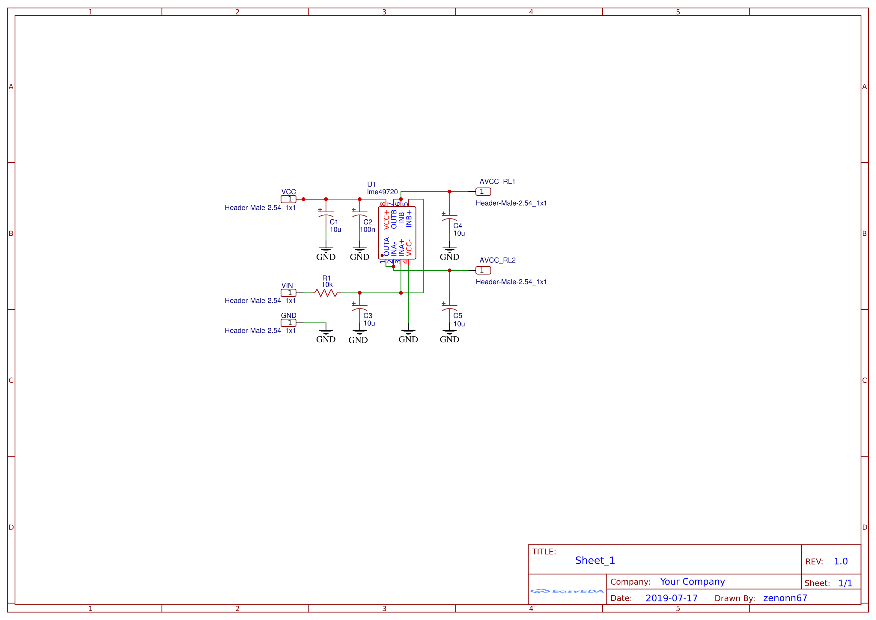

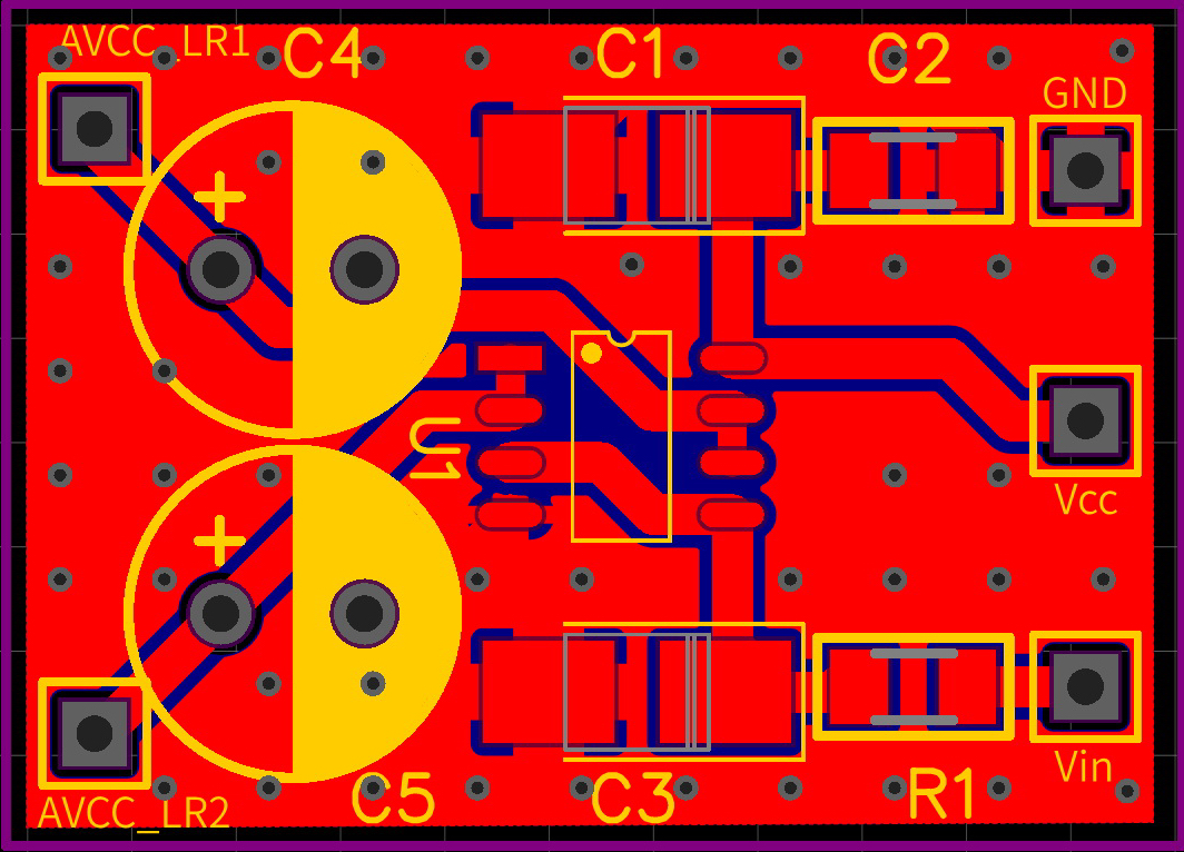

ES9038Q2M Board
PCB (AVCC_LR)
*.json project files in zip.
Looks nice. Hope you won't be offended if I point out some potential issues, most of which we have already experienced having to sort out to improve sound quality. If I may:
ESS has specific advice about keeping AVCC on the dac ground plane and adjacent to the dac chip AVCC pins. http://www.esstech.com/files/4514/4095/4306/Application_Note_Component_Selection_and_PCB_Layout.pdf
It turns out that merely connecting a 10k and 10uf input filter to noisy 3.3v power will adversely affect dac sound quality. The AVCC input should be fed from a dedicated low noise 3.3v reference. LTC6655 or LT3042 with no other loads attached might be suitable.
Also, LME49720 is sensitive to some types of RF, such as 2GHz from DECT phone base stations. It should be shielded from RF to prevent unwanted distortion, or the dac places in an enclosed metal box. Probably better to use OPA1612 anyway, less sensitive to RF and may sound a little better too. Dual AD797 AVCC regulators might be slightly better yet, and can also be used for ES9028PRO.
In addition, another possible consideration is with the opamp VCC- connected to ground, then the opamps are running with inputs and outputs offset to within 3.3v of VCC-. Don't know if it affects sound quality, but in a non-inverting configuration, common mode distortion may be higher when the inputs are far from centered between VCC+ and VCC-. You might try connecting VCC- to -15v and see if any audible difference. That being said, the smallest audible differences won't be noticeable/audible until everything about the dac is as cleaned up as it should be.
I have seen no problems with damage to the dac by powering AVCC opamps from +-15v. If concerned about possible damage that could occur if the opamp outputs are too high or too low, zener clamps in the + direction and schottky diodes in the - direction could be used.
At some point there may also be a need to derive Vref signals from AVCC_L and AVCC_R. Recently, there has been some discussion over at ASR about eliminating the 'ESS hump' by, among other things, setting Vref to other than exactly AVCC/2. ESS THD ‘Hump’ Investigation | Page 14 | Audio Science Review (ASR) Forum
Thank's Mark!
This is a project witch, I believe, is enough flexible, so anyone can change parts, according specific needs.
Vref is only voltage input, so I'm sorry for misleading here...
About grounding plans...
The PSB is with strong ground (log time ago, I build many RF amplifiers) and with large traces, I hope.
Why LME49720?
I'm trying OPA2134, witch output stage is the same as OPA1612, and I'm not satisfied at all.
May be OPA1612 is OK, I don't know. But both OPA1612 and OPA2134 has a common emitter output stage. LME in other hand, has common collector, so it is better for loads like DAC AVCC, I believe. Just now, my AVCC power supply is based on LME, and sound is way better, than OPA2134. I beleive, that ADA797 or ADA4898 or any fast, low noise, low THD, high output currant OP Amp will be better. Again, I'm not tried OPA1612... yet 🙂
P.S.
Topping D10 (ES9018K2M), has not THD Hump. Vref is not AVCC/2 here.
Vref (Topping D10) is formed - 3.3v to 10k & 4.7k to GND (1.05V).
Rin = 806ohm, RF = 910ohm.
Ivo

Hi Mark!
May be I have not expressed correctly...
About AVCC: I am trying OPA2134, but sound was unnatural. Lack of middle highs, mute cymbals attack, drum attack, unnatural and mute sound. If You put sound equalizer's low's & high's freq up to the limit, You will have an idea of sound when OPA2134 is used as AVCC.
Then I swap OPA2134 to LME49720 and things goes far better.
This is an experiment with no other conditions changed, just AVCC OP Amp swap.
After that, I do some Tina Ti simulations (with some pulse load). OPA2134 oscillates, with capacitive loads. May be it's true, or not, because scope is shows nothing, but anyway, sound was not good.
About I/V stage.
After original OPA2134, witch gives me tight, flat and some how "cut off" sound, I swap it to LME49720. Minor improvements. A little bit airy and light, minor improvements in sound stage.
Then swap LME to ADA4898-2. Well, things are totally different since then. Sound become more natural... (to as much as my audio equipment allows me).
Why I said this?
I'm comparing (yes, brain is tend to forget), sound of my friend jazz band - only acoustic instruments.
These things are complicated, if we want best possible results.
It's a system with too many permutation actually...
Ivo

Because of impossibility to edit my previous post, here is updated version of AVCC_LR PSB project.

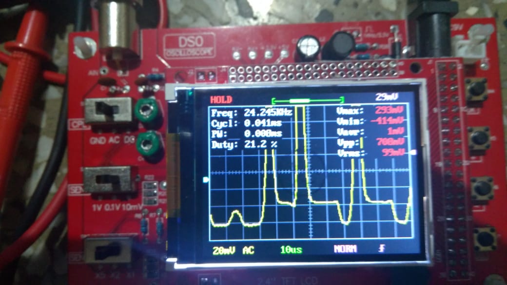

Is there a shortcut to test i2c connections on the arduino, mcu or dac pins?
Hi Kay,
You need some pullup resistors on the I2C bus so that normally, in the absence of I2C signals, it sits at 3.3v. Then the Arduino can pull down the bus with a fast stream of pulses when you send an I2C command.
Scopes have a trigger point which if you can set. It should be maybe 1.5v or so, somewhere about half way between 3.3v and ground. Doesn't have to be exact. When an I2C command is sent, the pulses will start in the downward voltage direction (from 3.3v going down towards ground), so if possible the trigger set for the down-arrow mode, meaning when the input drops below the trigger voltage you set, the scope start showing a sweep in time as the input voltage is changing. The horizontal axis is time and the vertical axis is input voltage. Before the I2C command is sent, the line on the scope should be visible kind of high on the screen. If you short the I2C pin you are monitoring to ground, the scope trace line should drop down to lower on the screen. Scopes usually have some trigger mode options. Auto mode means the scope will sweep and display a line even if there is no trigger event. Normal mode means the scope will only scan and display a line/trace when trigger events are present. Single mode means the scope will display the first trigger event then stop. You may have to play with the horizontal sweep rate to see the I2C pulses well. If they look too close together, speed up sweep a little. If you only see one edge of a pulse, slow down the sweep speed a little. Start with the sweep speed somewhere in the middle of its range and try lower or higher sweep speeds until you start to see trigger events.
Each time you send a I2C command a series of pulses will be sent and very soon be gone. It can help if you have someone to keep sending commands for you while you adjust the scope controls for a good view. I would suggest to try with the sweep set to normal mode.
If you don't have pullup resistors and if the arduino is not connected to the dac, you could try turning on the software pullups by setting PULLUP = 1 so you can run a test. Don't forget to set it back to 0 before you quit, otherwise you might not remember you left it set to 1. If using software enabled pullups, they will pull up close to Arduino Vcc, which for your arduino will be almost 5v instead of the 3.3v we use for the dac.
For displaying other signals on the dac, auto sweep mode is usually best at first. Then play around with the controls (and of course read all the manual on the scope you can find, if no directions, I may have them around here somewhere if I look), and pretty soon setting the scope controls will become second nature.
You didn't say if you got an 10x probe along with the scope. If so, we should talk about that.
Also, commercial scope manufacturers have some good app notes you can find on introduction to scopes and introduction to probes. The old Tektronics app notes are kind of classics in that area.
Connecting the MCU SDA pin to the red line and black to GND, I got something like the attached pic in DSO138. Does this show anything?
Hi Kay,
You should set the input coupling to DC mode for this measurement and set the vertical sensitivity to about 1v per divsion (if using a 1x probe).
Since you have the scope set to AC input coupling and 10mv per division, you are basically looking at low level noise.
In the above, I only turned on the dac and clipped the red to a pin under the lifted MCU sda pin, my very crude attempt at determining if the mcu still works/ if the mcu is the problem.
The MCU will need to be connected to pullups to see if it still works. You could solder leads to its lifted pins, then use some clip lead jumpers to attach pullup resistors to the wire leads so as to simulate the conditions needed for I2C bus to work. At that point you could use the scope to see if the MCU could pull down the I2C bus with clock and data pulses.
