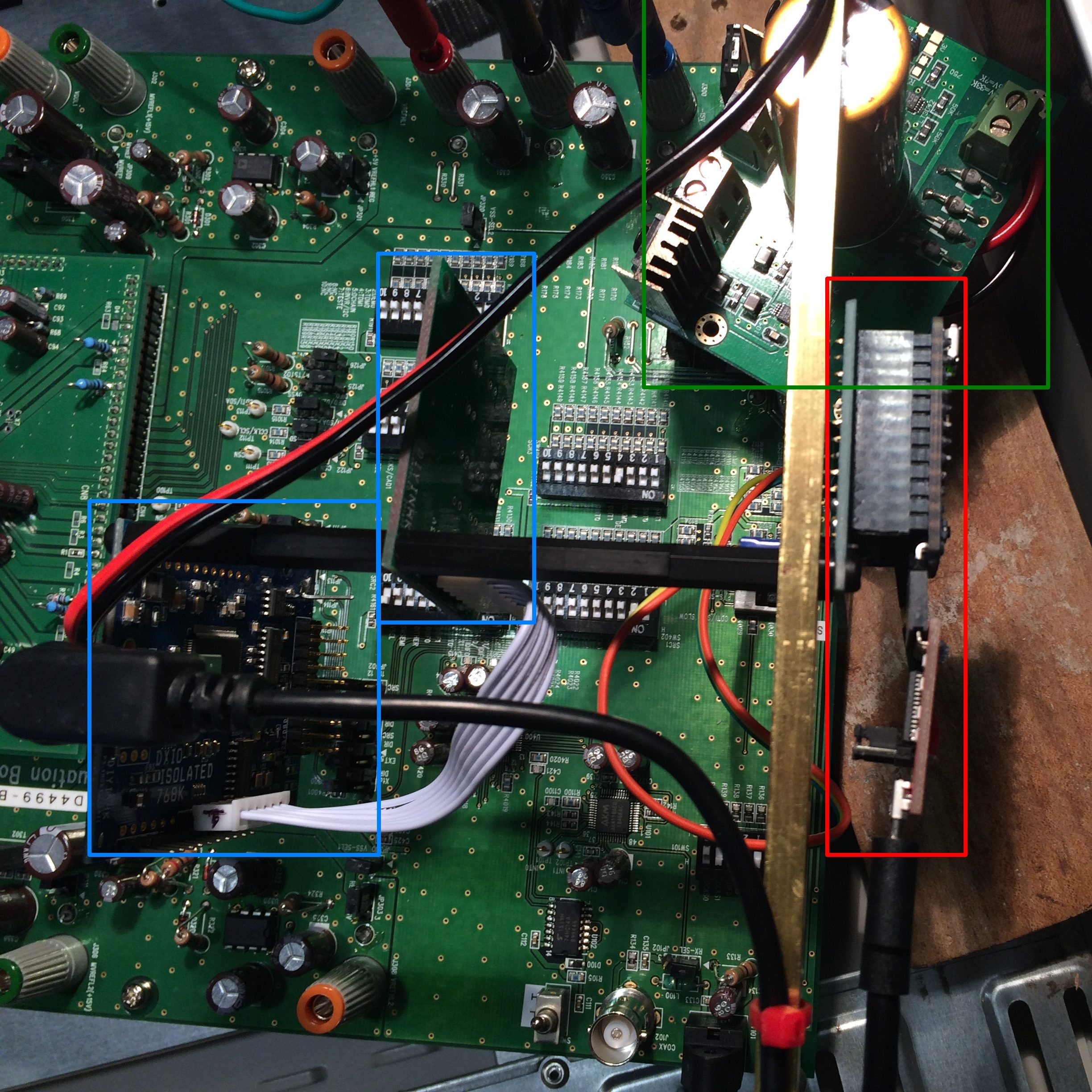

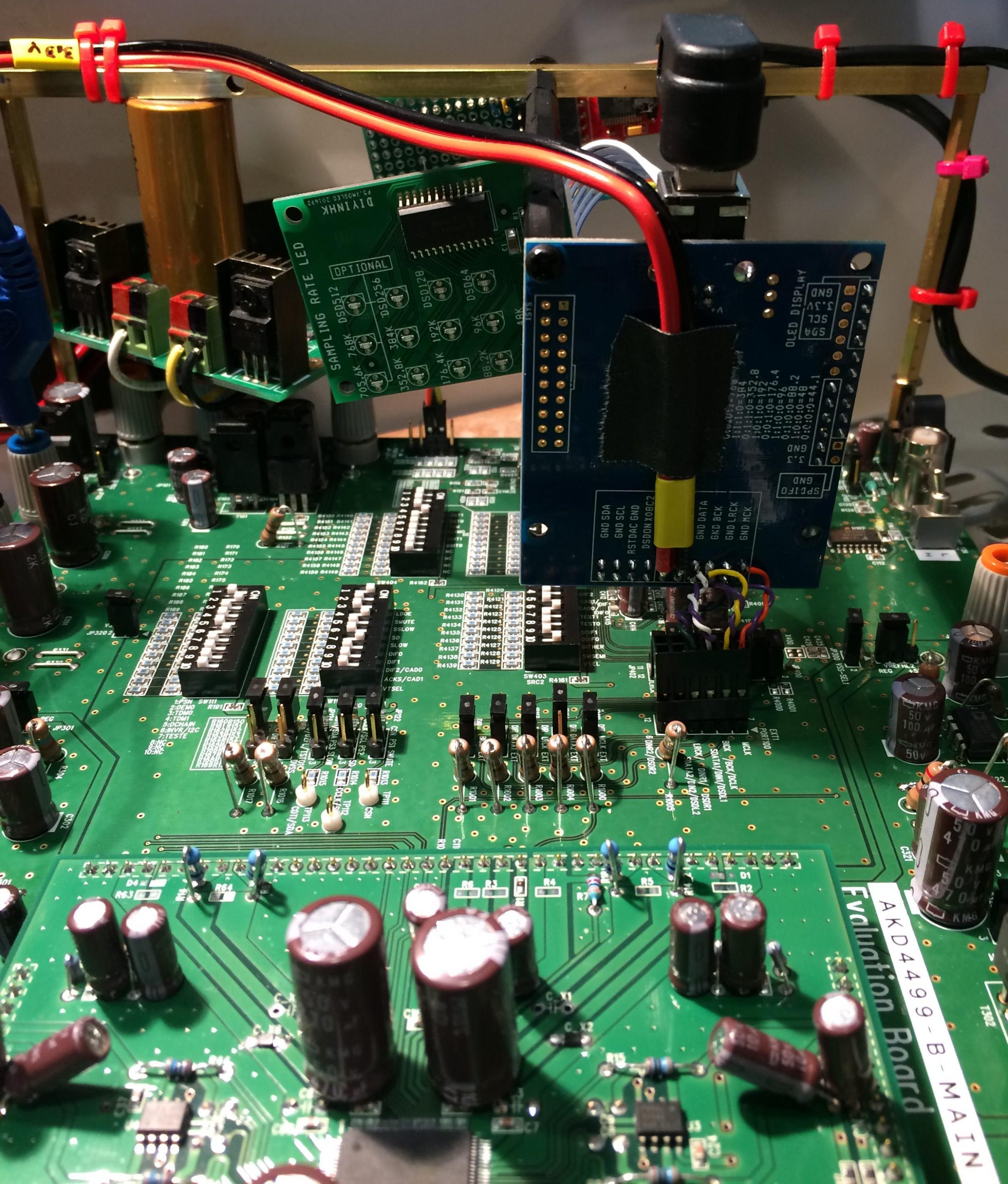

Right now its sitting inside a computer case on the bench. There are a couple of bench supplies powering it, one for +-15v, and the other for +8v. Both bench supplies and two computers are all plugged into separate ports of an ebay Monster HTPS 7000 MkII power conditioner (required for best sound quality at this point). The +-15v rails each have about 100uf of parallel film caps to ground. (Film caps mostly seem to be helping OPA1612 I/V opamps sound their best.)
Below are some pics. A top view inside the computer case, side view showing the busy end, and a top view of the busy end showing the USB board and sample rate indicator board in the blue areas, Arduino (with no wall wart anymore) in red, and in green a Chinese dual LT3042 board supplying +5v and +3.3v locally.
The USB board happens to be the diyinhk one, but could be the JLsounds one would have a bit more reliable driver. Haven't decided on that yet. Master clocks are NDK SDA series on USB board. The USB board is suspended right over the I2S input connector with the ground plane side facing towards the dac chip area.
A brass frame was constructed to hang stuff on using existing holes at the corners of the eval board.
The I2C input is directly below the Arduino.
The purpose of the LT3042 board is to get most of the local digital regulators on the dac board separated from the +15v rail, from which they otherwise would receive power by default. (The power supply change helped clear up sound quality noticeably in terms of improved clarity.)
The analog output is taken differentially into a Neurochrome HP-1 ultra-low distortion headphone amp. Headphones are Audeze LCD-X. I believe the HP-1 uses a differential receiver for the balanced input. I haven't checked, but it might be a That Corporation part.
DSD512 is provided by a powerful desktop computer, one of the two computers powered by way of the power conditioner. (A fair amount of time has been spent troubleshooting and sorting out computer, HQplayer, and USB board driver issues.)
Slowly, I am working my way down the board towards the dac analog out power supplies, and to where there needs to be some kind of dedicated balanced to single ended converter circuit added. (A preliminary test using a dac output stage board, not one I made, just the differential summing part and using OPA1612 didn't sound as good as the HP-1 differential input, so have to find out why.)
At the moment, I am thinking about what I want to try doing with the Reference Voltage Jung regulator supplies. The dac sounds quite good as is, so this is getting more into the experimental realm where I don't know if any changes will make it sound better or not, but I hope to find out.
Also, thinking about whether or not there will be an ESS hump type issue, and if so whether the same type of solution might work here.

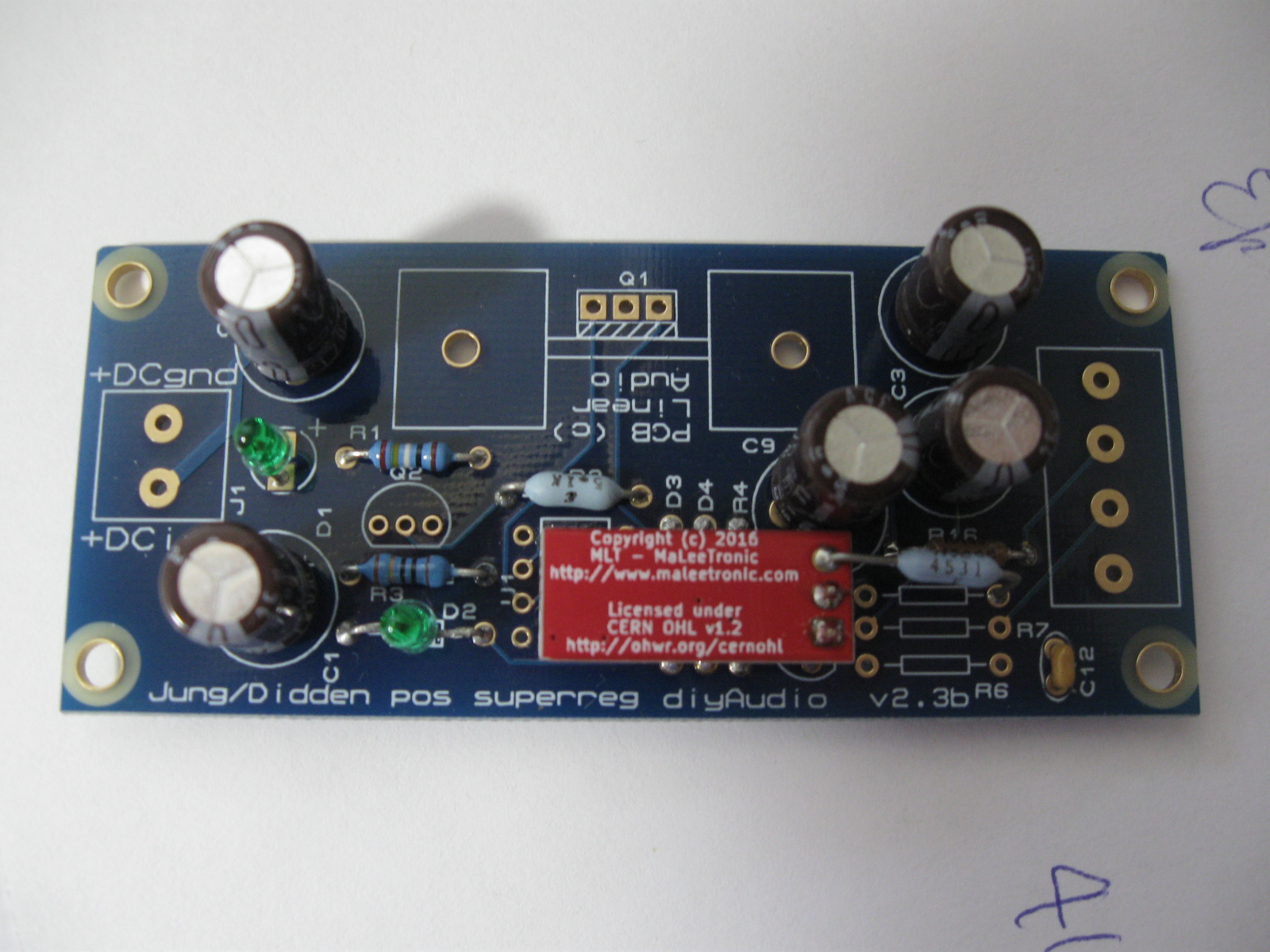

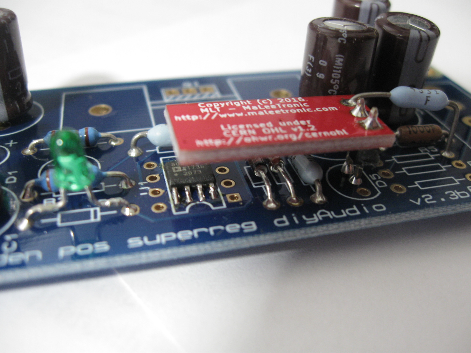

Here are a couple of pics from my slowly being constructed Jung SuperReg for AVCC using the LTC6655s. The LTC6655 module is inverted and connects directly to the Jung Super Reg board. I might fire it up this weekend if I get a chance. The op amp driving the low voltage is the AD8031 as suggested by Didden. This will be connected with remote sense via coaxial cables to minimize noise. It should be interesting how this compares when replacing a Sulzer Jung AVCC supply using the AD817.
