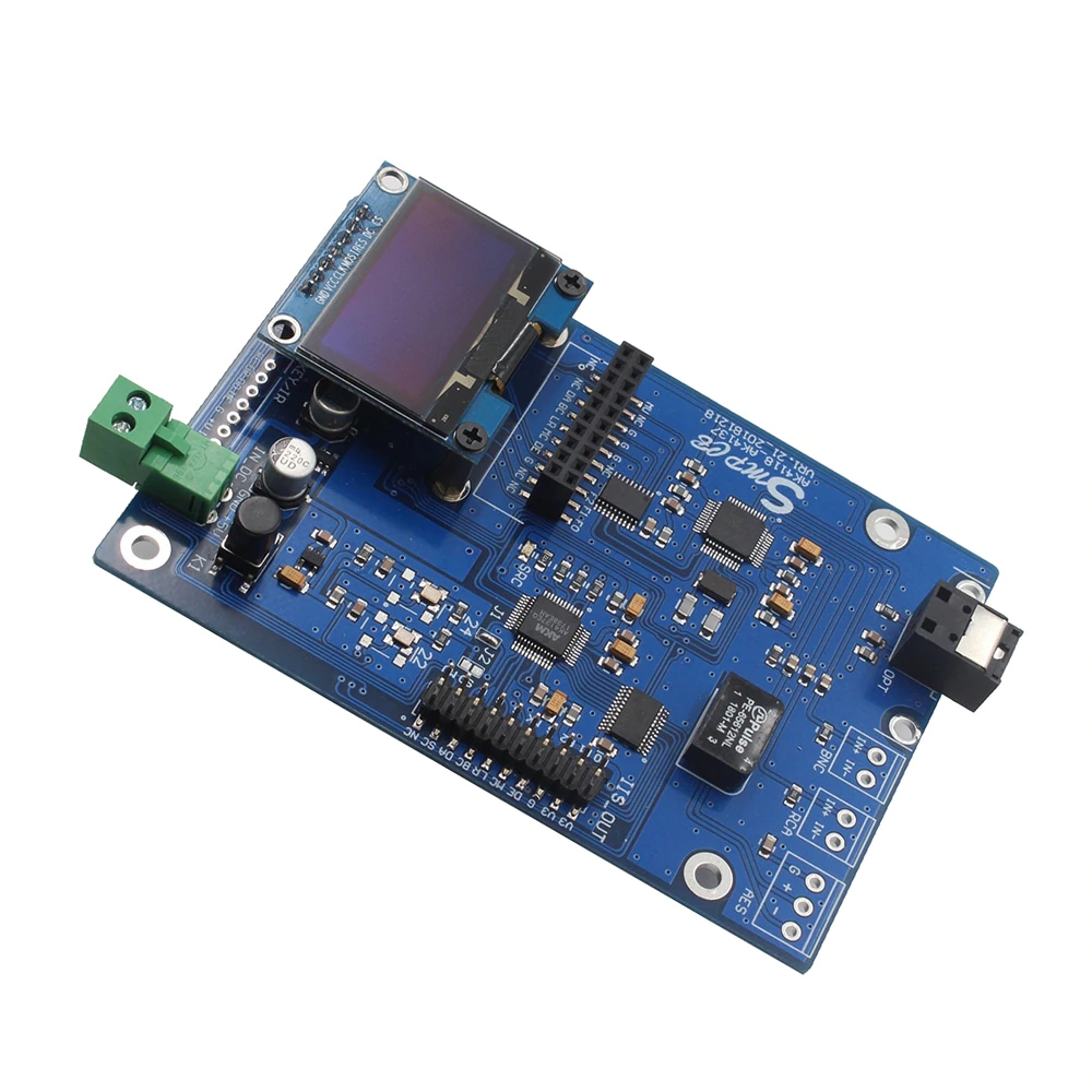

Lusya AK4495S AK4495SEQ I2S DAC Audio decoder board support 32BIT 768K decoder T0241-in Digital-to-Analog Converter from Consumer Electronics on Aliexpress.com | Alibaba Group
I also realized it is not only the chip itself that influence the final sound, but the implementation and mainly the power supply. In my case if I get 3 DACs and each of them probably 2 or 3 different power sources. So, the question is also if I can use each power source for all 3 DACs or should it be each of individual ones for each DAC?

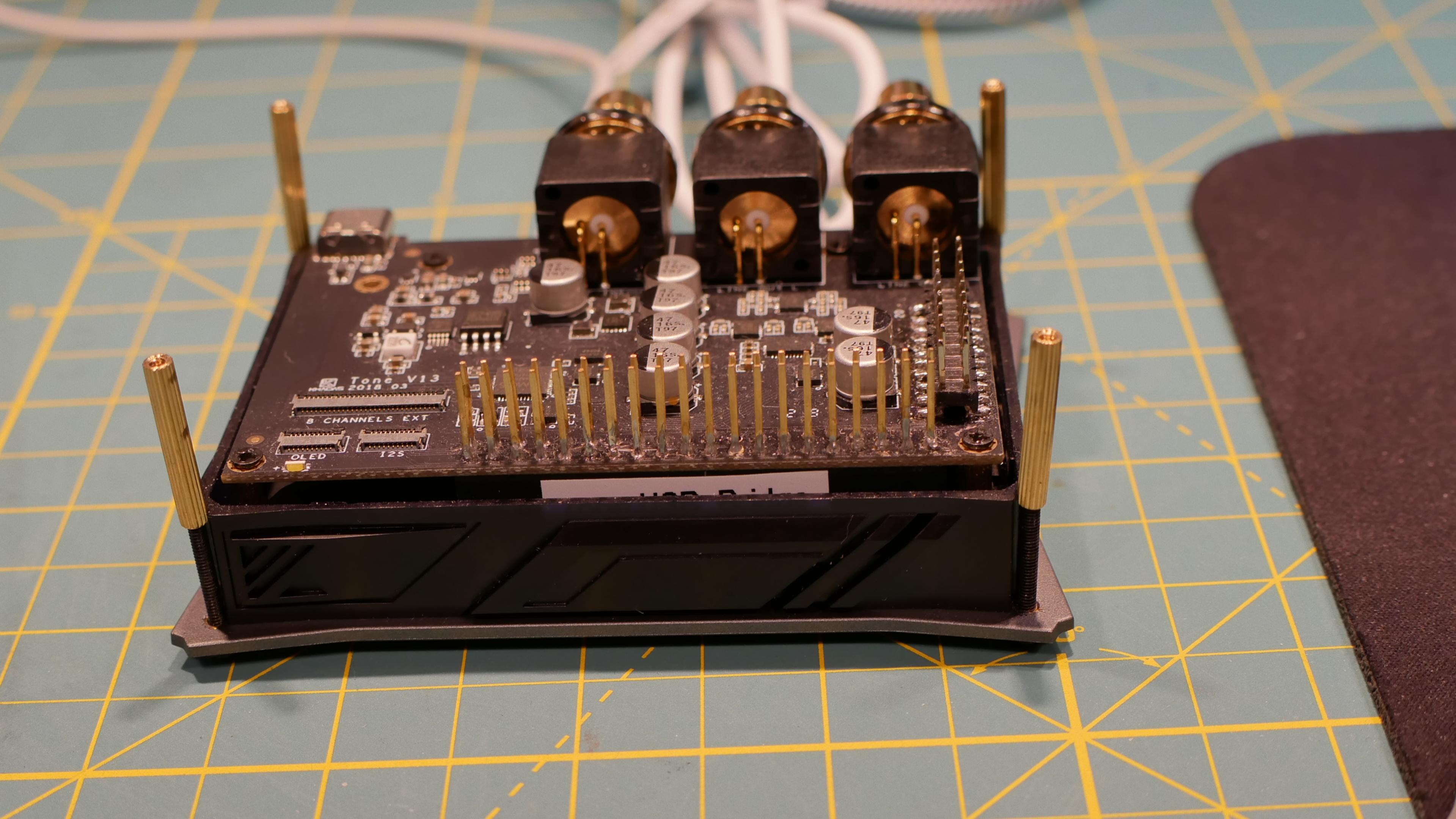

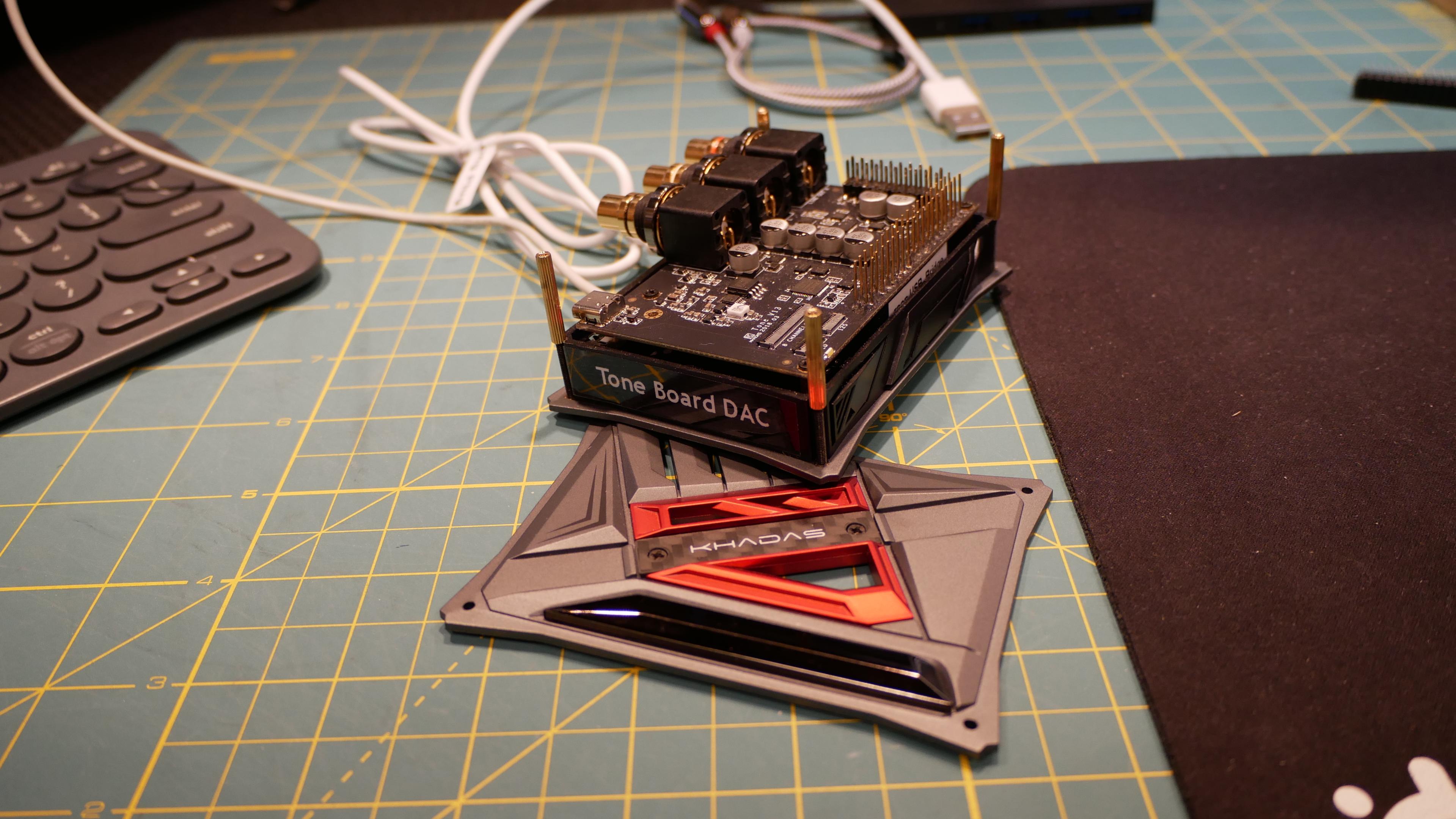

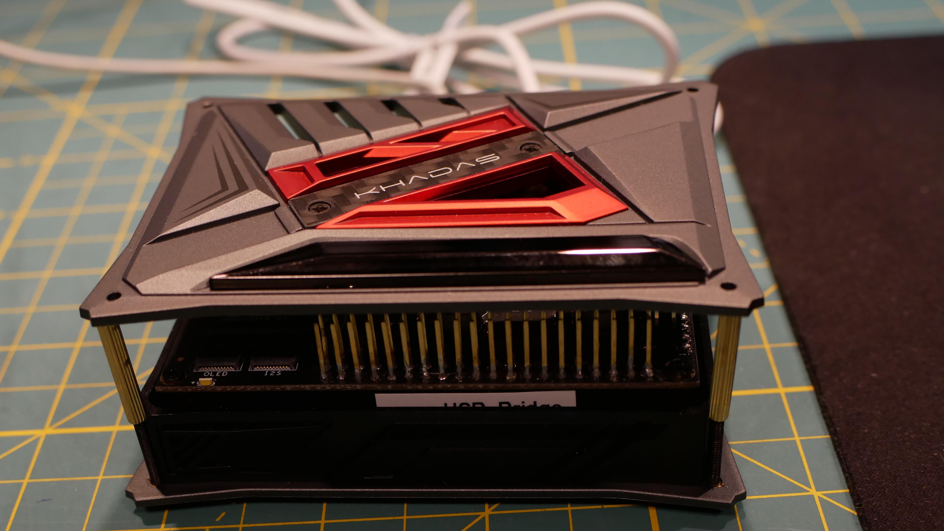

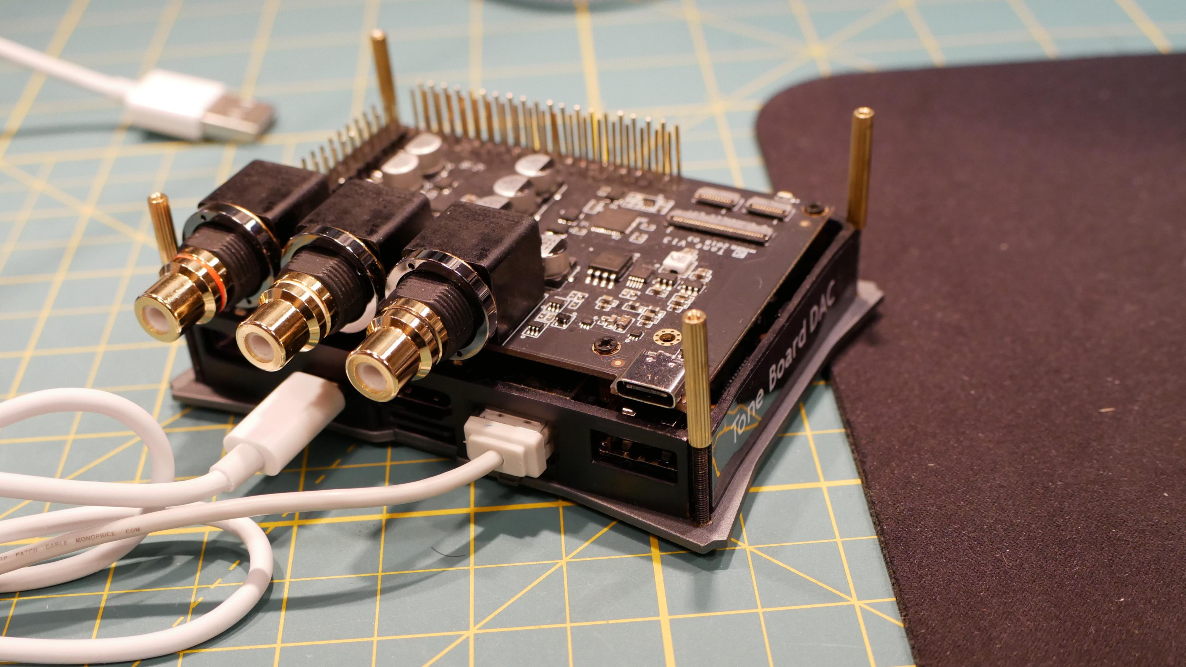

Here are a few pics of my kit, and the Khadas case semi-mod.

The thing about Chinese dac boards like that one is that all the components on the board except the dac chip itself are usually very cheap quality. In many cases power supplies and critical voltage references are not well implemented. Those things can sometimes be improved, but cost, and time and effort add up.
In addition, one big issue with AKM dacs is they require an external master clock to run the dac (MCLK). That clock would have to come from the Sharc board and may be one with rather high jitter. You might want to look at the quality of the clock modules used for MCLK on the Sharc board and how they are buffered for driving multiple I2S ports. Usually two MCLK clock modules are needed, one at around 22.5MHz and the other right around 24.5MHz. If the Sharc board uses NDK SDA series clocks and they have clean power, not the same digital power rail than drives the Sharc chip, then that would probably be a good sign.
Exactly how the dac would sound I could not say, since the only AKM dac I am familiar with is AK4499EQ. It can sound world class, but not cheap to implement well.
However, a solution like the above would probably easiest to work with, which is an important factor for your project. You could get one and try it, no big discount for buying 3 at once.
