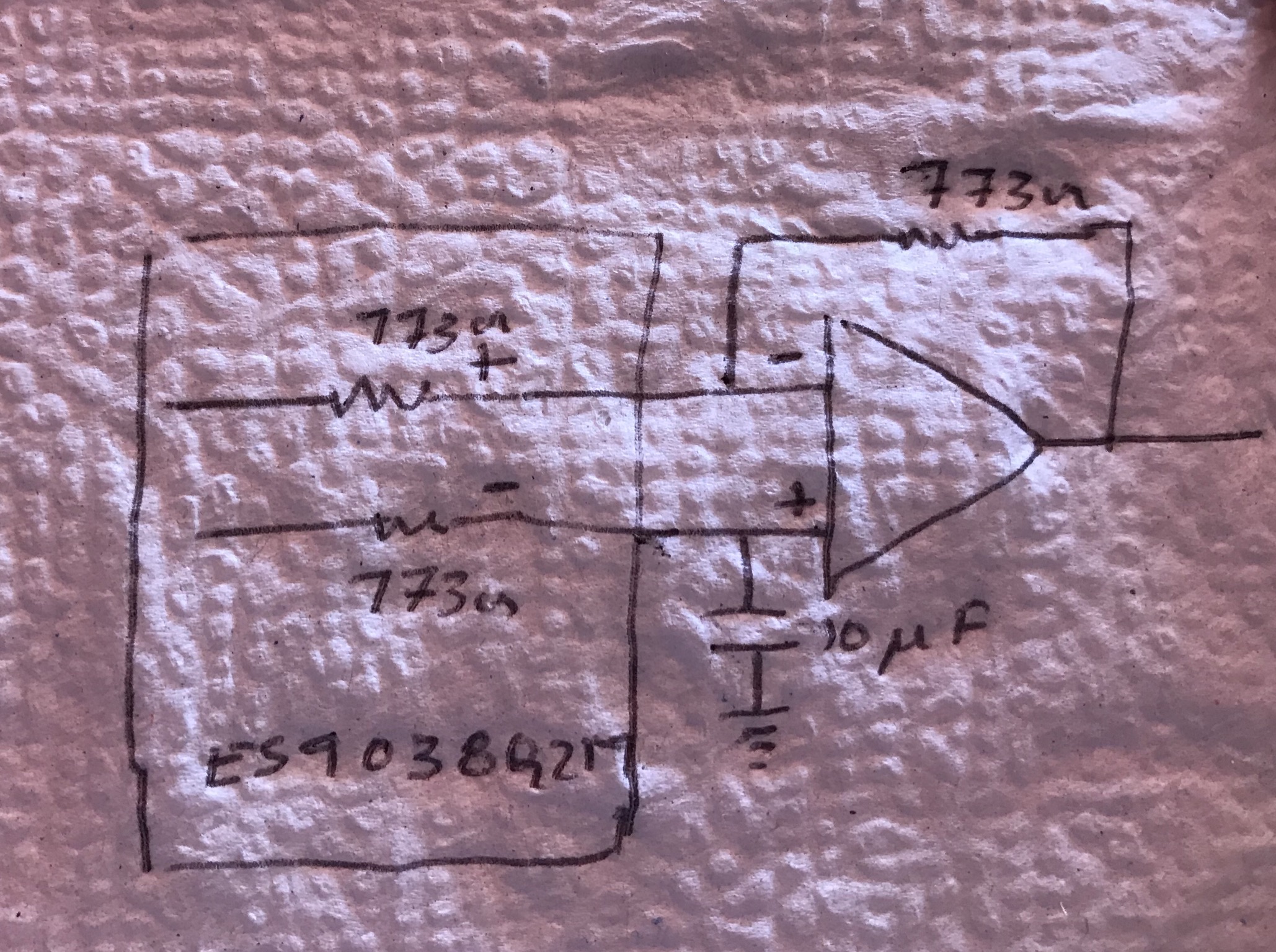

Could someone show me the easiest way to put the Dac in current mode?
I followed the advice of Madds1 post # 355 but the indicated resistance seems irrelevant, I tried all the values between 0 and 3.2M.
I'm a beginner, could you show some images too?
Any suggestions?

That is correct. I did not take a targeted approach for this board. I played with it in voltage mode as it was and then shifted to current mode without reworking the entire circuit using a single opamp by putting one leg on the inverting pin into virtual ground and putting a cap to the ground for the other pin which will makes a low pass so that all AC sees a constant voltage. It is a quick and simple way to get to a non-differential current mode using one opamp
My goal was to see if this chip had potential and it does. But like others have discovered, the board layout and voltage supplies need too much reworking to get a good clean output
Hope this helps
Cheers
Apologies for the napkin drawing. Sitting at a bar in Mexico 😊
Shown in the pic is the easiest way to get a Sabre sac to current mode. Simply set the feedback resistor to be equal to the internal resistance of the DAC. The other pin can be used as a voltage reference and grounded using a LPF
Don't know why it would matter if the feedback resistor were the same as the DAC internal resistance or not. It seems like it should only have the effect of scaling the output voltage to no more than 3.3v peak-to-peak.

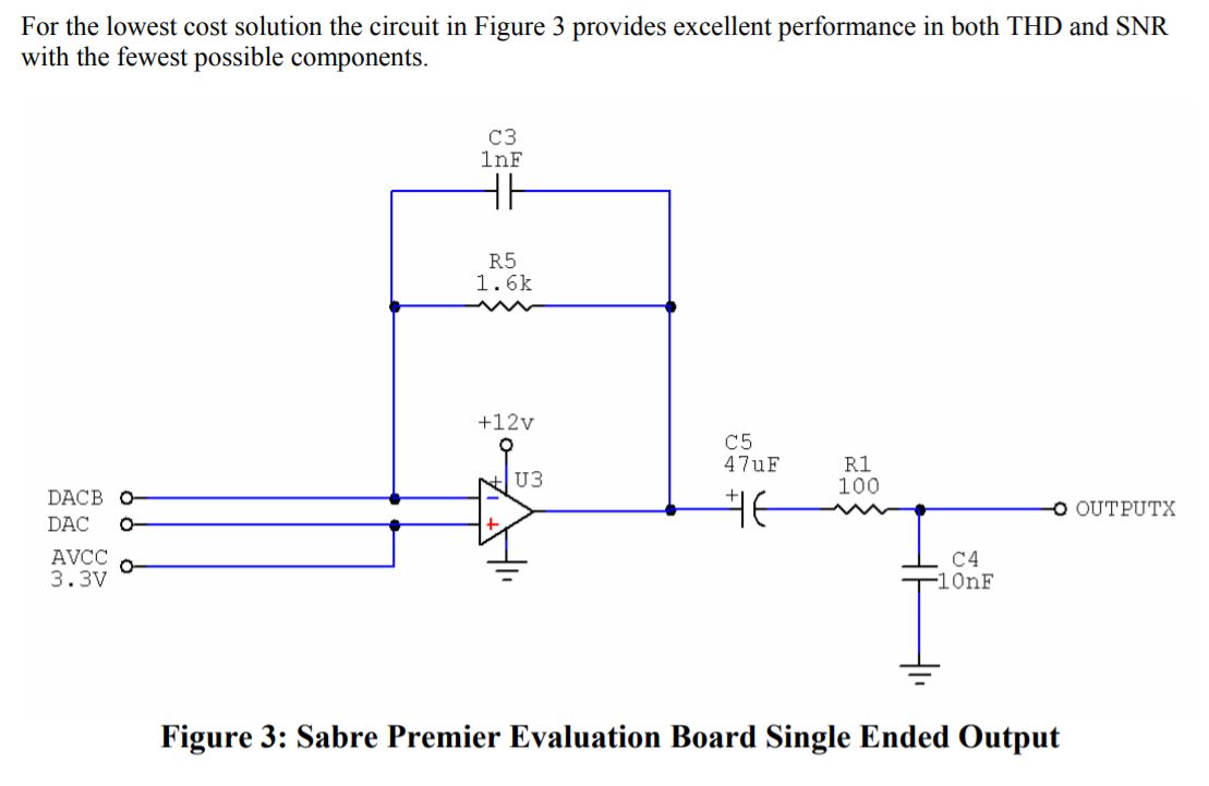

For a very simple circuit, ESS have their own recommendation as shown below.

Yes. Very correct. Feedback resistor value doesn’t matter in either circuit. In one of my earlier post I mentioned was getting a DC offset and that the feedback resistor was the culprit. It is not. I was mistaken. Not sure why I said that 🧐

Madds1, it can't be done like this. As Mark already remarked, the value of the feedback resistor doesn't matter, the inverting node is always virtual ground (plus offset in this case). The non-inverting connection doesn't make sense like that. It certainly will not put the negative output of the DAC in current mode. The only way to do that is to give that output its own dedicated opamp.
The Sabre recommendation is puzzling. To bias the non-inverting input of the opamp to AVCC will turn it into a phase splitter if it is rail-to-rail, at best. Biasing this input to around 1/2 AVCC would make more sense. In that case, only one output of the DAC is being used, but that is not a real problem distortion wise, just reduces PSSR of the reference input on the DAC to zero.
In short, for current mode operation you need at least two opamps. Victor showed an elegant schematic to get single ended output from this without using a third opamp.
I thought that was a typo and meant to be 1/2 AVCC as well. If it is as recommended then, yes, it's pretty counterintuitive.
I agree it looks counterintuitive, but that is probably only because we don't know exactly what is going on inside the DAC, only ESS knows that.
For anyone wanting to implement such a circuit please remember proper power supply bypassing is commonly omitted from schematics, but essential for good performance and stability.
Also, probably wise to choose an appropriate opamp. ESS is quite clear about which opamps they think are most suited for maintaining signal quality the DAC is capable of providing. LME49710 is one good choice if using singles, and LME49720 if using a dual.

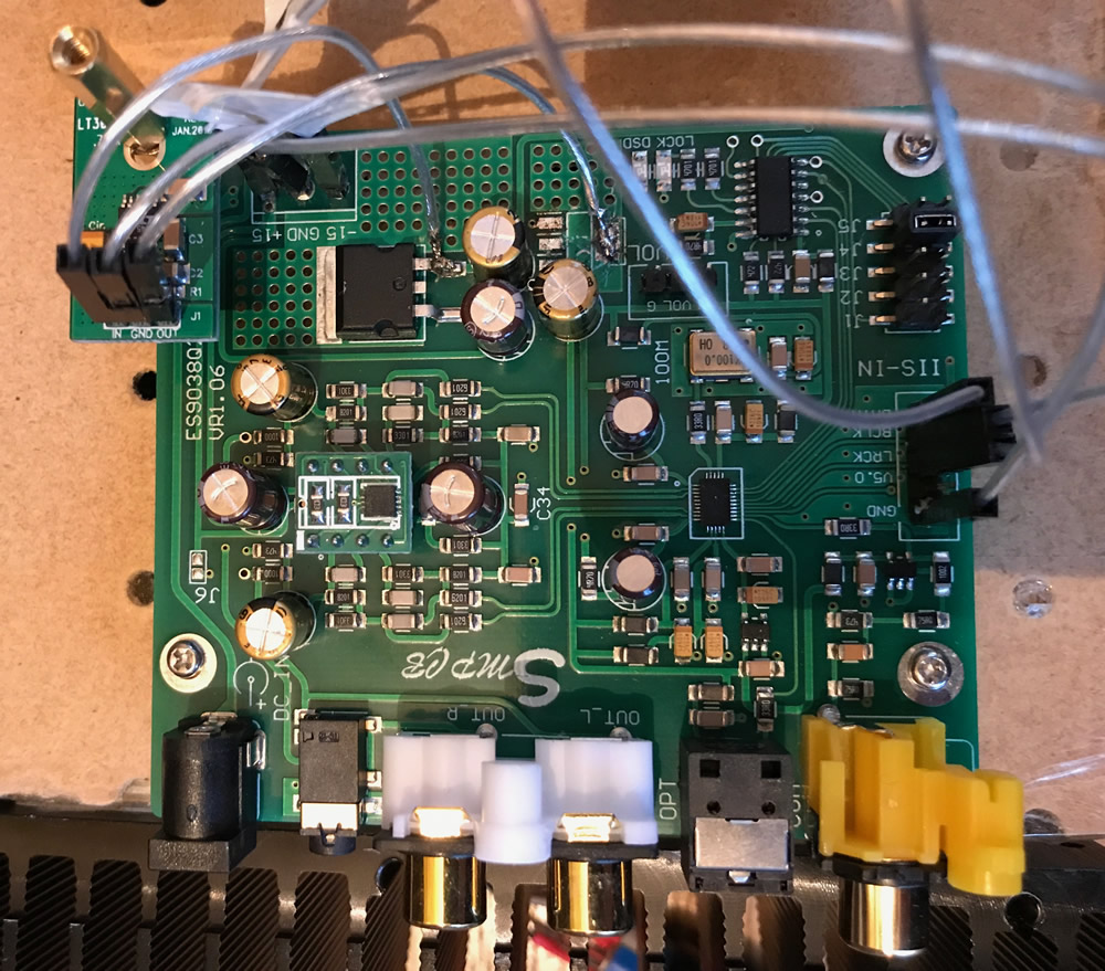

Despite of the fact that to do some mods you sould have some knowledge, I will try to help.
Indeed, AMS1117 have 3 pins - see datasheet. Namely, tab is the same connection as pin 2 (VOut). And at our board VOut trace is connected to tab (not to pin 2). Pinout of AMS1117 is:
1. Ground
2 and Tab - VOut
3. VIn
As I remember, in your small PCB with LT3045 pinout is the same as L7805 (for example, see datasheet too), i.e.
1. VIn
2. Ground
3. VOut
So, you need:
- desolder AMS1117
- place your PCB with LT3045 on original board somewhere near the L7805 (or 7808, it depends on version of original DAC)
- solder pin 1 of that PCB to pin 3 of L7805 in case of ver 1.06 (or L7808 in ver. 1.04)
- solder pin 2 of that PCB somewhere to ground (I think the simplest way is to do it via the existing hole to bottom layer)
- solder pin 3 of that PCB to the trace where tab of AMS1117 has been soldered
That's all. See also my picture in the post #336 for your reference (in that case pin 1 of my patch PCB is VOut, pin 8 is VIn, pins 3,6,7 is ground).
I just replaced ams1117 by lt3045.
Thank you to all who helped about the procedure and the desoldering advices.
I can't make THD and SNR measurements, But to my ears, noise is no more perceptible, the soundstage is way bigger and the music sounds more vivid.

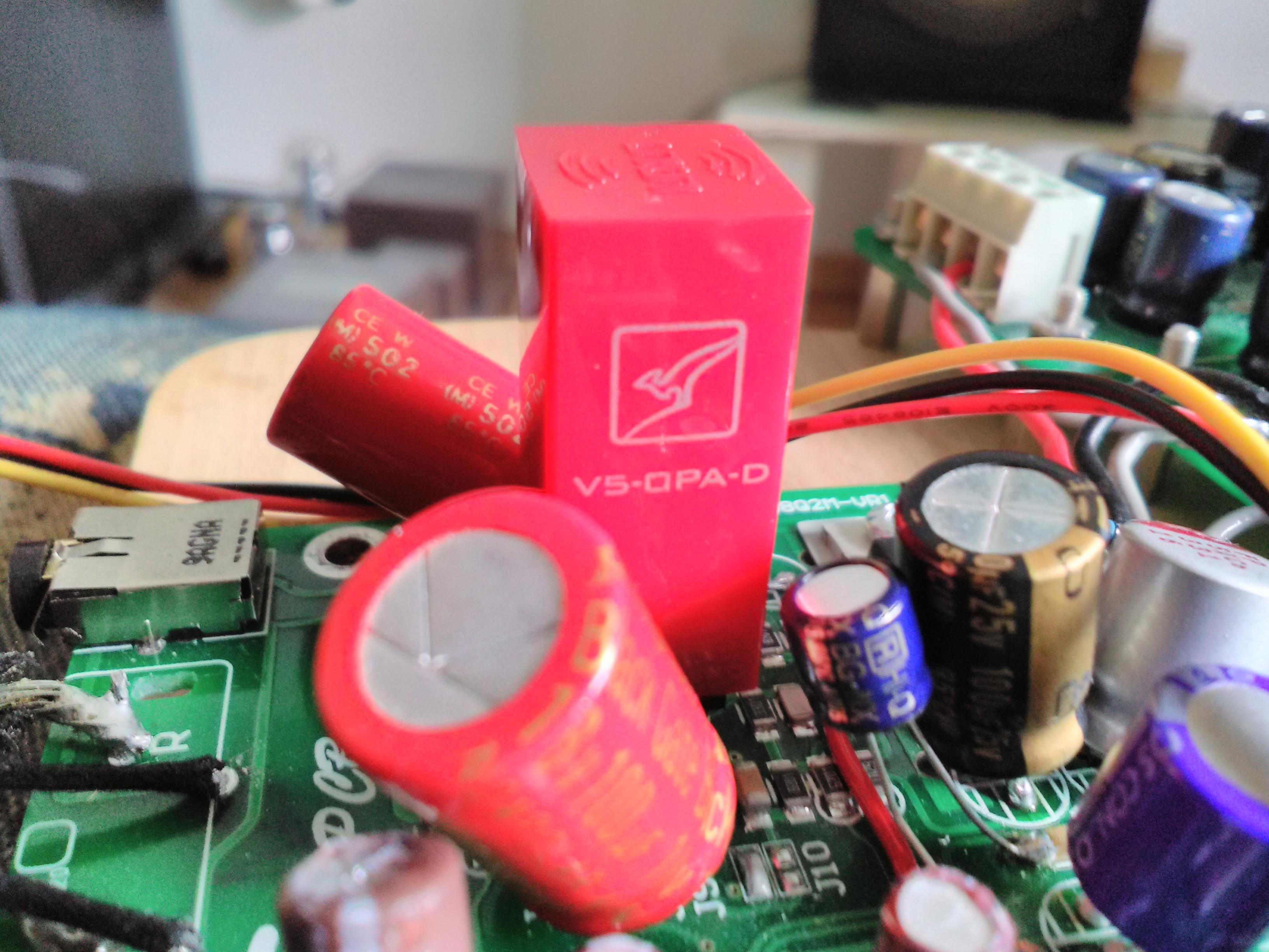

As I reported earlier here, I have separated many of the power supplies of the 1.04 board using Superregs, Salas BiBs and others. So it was high time to serious tests of OPAs! But I fed up soon (boring opa rolling
), so finally I bought this guy. It is huge sized, and the sound of Burson V5 opa is just huge too. The factory recommendation is to install 2x 220 uF Elna Silmic II at the power legs. One of my friend had a great success using Elna-s. I put two old 100 uF/16V BG N caps instead of the onboard Elna RA3-s. Bgs are huge too, and because of the lack of enough space, it is not an easy job to solder them in place, but i managed to do.
