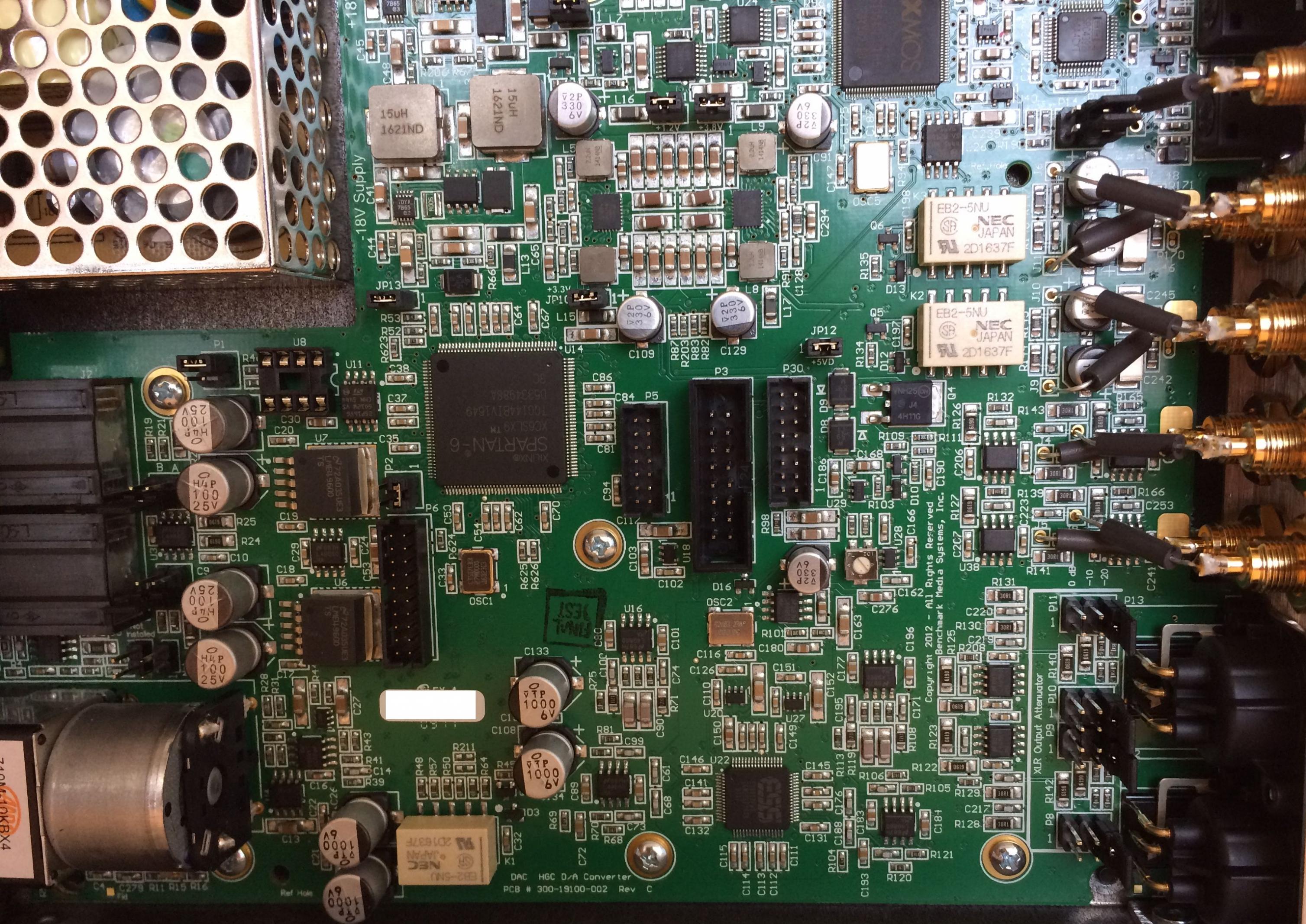

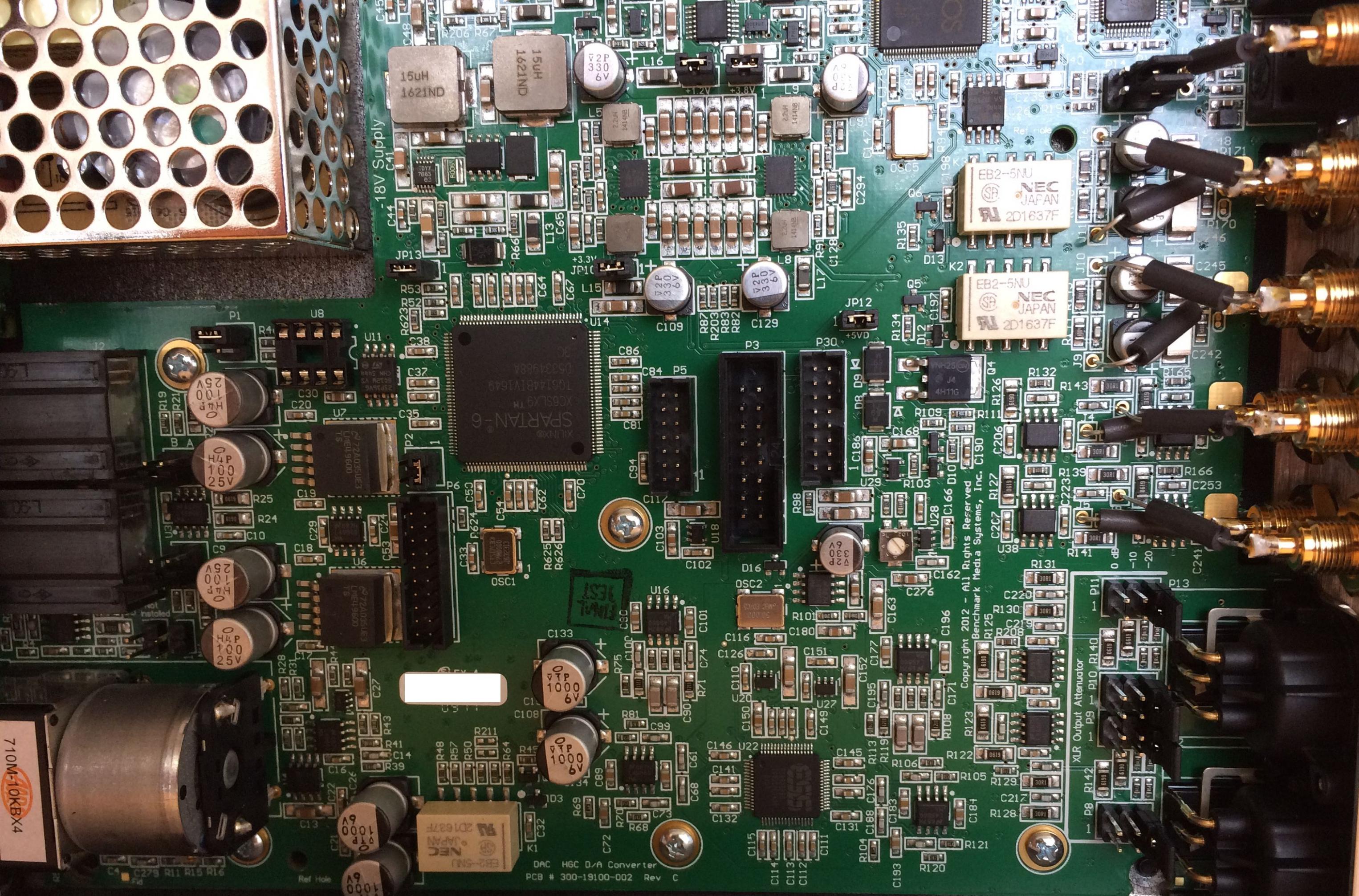

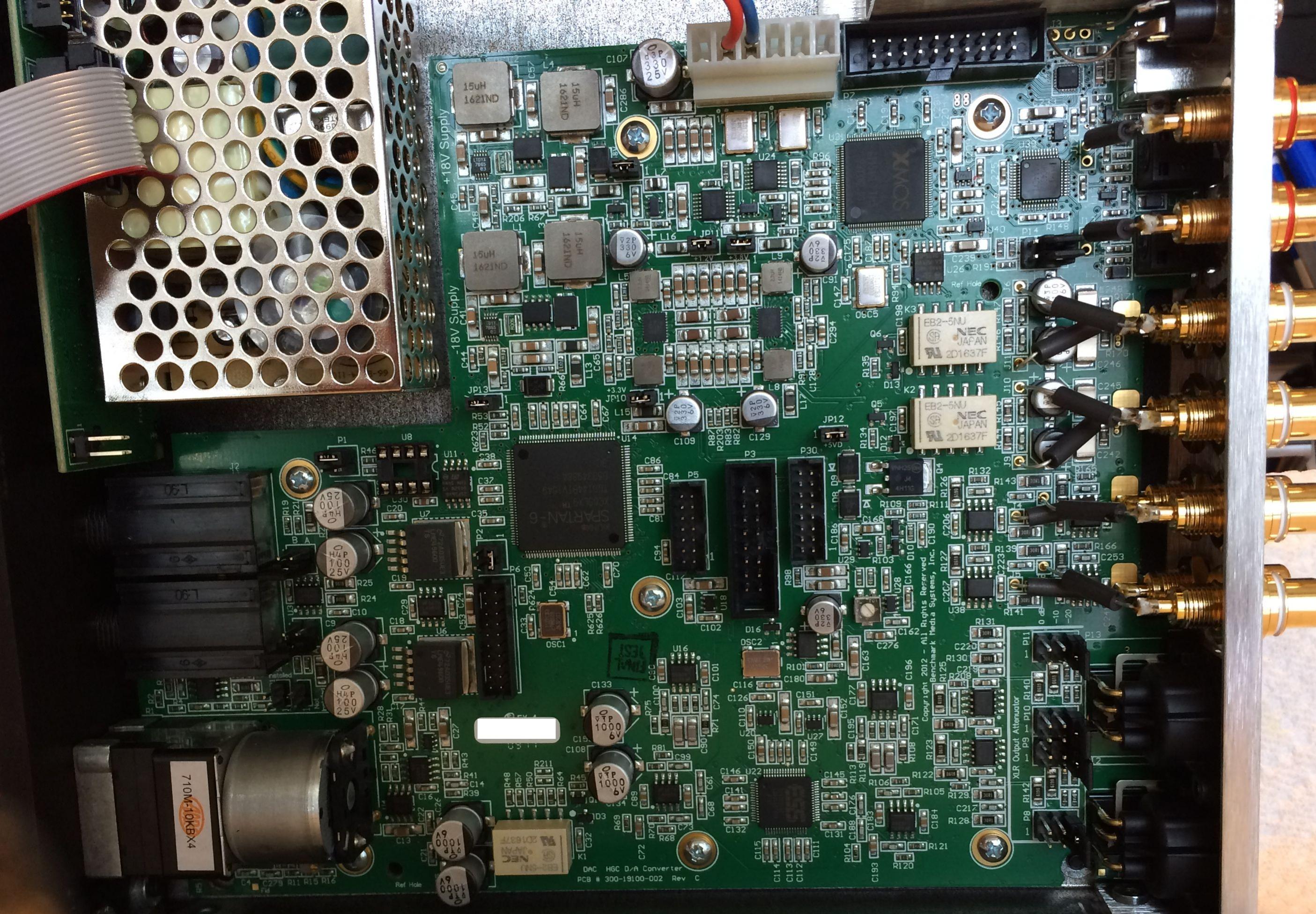

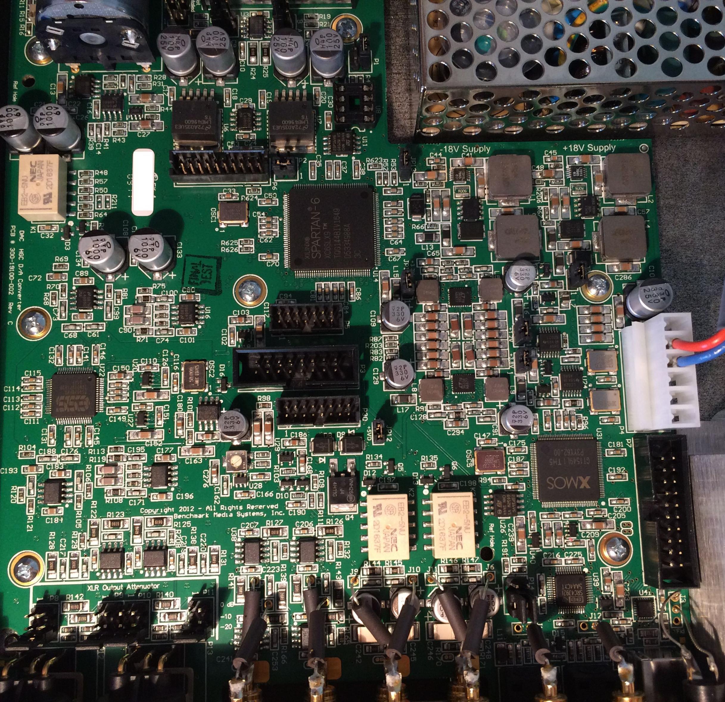

RustySpoons, Just looked at the kit and also the link they have there that shows the finished board. It looks like there are only enough opamps there for modest conditioning of AVCC (maybe only using a voltage regulator for that), and maybe one left and one right channel IV conversion. One of the reasons for using a full ES9038 instead of the Q2M version is that the big chip has 8 output channels that can be combined into 2 groups of 4 channels. Using them all that way gives the best results and lowest noise. Also, the big oscillator can doesn't necessarily mean you get a truly low phase noise oscillator. The one I used is much smaller, and the ones Benchmark uses in DAC-3 are are a bit smaller than what I used.
For reference and to make a sort of overboard comparison I will see if I can post a few pictures of a DAC-3 board below. (Posted more than one because they are not all equally in focus across the board.)
Getting back closer to reality for a kit, it would be very hard to tell what you would be getting without a parts list and a schematic, or alternatively perhaps some measurements and listening test reviews. It seems like kind of a shot in the dark.
Then again, assembling it yourself you might be able to use any extra unused output channels to experiment with other IV circuits while leaving the default circuits included with the kit fully intact.
If you decide to go ahead with it, please keep us informed of how it is coming along and how you like the sound quality. Also, if you are able to sketch out a schematic, it would probably of great interest to folks here in the forum.

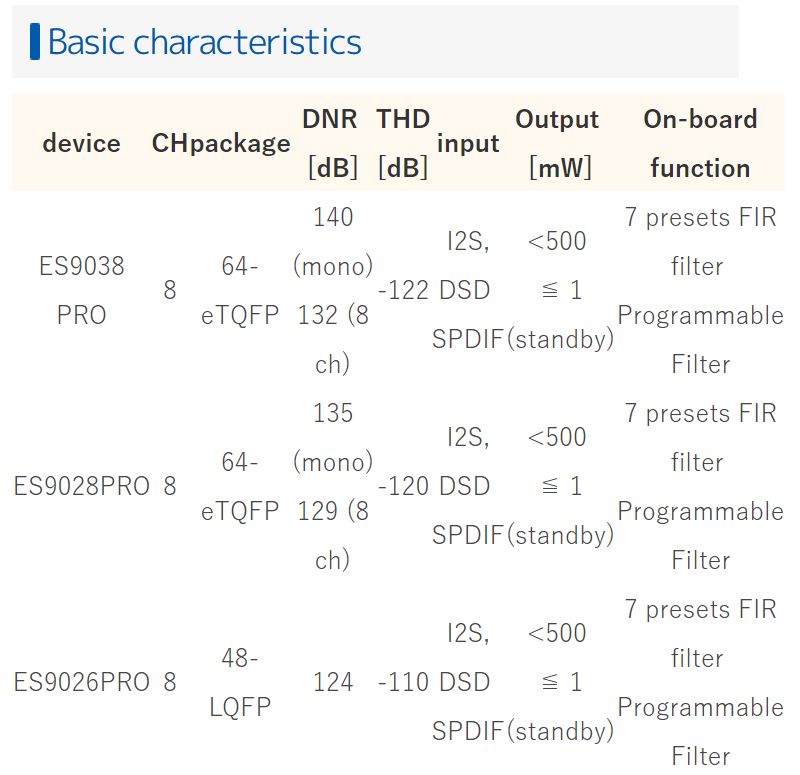

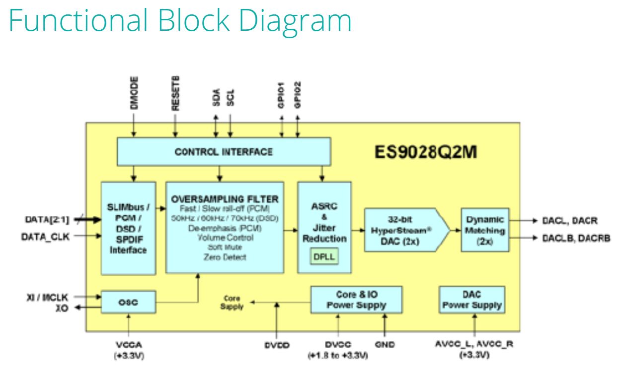

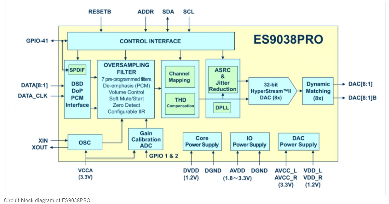

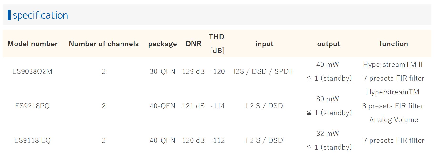

Sometimes people ask what differences there are between an ES9038Q2m and an ES9038PRO. I found some info out on the net an shown in the images below.
