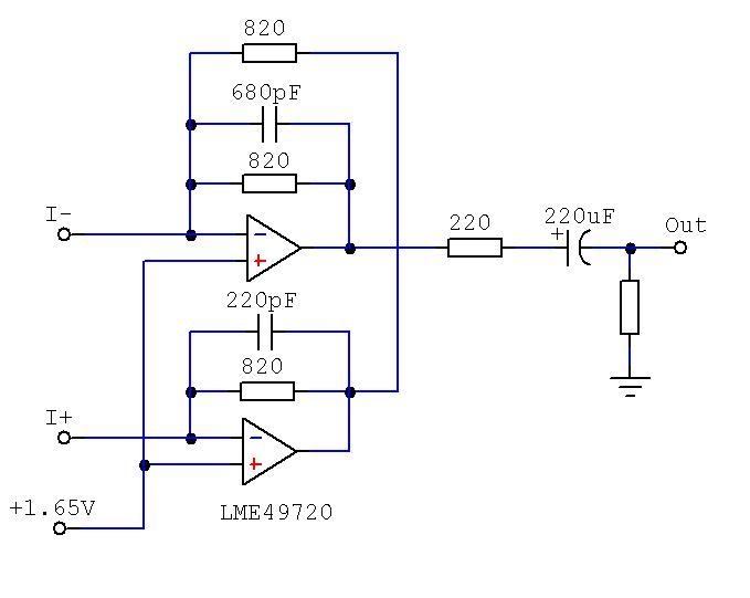

That is correct. I set the LPF at 2hz with a 100uF. 10uF was a typo in my last post and the diagram.
I know this circuit works and puts one leg in current mode just like the Sabre recommendation. The only difference is I am deriving AVCC/2 from the other leg via the LPF
Anyhow - here is napkin drawing that originally posted
http://www.diyaudio.com/forums/digital-line-level/314935-es9038q2m-board-47.html#post5387750
Please poke holes in this approach. As far as I know - this is the easiest way to get the DAC board in unbalanced current mode

Madds,
The problem with Sabre is that they are skimpy with their information. If the chip contains a charge pump to double the voltage, 3.3V would be right in the middle. Basically, it was a wild shot when I mentioned this, it might be ok to follow the Sabre paper on this point, but it deals with a different DAC. Measuring Vout from the DAC is the best way to find out where to bias the opamp. Since all my measurements were done in balanced mode, I didn't bother to measure it when my board was still operation.
Can you please post the schematic along with your questions again, I'll be happy to respond.

Hope this helps. The cap is actually 100uf unlike the 10uf shown

Victor's high-performance solution for SE output isn't much more difficult: Chinese ES9018K2M I2S DAC
Don't have the DS for the 9038q2m to know how much you need to scale the resistors vs the 9018k2m, but it all depends on what output you want as well. Compensation may need a little fiddling, too, if the overall gain is lower.

Not saying it is difficult. Just saying that this is the quick way to get to current mode without doing too much and with a single opmap. Literally short 8 resistors and add a 2 caps
Don't know if Vic solution measures better than Sabre's recommendation but here it is
Cheers
I think Daniel is referring specifically to the circuit shown below. Victor also said he used 3 x 1800uf caps in parallel with a tantalum already there for AVCC conditioning. This was for a Chinese ES9018 DAC board. Resulting harmonic and intermodulation distortion were measured as virtually completely down in the noise at -120dB or so. Only exception was a little 3rd harmonic seen at around -115dB when at FS output. Who knows, maybe a little bit of intersample overs there?

This will work for the chip specified for the development board, better measure output level offset of the 9038 to be sure. That's what I would do.
As a beside, it is not a good idea to only use one channel of the DAC for output, unless your reference voltage is rock solid. On the standard board it isn't. There is a reason why these chips have balanced output: so that reference voltage fluctuations are translated into common mode swings. If you want single output, better use victors schematic.
