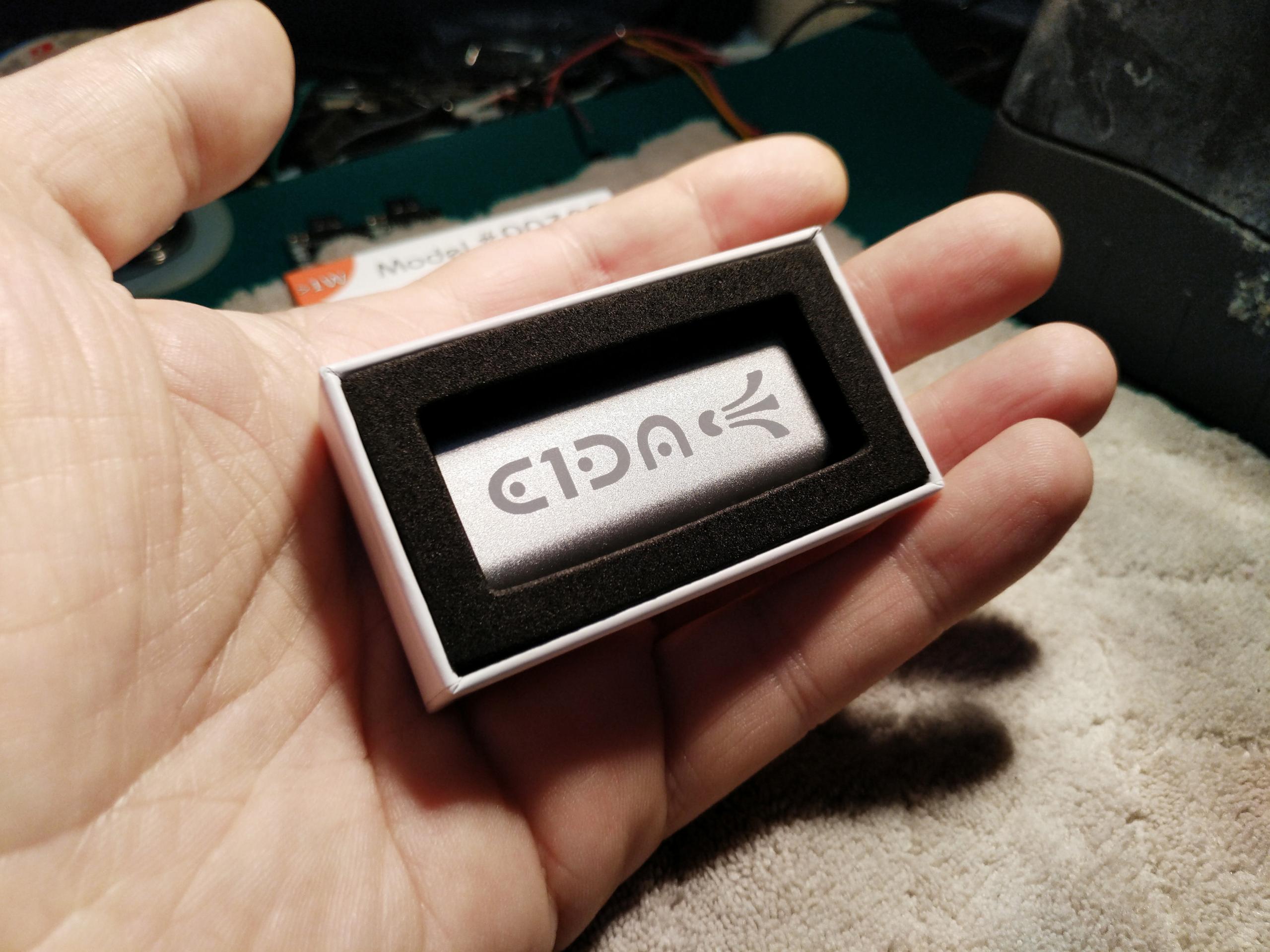

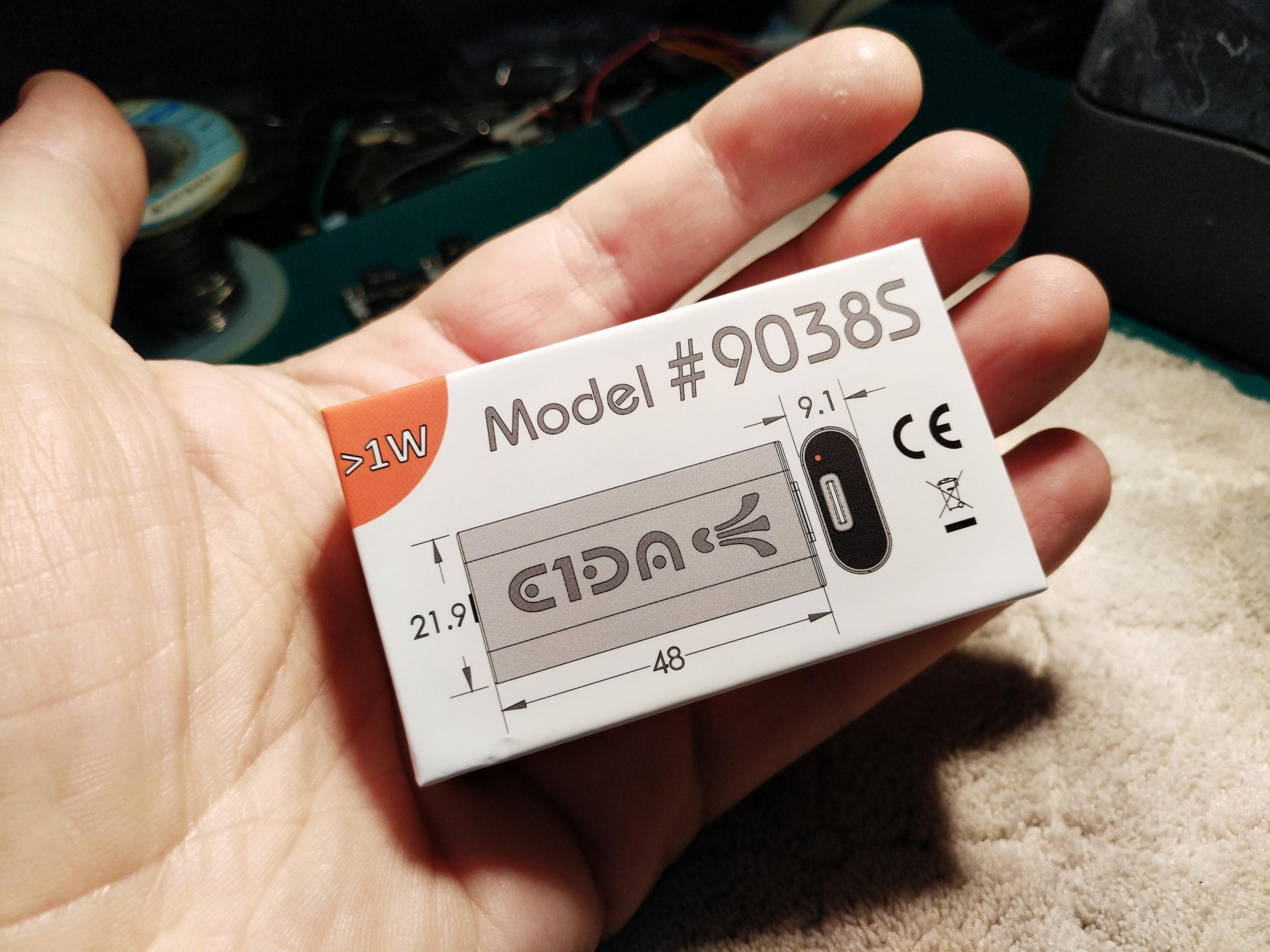

Oh, my package looks like simple matchbox but my own design, as everything else ))

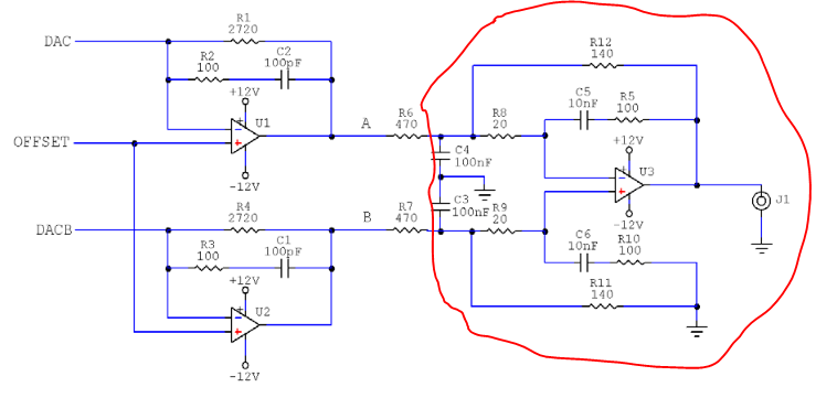

Now, I have to sort out a few things related to the possible setup with the DAC 8. I have a few SET amps for MF and HF horn drivers which obviously have unbalanced RCA inputs, while the DAC 8 has only balanced XLR outputs. Okto recommends using transformers which aren’t cheap, so I’d like to look at other possible options.
ESS Sabre on their website gives schematics for high performance balanced and unbalanced IV circuits. In both diagrams the first part of the diagram is basically the same, so I was wondering if adding on the second part to convert to unbalanced is a good idea (red marked on the attached picture)? I may use a separate box for it with a separate linear regulated power supply unit. Again, Sabre’s recommendation is AD797 Opamp, but what would be on opinion here?
As mentioned, I will need to use 2 unbalance-input amps = 4 channels = 2 Opamps. Can I combine all of them in one box and supply with common power supply or will it be much preferred to split them in two units with separate supply?

The AD797 performs extremely well. I'm using them in some test circuits because they have the lowest distortion (measured with direct FFT using an APx 555) of all monolithic amplifiers that I can find. Their single gain stage design also means that the little distortion that they have is low order. For example, the LM4562 is very clean, but when it warms up, it shows increased 3rd and 4th harmonic, and you can start to see 5th. Cool the chip down and this goes away. It's also no longer available in a single.
The OPA828 is also a potentially nice single op amp, but I have not tested it yet. Oddly, it's even more expensive than the 797 in production quantities, so unless you need a FET, possibly for bias current reasons, the 797 may be a better value.

Hi Anton,
You seem to have the right basic idea. R6 and R7 form part of the input filter time constant so you need to know what those are. Or perhaps you could buffer the octodac output first with two more opamps, but that gets to be a lot of opamps in the signal path.
AD797 that Monte suggests is very nice opamp, but one no longer used by ESS for output stages. AKM and ESS both now use OPA1612. The reason on the ESS side, at least, is because of the 'ESS hump' issue. Seemingly, it turns out nobody found a way to reliably solve it if using AD797 for the output stage (although AD797 still makes for a really good AVCC buffer).
Some discussion on the ESS hump and opamp selection can be found at ASR: ESS THD ‘Hump’ Investigation | Page 14 | Audio Science Review (ASR) Forum
Also, its possible if the DC offset from the I/V converter stage is already removed at octodac outputs, then AD797 might be okay for differential summing/filtering use, not sure. If the offset is removed, it might be helpful to know of it was done as described at ASR or if DC blocking caps are used, and also if there are equivalent output resistances more or less the same at R6 and R7 in the schematic you posted .
