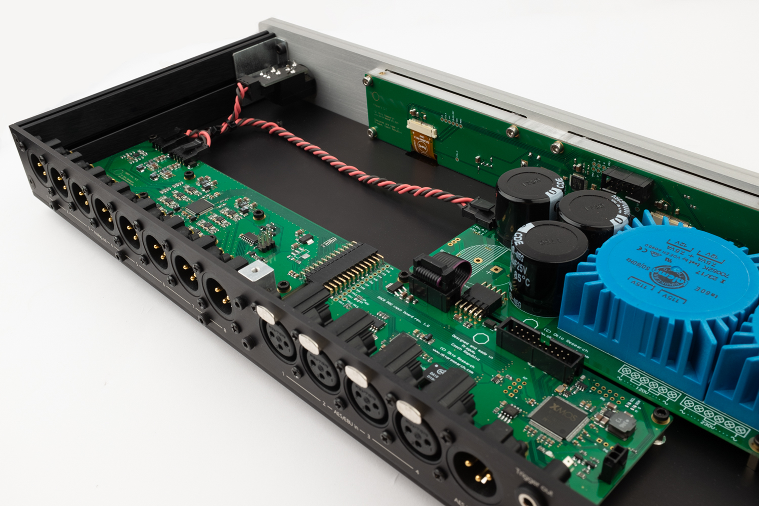

Thanks Mark,Hi Anton,
You seem to have the right basic idea. R6 and R7 form part of the input filter time constant so you need to know what those are. Or perhaps you could buffer the octodac output first with two more opamps, but that gets to be a lot of opamps in the signal path.
AD797 that Monte suggests is very nice opamp, but one no longer used by ESS for output stages. AKM and ESS both now use OPA1612. The reason on the ESS side, at least, is because of the 'ESS hump' issue. Seemingly, it turns out nobody found a way to reliably solve it if using AD797 for the output stage (although AD797 still makes for a really good AVCC buffer).
Some discussion on the ESS hump and opamp selection can be found at ASR: ESS THD ‘Hump’ Investigation | Page 14 | Audio Science Review (ASR) Forum
Also, its possible if the DC offset from the I/V converter stage is already removed at octodac outputs, then AD797 might be okay for differential summing/filtering use, not sure. If the offset is removed, it might be helpful to know of it was done as described at ASR or if DC blocking caps are used, and also if there are equivalent output resistances more or less the same at R6 and R7 in the schematic you posted .
In addition, I personally would be concerned if octodac had no MCU at all. It could be controlled over I2C by the XMOS chip or some other part that might not be recognized as performing what would normally be the MCU function.
Then I believe the right way would be to receive the DAC8 and then check for what kind of resistors are used there. I have also asked Okto the same question as here and currently awaiting for reply.
Regarding the new updated boards, I guess they may use the XMOS chip to control the sabre chip. Here is what Pavel replied me regarding this:
The DAC8 PRO has a next-gen board, without an on-board MCU (so no Sabre chip settings) and is not designed to be DIY friendly.
Modifying the DAC8 PRO would be possible I guess if the I2S lines from the input board were disconnected and tapped into. We could provide support, but it might require some debugging on your side in the process and there is a risk of running into problem that cannot be solved remotely.
So we agreed that modifying the DAC8 and integrating the MINIsharc is not a very good idea. Instead I was advised to use a PC based software crossover with e.g. Jriver and Audiolense and I am quite interested in this solution to be honest. Still, I will have to find the way how to convert the balanced signal to unbalanced.
Yes, this is obsolete, the new board is different as I mentioned above. There are some pictures of the new board Vs old:Okto Dac8 module manual: https://www.oktoresearch.com/downloa...ule_manual.pdf
Page 5 shows the I2S input connector. That's what I would want to interface to Sharc.
Review and Measurements of Okto DAC8 8Ch DAC & Amp | Page 33 | Audio Science Review (ASR) Forum
There are some pictures of the new board Vs old...
Okay, I see the new picture. Makes it look easy to get into the dac chip via I2S (or possibly SPDIF, since I can't read the connector labels) since all the I2S (and or SPDIF) lines go through a connector down to the XMOS and AES intput board. Just a matter of tracing out the correct lines and tapping into them. Also, I would see if the I2C lines go through that same connector. If so, great. If they did something stupid like grounding the dac chip I2C pins right at the chip, then not as good. In any case you would need an ES9038PRO data sheet to work from, if thinking of doing any customization.
