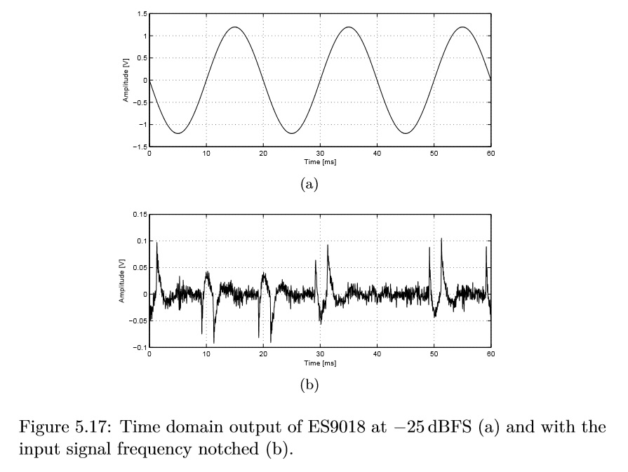

Mark, Terry have you ever seen this type of plot? I read about the "ESS hump" etc. and no measurements show much, but this is clearly some pathological behavior in the DAC. I don't know if this was ever published and it was sent to me in confidence, but the folks that did this are very competent and I trust their results. If this is old news (and it might be) no harm done, I don't follow the DAC stuff much.
Anything you might be willing to say about that?
Yes, that plot was probably done with a single ended output. So let's postulate that those zero crossing glitches have an anti-symmetry with the desired signal so a perfect differential output cancels the "badness". It is possible that all this tweaking is doing is trying to achieve this perfect cancellation. You will notice the artifacts are rich in harmonics. If that is the case the comments related to getting excellent match in all the components of the circuit are right on. IMO worth exploring.
EDIT - That old conversation on ASR is about the ESS9018 so the graph I posted applies.
