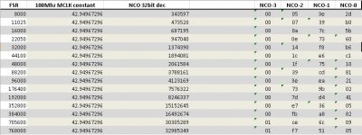

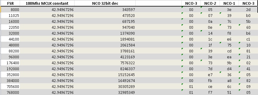

hi, there,

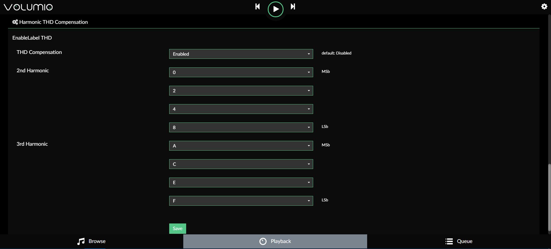

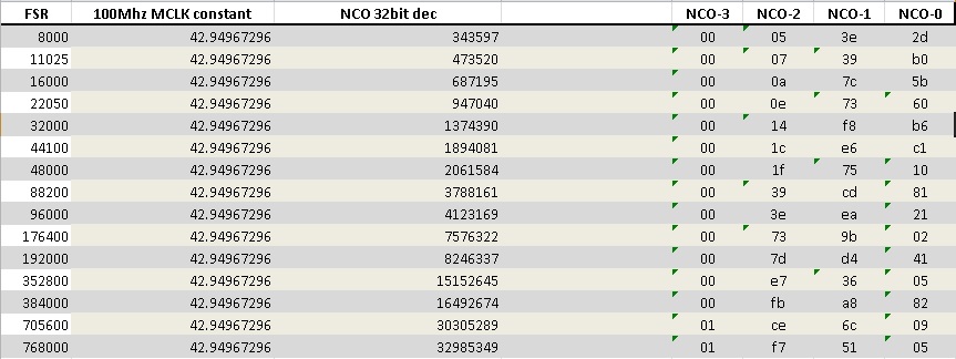

i'm on volumio 2.599 and es9038q2m hifibunny drivers, 1.07 board, rpi3b.
we have to get the right nco for 100mHz crystal 1.07 board.
GitHub - eslei322/ES9038Q2M-Linux_Driver
the thd compensation would be acceptable now.
cheers

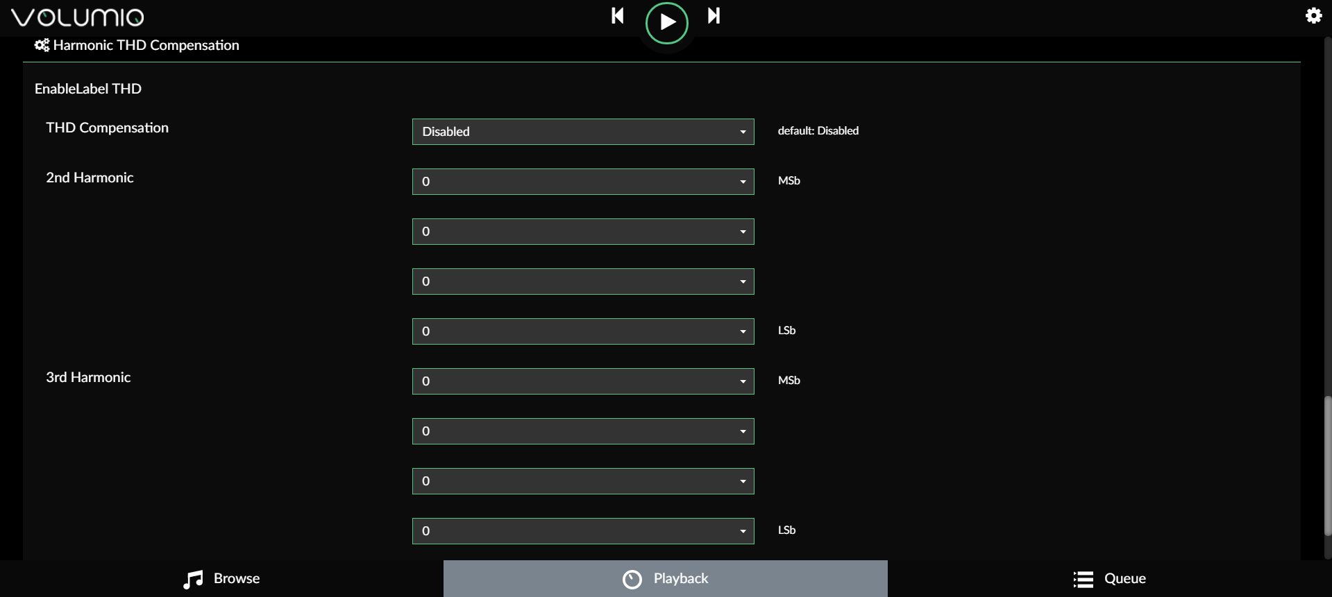

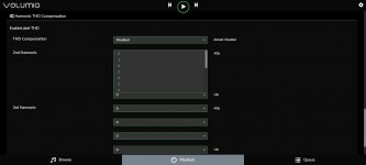

Hi eslei,
Nice work!

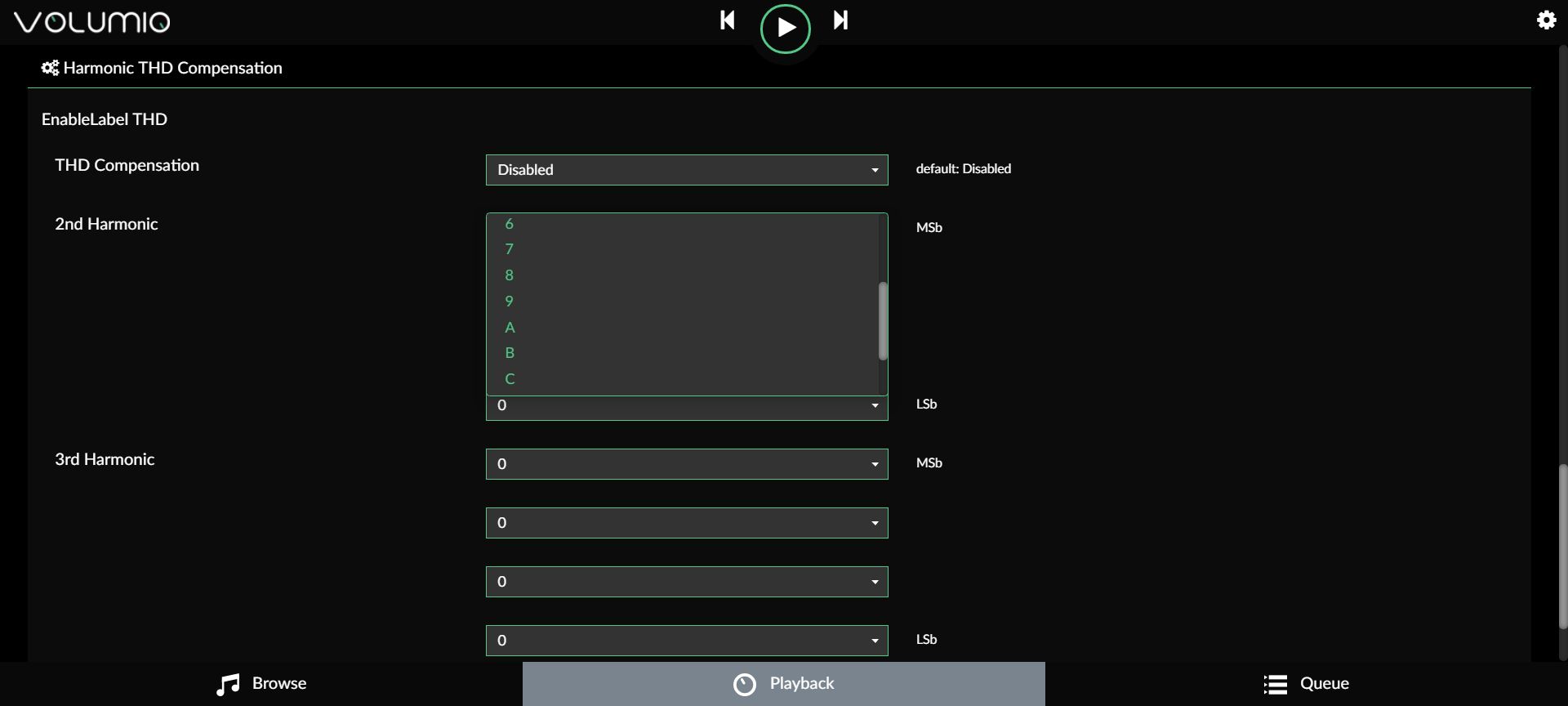

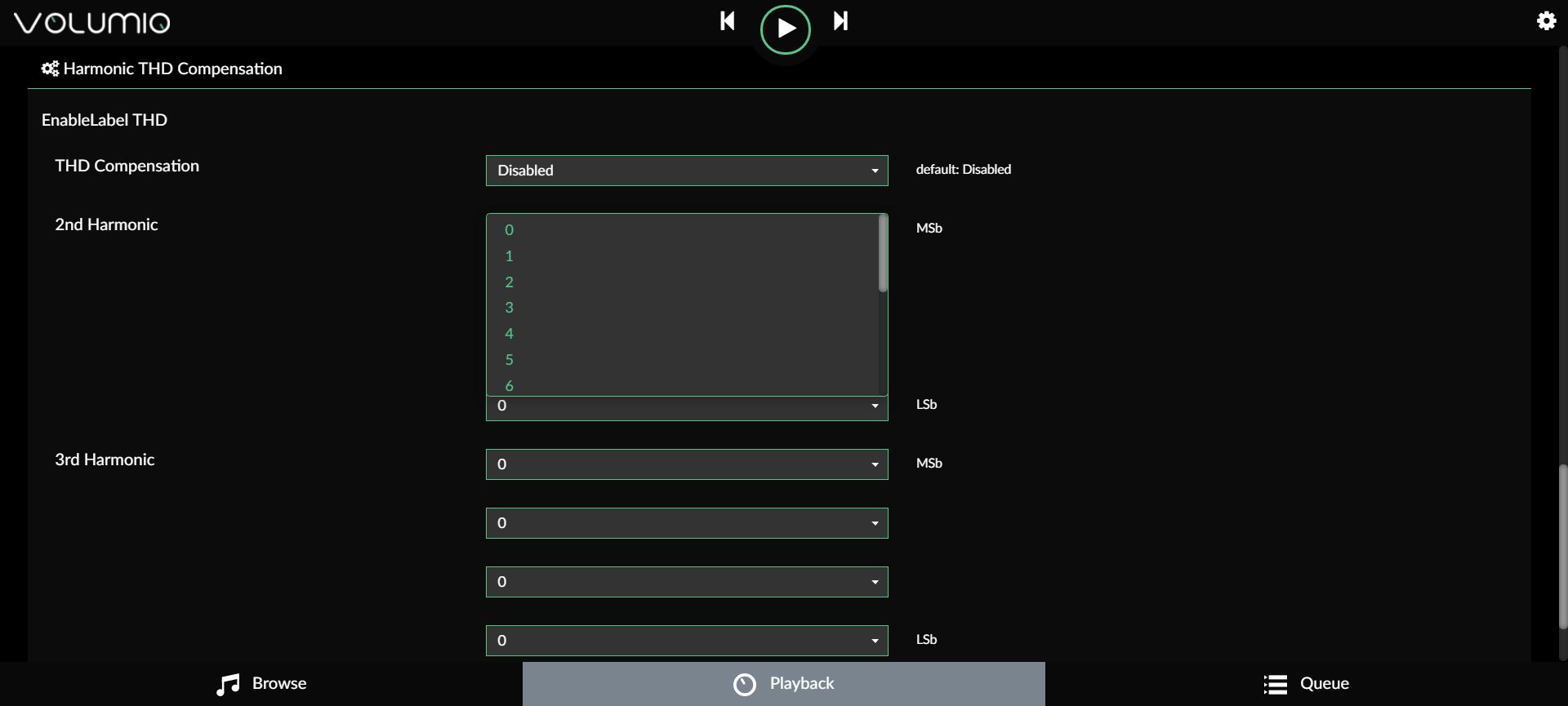

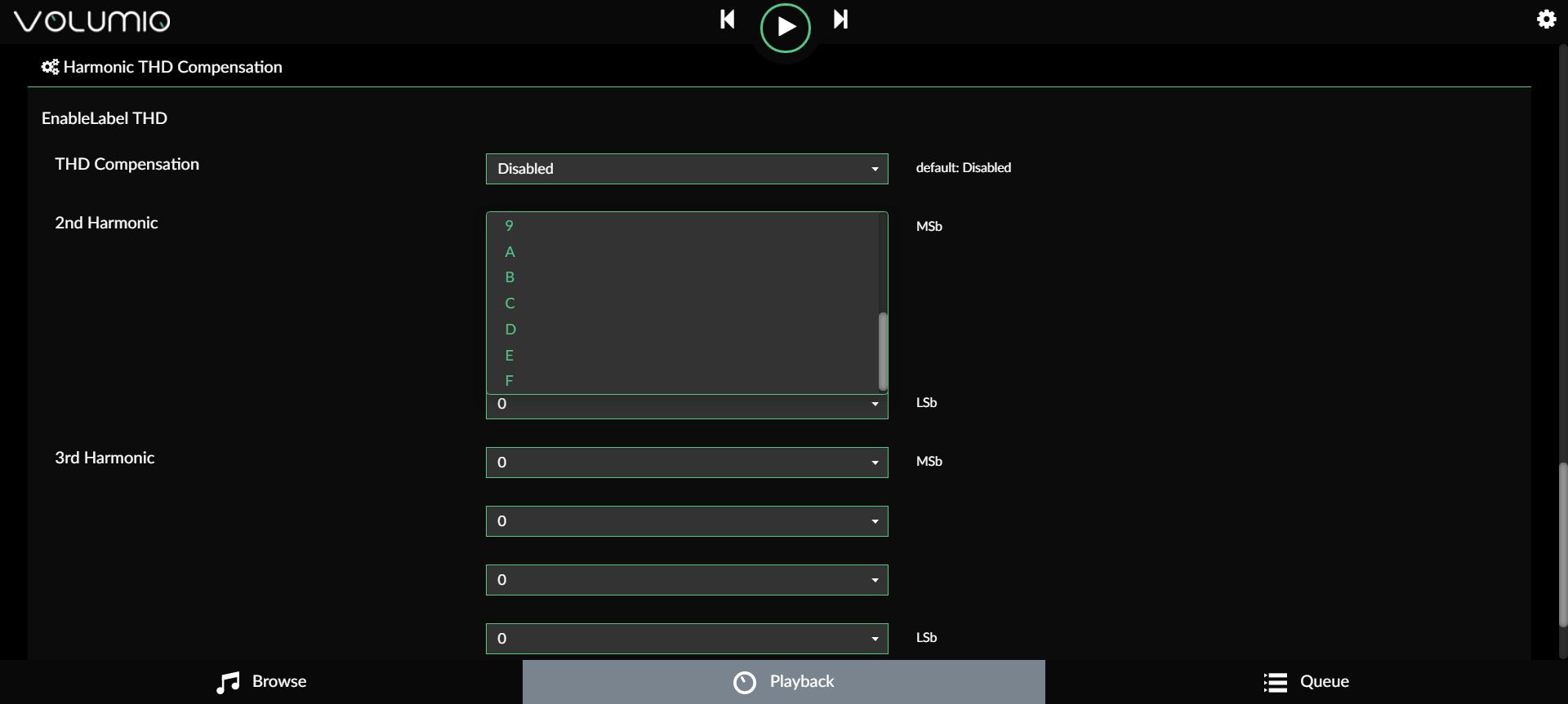

May I ask if the thd compensation settings you added can accept either hex or decimal number formats, or only one or the other?
cheers[/QUOTE

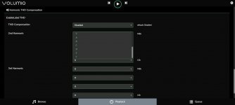

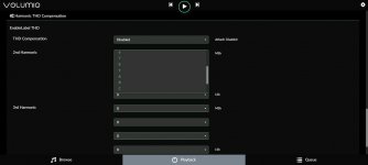

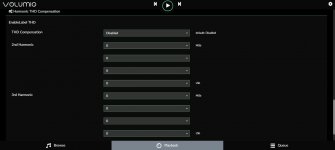

hi there,
it's on hex, each harmonic has 4 bits, each bit has a drop-down menu from "0" to "f", so we have a choice of "0x0000 = 0" to "0xffff = 65535".
cheers
