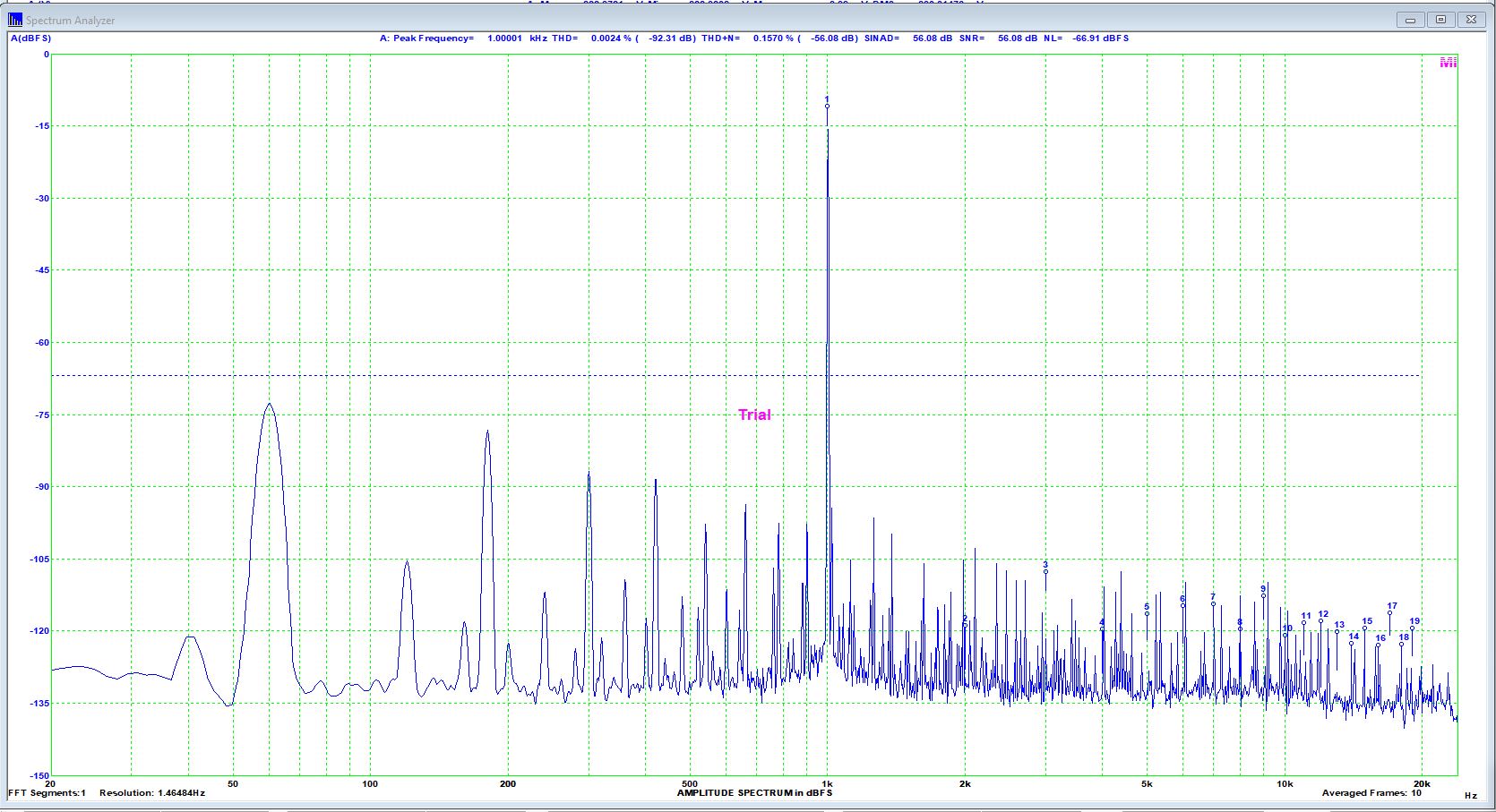

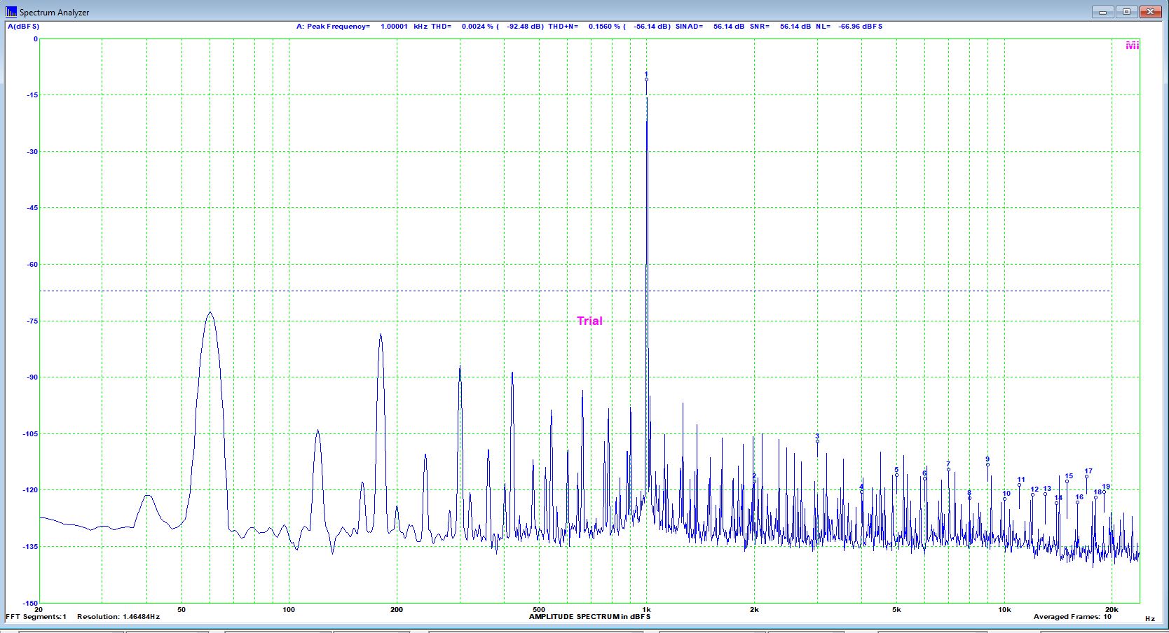

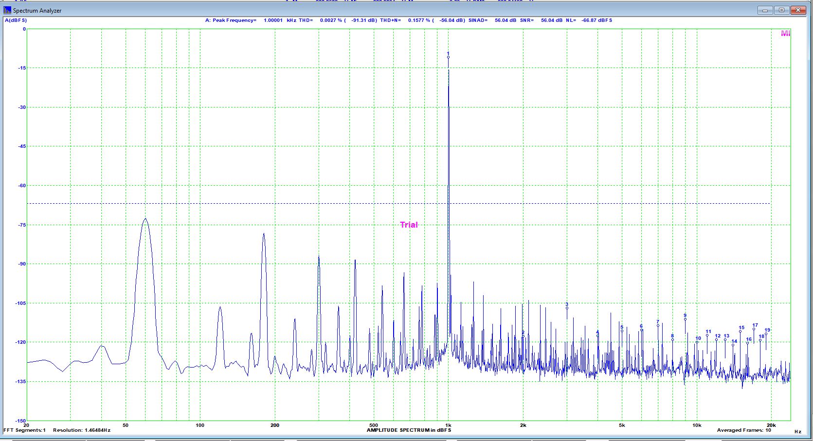

In the meantime, I got curious and did some measurements with that ES9038Q2M board from Breeze Audio. I tested the board with several opamp chips using the same setup. I include just three results here for illustration: JRC5532 (the original chip sent with the board), PBA2604 (from Academy Audio), and a dual AD797 (set on an adapter board).
All three results show the THD+N below -90dBFS, which is quite far from -120dBFS, but much better than -70dBFS. The graphs demonstrate substantial power supply induced noise that dominates the results. It's amazing how much noise can a regular full wave rectifier create!
It appears, however, that the THD+N tests do not tell much about the difference in audible sound quality. The JRC5532 actually measures a bit better than the PBA2604, but sounds the worst of three. I would love to hear your opinion on the PBA sound, if you find some time to try it.
With a 3-opamp output stage and everything else done properly, ES9038Q2M can reach a -120dBFS distortion level. With a one opamp output stage like you have now it has to operate in voltage mode which increases distortion to closer to -70dBFS. That's a huge difference, of course.

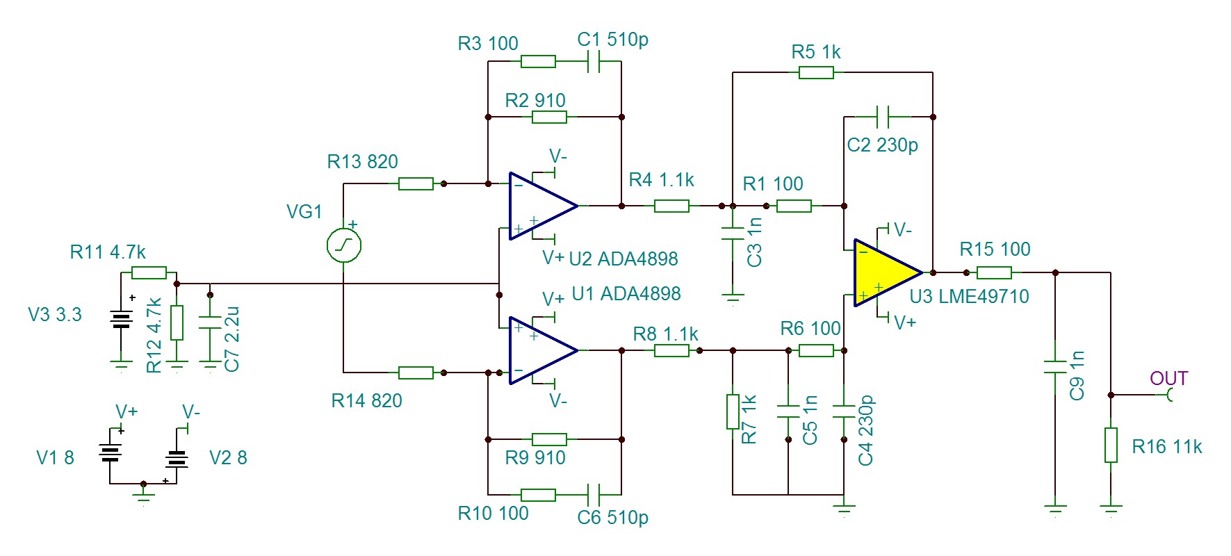

Someone posted a similar 3-opamp output stage schematic from a Topping board that might actually be little bit better. Copy attached below.
I would still suggest that OPA1612 is the best opamp for the job. If it doesn't sound best it usually means there are other problems with the dac or power supplies that still need fixing. I would suggest to mount the output stage as shown in the instructions at: Dropbox - Output Stage Instructions.zip - Simplify your life
... loosely twisting the dac outputs for each channel together and running them along the ground plane down to the output stage is pretty effective for removing residual RF coming from the dac chip (a few pf of incidental capacitance to ground can be helpful, but not too much capacitance there or it sounds and measures worse). Helps keep opamp distortion lower that way and helps prevent heating of opamps from RF, IME.
In addition to a proper output stage, AVCC powering is critical for good sound quality. The AVCC power schematic at post #3003 is still good, although some people have substituted LT3042 or LT3045 as the low noise reference for the opamp buffers. In that case the LT304x should not be used to power anything else. Probably not necessary to use film caps for opamp output filter, average quality electrolytics are probably fine for that. AD797 makes a very good AVCC buffer
Don't know about PBA2604, can't find a link for it.
EDIT: one more thing: The voltage divider for Vref in the Topping schematic and in the post #3003 schematic shows Vref set equal to AVCC/2. That may not be optimal for minimizing distortion. The voltage divider resistors (R11, R12 for topping) can be adjusted to bring the quiescent I/V output voltage down to ground which is also something that can be done for AK4499. Seems worthwhile if starting from scratch.
Also, use good quality .1% or better resistors such as Susumu and NPO/C0G caps in output stage signal path. Bypass caps should be X7R.
