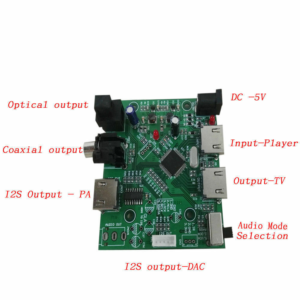

Input board for SACD-DSD function
The board can use external 5V source or the HDMI power. I soldered a 5-pin header to the DAC board and connect the 2 board with 5 Arduino jumper cables. It is done. No programming, no jumper change.
I got a 3-in, 1-out HDMI switch for the Blu-Ray Sony, Firestick and Cable TV box. The DAC uses HDMI input and on DSD mode all the time. I love the DAC before and love the DSD mode even so much more. A cheap solution to good sound.

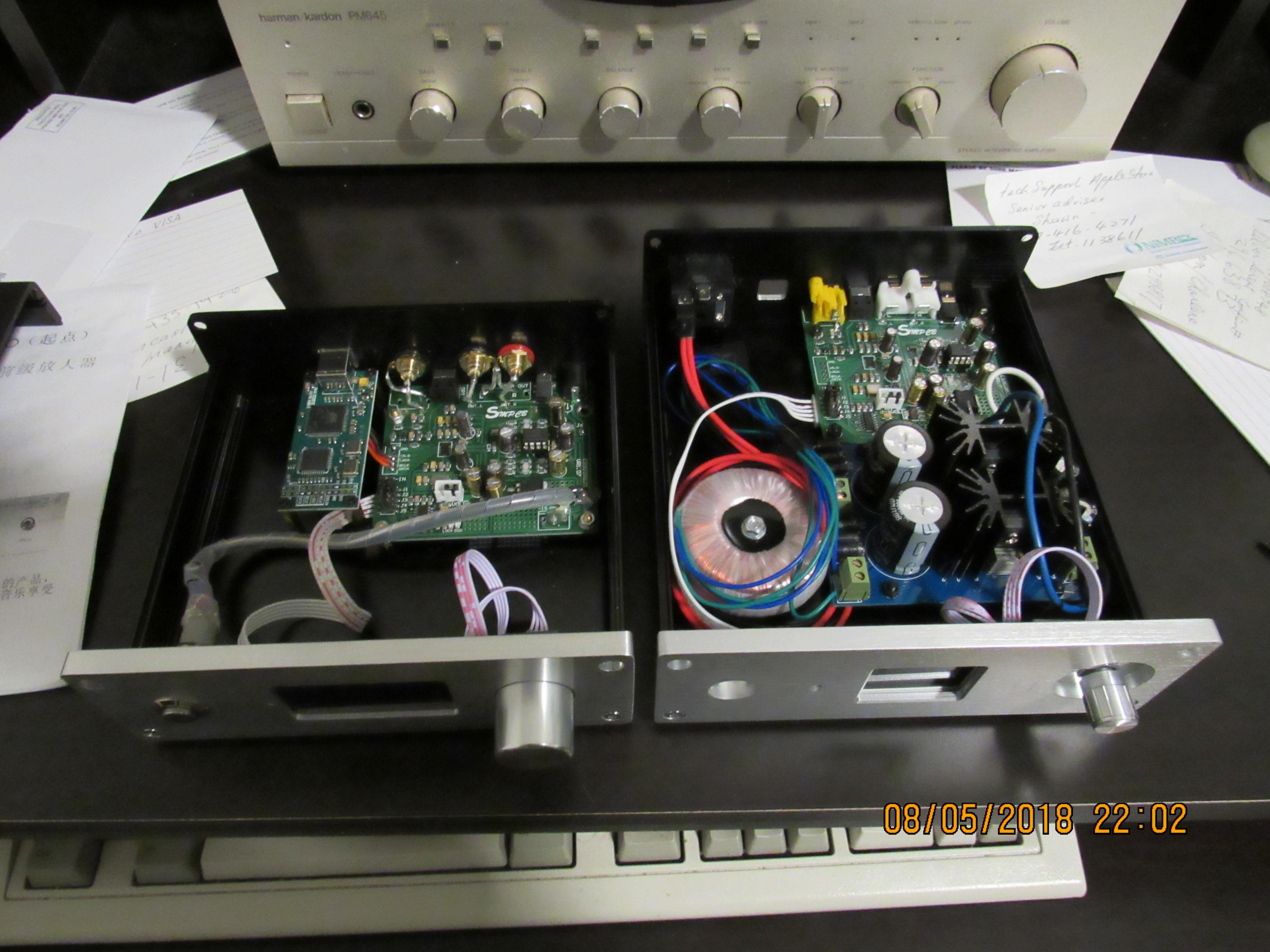

The one on the right is my DAC before mod. I will post some picture when I finish the hardware touchup.

In the past year, I added an Amazon Firestick 4K for internet/streaming input. My Sony UBP-X800 can play SACD. I have 2 DSD source and a DSD capable DAC, but no link between the HDMI only source and the DAC. My search led me to a HDMI/MHL Dual-Mode Audio Extraction I2S/DSD board on e/bay.After living with this DAC using the ES9038Q2M and toyed with the idea of updating to an ES9028PRO DAC in the last month, I decide that the sound quality of this DAC is sufficient for the TV audio, DVD and CD digital sources that I use. I built another one using dual voltage internal PSU. It requires a deeper (180mm) case. The original factory built DAC and the home built DAC is shown side by side below.

It is the same VR1.07 SMPCE Chinese board. The new case uses the onboard RCA jacks instead of off-board ones. The new home built DAC is working fine as is, but I am waiting for the power on-off and volume knob.

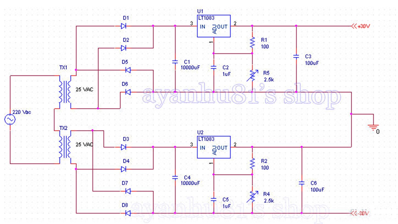

The transformer is from Antek with a dual 15VAC windings. The PSU has dual full bridge rectifier with LT1083CP regulators set at +/- 15VDC.
The schematic of the PSU is notional, not the actual values of components that I used.
I like the home built DAC very, very well and may sell the factory built DAC soon. If you are interested, PM me.
![hdmi_i2s_s-l1600.jpg hdmi_i2s_s-l1600.jpg](https://www.diyaudio.com/community/data/attachments/732/732725-21e6f2a2da9353f38bc188877db49fe8.jpg)
