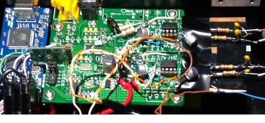

That pdf sorta answered my questions. Have did you tie dac earth with the op amps (for virtual grounds, not the AVCC op amp) middle voltage? (18V+, middle 0V, 18V-). In my solution they share the same ground layer and is tied. Is that the correct way of doing it? So all the earth symbols in multiple schematics refers to the same ground plane? In the picture one can see the new copper plate soldered on to the the old regulators ground..

There is only one ground potential for everything, no virtual grounds.
However, there is something we sometimes refer to as an 'offset-virtual-ground' which is at about +1.65v relative to actual ground. The name ESS uses for that sorta kinda offset virtual ground is Vref, and it is some fraction of AVCC, originally it was AVCC/2 = 1/2*AVCC. That's it.
Vref is only used by the non-inverting inputs of the I/V opamps, not for anything else.
Also, please don't confuse what we call the AVCC opamps with the I/V opamps. The AVCC opamps are used in our dac modding project as power supplies or voltage regulators to power AVCC, which actually is of two types: AVCC_L and AVCC_R. That means there are two AVCC opamps that supply 3.3v for each of the Left/Right dac channels.
The outputs of the AVCC opamps also power the Vref voltage dividers. There is one Vref voltage divider for each Left/Right dac channel.
Schematics for the recommended AVCC supply and for the output stage are attached to post #3003 of this thread. The Vref dividers are shown on the AVCC schematic. The output of those Vref dividers next appear on the output stage schematic and go to the non-inverting inputs of the I/V opamps.
Hope that explains it all this time 🙂
If not, sorry. I'm willing to try again if something still isn't clear.

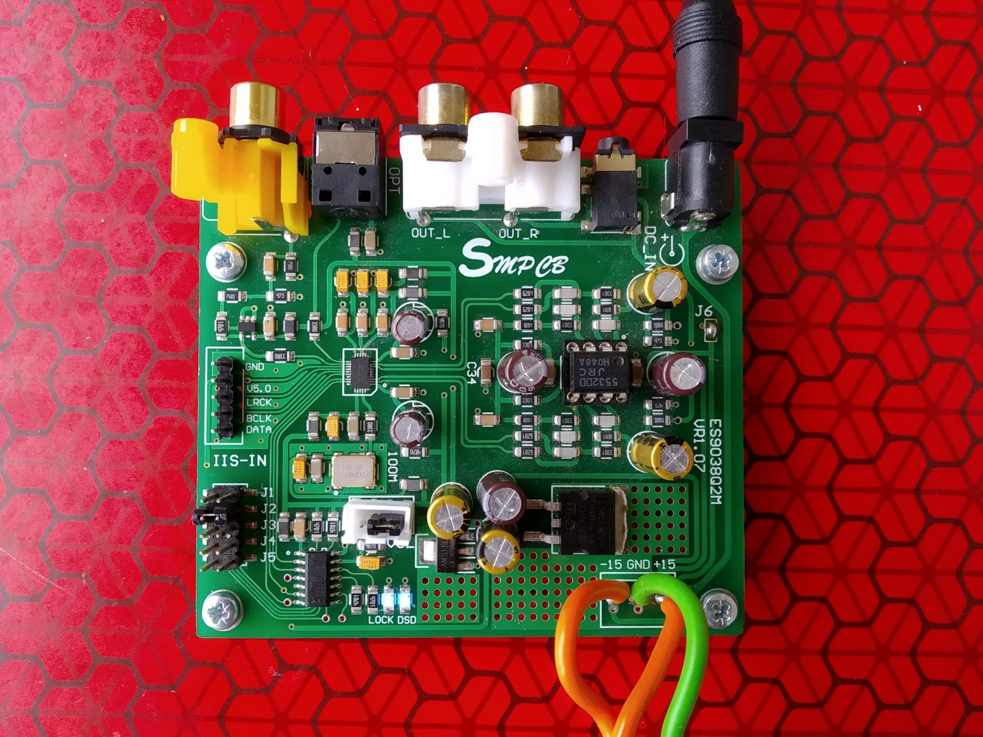

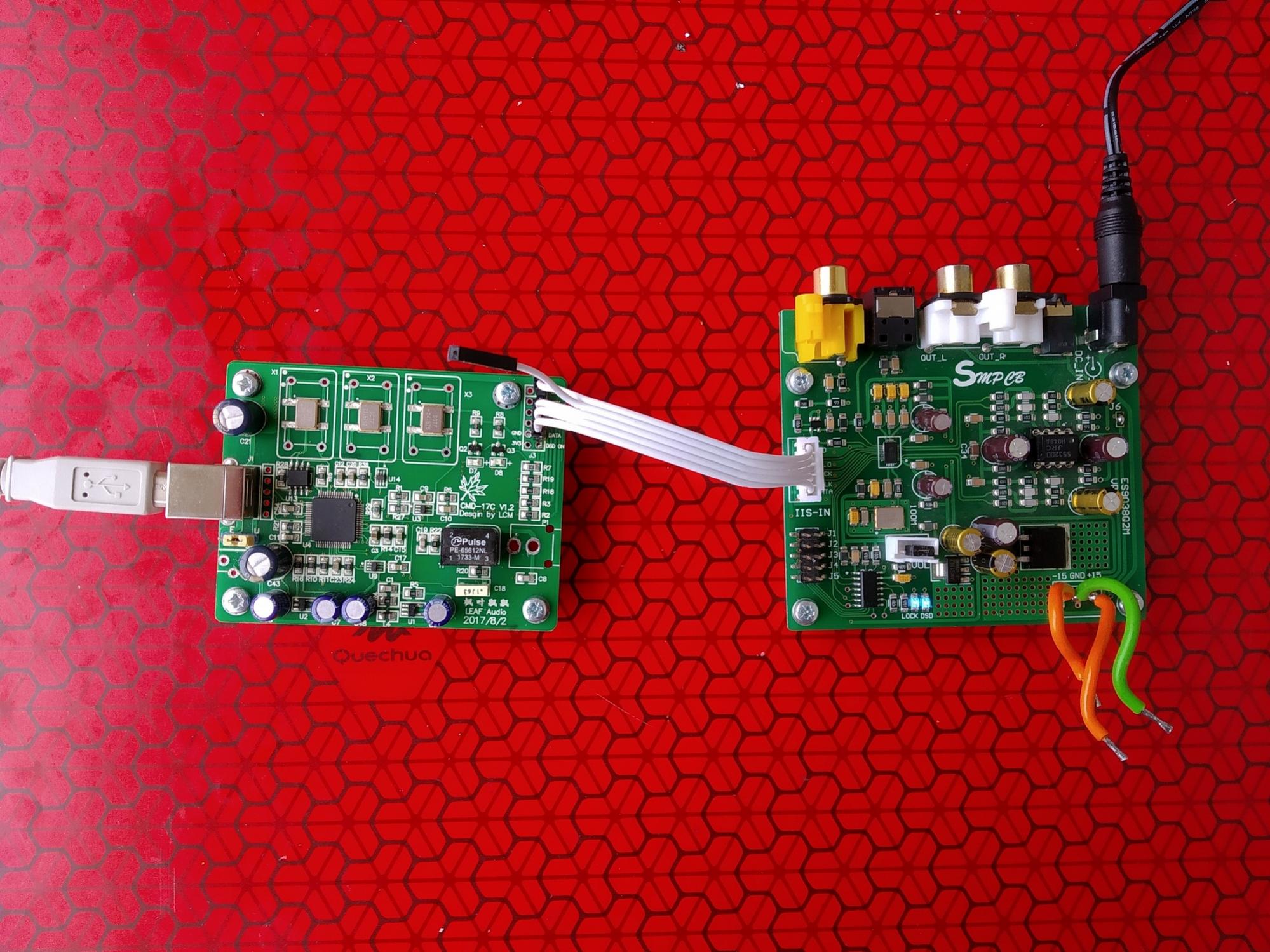

Naaling,
Could you post a clear picture showing the interconnections between your dac board and XMOS board? Maybe that would help us understand what is going on.
Also, if you just install J1 even though no TOSLINK input is present, do you still have both LEDs lit?
Naaling,

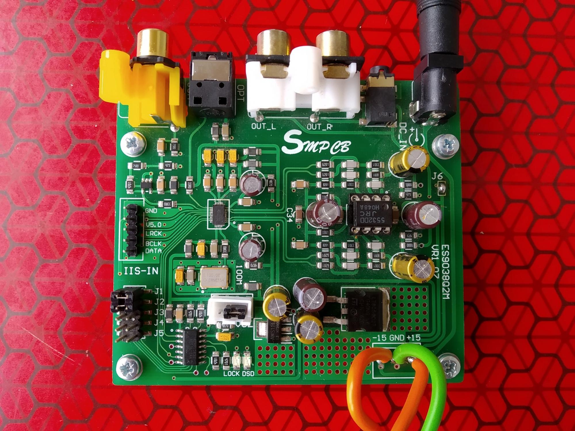

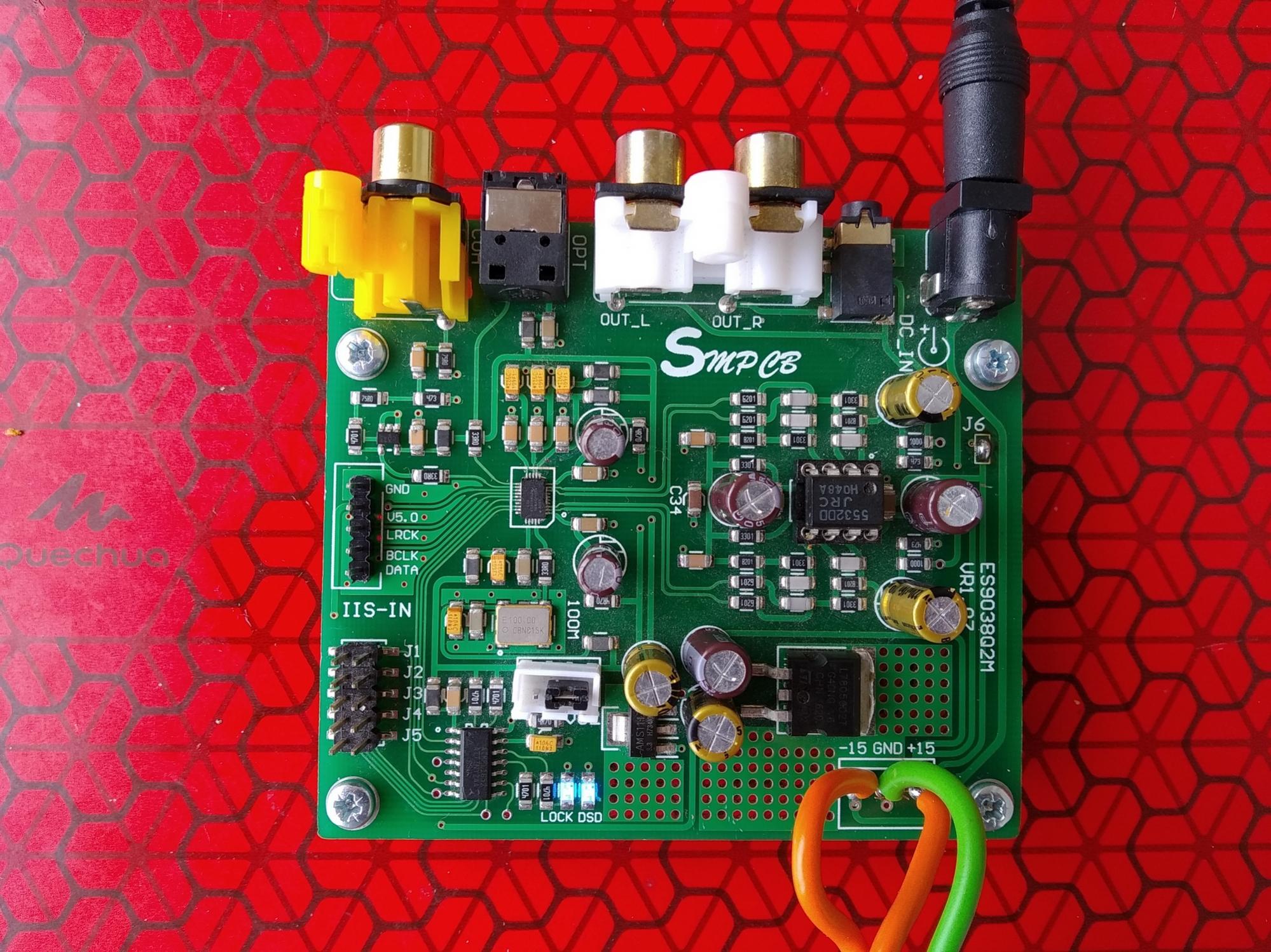

Some Photos
1. DAC powered by 12v wallwart. J1 and J2 open, with no inputs.
2. XMOS DAC connerction.
3. DAC powered by 12v wallwart. J1 open, with no inputs.
4. DAC powered by 12v wallwart. J2 open, with no inputs.
5. DAC powered by 12v wallwart. J1 and J2 shorted, with no inputs. (a bit pointless really!)

Sorry that should have been
3. ............J1 shorted
4. ............J2 shorted
